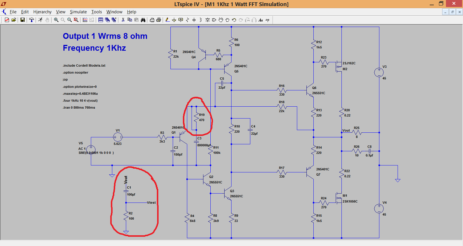

How many times I have posted regarding critical drive for low transconductance LATFET especially to achieve sufficient musicality. This "drive" at worst can be achieved from global feedback or gain.
Mooly's amp has 22k/470R=47. Original Hitachi circuit has 33k/1k=33. Do you know of ANY other latfet amps on this site having gain as much as those two???
I think I will build this again with little (bias current) modification to the output driver stage. As far as I remember, it was impossible to remove the second order dominance from this circuit. Ditto with its equivalent TSSA competitor, where both are CFP (Yes, I guess CFP configuration plays a role as well).
So, drive, second order distortion, CFP, SE input, all are known good features (at least for me) for musical amps.

The OLG is surprisingly high but if I'm honest that wasn't a consideration back at the time. The amp was designed long before I had got my hands on such goodies as LTSpice and so on. But yes, high it is, around 110db in simulation compared to around 84db for the typical blameless configuration.
Running the amp at high closed loop gain was deliberate, my experience is that doing so results in a less fatiguing design... something this amp could never be accused of 🙂

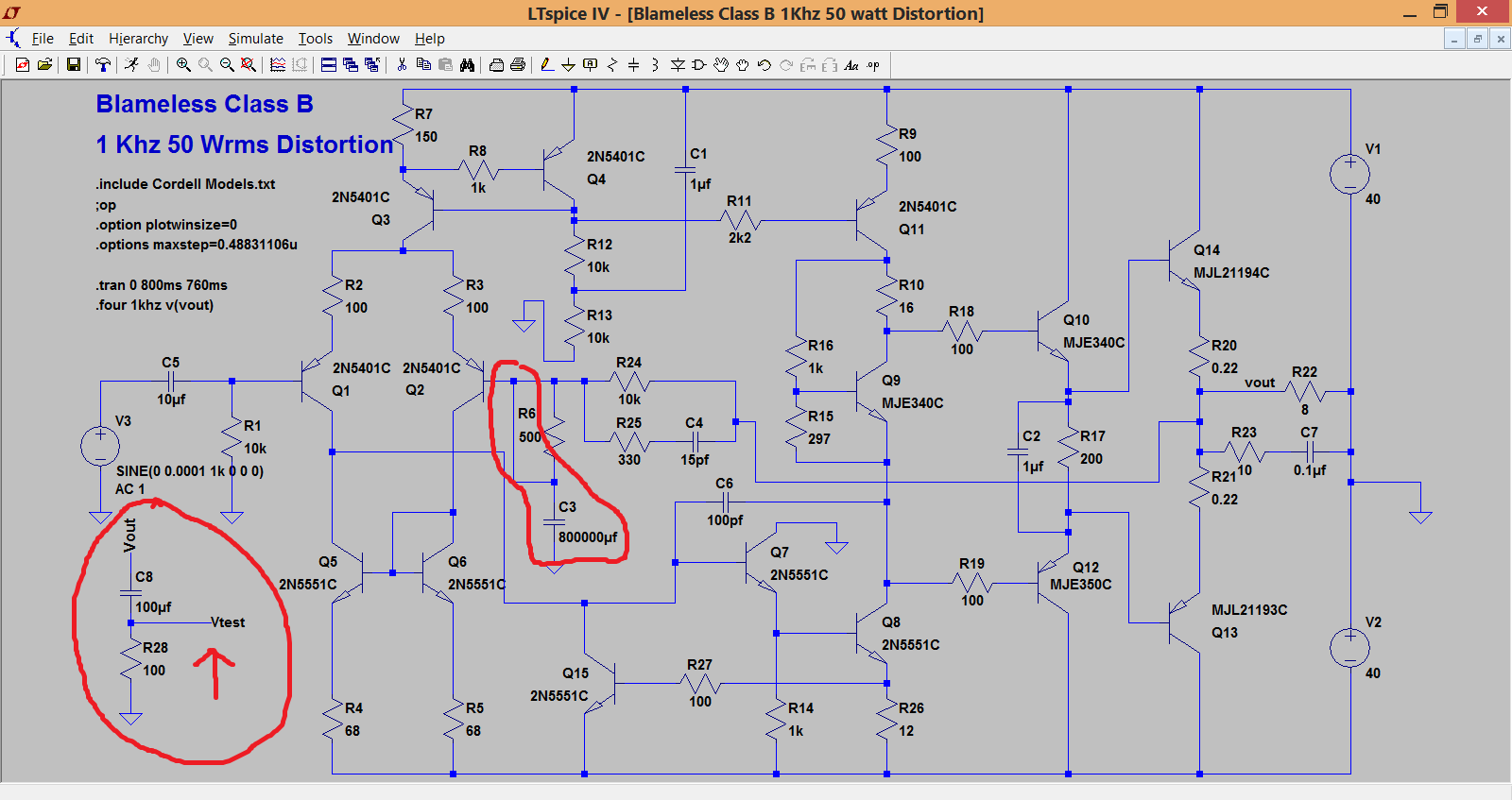

D.Self quotes OLG @ around 117dB for his "Blameless Power Amplifier" (fig 8.15 p218 of 6th ed)............. high it is, around 110db in simulation compared to around 84db for the typical blameless configuration...............
He goes on to say "what we really want is more feedback in the 10kHz - 20kHz region.
It's the excess of OLG over gain @ 10kHz to 20kHz that he is claiming as an important criterion. Many other designers agree on this point, that of maximising loop gain at 20kHz, while maintaining the stability margins.

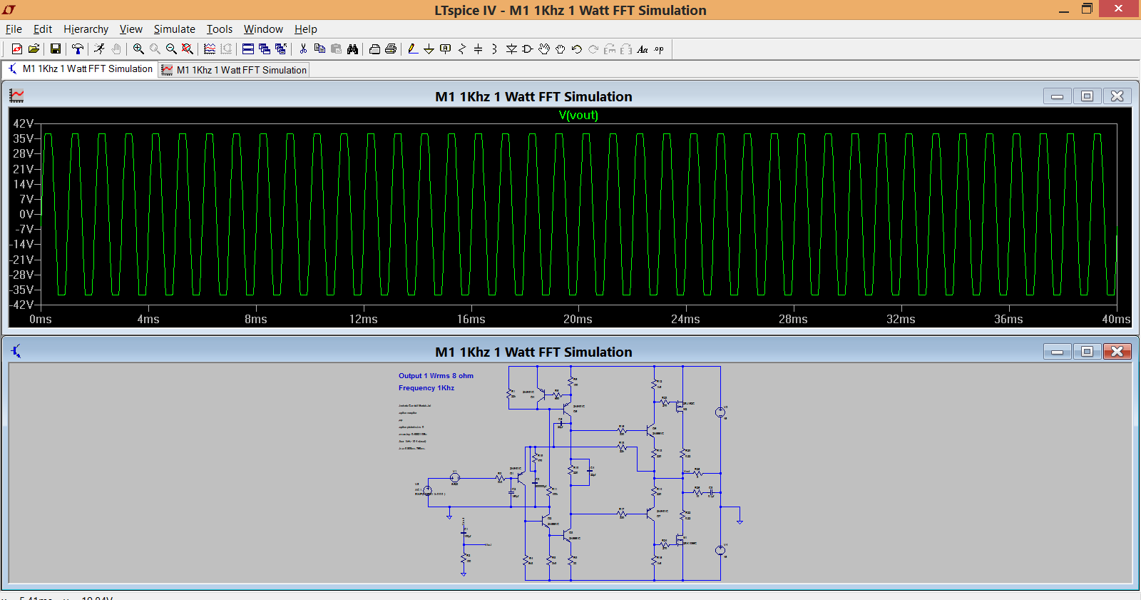

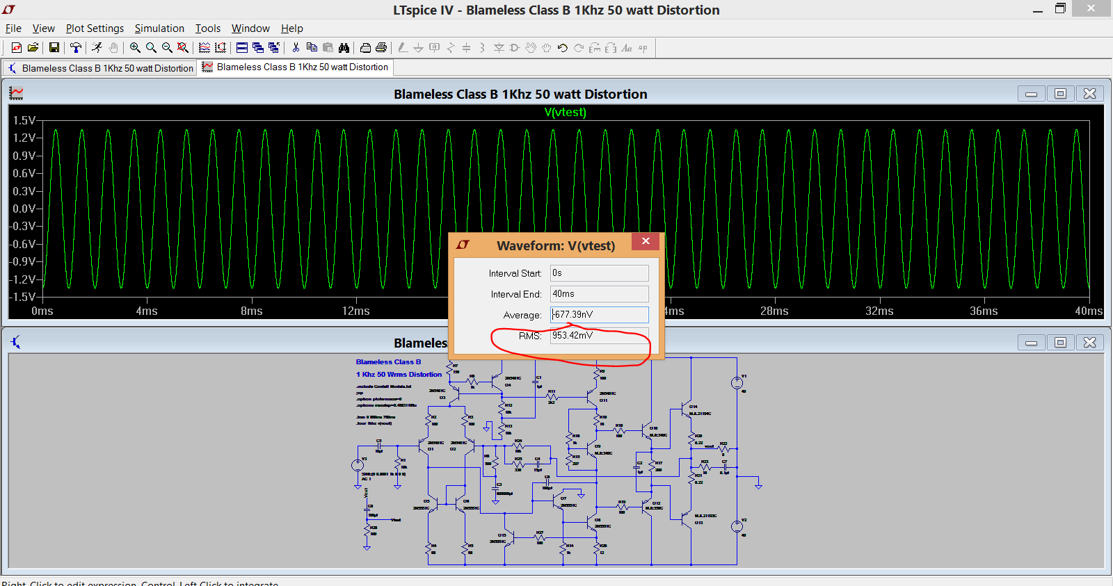

I am just re running the OLG sim again. Same set up for both as you can see.
Vin is 70.7uv RMS for both. Frequency is 1kHz.
Blameless Class B delivers 953 mv RMS into 8 ohms. M1 amplifier clips requiring the input signal to be lowered.

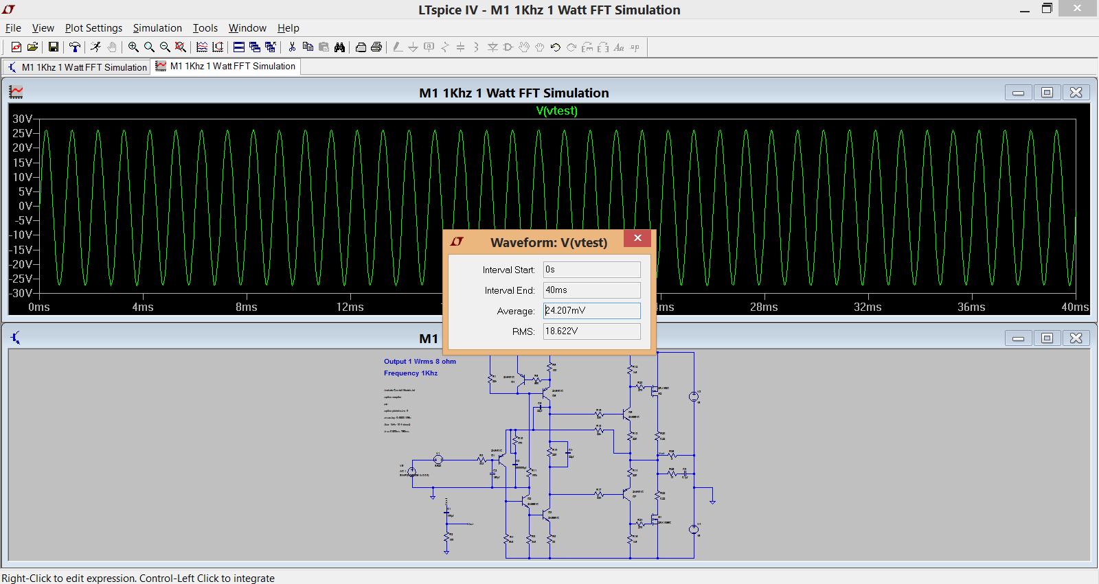

New input level for M1 is 34.8 uv. Output is now 18.6 volts.

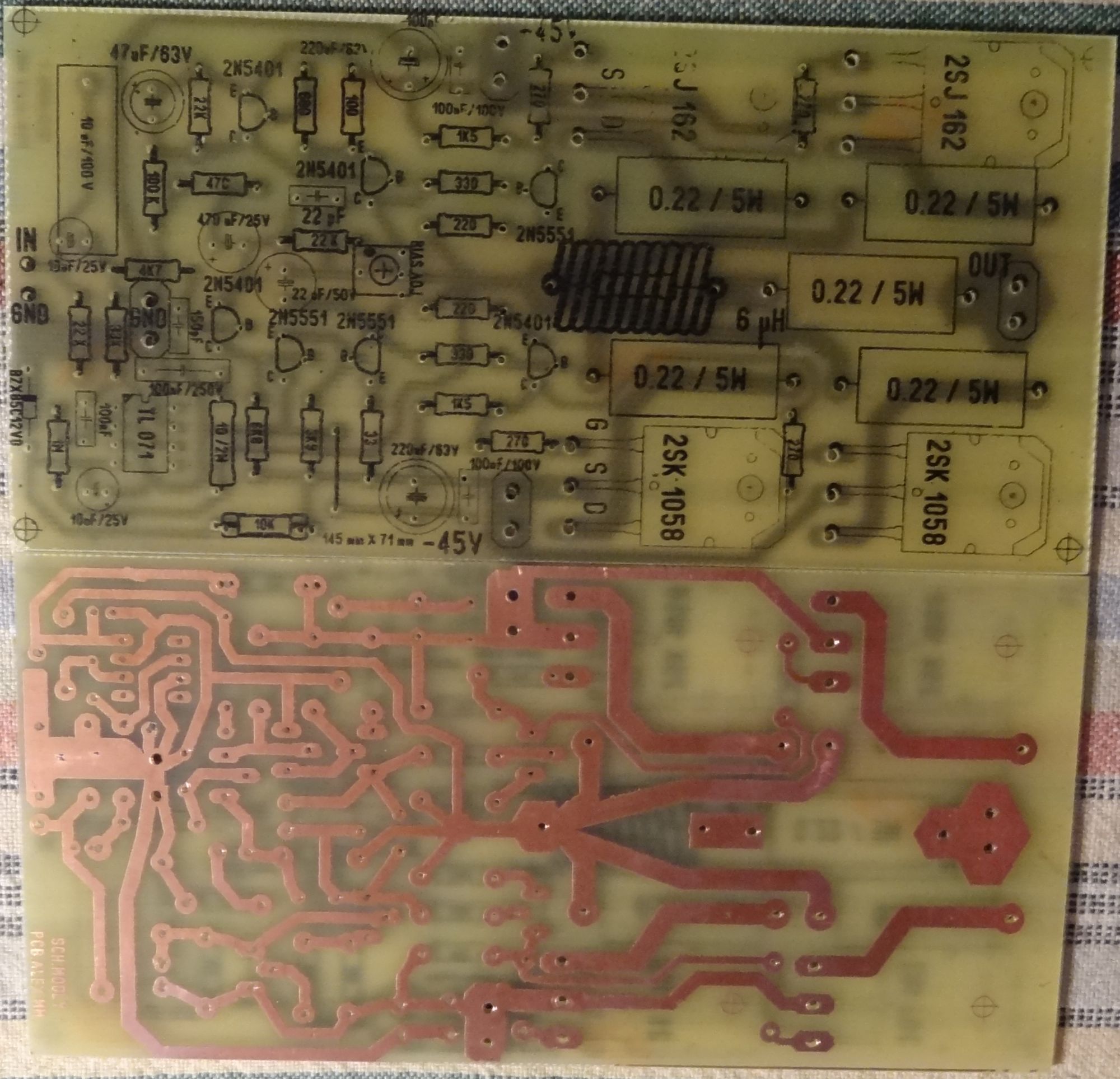

Well I have it singing but it is not a very happy camper. I will have to do some more reading through the thread. I built it to the schematic in post #1 and the values on Alex's board which seem to match. The output doesn't look too bad with a load attached. A little over shoot on the square wave. The biggest issue is the offset. Once I play a sine wave through it the offset starts jumping all over the place and doesn't settle again unless I shut it down and restart. Any suggestions are welcome.
Also, the gains seems really low. With a 1.2v input I am only getting about 8.5V output.

I am unfamiliar with this amp but the problems you describe are familiar and remind me of issues that I have seen with a different amplifier with parasitic oscillations.
