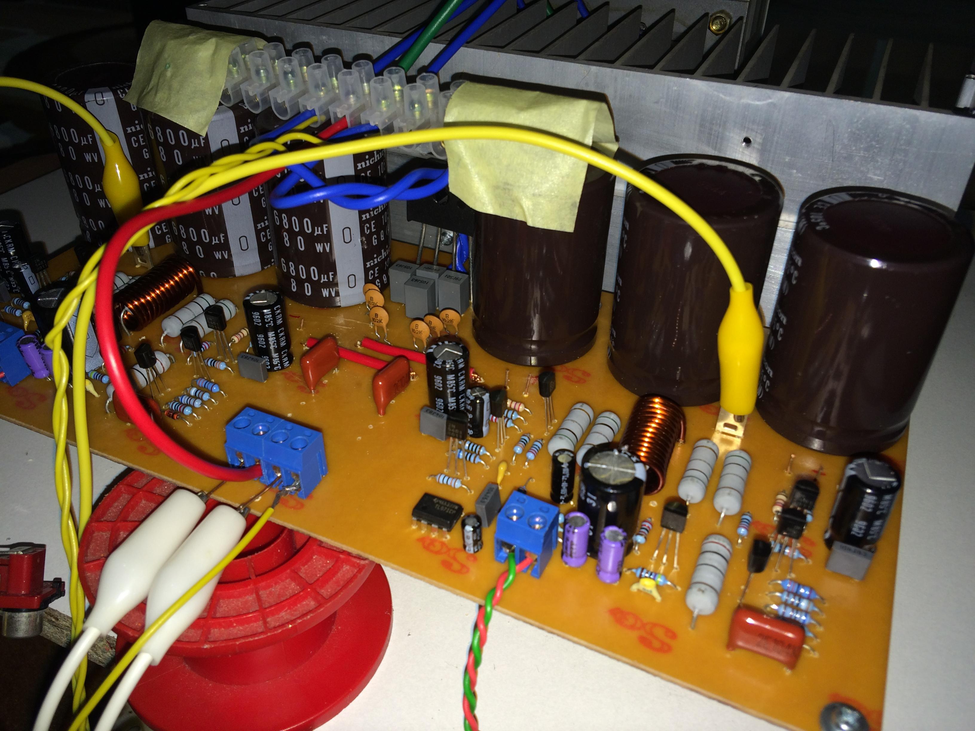

Hi Karl,

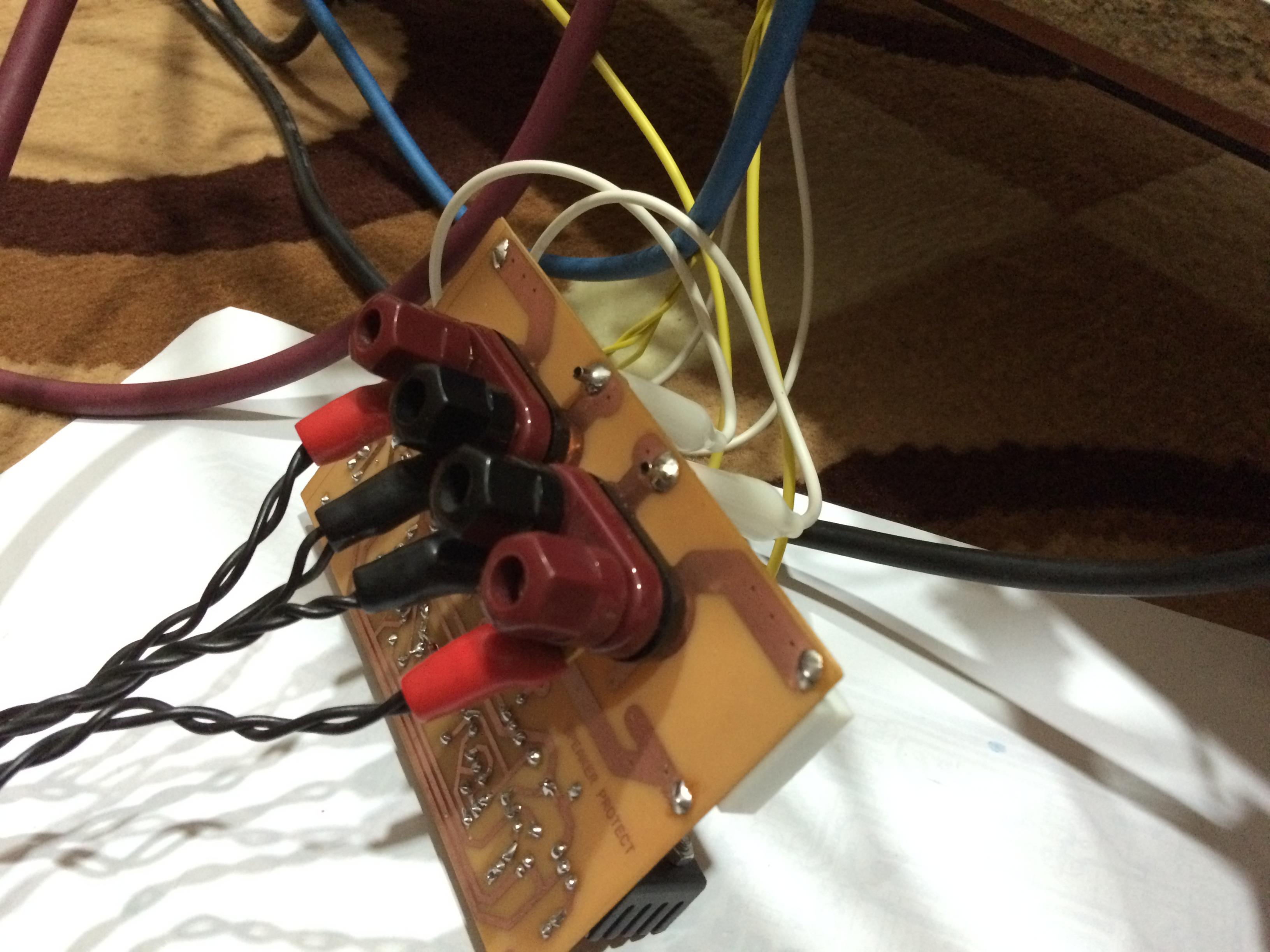

Have hooked up for testing. Speaker protect/delay included.
At initial start up, dc offset starts at about 50 mV and settles down to some
3 to 5mV. Running for about half an hour, the heatsink is only warm at touch.
There is very slight hiss and hum. Probably due to messy wiring.
Playing Jennifer Warns - (Hunter/way down deep), the bass is very precise and well controlled. Rich soundstage and the vocals are best so far. Have built the P3A with similar layout and all is similar performance in terms of dynamic and attack. But this is subjective to my setup, your amp excels in the vocals. Highs are well detailed and sweet. Overall I like it very much.
For a simple circuit, it is worth the build.
That's a really neat build you have there 🙂
I'm pleased your liking the audio presentation, and I know others that have built it have had similar findings.
