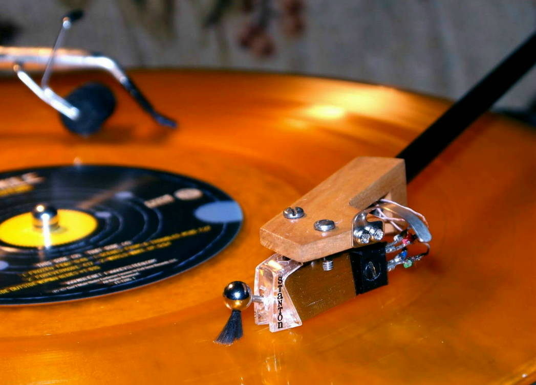

a little better look at te base with vta adjustment. Thumbscrew has a 6 mm thread, locknut is needed for a solid construction. I ve got about 10 mm of adjustment range, so way more than needed. Just hope the adjustment will not be too coarse.
headshell.
rather heavy in comparison to the armwand, but wanted to stay with brass.
Effective mass is 15 grammes for this 10" arm, should fit my cartridge quite nice.

Sorry to Jump In...But, I Liked Stew's thoughts on a Straight HeadShell...Needle to Pivot...So, I just made One...
Damn...These are Easy to Make...And, it Sounds Great and Balances Naturally.
TT Spindle to Tone Arm Pivot; 10"...Pivot to Needle 10 5/8"...21 Deg Angle..

sled's headshell
sled:
Was the "Damn...These are Easy to Make" reference to the headshell, the arm, or both? In any possible Kickstarter offering I was thinking that a 10.5" arm would be a nice compromise between length (and therefore superior tracking error) and convenience regarding the retro-fit to existing turntables. Anybody have any thoughts on this?
sled:

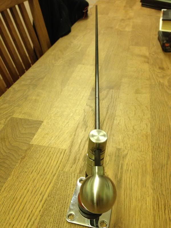

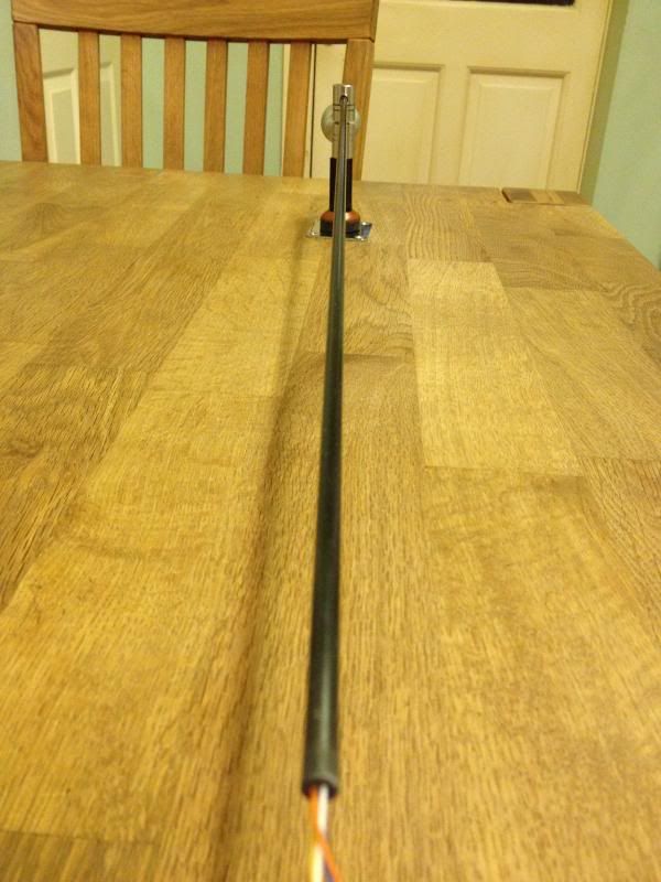

Uni-pivot arm number two is coming along nicely. Still to do the wiring and decide how I'm going to connect the headshell but the design for the body is pretty much sorted.
Two foot of Carbon fibre arm wand will have it sitting on the coffee table thereby saving me the hassle of getting up when the record ends 🙂
OK two foot is just too damn long and this will be shortened I just wanted to see how it would work. It's like one of those situations where you just know it shouldn't be done but you have just gotta do it, just to see, just so that you can say 'yup I did it'
The ingredients for this recipe are as follows:
2 x draw handles for the main body pieces.
1 x draw handle for the counter weight. I think this is going to be too heavy if I go for a shorter arm but there is a smaller version, although not in stock when I purchased.
1 x very small diameter 2 foot+ long arrow shaft.
1 x computer mouse cord. I may change this out for earbud style speaker cable if I go for the shorter arm.
1 x ball point pen blank.
various bits and bobs from down the shed to make up the rest of the body.
The pivot is different on this one in that it is cut into the top section of the body very near to the top and above the tube of the arm. The wiring will come out before the body section then thread into and through the lower body thereby tidying it all up.
The design is to compliment the Saturn and to be fixed ultimately as a second arm. This is the first time I have worked with metal on one of my designs and without a lathe or proper tooling it's damned hard to get things right. Just drilling a hole through the body section had my metal drill bits glowing red hot!!! Stew it's alot easier working with simple materials when you only have the basic tools to play with 🙂

I was referring to the HeadShell...I use the same Tool Kit as You...That one was made with Hand Saws, an Electric Drill and Sand Paper, on the Kitchen Table with a Wooden Clamp and a Dust Pan and Broom...

I made another test. Our wedding trip went to Wienna in -91 where we bought this as a souvenir...
A red Mozart Jubileum 2 LP set. The second one is very warped - they obiously had a rush creating these. The sound is OK on the first LP but the second one was no idea of playing. The cart jumped all over it due to the warps... Now - not a single miss - the cart just rides the waves. Amazing.
I'll give you a picture of the album and a youtube video when I have figured out how to get it there...
Brgds
Brgds
Youtube as I have it in the cache: http://youtu.be/Xb0_8HJQ8z4
Pic of the album :
I have to add that I haven't percieved any issues with SQ dealing with the warps.
Brgds
Pic of the album :
Brgds
@squiffything, drilling in stainless steel should be done on a surprisingly low speed. For example a 6 mm hole should be drilled at 500 rpm, and plenty of oil. But what a neat arm it is!
How do you plan to adjust the tracking weight?
With regards to the luxury of a lathe in the shed, the nice thing about it is that you will find more use for it than just a tonearm. And a small one does not really need to be very expensive and still be usefull.
