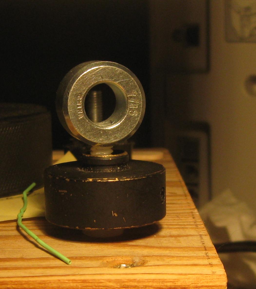

Now creating my second one - The Stick (the first one was The Tube). A bit heavier for lower compliance carts. I would love to hear what ideas you all have about this...
Maybe it should be in it's own thread but since the basic principles would be the same - I'll give it a shot.
Gathered so far - everything. Instead of using a quite thick wall carbon tube I found a gallow from presumably the fifties that had a lot lower resonant tone than the tube of carbon. Oh, yes - I need something to measure the weight. Will search the shops during the week. I would also like to find a cheap needle pressure gadget.
I took the straight stick out of the gallow and found it's an ellipse. Now, the vibrations from the cart is mostly in the horisontal plane so the broadest part of it goes into that plane. The alternatives of a headshell is either brass or wood. I will probably test both before I secure the headshell. Cabeling - what do you propose as the golden midway - shaked and dried of snakeoil? I wan't green, blue, red, white and black. 5m of each.
Oh, yes. If you have broken hi-end carts - don't throw them away - PM me and they might be worth something (the kinds you cannot exchange needles in...)...
Brgds

It seems to me that most tonearms have an effective mass of between 10 and 17 grams.
One thing that most forget though is that you can have an arm that is too light. Everyone should have a look here for a quick n'dirty explanation. Also make use of the resonant frequency calculator, or just write down the equation.
rf = 159 / sqrt ((eff. mass + cart weight + fastener weight) * (compliance))

Squiffy,
A balsa arm with headshell & bearing (Fuse cap) No wires though, will come in at about 4.5 grams. Vs Easton GameGetter Ali arrow tube, same length but no headshell, bearing, Or wire, will be apron 12 grams.
Stew,
I did make one & yes your right it will need to be stiffened, I used X bracing ala funk bros.
& that works well.
