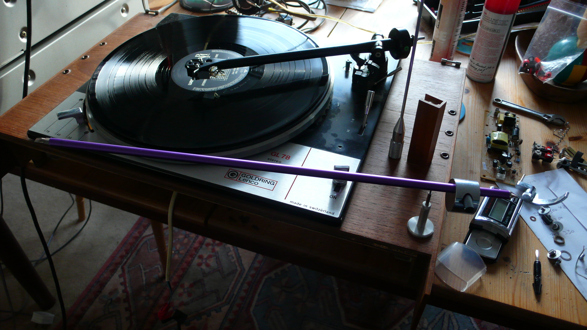

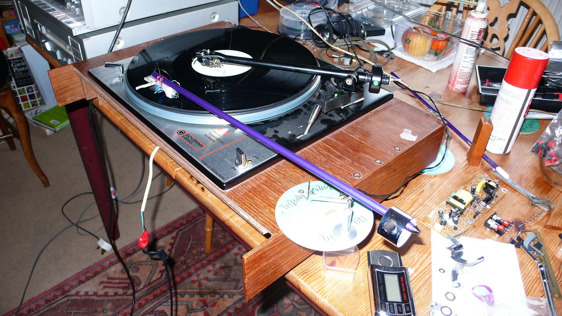

thanks turbon. have myself an Easton 2016 jazz for £6 in a pretty purple. can get 2 arms out of it. it sounds nice, a low freq resonance. got the papermate refill, broken fuse, enamelled copper wire, bits of wood etc. will make a start on it. the graphite arrows are too flexible, but fishing poles are so cheap, I couldn't resist the temptation. one was only £4 and weighs nothing.
paul
have just noticed the lenco counterbalance weight is a perfect fit for the arrow. this is too easy. could even fit a knife to it and fit it straight into the lenco pillar. sorry must stay on topic. will do a unipivot and get back with the results.
progress
proof of concept so far. P1060548.JPGits far too easy😀

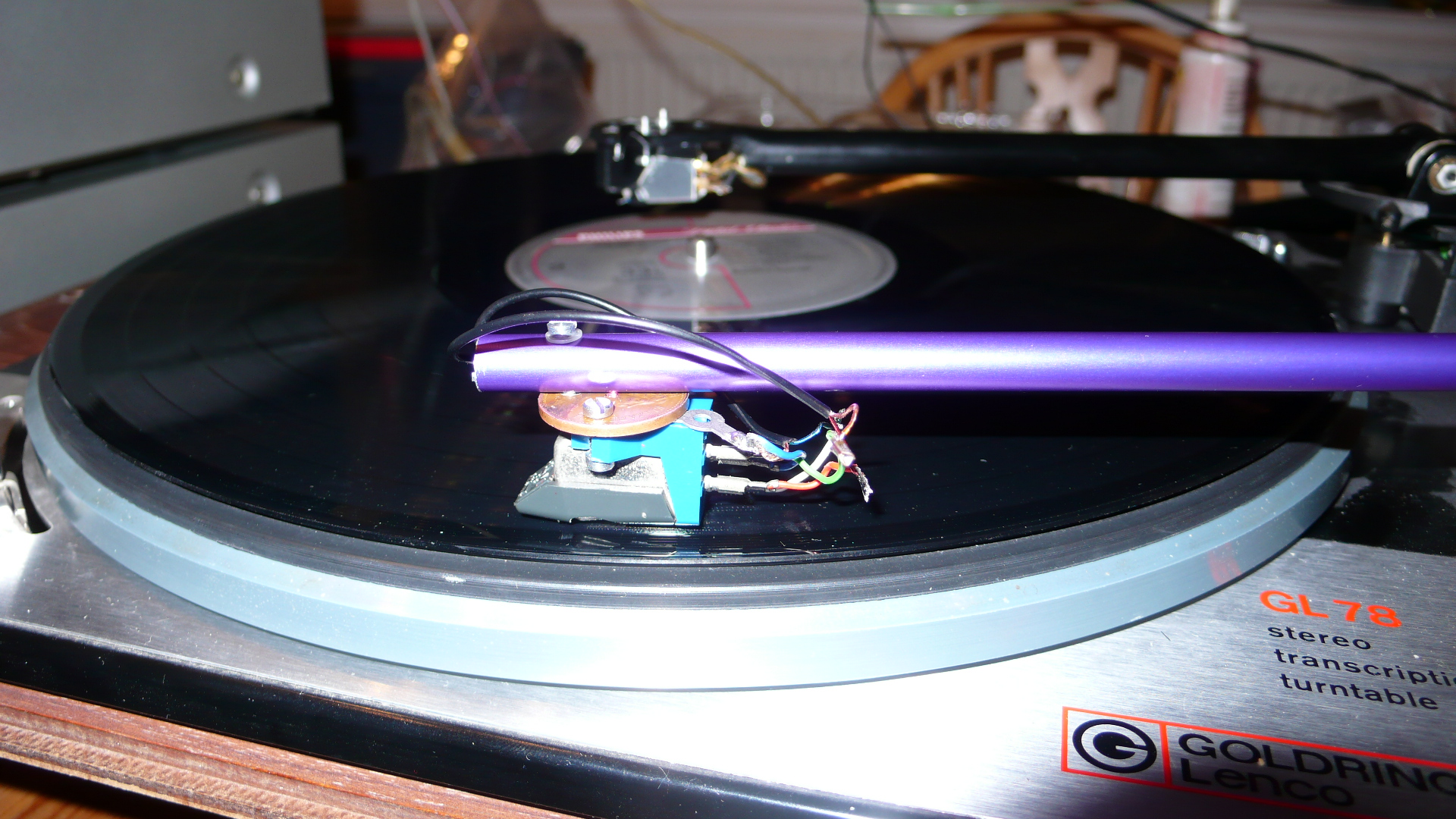

had to cobble up a headshell. the left channel earth has got rid of most of hum, plus grounding the lenco to the amplifier. now I cant say it didn't cost a penny😀. it sounds pretty good. the carts only an adc qlm33iii. next is to try the grado on it.

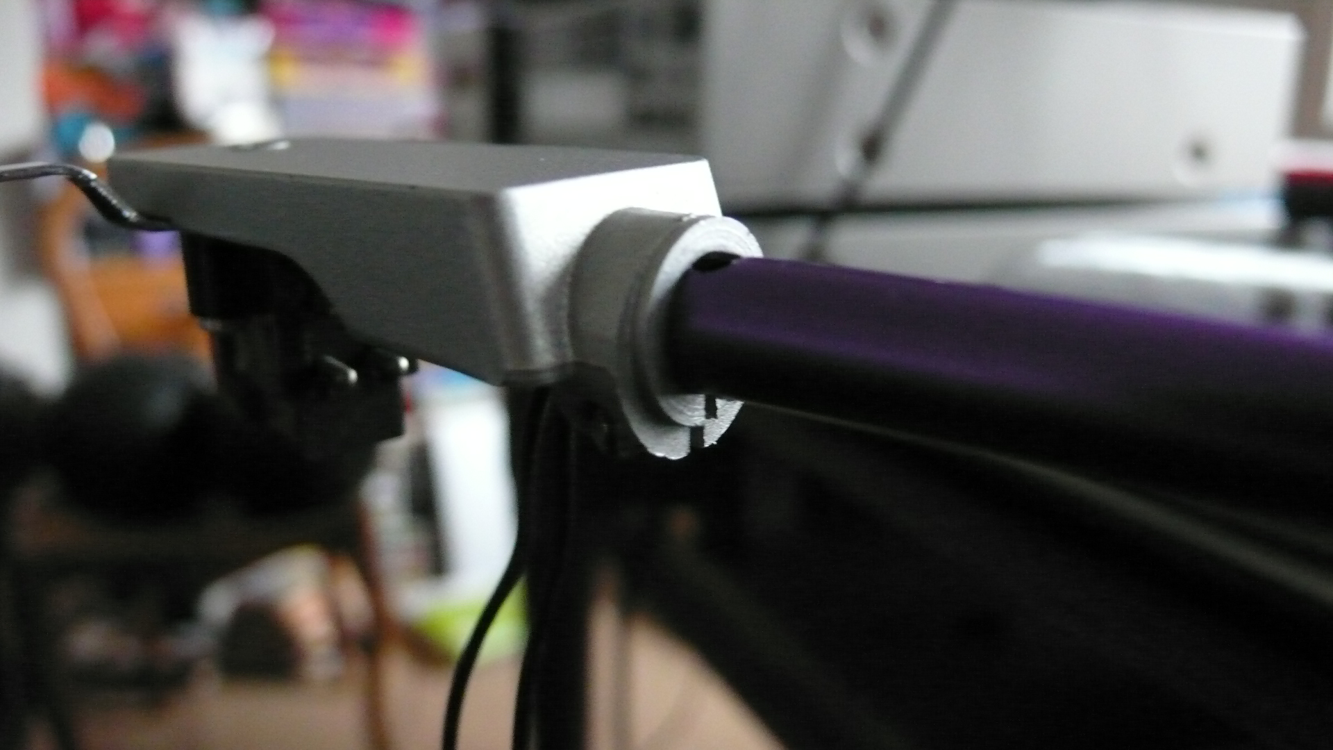

now it turns out the arrow's diameter is exactly the same as the standard (sme type) headshell shaft. my clamp on headshells are a perfect fit and make azimuth even easier. do you think the original designers of tone arms were using arrow shafts as their original material or is this a sign from above?😀 the location and rigidity of the pivot are important probably, so improvements may come with a solid plinth arrangement and beefing up the pivot's base. the bonus is the arm looks pretty.
