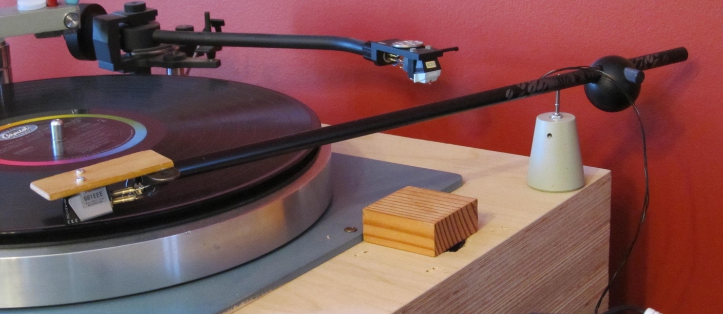

another canadian 219
"I'm sure Morton would appreciate the arrow shaft. Maybe you could drill and cut the shaft for him too (if you could do that I'd greatly appreciate it). Any pictures of your arm?"

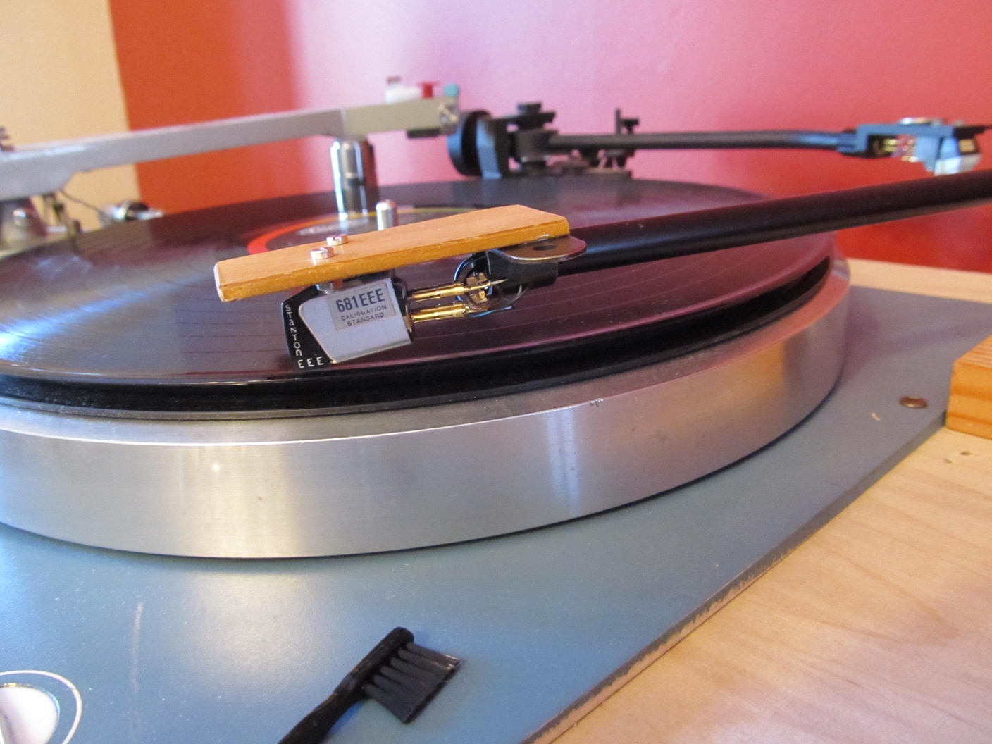

My 219.
XX75 shaft. Ballpoint pen bearing into a notch I punched inside the arrow shaft after drilling a hole for the pivot. Mouse wire. Regular cartridge tags. Thorens arm counterweight and Gates tonearm base, because I happened to have them lying around. Headshell is wood glued onto a metal bracket i found in the hardware store - pressure fit around the arrow shaft, although I should epoxy it. Might glue a strip of wood at 90 degrees on top of the headshell to minimize any potential flex (one day- lol).
Reclaimed items: wood, pen, mouse wire. Most expensive item - the arrow, since i had to buy a pack of several. A couple of $ for the tags, and a few for a hanging counterweight (a heavy metal cog form a surplus store, but currently sitting on the shelf) So perhaps not quite $2.19, maybe $10.
Arm: mounting distance 290 mm, 15mm overhang, 19 degree offset. Current cartridge Stanton 681eee, previously had a Stanton 500. Works like a charm.
The arm oscillates slightly at first when placed on the vinyl (TT off), but is easily stilled and shows no sign of this once the TT is going (McCurdy gets to speed in 1/4 of a turn)
Mortron has already picked up the arrow shafts and is borrowing my pipe cutter, but otherwise he is far better at DIY than me, so I will leave him to it.

I do like the canzid headshell 🙂
The slight oscillation is usually due to actually placing the stylus tip on the LP surface. No matter how careful you are, it's impossible to get it perfect. Even using a mechanical tonearm lift, the same thing usually happens. Regarding any with resonance issues, the use of small cork plugs at one end or the other (or both) of the arm shaft increases mass, but can also act as mechanical damping material.

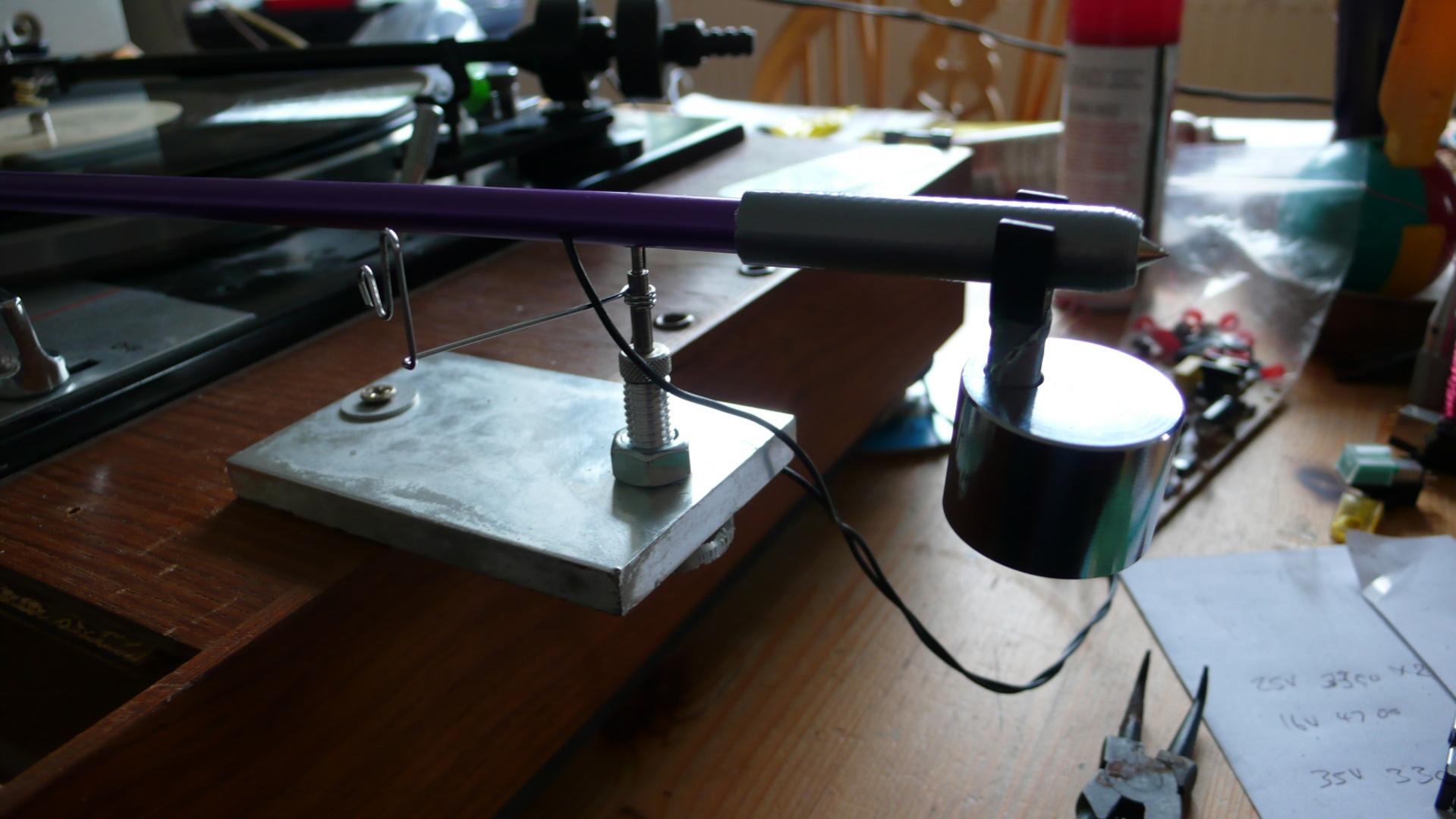

hanging weight
have upgraded the counterbalance weight using the arm rest from the lenco and some gaffa tape. I believe I perceive an improvement.

QUOTE]have upgraded the counterbalance weight using the arm rest from the lenco and some gaffa tape. I believe I perceive an improvement./QUOTE]
Sometimes it is difficult to perceive improvements, mainly because we do them (or make the thing we're listening to. So far most who have tried the 219 and any "improvements" like hanging the counter-weight have agreed with me, so perhaps I too should learn to trust my ears 🙂.

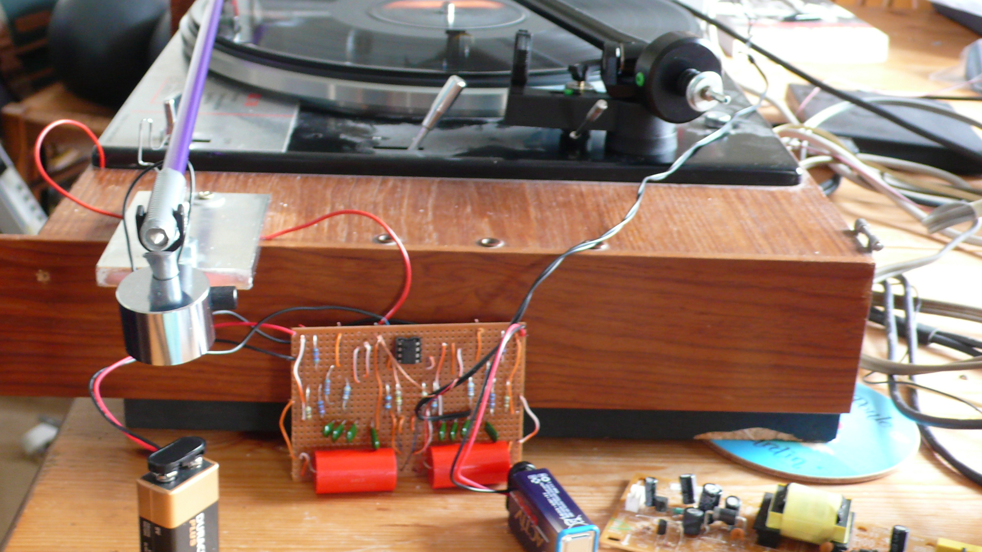

thanks for the advice stew. now I have terminated the headphone wires at the pivot to run a regular cable up to the amp and all hint of hum is gone - an objective improvement. the cable came out of my junk box, so a freebie. the thing I love about this arm is how easy and cheap it all is, and yet I get very good music from it. this is a counter revolution against the audiophile world where looks and price carry more weight than measurable improvements. my childhood was dominated by science exploration and music, this experiment reminds me of those happy days. I cannot fault this arrow. bless you stew, may you find the rewards you are looking for, they sometimes appear in unexpected places🙂.

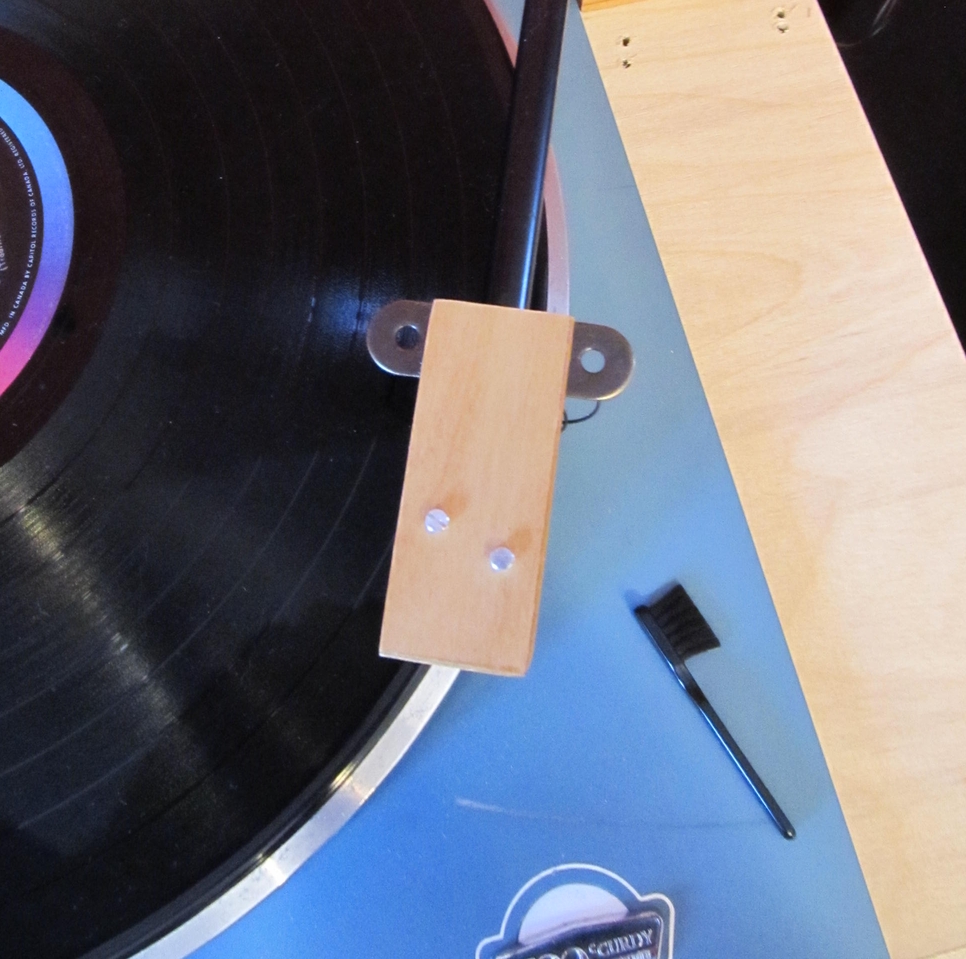

I have found that this is a good solution for a HeadShell...Easy to Make, and it could be Slotted for adjusting...This one is at 20.5 Deg. with the Stylus Tip centered on the Arm to the Pivot...
to make you happy stew I have built a phonostage so I can terminate the headphone wires direct, then feed the line on to the amp with the remaining length. Malcolm (willbewill) from lencoheaven supplied the parts inc post for £17.50. based on texas instruments ne5532p opamp. compares very well to my other phonostages.

I looked closer at your headshell. It seems very good to me. If one is not completely accurate in positioning the base of the tonearm, then a slotted headshell should be used. An alternative may be to have one hole and one "arc" slot, so that the angle can easily be changed. Only a few degrees of rotational adjustment is required (I'd say from 20°-26° would be all that is required). It all depends on the exact pivot to spindle distance you are using and what overhang figure you are using. I just plunked mine down and moved the base around until I could use a alignment protractor (the Oracle "Calibrator" is the one I use, but any will do).I have found that this is a good solution for a HeadShell...Easy to Make, and it could be Slotted for adjusting...This one is at 20.5 Deg. with the Stylus Tip centered on the Arm to the Pivot...

- Analogue Source
- my latest iteration of "Nanook's 219 tonearm"..
