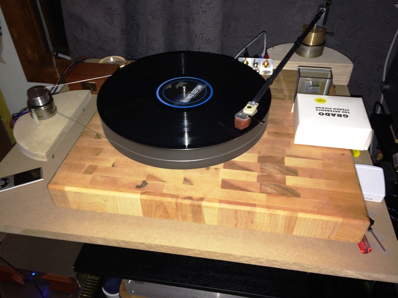

14" Arm
Made a new arm. This one is a 14" version using an Easton arrow shaft.
Wire is 38 gauge. The head shell holder is a laminated wood. It's actually a crafts trinket. Pieces of wood with letters on them that can be hung on a nail, possibly to spell things out. It was the right size and had a hole already drilled in the right spot. It's held into place with JB Weld. The head shell is aluminum drilled to fit the cartridge.
Only think I don't like is that the whole arm rocks and sways a bit. Might be do to the pivot point being to sharp as a point and not a radius. It's literally a needle point. It's inserts into an acorn nut.
What? How does it sound? Thought you'd never ask. 😉
It's the best thing I have heard in my system.
