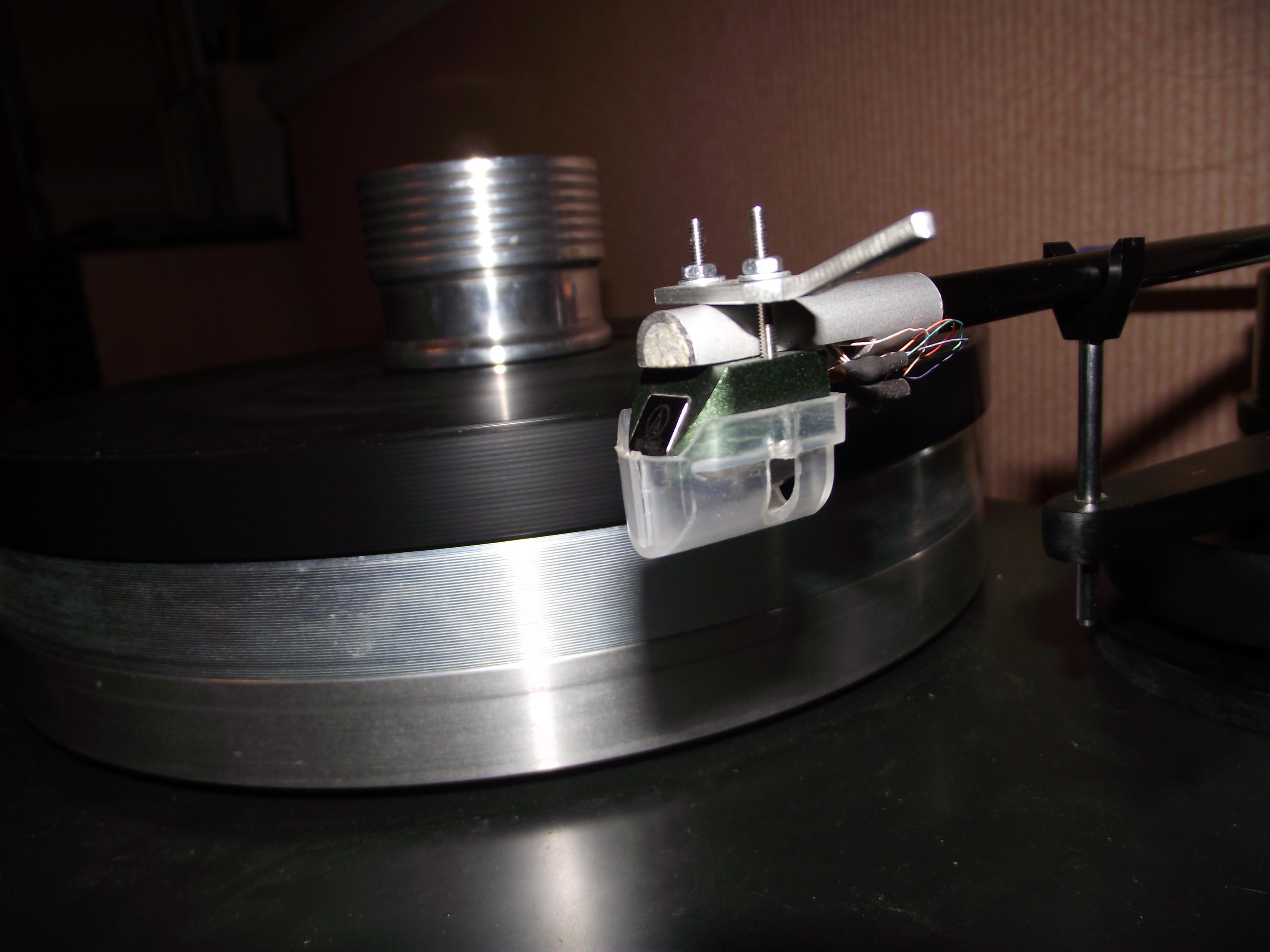

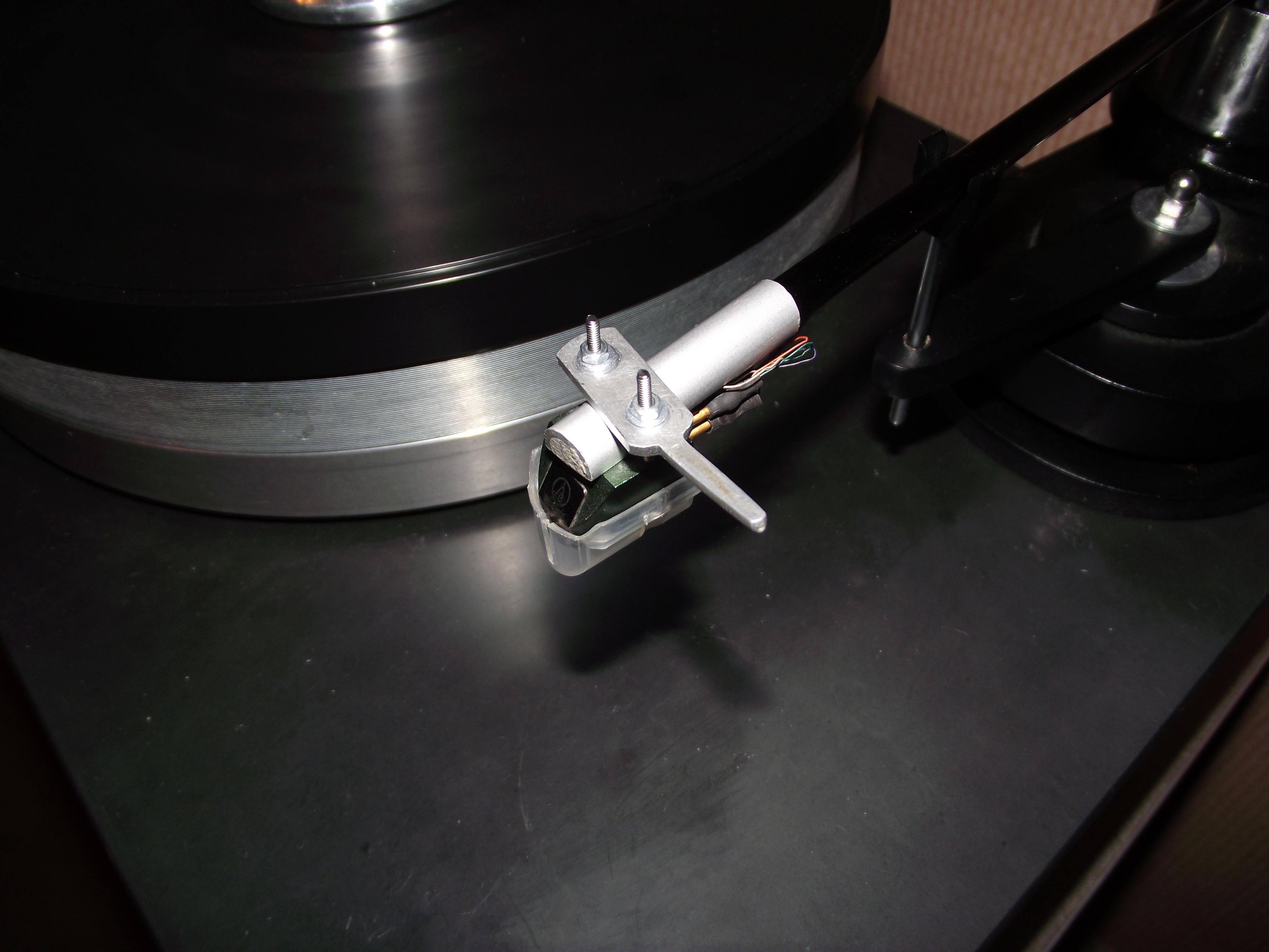

Hello Everyone
Further to the discussions relating to headshells, I believe my design to be, not only aesthetically pleasing but also very practical and rigid. It is also very light at less than 4g. Headshell 002.jpgHeadshell 003.jpg
I'm using it on both my version of this arm and my WT Clone (see the other thread). It also makes alignment so very easy.

Looking good Gijsch,
& yes thats how I fitted the fuse cap into the tube with epoxy, then filed any excess off so it looks like its just a hole in the tube.
Though to be fair the added weight at that point (directly below the pivot point ) could be of benefit to overall stability.......Any thoughts about this?

Jay: Your headshell is similar to the Scheu design. Did you use a piece of tubing and then fill it with epoxy or similar? I am building basically the same thing, using wood. Once I am happy with it I will try one out of solid aluminium.

I think any old fuse would do as long as its brass. If production was an intent This is the method I would use as it lends itself nicely, to Flow production. As it is merely an adaptation of an existing thing.
Stew: The headshell is Cherry Blossom wood, (we have a nice tree in the garden) just hand carved, then Carefully sanded & drilled. I was going to make an entire arm from the same wood, got as far as drilling a rather wonky 13" long hole, by hand, I don't have a lathe.
Yes the implementation is nice & diverse with interesting ideas.
Jay
