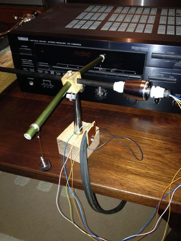

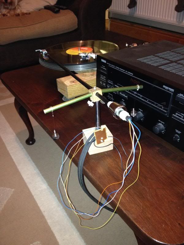

Having read through the thread from the beginning and wanting a new project I decided to have a go at a pivot arm and see if I could put something together for even less than Nanooks $2.19.
Well here's my attempt and a brief run down of the costs. It's 19" long from the pivot to the stylus!
It is currently a work in progress and I will be tidying up the wiring etc to make it look a little bit more presentable.
The costs:
1 carbon fiber arrow shaft - free (found buried when I used to do field archery and saved for a rainy day)
1 metal arrow shaft - free (ditto)
1 block of wood for the base - free from the wood scrap pile
1 block of wood for the body - free from the wood scrap pile
wiring - free from an old mouse (he'd passed it and had to go) and an older dead turntable
pivot - free (an old pen refill and a screw)
4 counterweights - free from an old computer (they used to be on the front holding the facia on and when the comp died I always thought how cool they looked and might be useful for something)
Fishing line and rubber holding bands for the counterweights - free from the fishing box
Rear weight - free from the old turntable
rubber gromits for the rear weight - free out of the box of bits and bobs
Headshell - free from the old turntable (it was a plastic fantastic and therefore isn't the best but it is light and has the cartridge positioning holes already in place.
Cartridge - free as already in a box of spares, it's an Ortofon OM again nice and light.
Oh and the last piece would be the chrome metal body. Whilst technically this was free in monetary terms, it was most definately not in terms of retribution from the lovely Sarah, my long suffering wife. Until a few days ago it was haning in our bathroom waiting to be pulled to turn the light on 🙂 It didn't help when I 'forgot' to let her know it wasn't there anymore and in desperate need for a squirt she could not find the cord to turn the light on in the dark and almost had an accident, Ooops 🙂
Anyhoo having put it all together as a dry fit I brought my testing kit from the shed into the livingroom and gave it a trial run. Firstly very happy with the sound coming through my homemade single folded horn speaker connected up.
Then connected it up to the Saturn and wow! the sound is amazing and it's rock solid. I cannot believe the quality coming through from a free, totally and utterly free, tonearm made from odds and sods in me shed.
Hope you like.

Hi Hejj, the carbon fibre arrow shaft is so stiff there is no bend whatsoever and its so light. Because the tube is thin threading the wire was a real pita as I wanted it to exit below and before the headshell. Try and thread an eye or a needle from over a foot away. The problem I had was I hadn't decided to exit there before I'd made the connections at the base end Doh. I was lucky that I had a diameter of shaft that perfectly fitted a second wider piece which in turn was a perfect fit for a standard headshell fitting. I sometimes wonder why these engineer types are paid so much I mean its a breeze to make these things 😉.
The pivot isn't perfect and could be improved upon but it now stays true and balances the arm very well. The top screw allows for the arm to be shortened if required and the rear weight can be moved accordingly with the rubber gromits fixing it in place. I've a day off work and have been playing it all morning and its performing faultlessly. And that's still in a dry fit form! Apart from the few screws and the soldering of the wiring at the body end everything else is still loose including the wiring to the headshell.

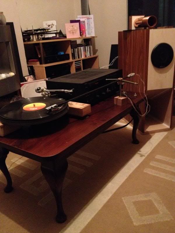

The turntable is the 'T' referred to in my intro thread. It is diy and again cost me nothing. The arm, motor, bearing and power switch all came from a dead turntable. The wood from my wood box and the platter from a further dead one. Nothing high end but with a little imagination you can get something sounding nice and looking ok. Much to my wife's despair I don't throw too much away if I think it can be useful and I have one of those minds that sees something and thinks that would make a good ????? This tonearm all stemmed from me sitting on the loo contemplating the light pull and thinking hmmmm tonearm 🙂

Stew the cost thing was to give the post a little side interest and humour, the post itself might have been a little bland otherwise. Certainly not in anyway trying to compete. I was inspired by your arm and the cheap cost of your build. As you said to put something that sounds as good as it does for so little is amazing.
The length is, I agree, totally impractical in a standard living room setting however I decided that I would give it a try before cutting down the shaft into a more practical length. I am truly stunned at just how good it plays and the detail that is coming through. I do not have loads of funds and my best arm is the transcriptors arm on the Saturn or the Linn Basic that I used on the beast. This is, to my ears, matching those with ease.
Having a fairly wide range of music tastes I can throw on a varied selection to give it a good run through and that's what I have been doing today. Some highlights have been the original Decca release of The Stones - Let it Bleed. Very bluesy and the guitar styles are very distinct. An old poor copy of Carole Kings - Tapestry sounds just lovely with her voice as good as ever. Phil Collins - Face Value had In the Air blasting out the drums as if the Gorilla was in the room in front of me and currently Vivaldi's greatest hits are filling the room with all of his seasons High pinpoint strings and the underlying bass booming out.

Is it just Me? Even with Litz Wire and a Carbon Arrow Shaft Arm..I still got a Buzz from just touching the ToneArm, and even not touching it...So, I ran a wire from the Phono Ground to under the ToneArm Rest. and now it's Quiet. Any One else have a Buzzing Issue?
Hi Sled, I do have a slight buzz at the moment but its so low at my normal listening level I hadn't noticed it. When I turn the volume up on the amp it can be heard when the arm is on my make do rest. As soon as the stylus hits the vinyl it stops! The arm sits on the rest on its plastic hook so no metal contact. Hmmmm very strange.
Ha ha Houston we have a problem. I have just stuck on my test record to see how well it does. Ok as mentioned before I'm no science bloke so the technical aspect is above and beyond me but one obvious and glaring error has revealed itself. Whilst perfectly aligned left is coming out of right and right is coming out of left Doh 🙂 ok a switch around on the final fit is in order. In my defence, your honour, mouse wires are not the same colour as arm wires.

Regarding any buzzing that is apparent: Yes, just running a ground wire from the arm tube to any system ground (preferably to a ground on any component that uses a typical 3 prong plug in NA works best). Even grounded, my choice of wire picks up quite a bit of noise. If I hold my tongue exactly the right way it goes away...., but usually I just reorientate the wires until no hum is present.

Having produced a full cover base and made the final fit the hum is now present at an annoying level 🙁 so I have to find out what is producing this as opposed to the pre-fitted version. I've looked at grounding which has reduced it but not completely removed it but I need to check that I haven't missed a single strand somewhere in the soldering. Sometimes this hobby can give rise to levels of frustration that are so damned annoying and keep you awake till stupid o clock on a Sunday morning.
