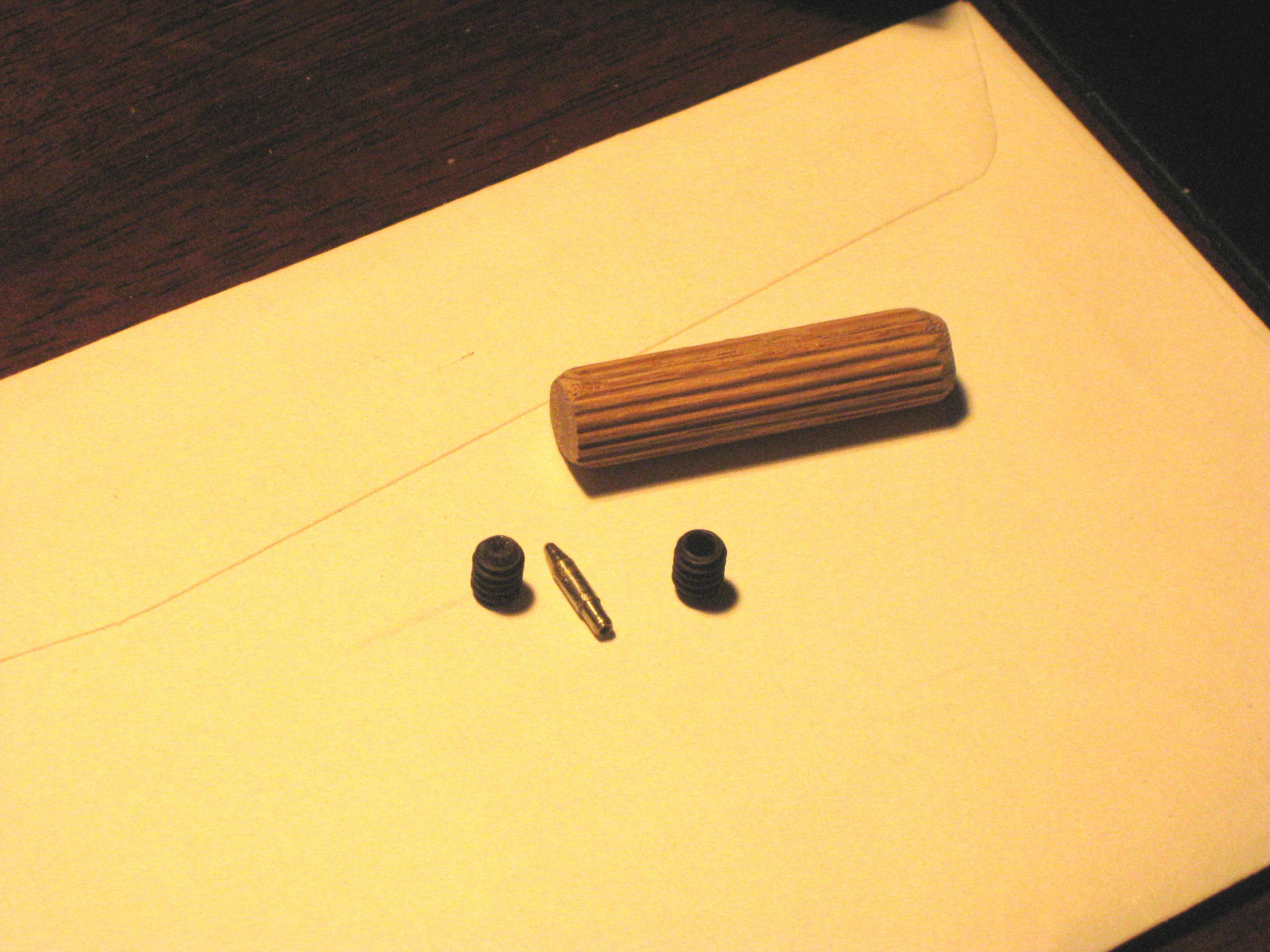

the complete bearing ...
is a set screw (2 pictured), a pen nub (pictured), and a short piece of the appropriate diameter of dowelling (the one pictured is approximately 2" or 51.4 mm long). Make sure set screws are used and not pipe plugs.
I pre-drill the arm wand (one hole only). I pre-drill the dowel completely through to allow the set screw to be screwed into but allow the bottom "cup end" to be exposed. I then use urethane glue to glue the dowel/female cup assembly into the arm wand, adjusting it so as to allow the pen nub to come in contact with the female cup from outside of the tube. That's it.

Thanks nanook for the clarification. One question - does the set screew have a perfect cup or do one need to drill a better one?

Turbon: QUOTE]One question - does the set screw have a perfect cup or do one need to drill a better one?[/QUOTE] The set screws I use are referred to as "cup point set screws". The cup as is, works perfectly with a 1mm ball point pen nub (medium or medium fine point). I know the picture is a little tough to see.
