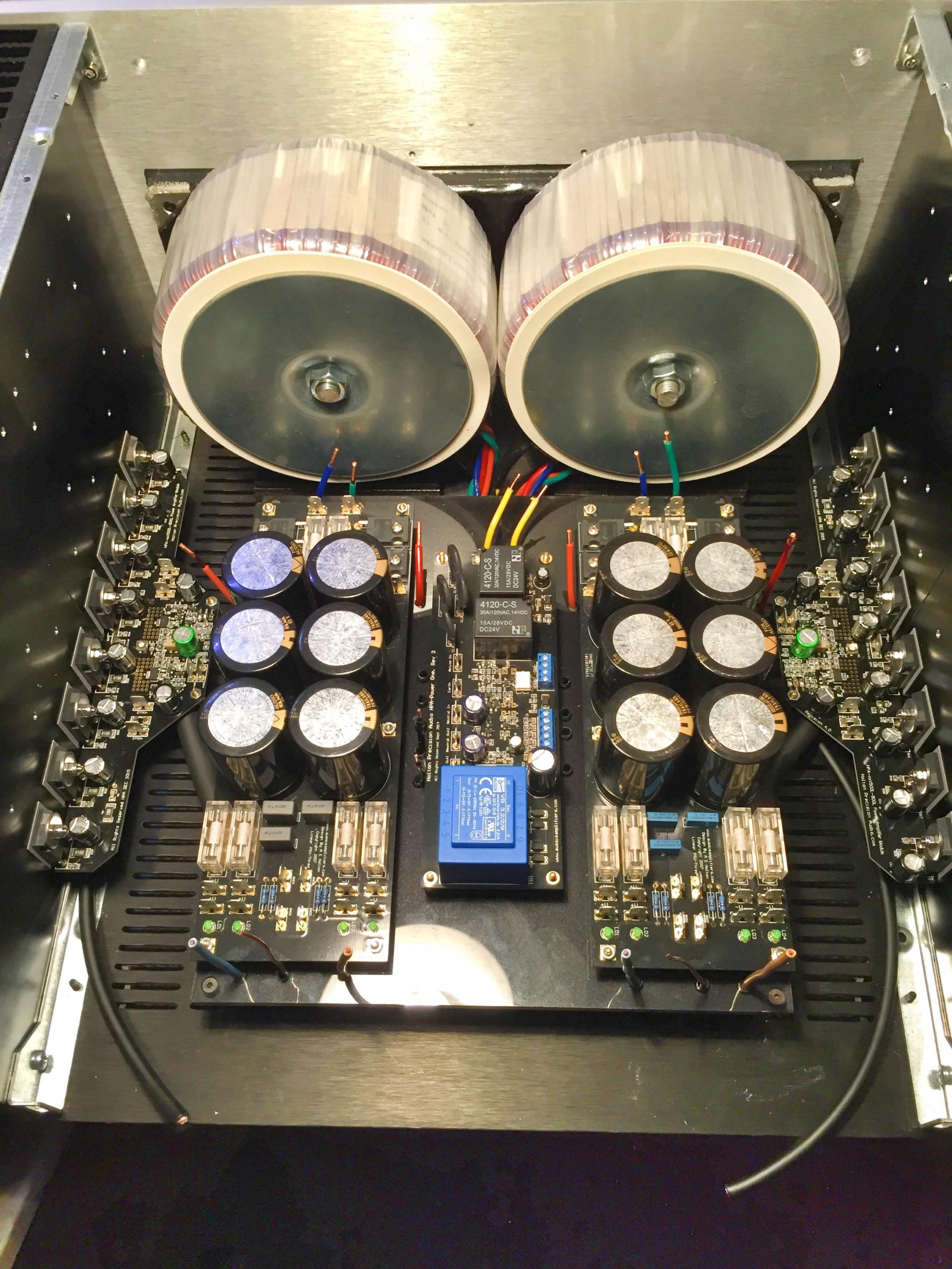

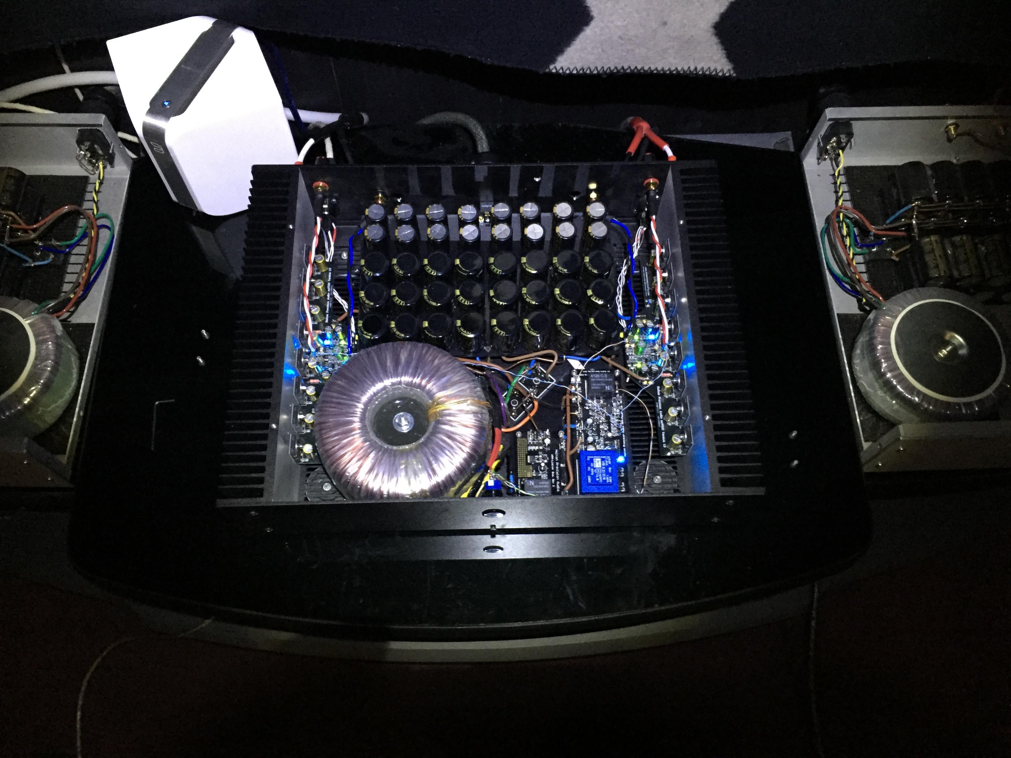

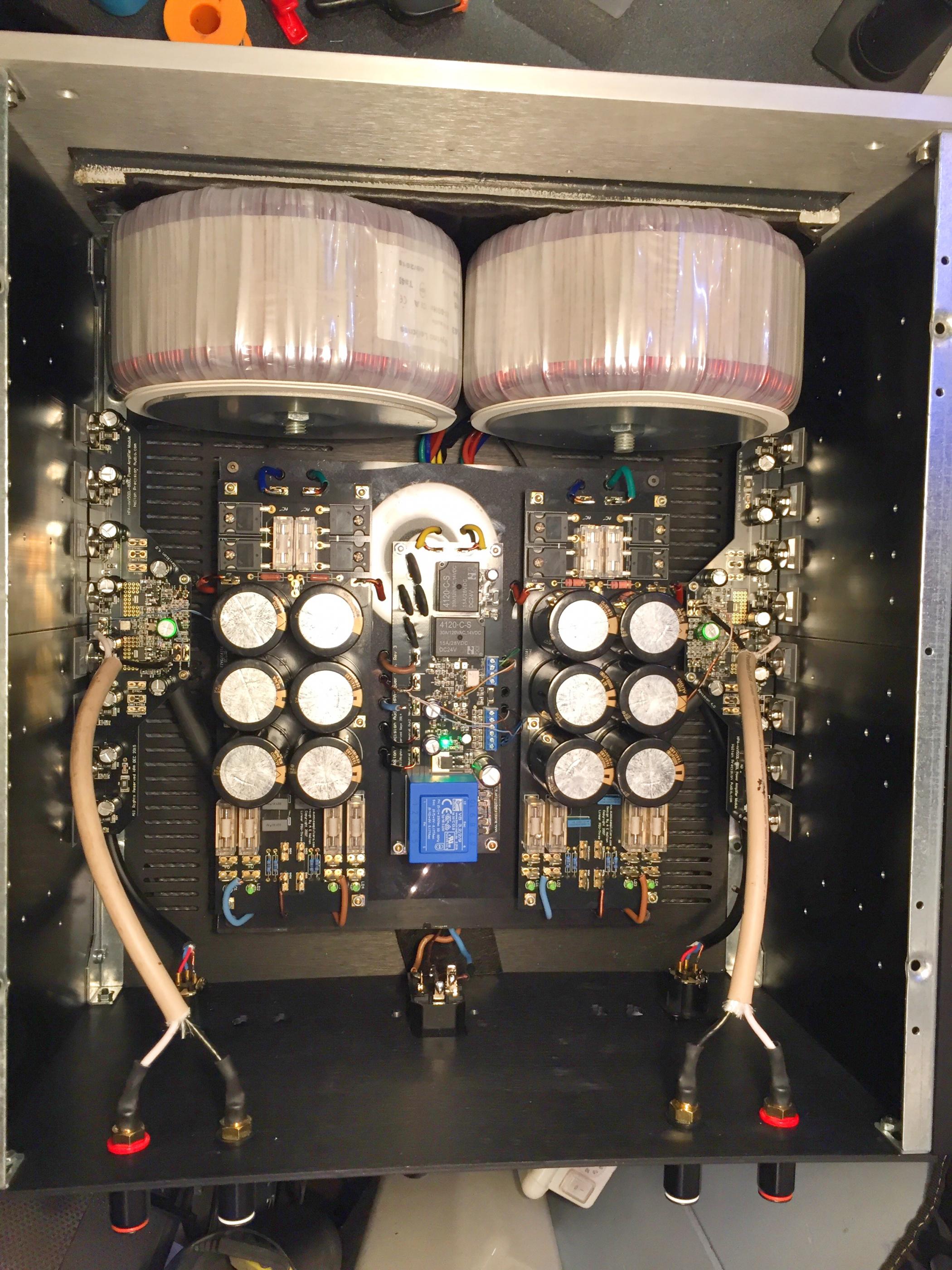

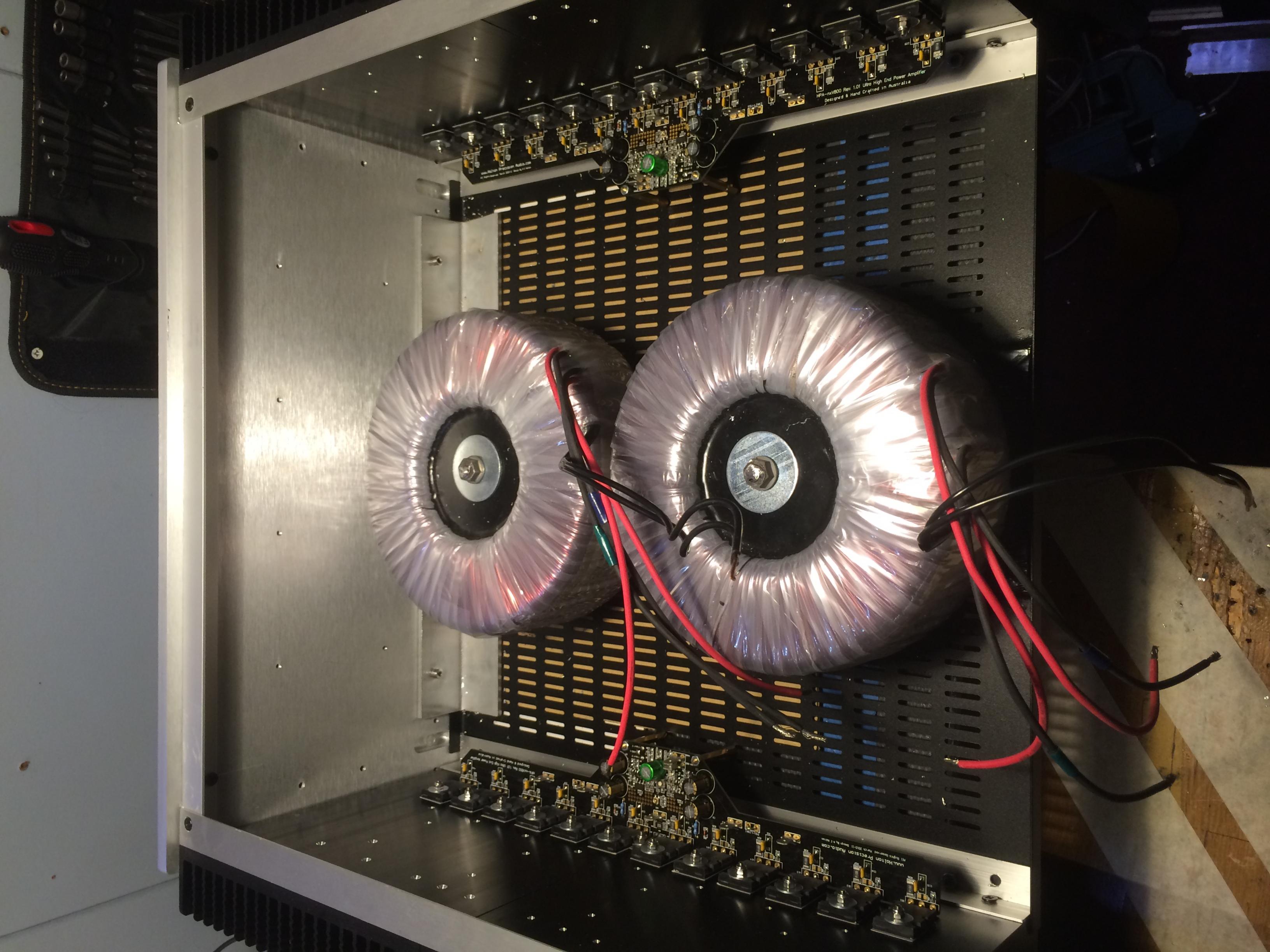

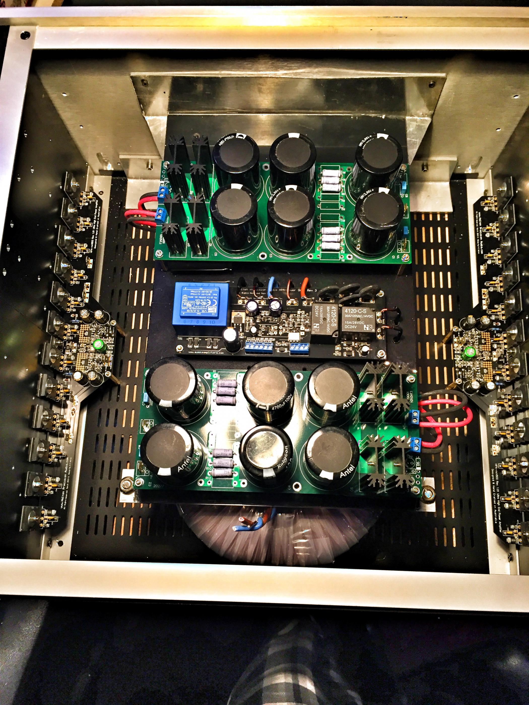

The Holton 500V1 is now playing, first impression is very good as alway with Holton amps.
Holton chassis.
Toroid from Adyton XP3D 1000VA 2x56V.
Psu is a mix of Roe 2200uF 100V and Nichicon 2200uF 100V 20 pc for aech side giving 44000 uF for each channel.
PowerOne v2 and soft start,
Neutrick gold Xlr. VanDamme xlr mic cable.
Gaofei speaker terminal wit MIT T2 cable.
Al power cables is solidcore 2,5kv.
Holton chassis.

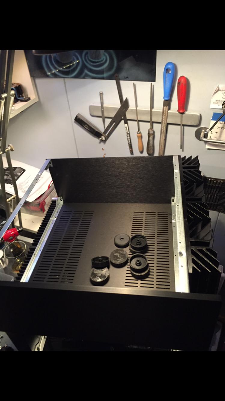

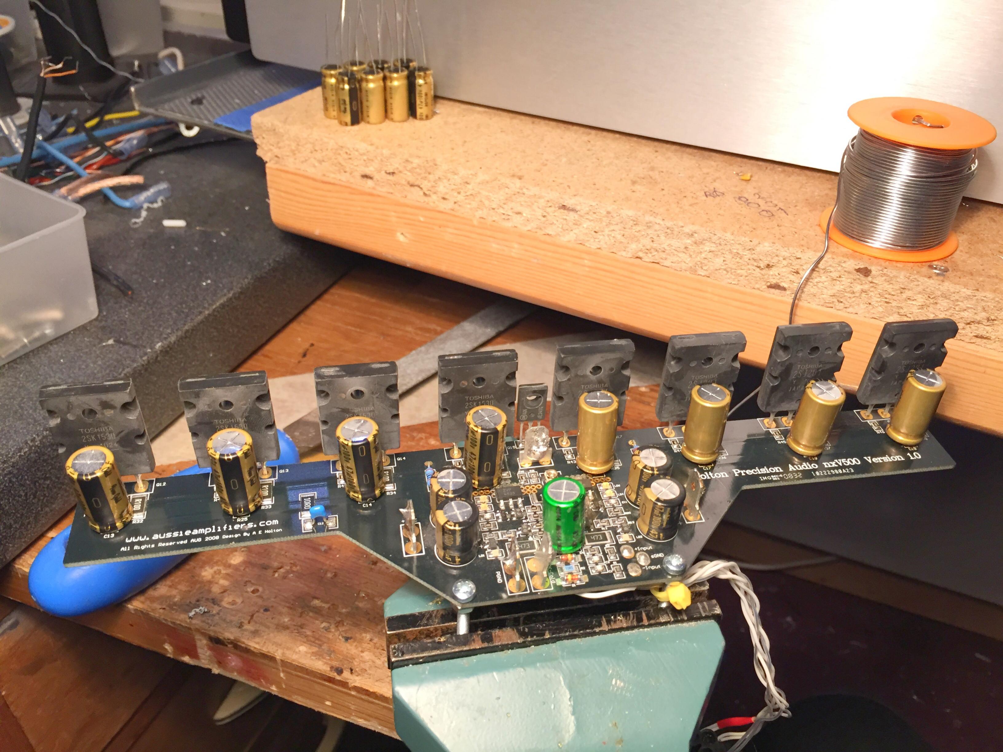

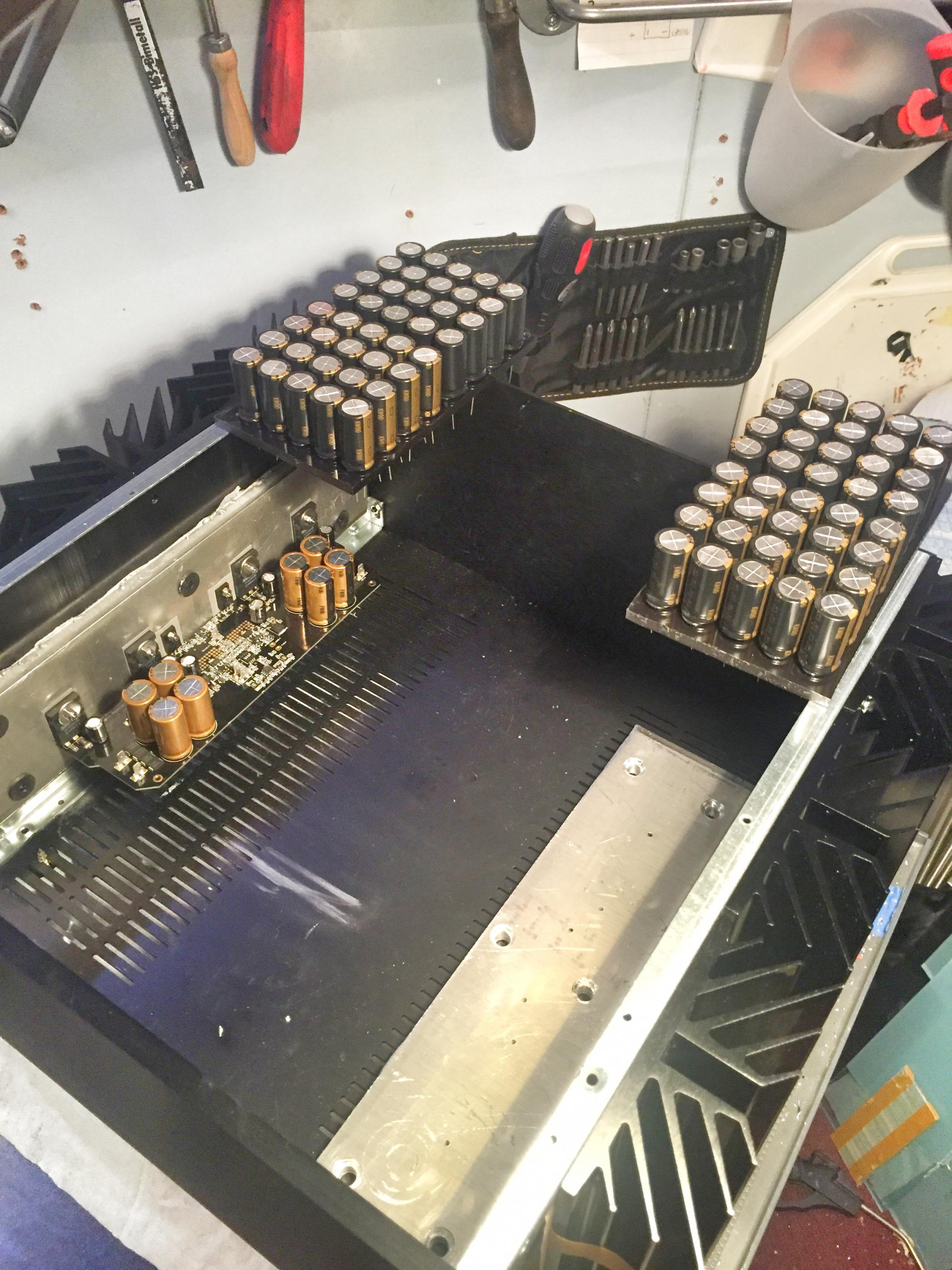

Besides the 500L work i have started on the 50L chassis

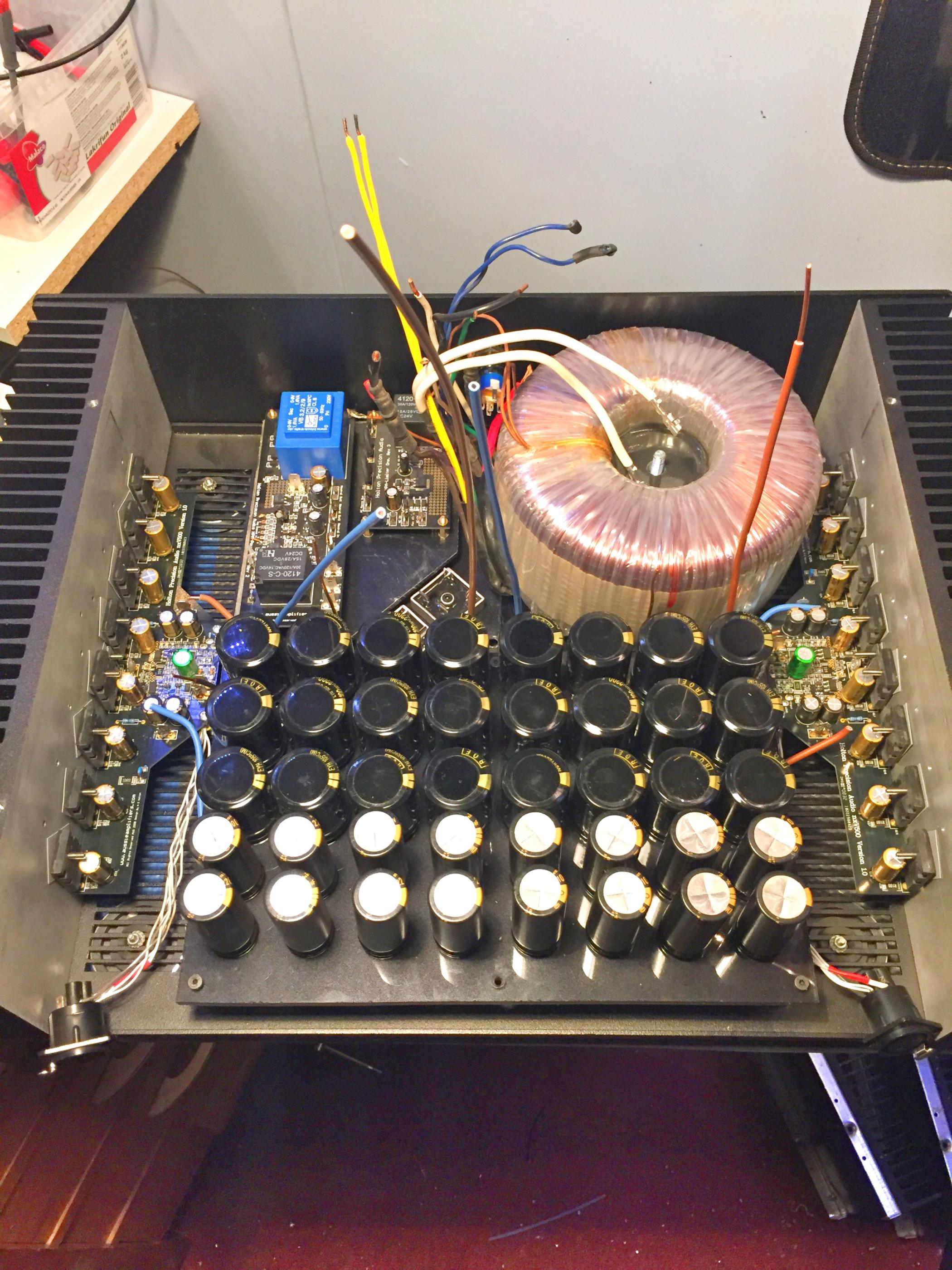

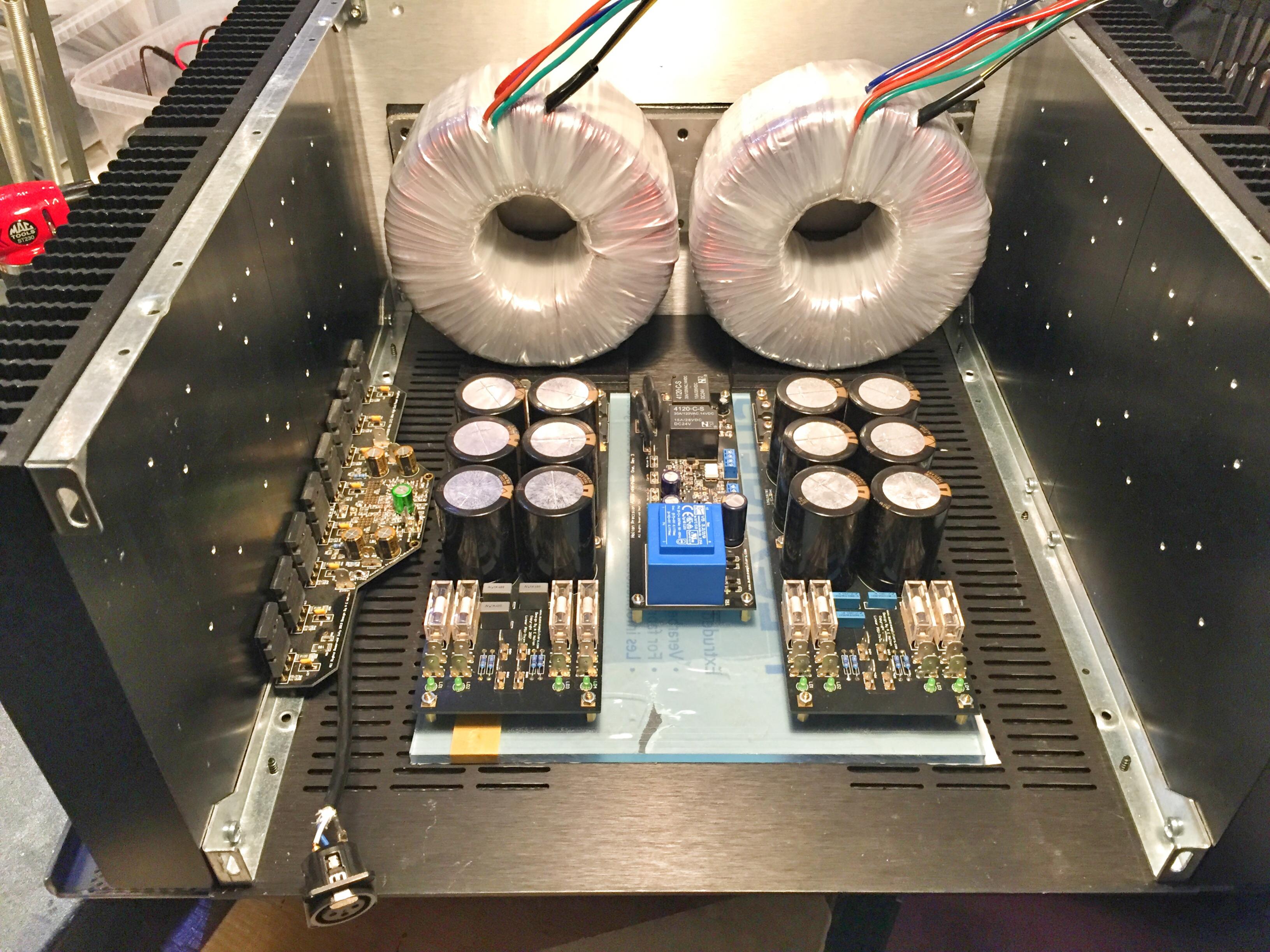

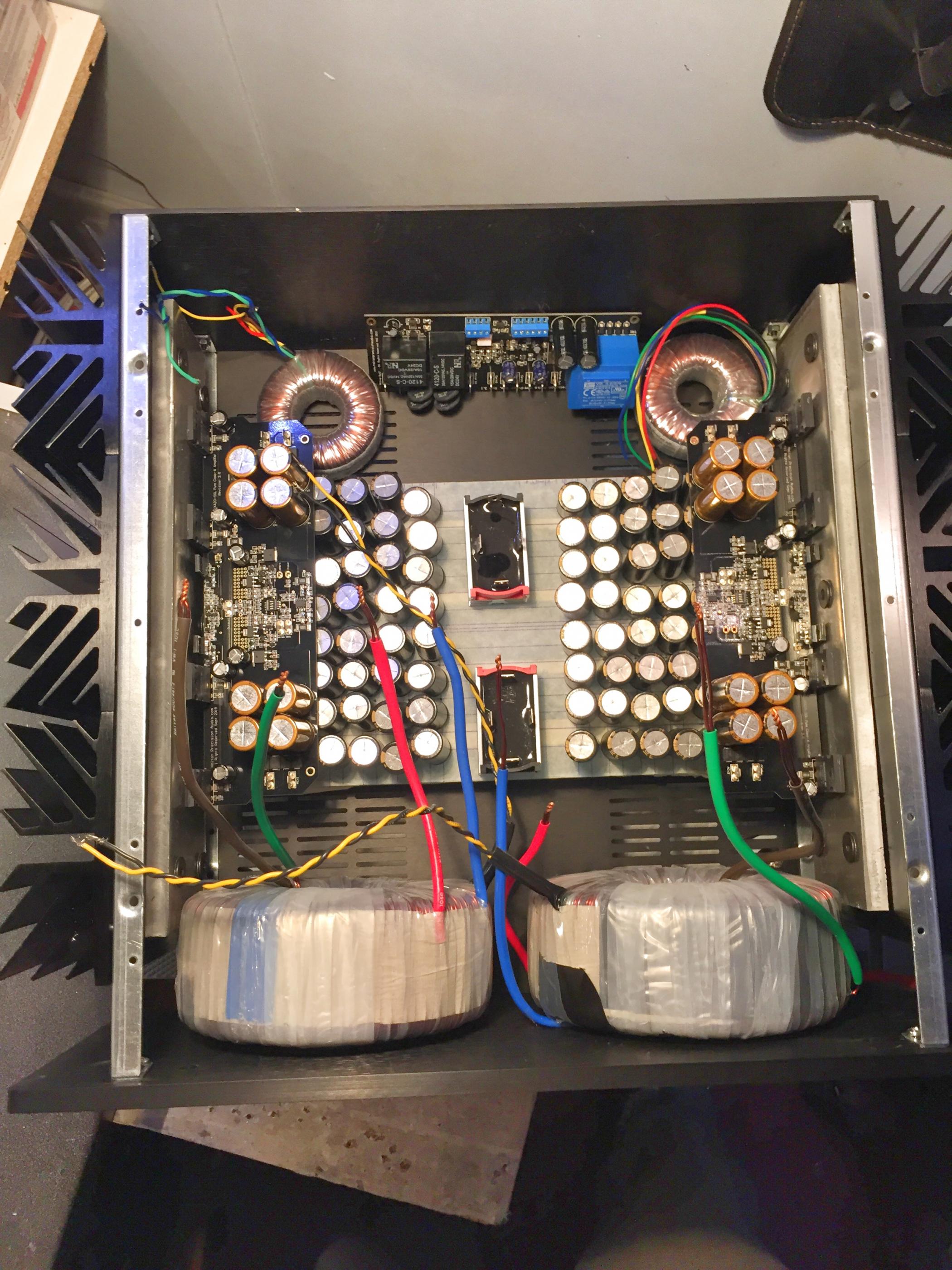

Some more work on the 50L, thrown in some stuff to see if there is room for everything.
2x50L boards.
2x 630VA 2x25v
2x 50VA 2x32v
40pc Nichicon KW 2200uF 63v for each channel.
PowerOne
And som more stuff.
As usual al solidcore for ac and supply for the amp board.

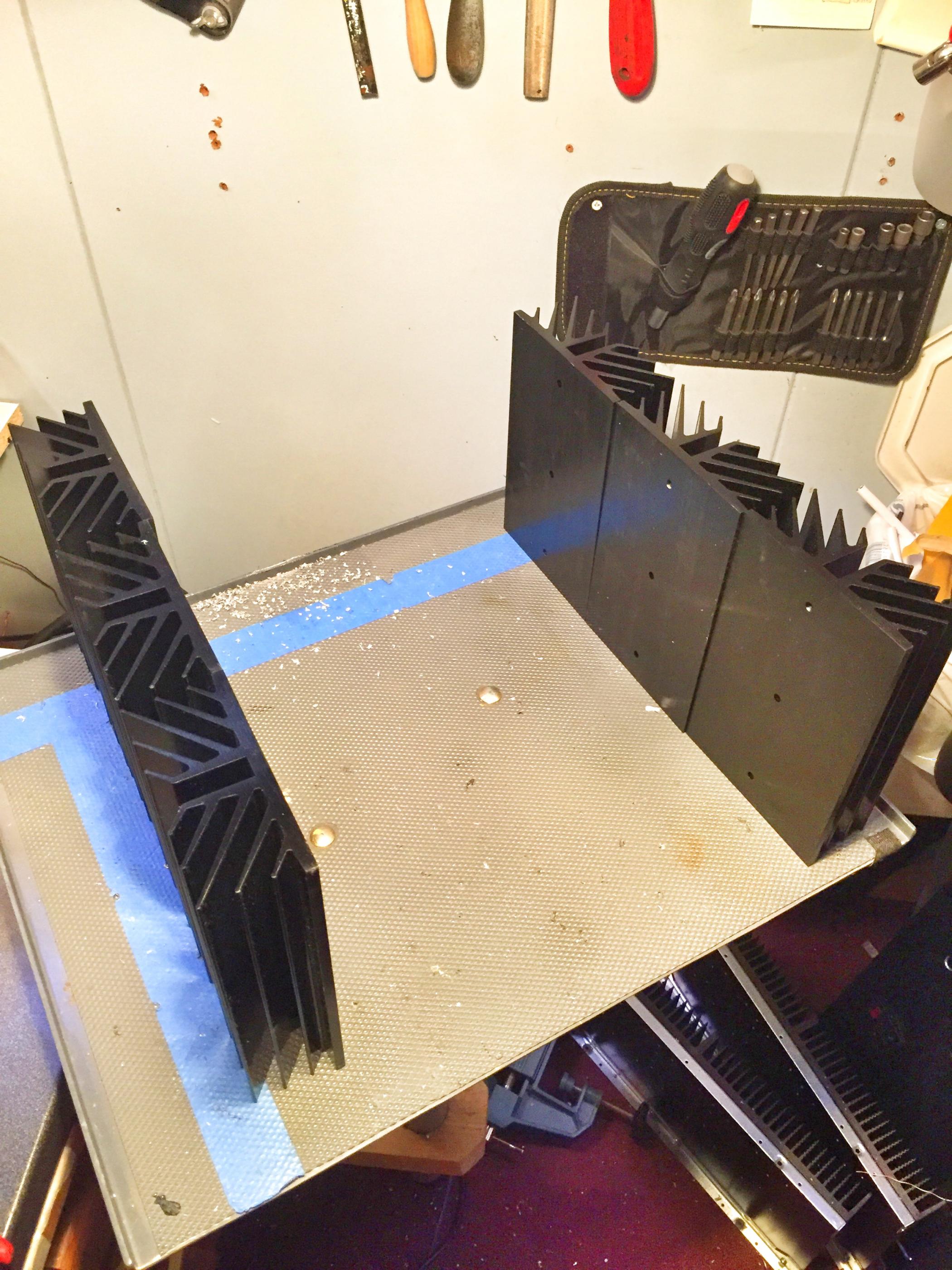

The chassis is a 4U modushopp with Pass look heatsink.
3 heatsink for eatch channel each is 12cm wide, 18cm high and 6,5 cm deep.
