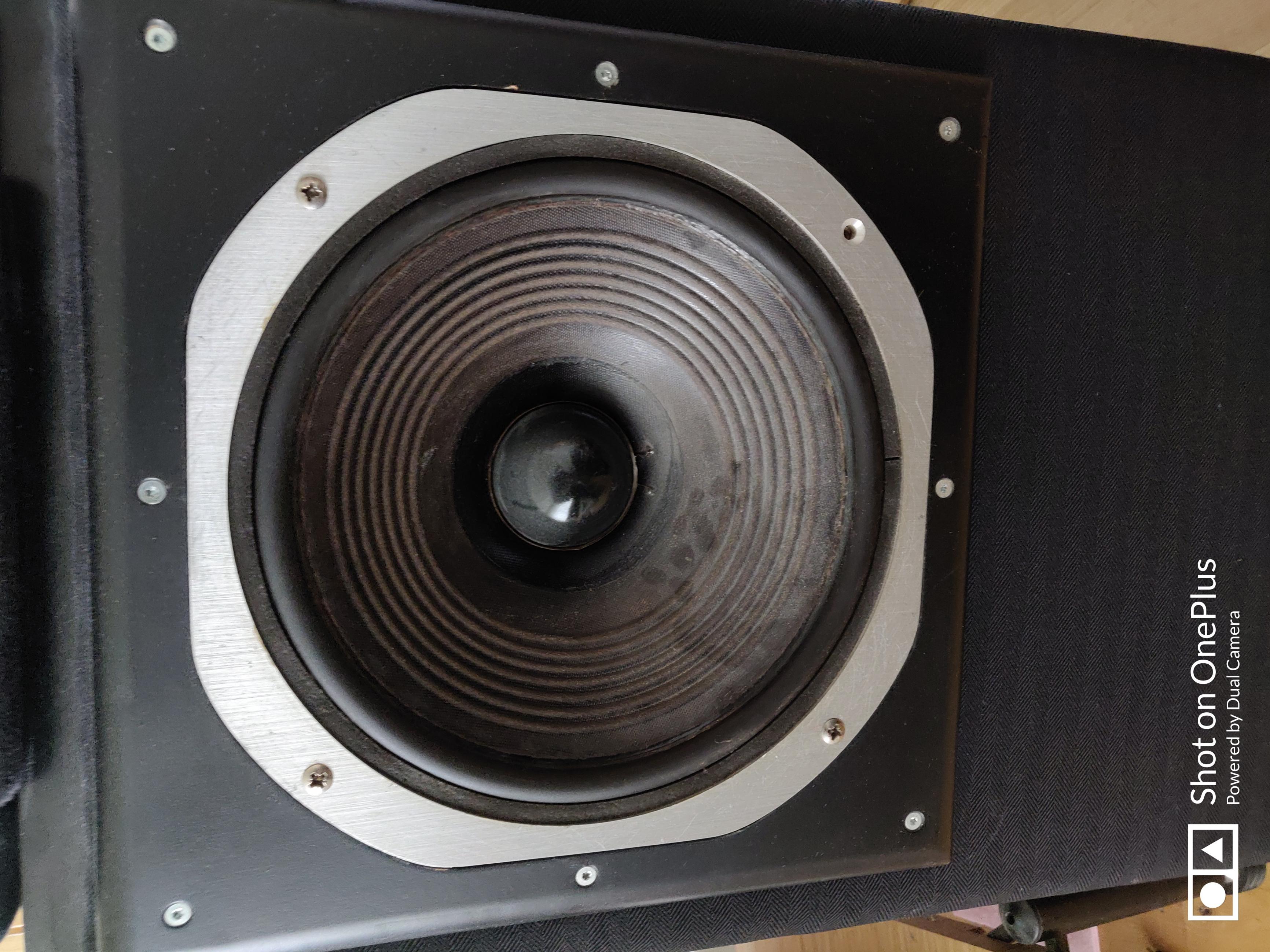

I wouldn't describe my NXL200R4 build lacking in bass either, especially now I can hear it with the clarity of a pair of 804 D3's. It seems tight to me.
I was trying to get some clarity from Erlend Sæterdal regarding his "bad bass" statement.
I have closed system with low Q bass and low resistance coil. A boom boom basreflex system will off course play different.😱😉😀
You're missing a screw....
You are right it can not be mounted anymore. The trea is destroyed. But now I will rebuild it with a new frame. Also use a new and better bass with carbon membrane.
