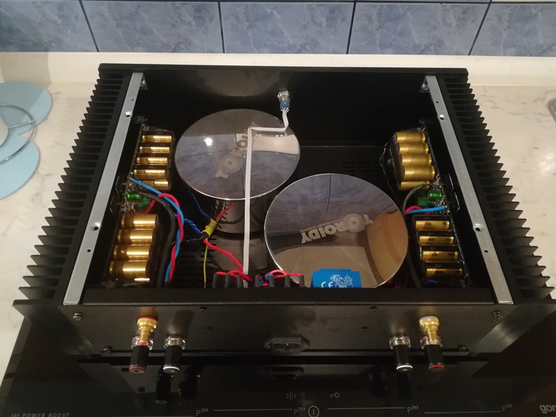

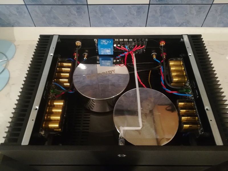

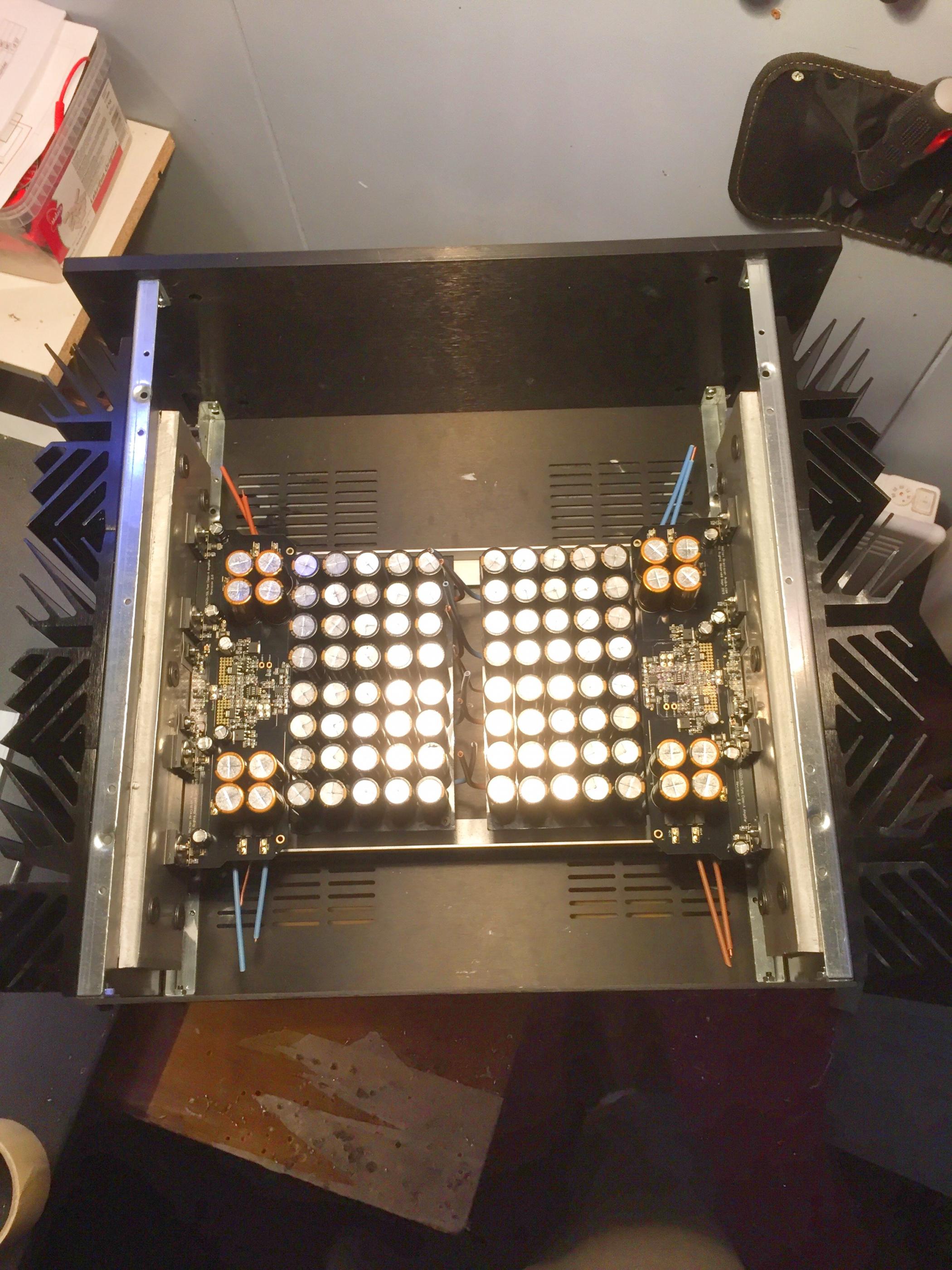

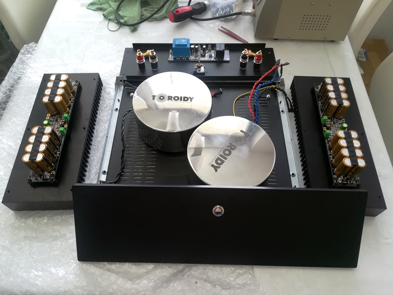

My Holton amp builds.

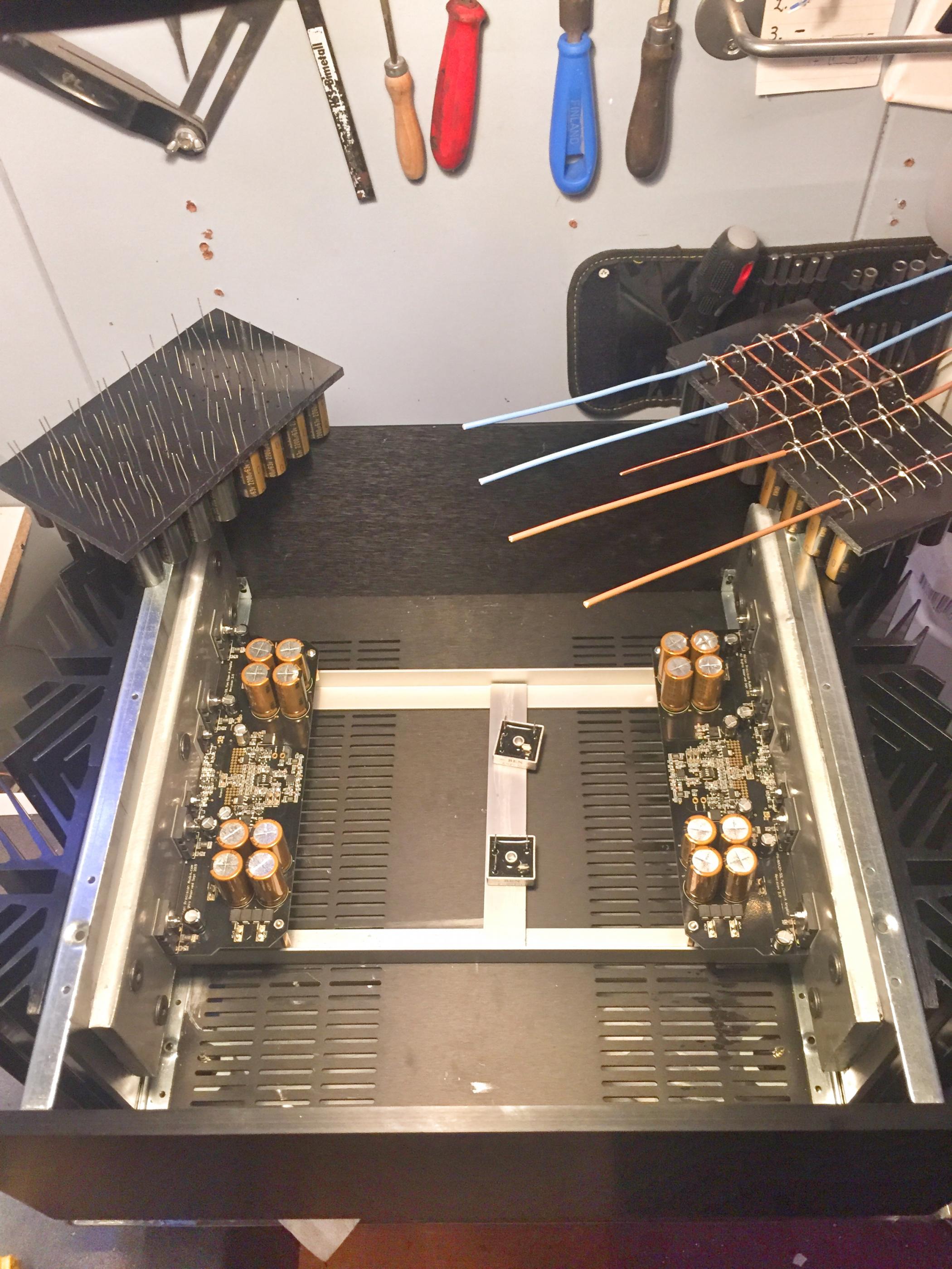

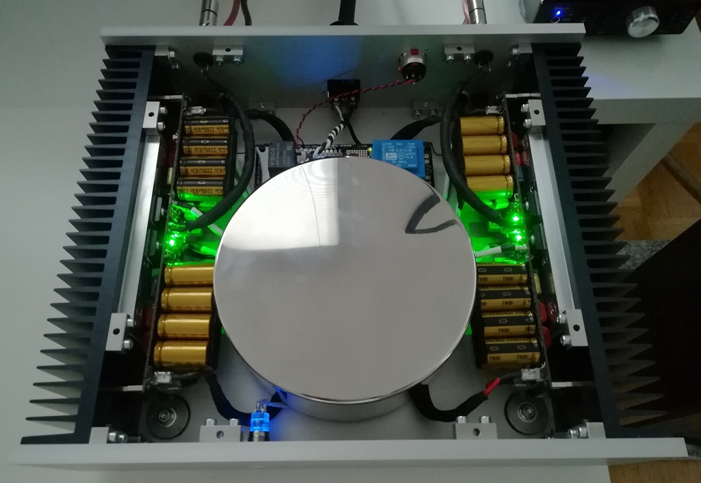

Both amp boards mounted to the heatsinks and one of the capacitor banks soldered.
The aluminium rods is to hold the cap banks without the bottom plate so i can solder the power cords to the amp boards from the underside.

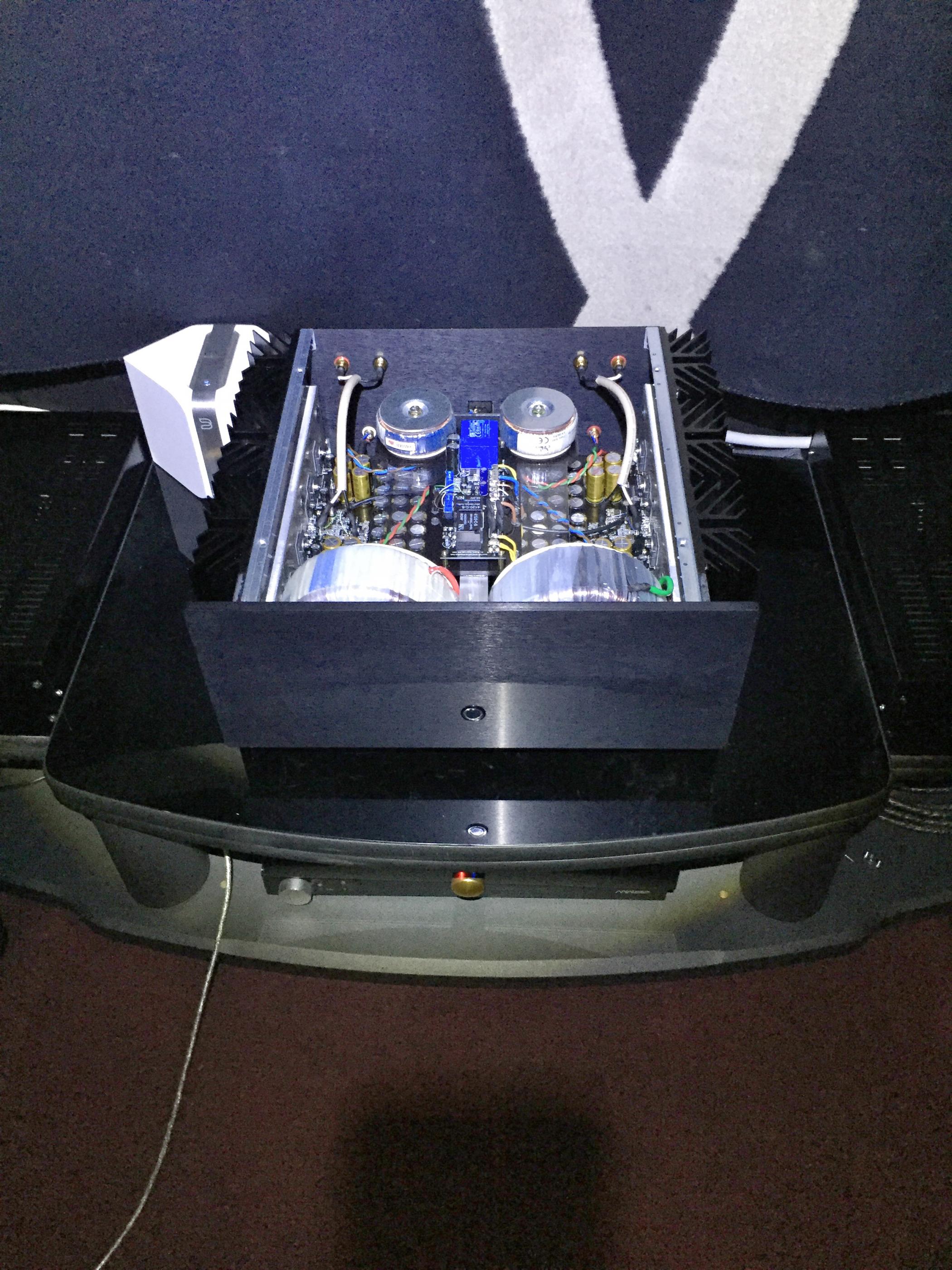

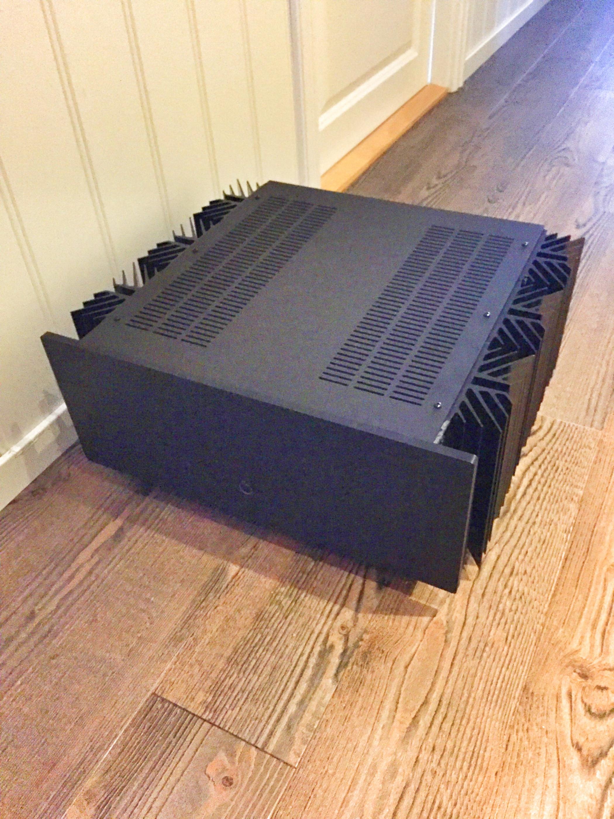

This is my lates build with 800L boards.
VoltOne
PowerOne
PsuTwoo with Nichicon 2200uF 100v KW
1000VA 2x60v
60VA 2x65v
The smal Pass look chassis from doukmal on ebay.
VanDamme xlr kable.
Monster Powerline II speakercable.
Neutrik gold xlr.
Speakerterminal from seller gear_city

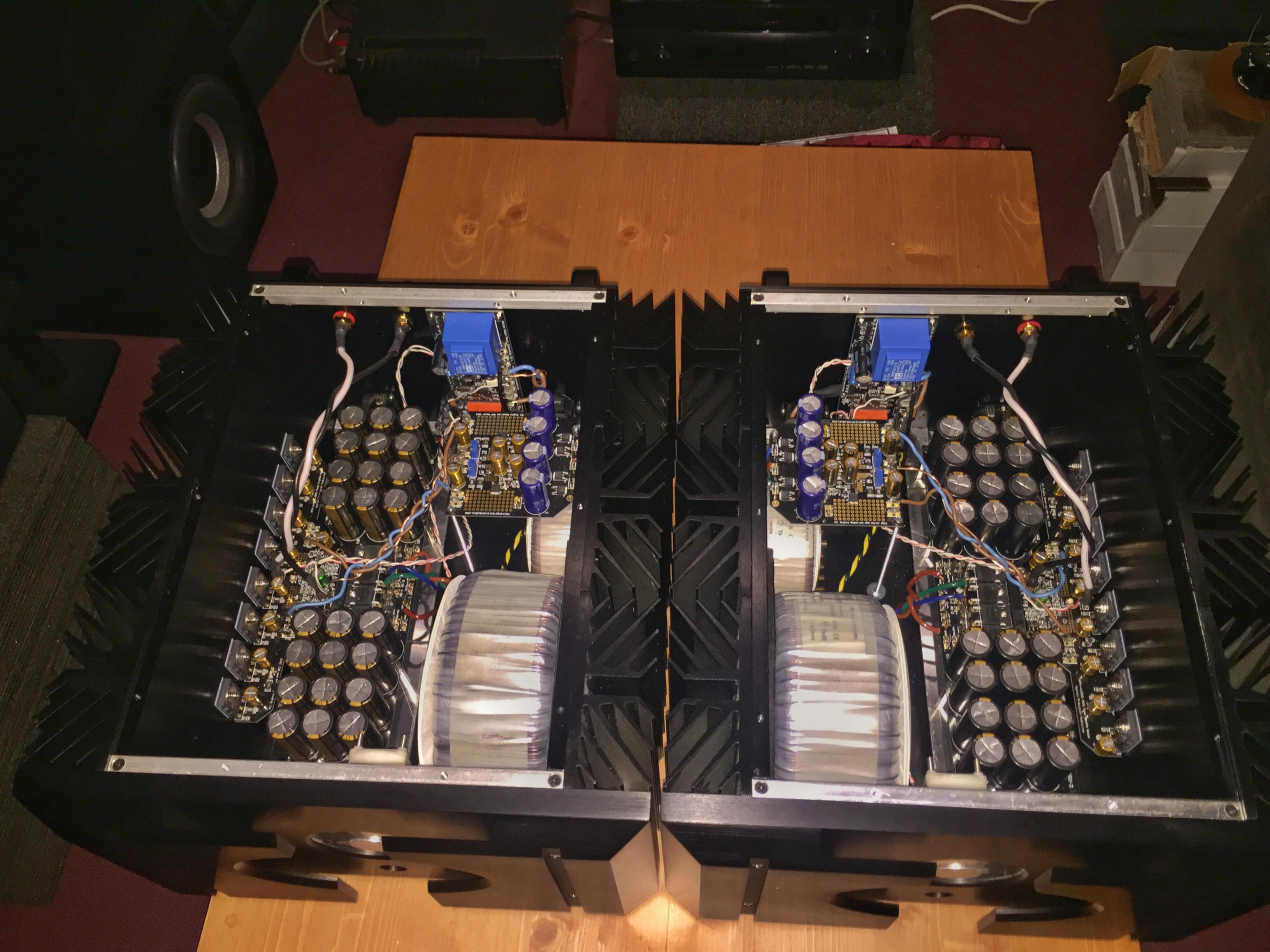

Thank you Anthony.
I must confess that i was just built your amp... Tried it technically and hear some music trought my small test speakers for safety reason from past. Because of abssent from home i can try it seriously in next days. Btw. Modules are very good production quality and smart design. Assembly is quite simple even for Diy members with less electronic skills. Almost no soldering, just plug and play.
Nice greet Davorin
Amp in action. Sings really beautiful. At bias set to 360mA, it plays extremely rock stable, full and wide in all dimensions.
Everything is on right position, very fast amp but not harsh or thin sounded, more on soft side. Very satisfied. I have done 2 version from FO (1.2 and 1.3) amp, and try it at my place but this amp is much more musically to my ears. More fuller sound more realistic timbre, and not so dry sounded. Excellent design.

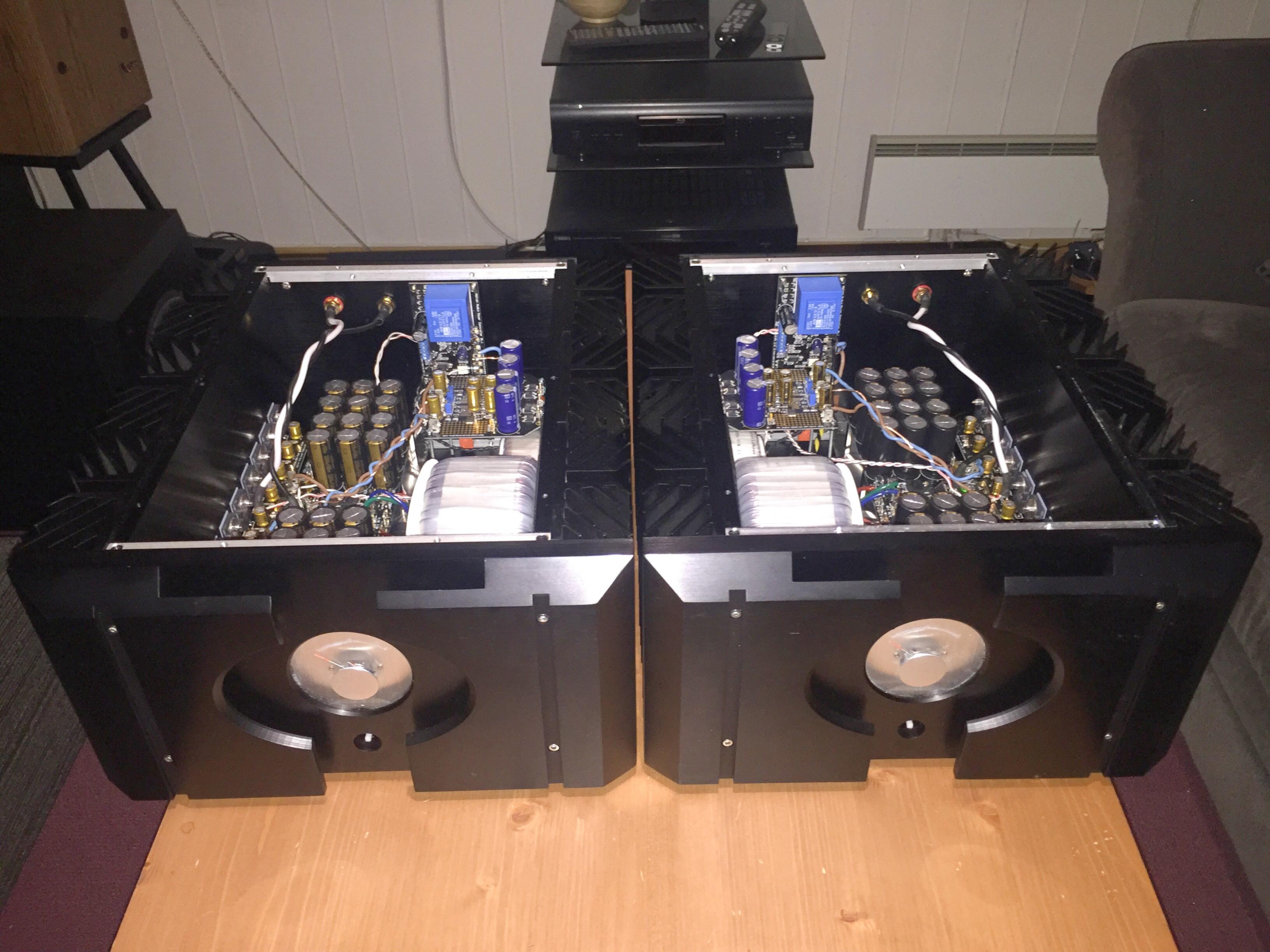

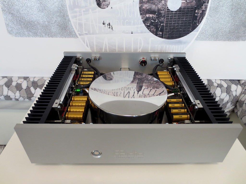

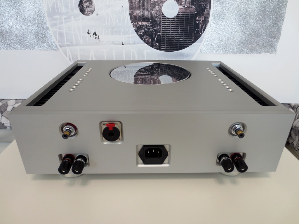

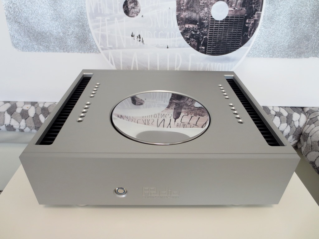

Another amp is built , this time with some mods.
This amp is really amazing...that is all i can say.
