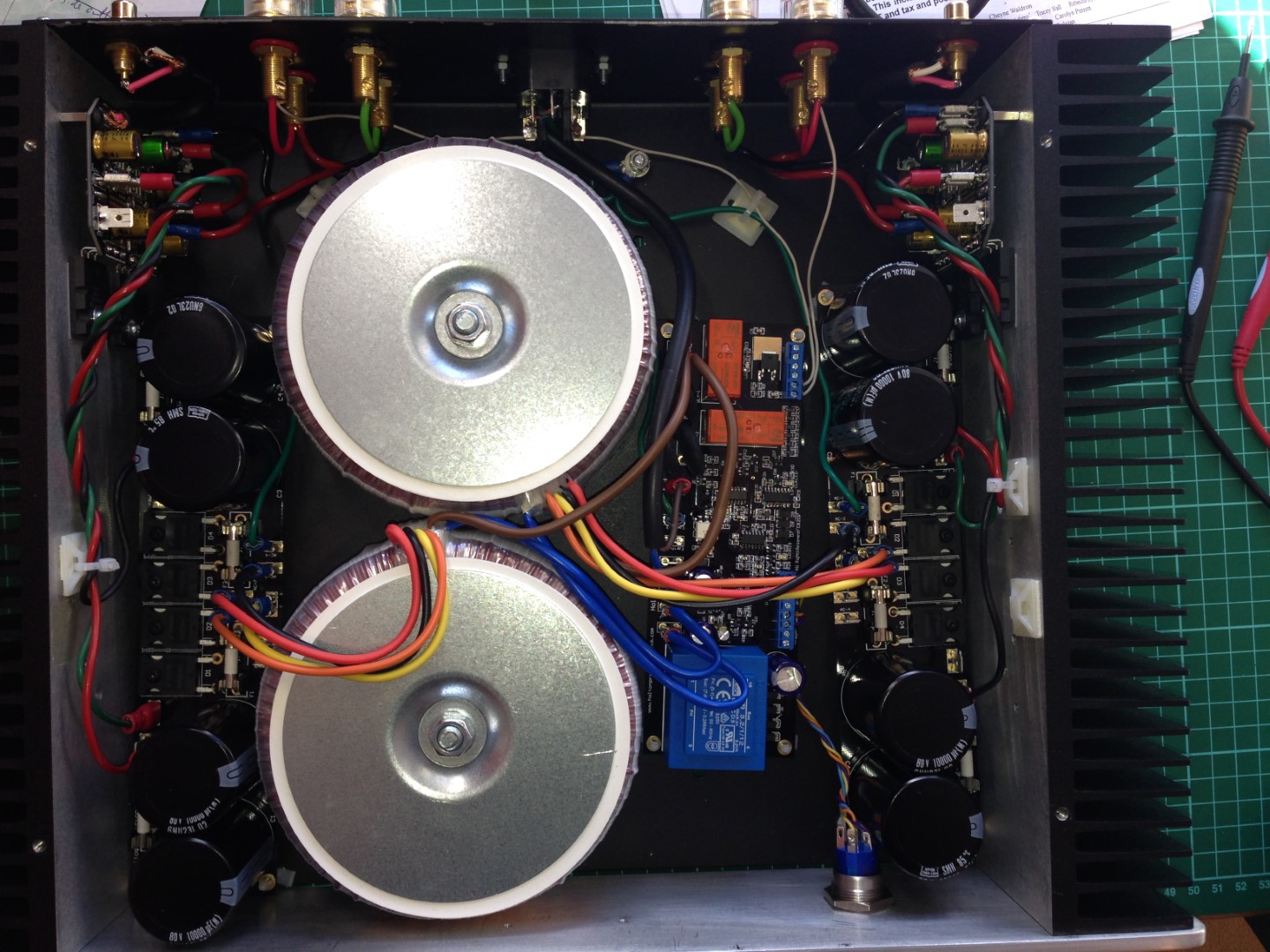

This is my second only ever amp build and first Holton build. First amp was an SKA but could never solve a right channel humming/buzzing issue.
I know the chassis space is a bit small so it's crammed in a bit.
NXL-200 R4 dual mono block setup
AC mains controller
2 x NXVPSU-one
2 x 500VA 2 x 45Vac toroids (yes a little overkill on these but the closest I could find in NZ).
Running from an arcam dv-139 through a Parasound 2120 HT bypass preamp so this power amp does double duty in a 2 chan/HT system pushing ampy type stuff into some B&W 804 D3's!!
Sounds very good but I'm never satisfied so I'm looking at upgrading this build. First thing is a nicer chassis with more room, then after that not too sure.
Bias - Currently running at 200ma - I have no idea where the best sounding spot is, but I have enough heat sinking to go up to the 300ma limit that Anthony has indicated as being the max.

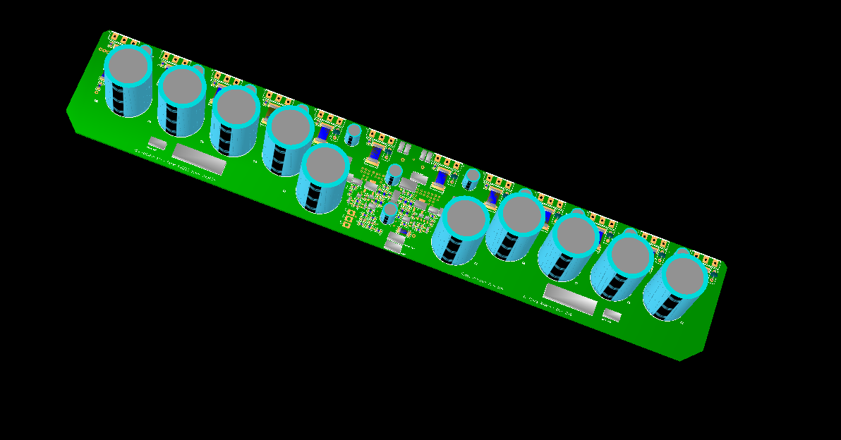

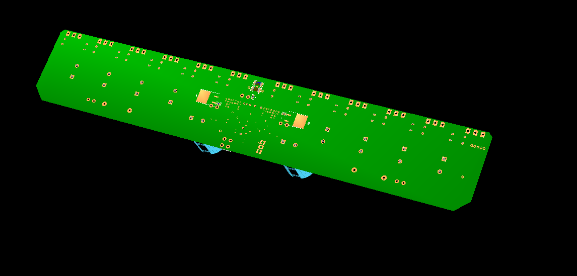

Hi Guys
Here is a new amplifier module I have developed its a very large module
that uses 12 dual die lateral mosfets, has a new mosfet pre-driver stage to handle the increased number of output devices and provide excellent bass control. The pre output driver stage is shown mounted on the underside of the main PCB.
It measures 363mm long and 63mm wide.
Power output can be as high as 1800 watts into 2 ohm loads and yes it will handle much lower impedances as well when used on lower supply rails.
