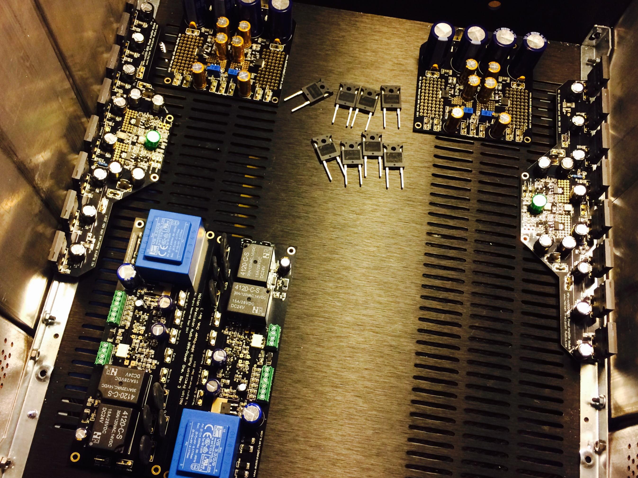

800L boards in order 🙂 Volt One and PowerOne3.0.
Building a dual mono stereo amp.

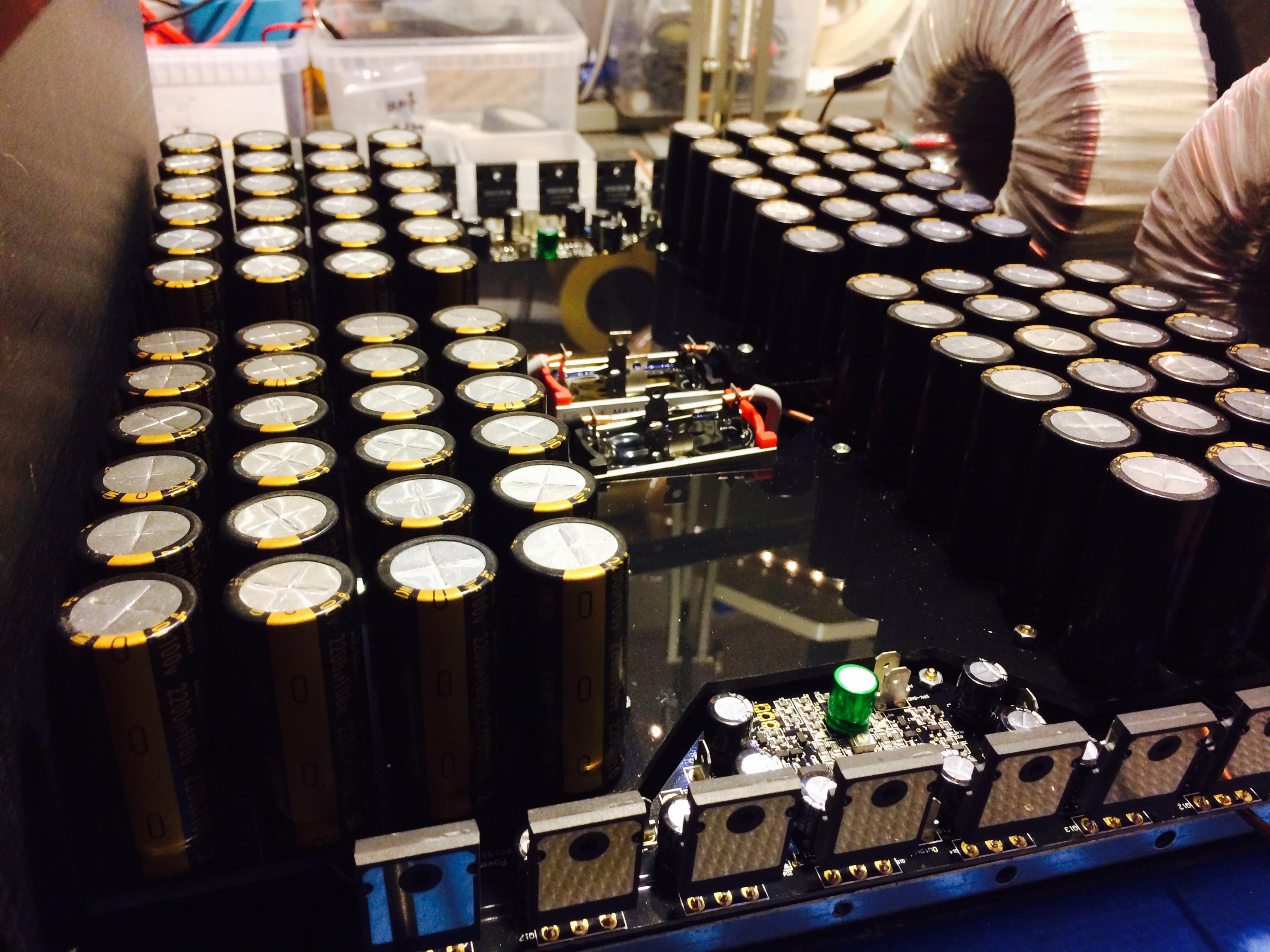

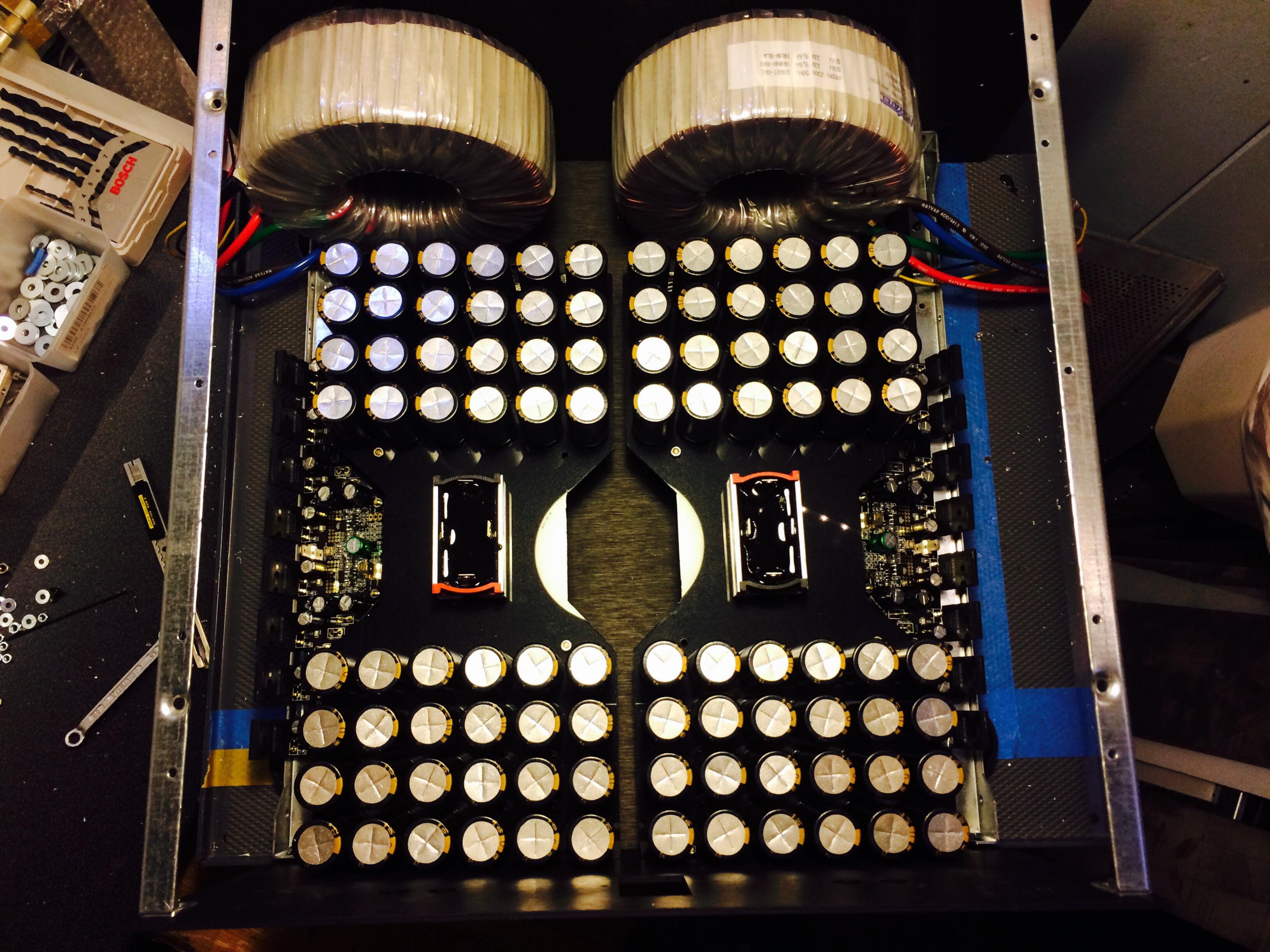

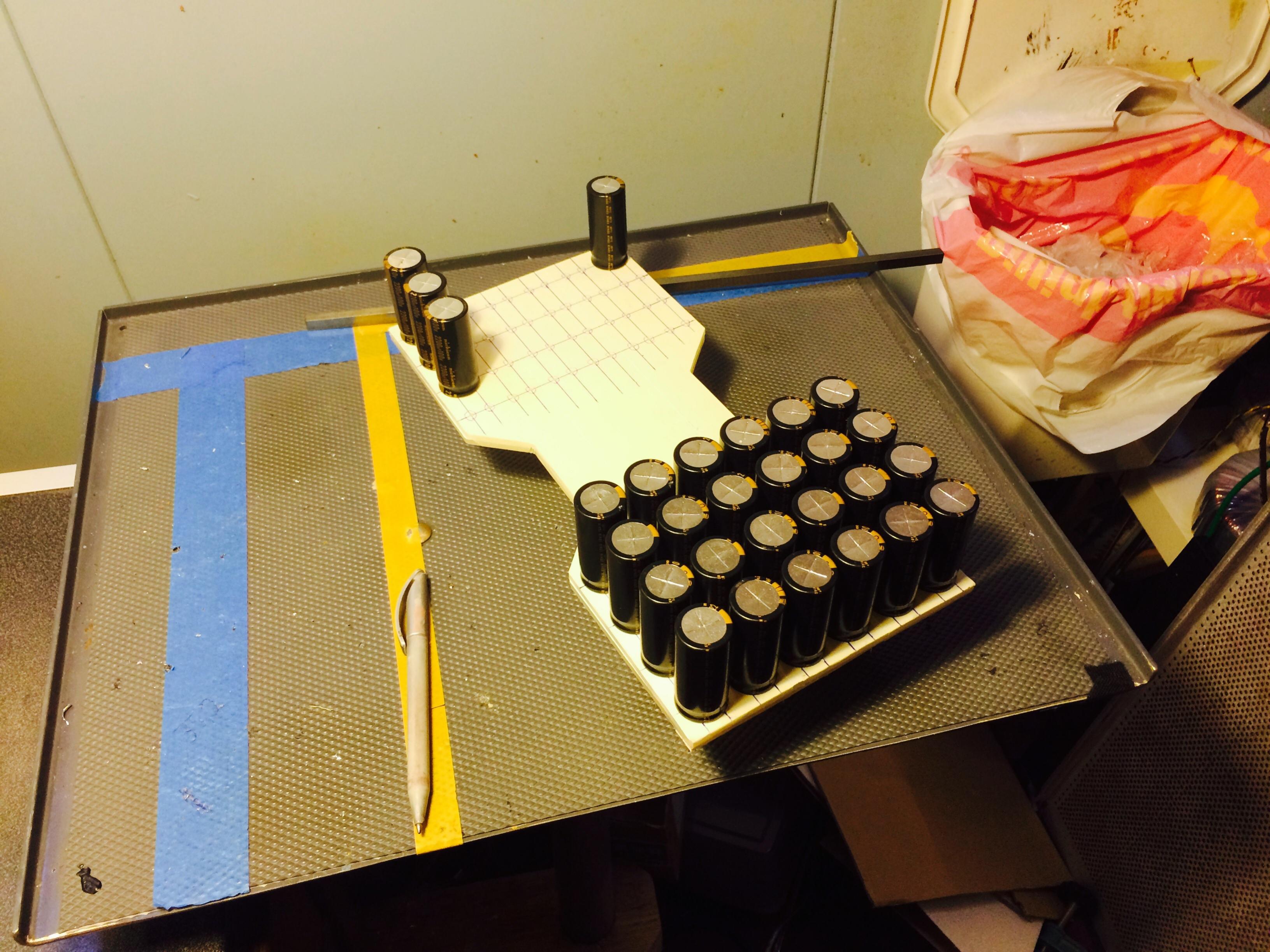

Inspired by Holton and wanting to make the capacitor bank nicer im using plexi glass and drill holes for the cap.
48 pc 2200uF 100volt Nichicon KW for each channel.

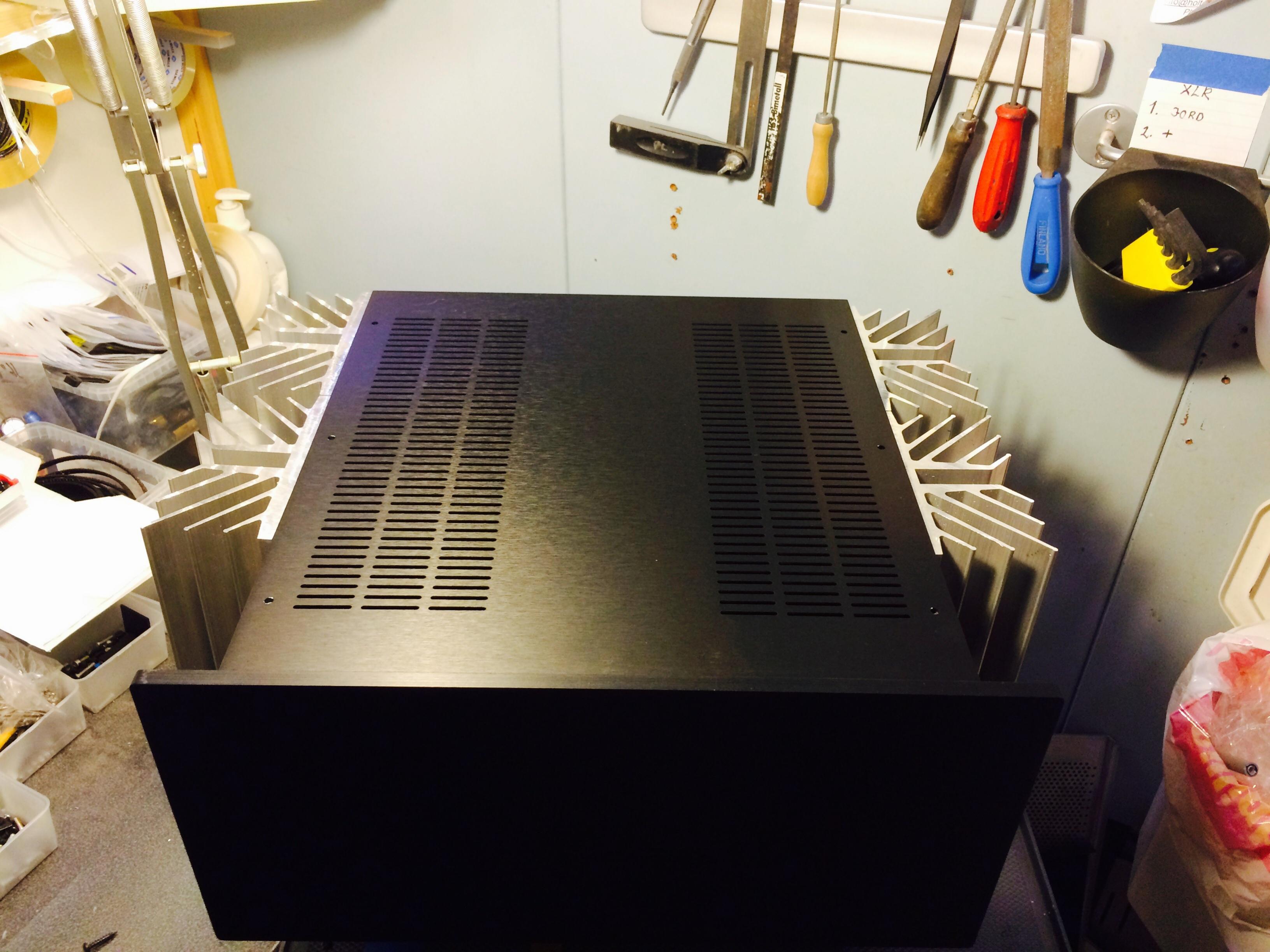

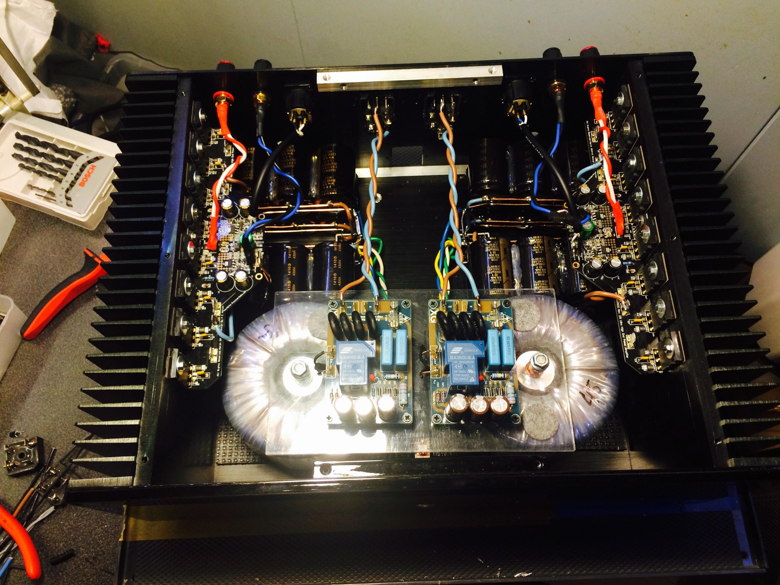

Putting togheter a low budget 500R2 dual mono.
Used enclosure, used 500R2 and used toroids from Thule PA200 monoblocks
2 x 500VA 2x45 volt.
12 pc 10000uF 80volt Roe for each channel.
Soft start modules from Jims Audio.
Geofei binding posts.
Neutrik Gold xlr.
Cheap iec w switch and fuse.
Al ac is 2.5kv solid core cooper.
MIT speaker cable.

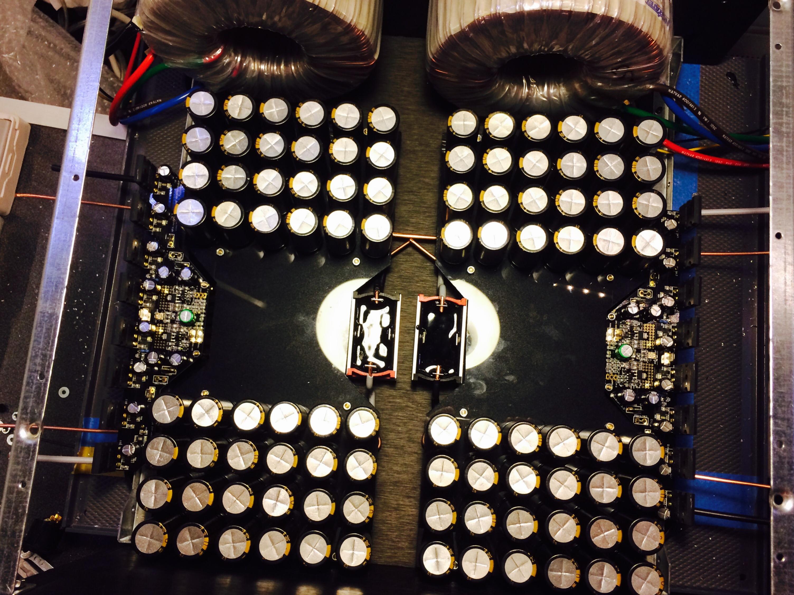

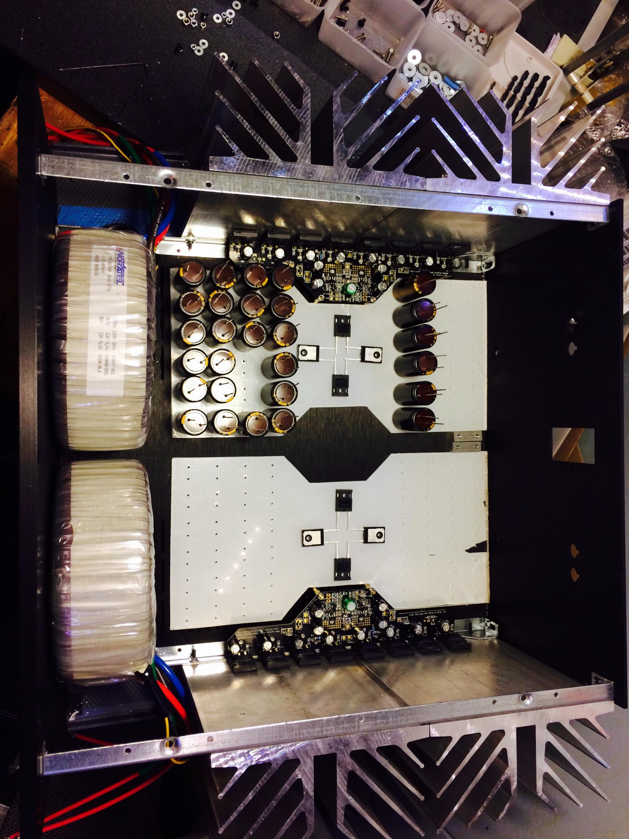

Some caps hase arived 🙂
48 pcs Nichicon KW 2200uF 100 volt for each channel.
In first rounde im gona use toroids with 33 volt ac, and high bias. If that doesent work out very good im using toroids with 60 volt ac.
