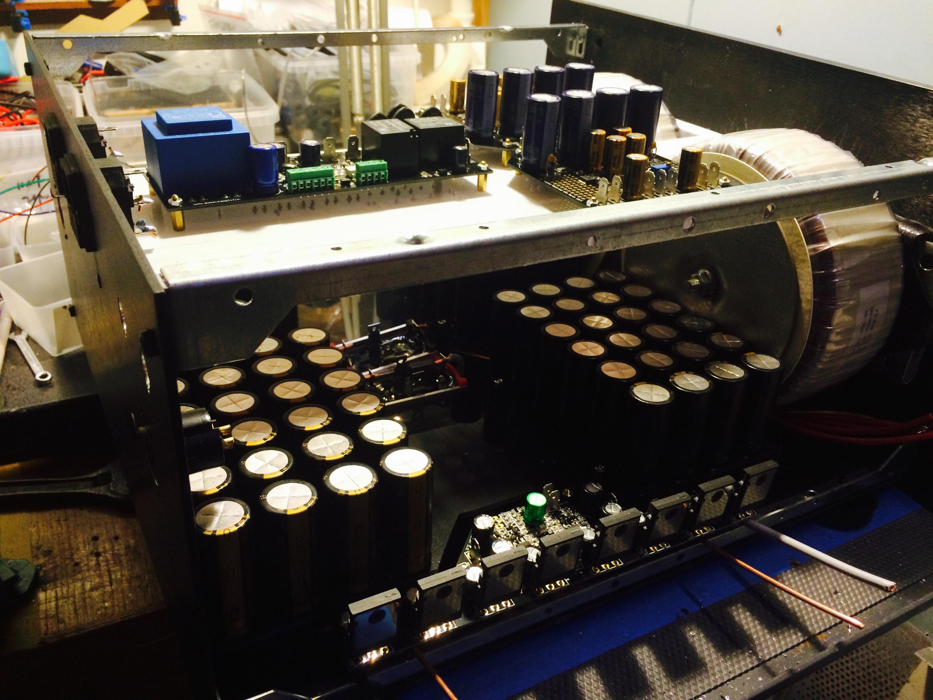

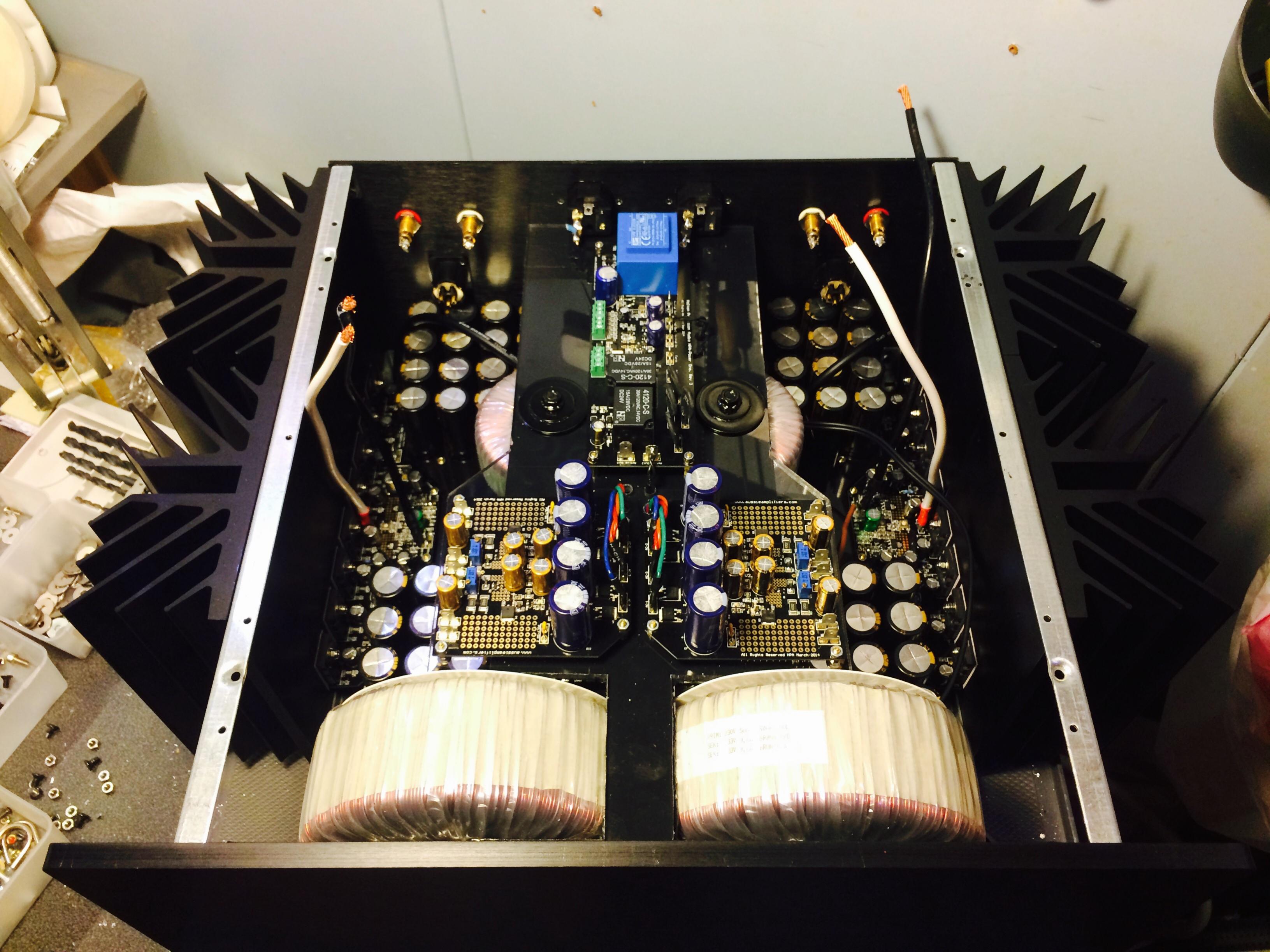

All your work will pay of. Just finnished a 800 L stereo version and the sound is magical. First time ever I can play old mainstream with beautiful sound. 800 L is the best amp I have heard so far. Have not changed the preset bias at all. Not even measured it. The heatsinks temperatur felt by hand tells me it is ok. But a bit hotter than R 2 versions. Next week I will begin the NXV 1200 LE. Could that be even better?

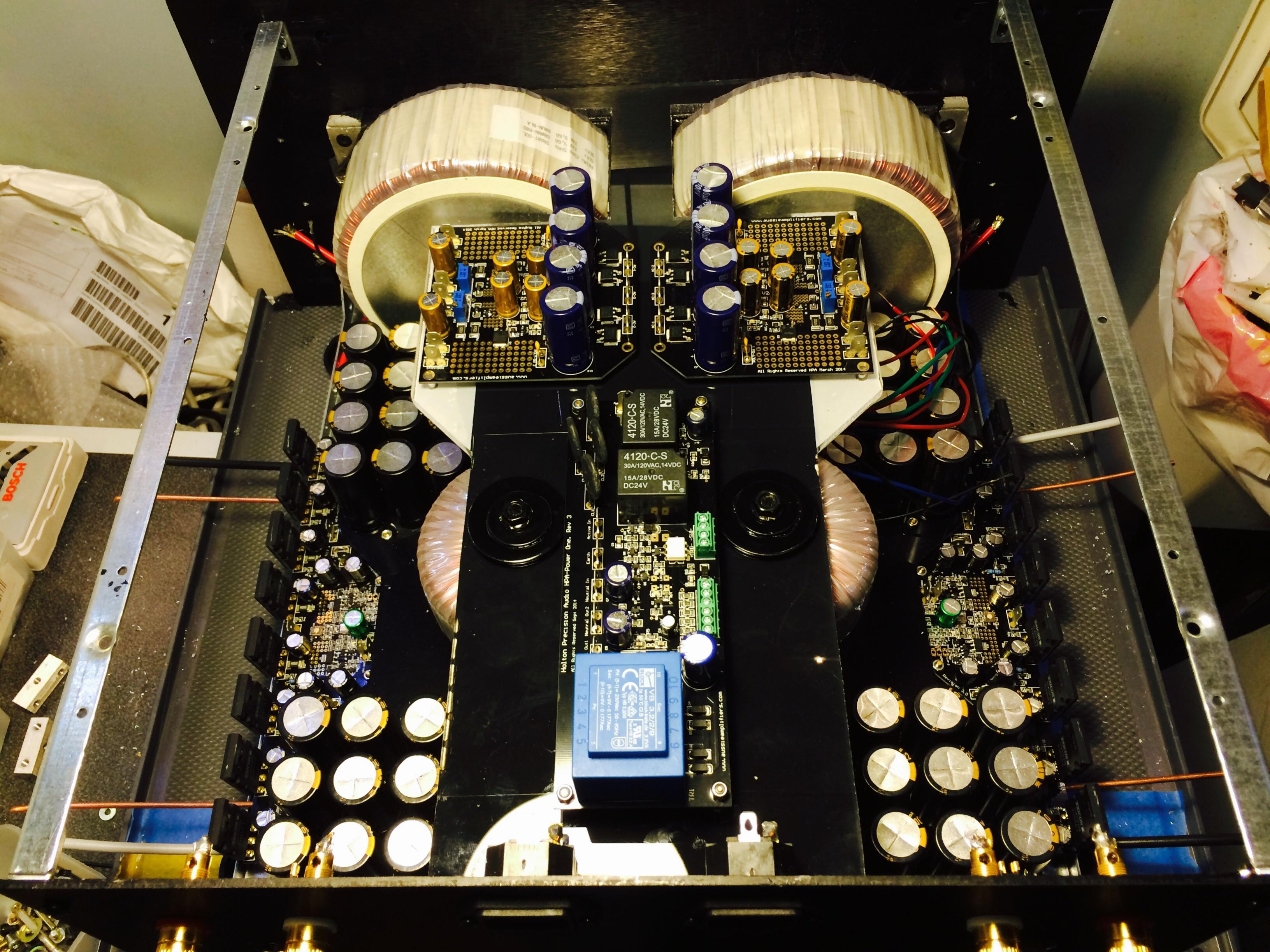

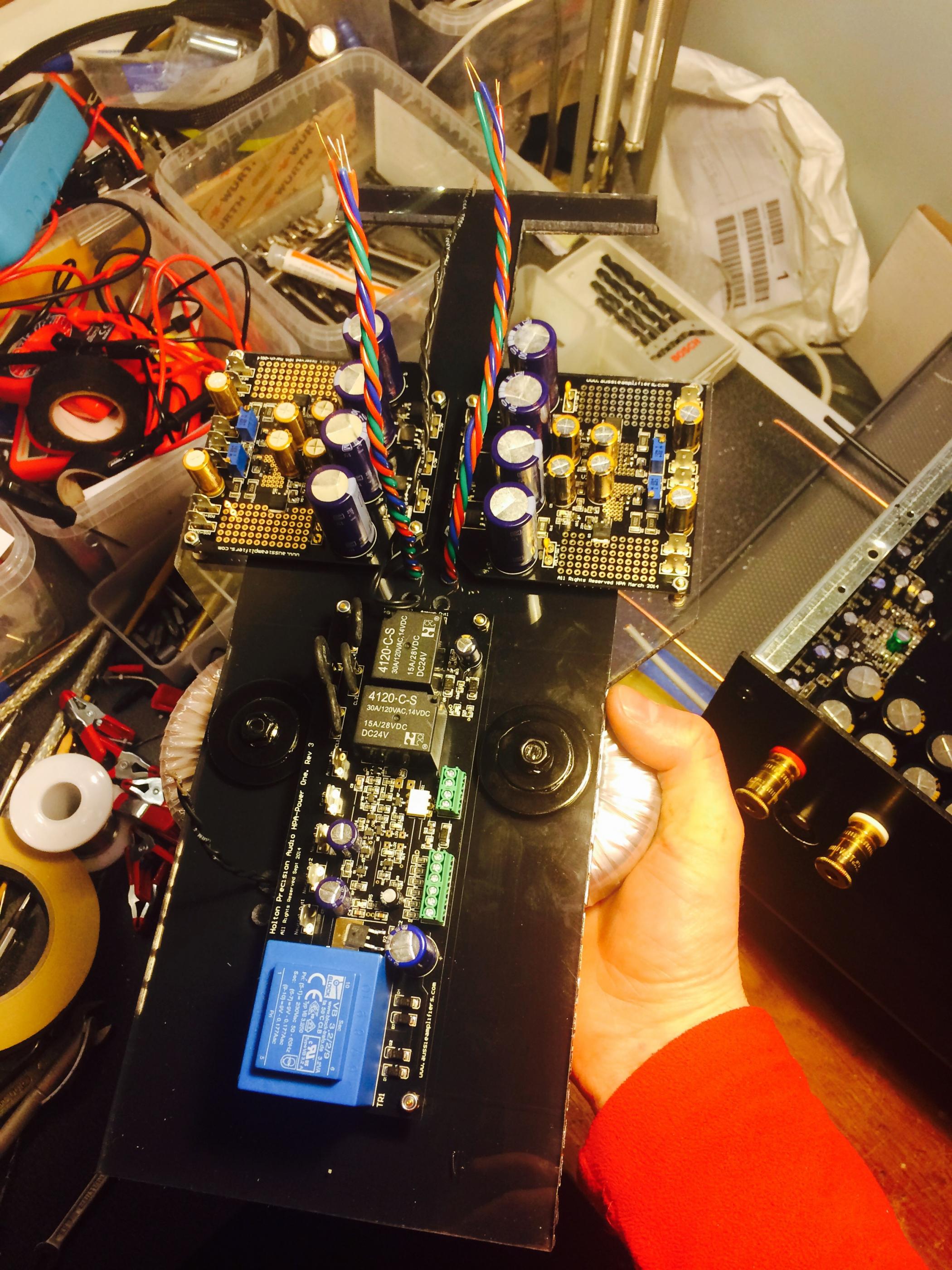

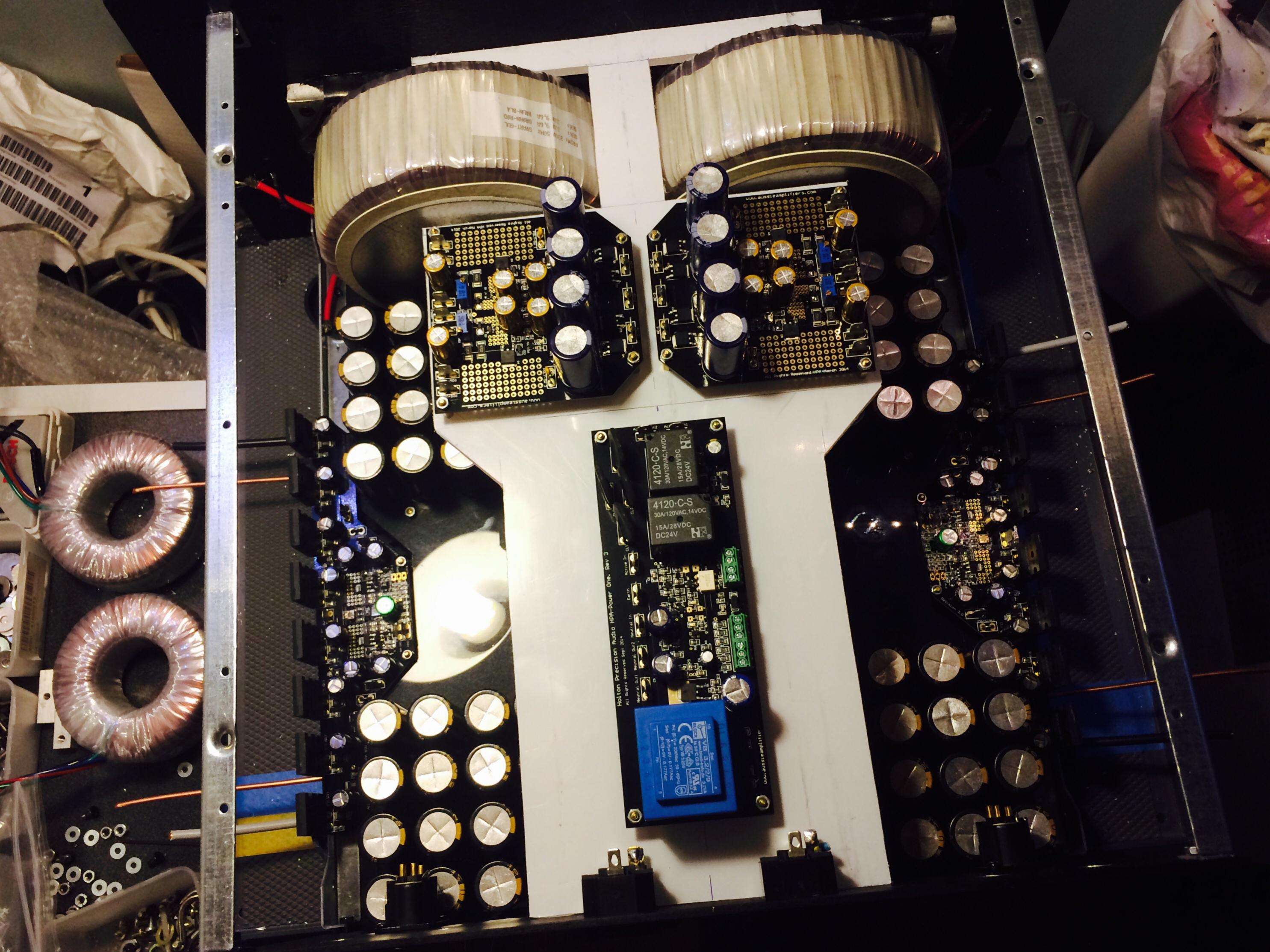

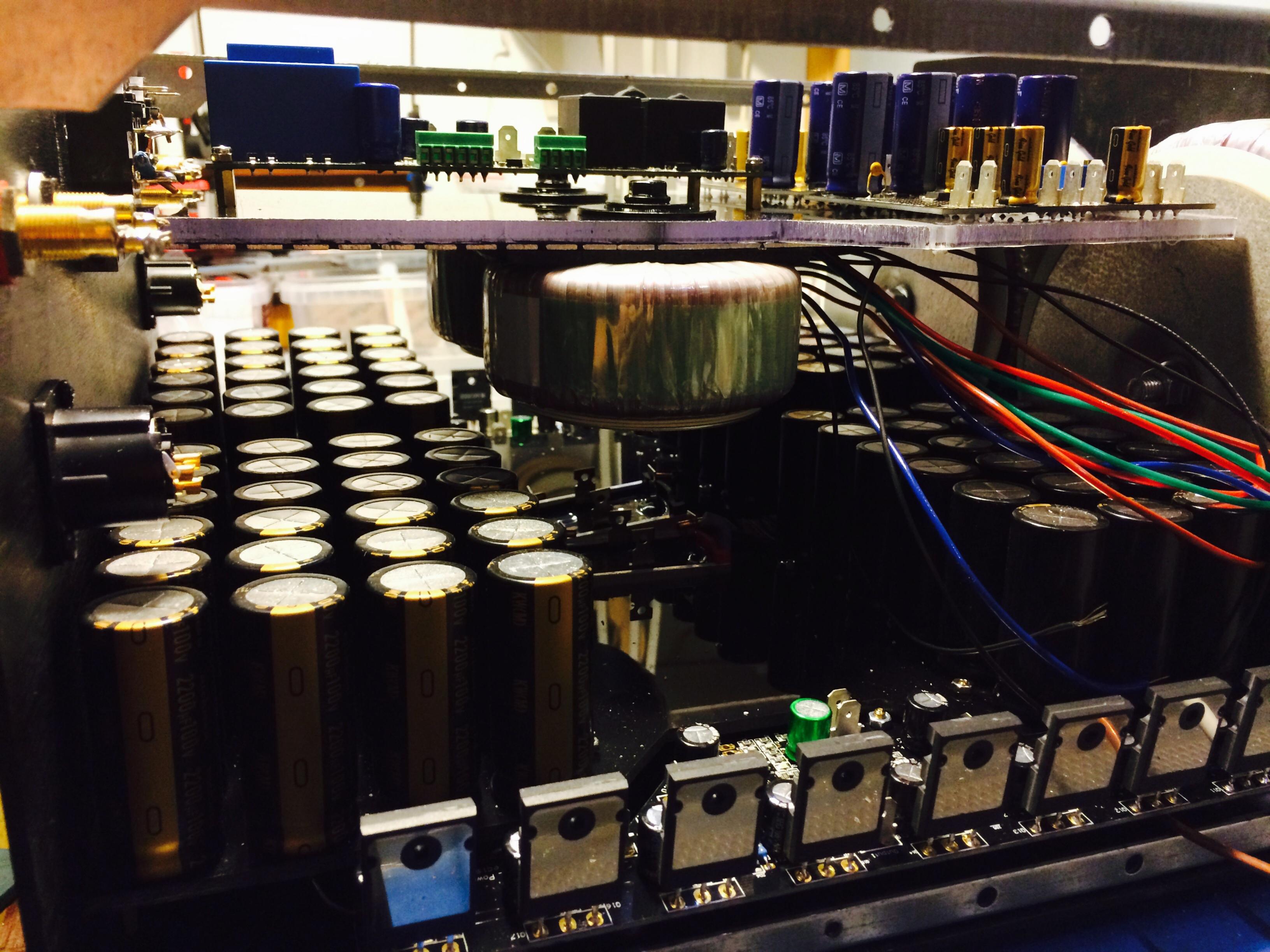

Some progress. The 800L boards mounted to the capacitor bank and heatsink. Al the wires mountet to the amp board. Power switch mounted on the faceplate.
Some test playing, the Volt-One not yet coneckted. Fine adjustment of bias, for now 80mA each transistor. Ca 36-38 celcius, reaching for 100mA later 😱

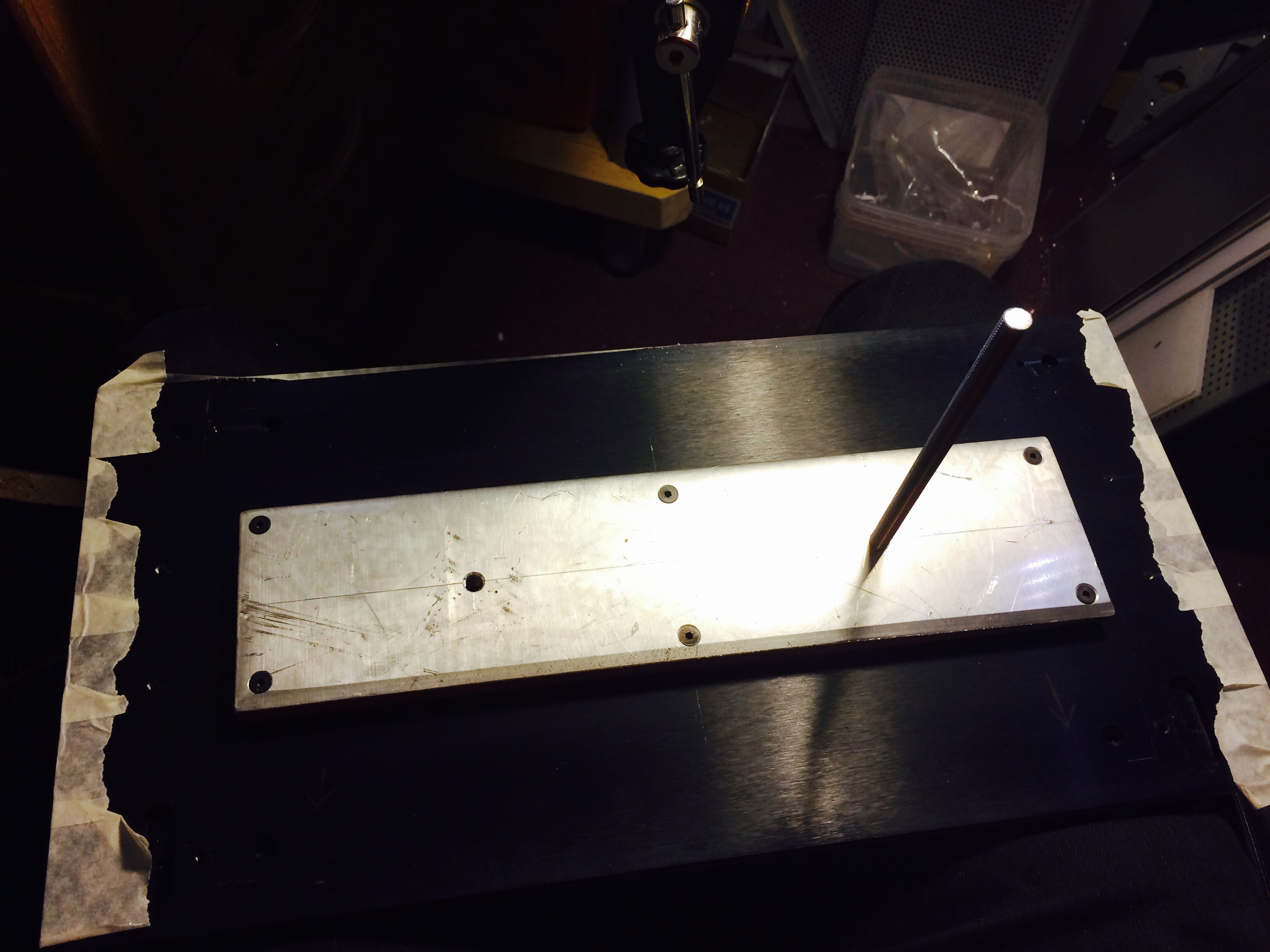

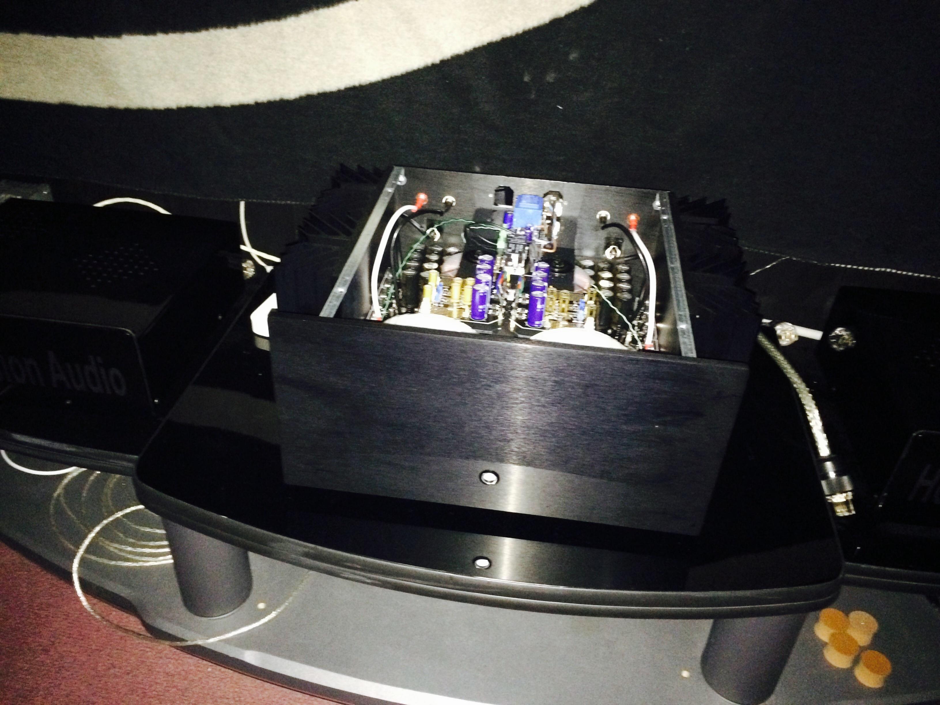

Wight 35 kg

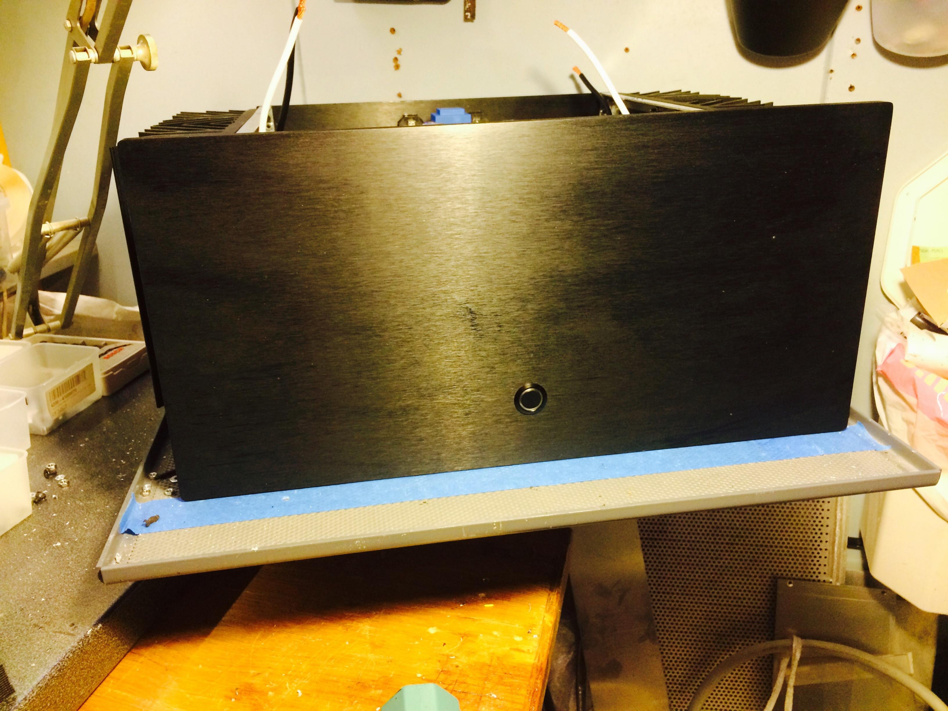

The Power-One R3 is an awsome device, love the easy conections for softstart, low volt switch, and dc guard. Worth al the money for sure !

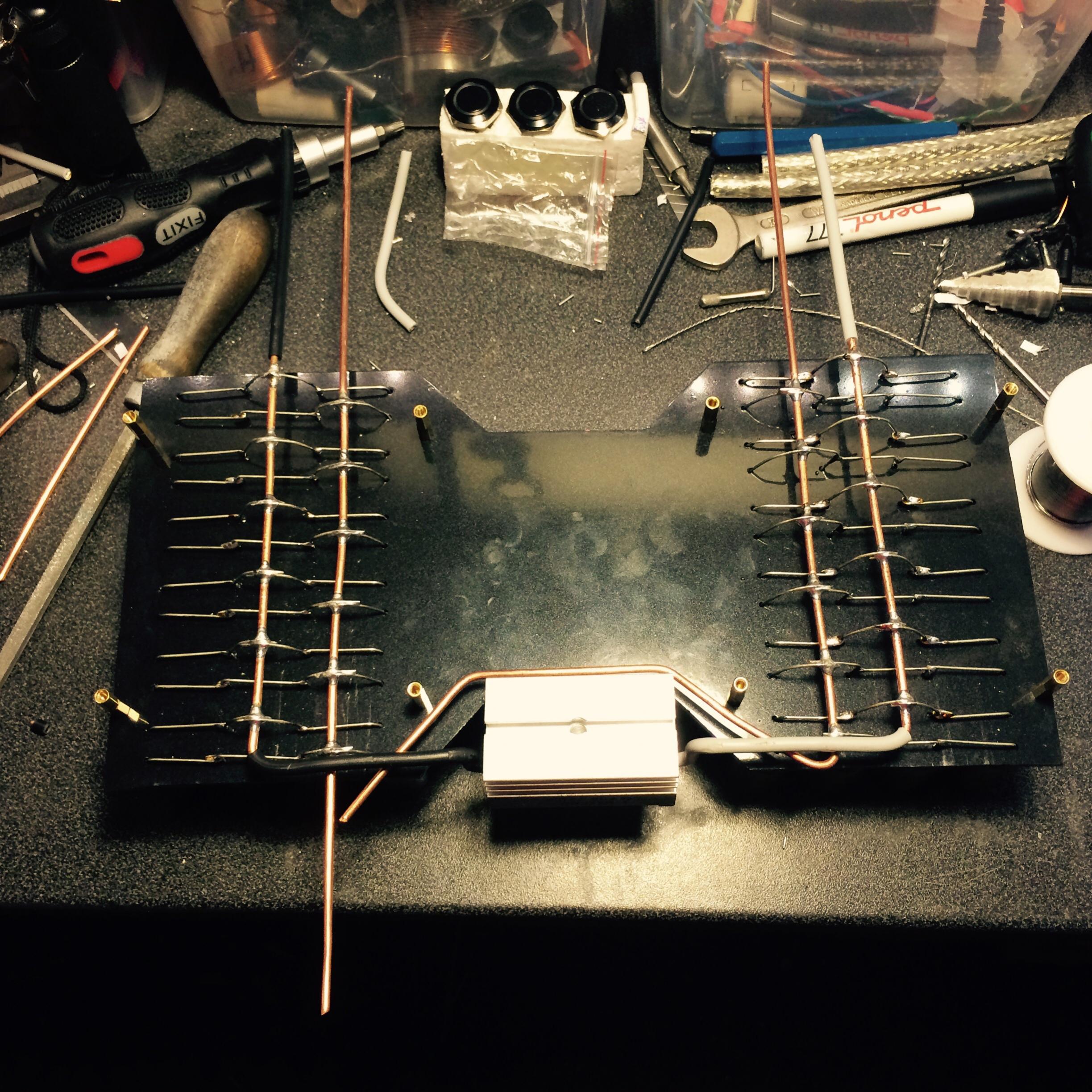

Conecteded Volt-One, the sound is emdiatly more accurate and soundstage more precice.
I now have 47 volt on the power part and 50 volt frome Volt-One.
