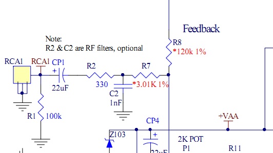

The "low" input impedance (and I put "low" in quotes because 3.3k is plenty high for any reasonably designed pre-amp output) is inherent to the reference design. If you want a higher input Z then you add an input stage to do it . . . it takes at most a couple dollars in parts.We were earlier discussing the possibility of increasing the 3.3k input impedance
Any reasonably designed "passive pre-amp" should have an output buffer anyway . . . it is not good design to make the performance of any component critically dependent on the load provided by the next device (including cables) in the chain.

So the question remains - can the L20d input Z be increased without a major rework ljm?
If your "passive pre-amp" is designed to work properly with a 20k load it will work properly with a 20k load. It will not work properly with a 5k or 10k or 40k load. There is, of course, nothing wrong with "application specific" designs . . . but if you want your "passive pre-amp" to work with a variety of amplifiers it will need an output buffer to provide the proper load impedance to the "passive" stage and a low Z output to the amp.I'm running the passive pre direct into a hifimediy T3 (20k input) with no issues at all.
And the answer remains - no, you cannot significantly change the input impedance of the 2092 (reference circuit) . . . if you need a higher input impedance you must add an input (buffer) stage (which is what other vendors, like classDaudio, do), the 2092 alone cannot provide it. It works fine, however, with anything that has an output impedance no higher than a couple hundred ohms (essentially any decently designed pre-amp from the past 30 years).So the question remains - can the L20d input Z be increased without a major rework ljm?
Two other thoughts . . . if your pre-amp is AC coupled (has an output blocking cap) or has a servo loop to control output offset and you never hot-plug it you can remove (bypass) the input blocking cap on the L20D board; and do note that the L20D is, like all 2092 "reference" designs, an inverting amp. If you want non-inverted output you'll need an inverting input buffer anyway (or remember to reverse your speaker leads).

Input-Impedance = 1/[(1/100k)+(1/3.34k)]=3.23kL20D input impedance is 100 K.
They are not parallel
You can use the multimeter, measure the IN +-between the resistance value.
This is the dc resistance.
If the input capacitance, no before and after the resistance of the parallel, then dc resistance = exchange impedance.

Hi ljm_ljm ,
Your Design is an inverting Amp. There ist no Signal-Difference between Note R7-R8 and GND.

I'm going to see this circuit, that you should be calculated is correct.
Reverse phase input virtual ground, so input impedance should be 1 / (1/100 K + 1/3.33 K)
