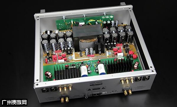

My design L20D IRS2092+IRFI4020H 200W8R
ARC DSI 200
The L20D with similar structure.
IRS2092 + (IRF4020 speculation)

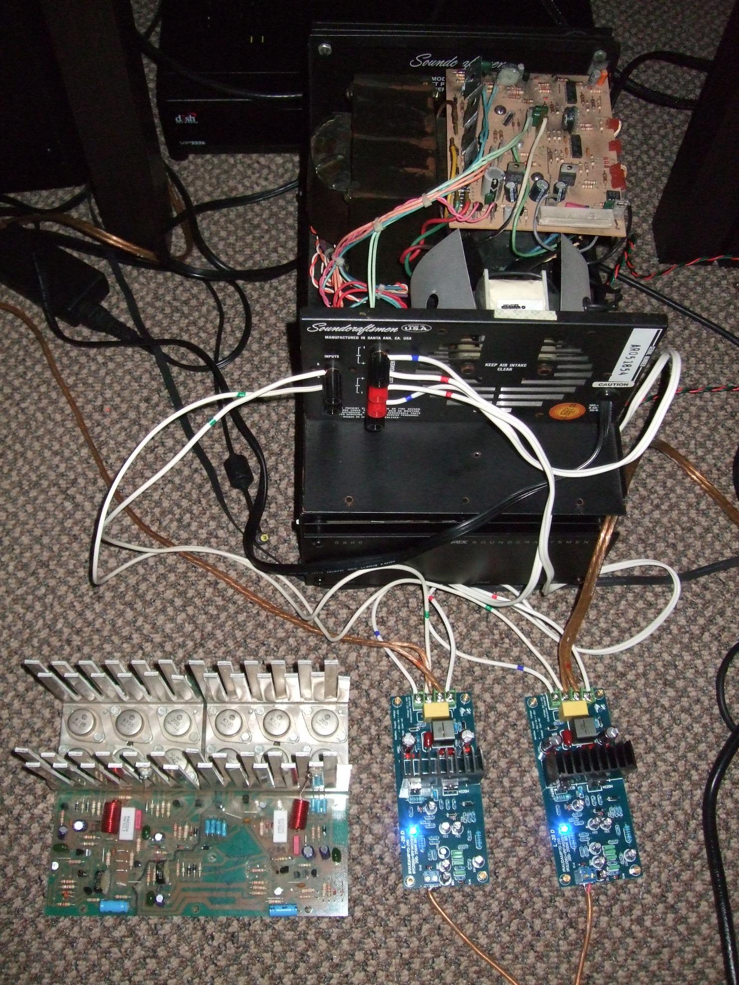

I got these boards yesterday and have been listening to them every time I get a break. My fear of them not handling 4 ohms is gone after playing them fairly loud for about 1 hour. They only get warm to the touch but I'm not using all the power these can produce. With a small fan they're cold like a corpse.

So long as the switching frequency isnt too high and the deadtime is correct they shouldnt run hot. Obviously the heatsink comes into the equation too.
I run an irs2092 into 2 ohms at 750watts without any trouble.
