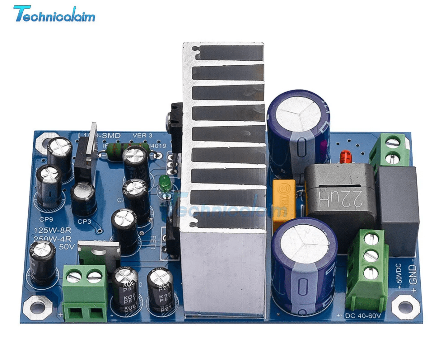

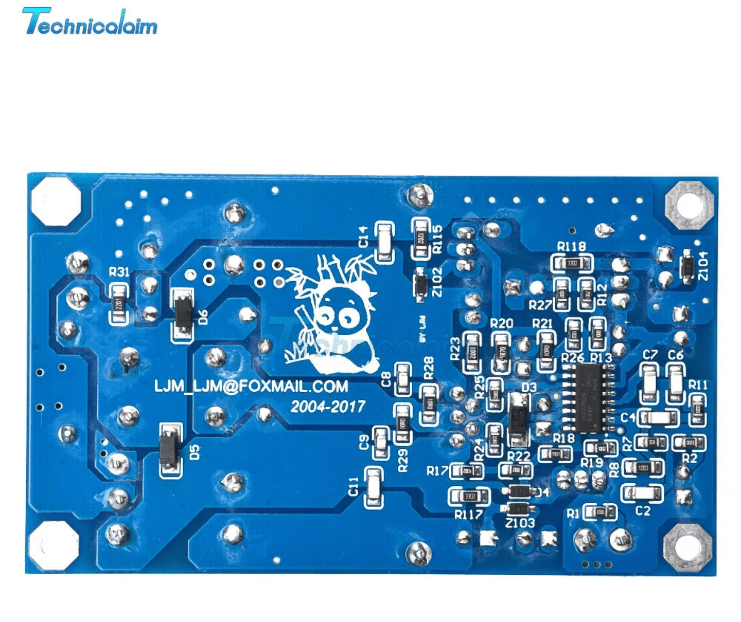

Can you please name real sellers for your boards...I belive that there are number of fake ones...I'm looking for l15dsmd...tnx
You just need to check L15DSMD
There should be no counterfeit goods.
Do not query the IRS2092 amplifier. Many of these Chinese produced products have quality issues.
My model is L15DSMD. Or L15D is not a problem. You can purchase a cheaper agent

I built a 7 channel amplifier some years ago based on LJM's L15D boards and they've all run like a dream since, and sound fantastic. LJM's boards are very well designed and excellent quality, very close to Infineon's reference design, and I'm sure the SMD ones will be just as good.
Reactions: Brko27
I really home they are legit. Looks like these SMD version are little cheaper than through hole ones.
Also I have L12-2 from LJM and one of boards works perfectly but other one have some weird clipping on half rail and starts under 10v rms matter on frequency, I don't know what is wrong.
And for supply of those L15DSMD boards I have 2 transformers from Kenwood amplifier and each of them is same with 140w, but I'm wondering is it better if I use each transformer separately for 1 board with separate rectifier board or I should combine them and get bigger voltage and hook up both boards on 1 rectifying board? Each transformer has output 36-0-36v after rectifying into DC.
Personally, I would run each amp from a separate tranny. That would give you in effect a dual-mono amp. Stereo separation would be better and there would be no crosstalk between the two amps. This theoretically would give you better sonics as well. Over the years I've built a couple amps using ljm modules and they all performed fine - both with linear PSU or SMPS. I even have a couple of the newer SMD variant modules in a box somewhere. 🙂 They really are very reliable and dynamic sounding little amps that sound very good indeed. That makes them a winner for the budget valued DIY'er.
Reactions: Brko27
