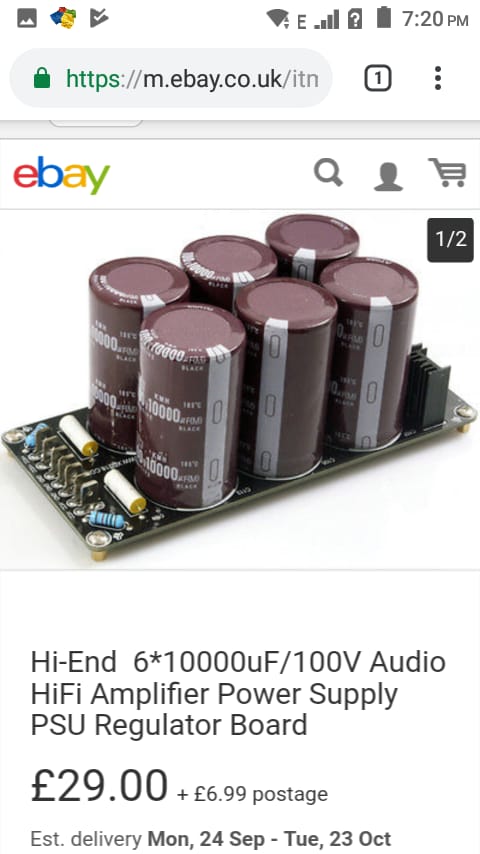

You can buy this power board. It supports L30D
USE AC 50-0-50 transformer

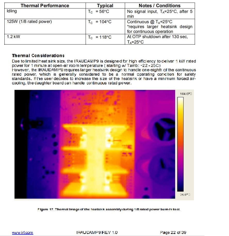

In addition, L30D is very geothermal. It is recommended to add fans in summer.
You can refer to the temperature test data of iraudam9
In use, the temperature may exceed 104 ℃

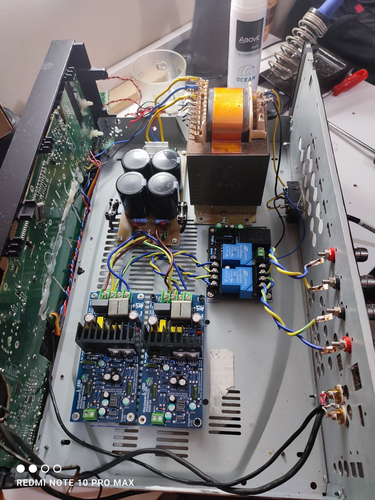

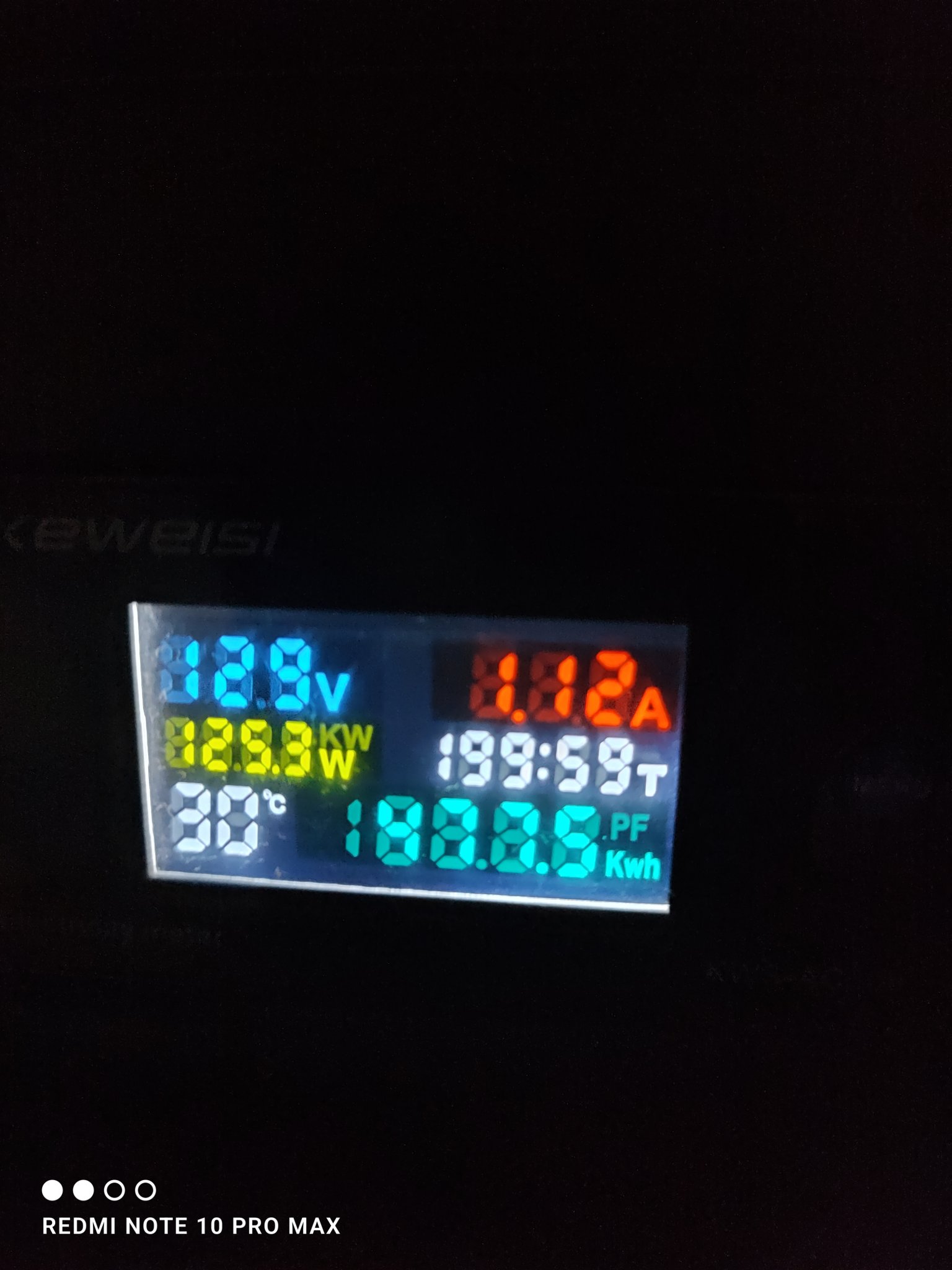

I built my L25D, used a DC protection board, a small NE5533 preamp to get the necessary gain, a +64.5 -64.5 VDC linear source.
I noticed that the heatsinks get pretty hot even without signal.
It's normal?
6 ohm speakers.

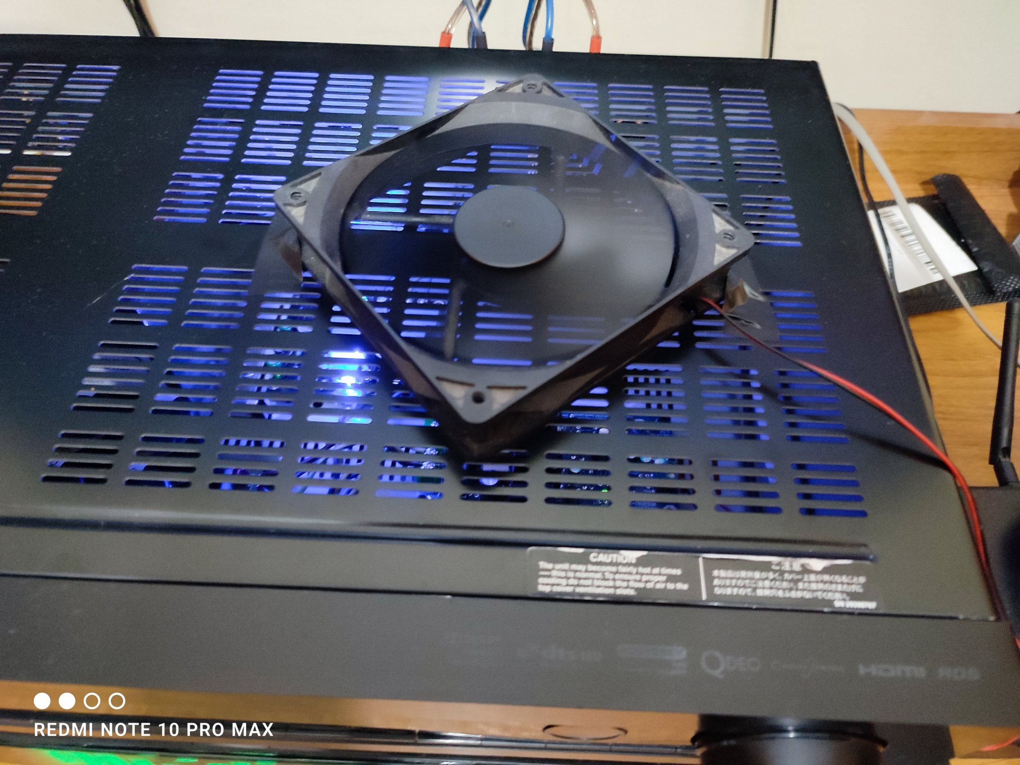

Thanks for the reply LJM.
But should I worry about this heating?
I wanted to used a power transformer that I already had with me.
The L25D was the first amplifier where I saw the possibility of using this transformer.
I did a test with a 120x120mm cooler on the outside of the case and the temperature dropped considerably.
If I put the cooler, can I be more relaxed about heating?
One note, last night the amp played all night, I left the test cooler off to see if the amp would trip due to overheating or some other problem and I ended up waking up with it playing music beautifully.
