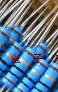

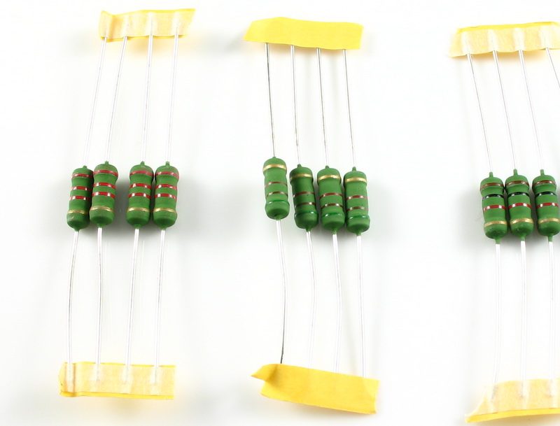

The 2K2/1W resistor next to the D669 gets very hot and changing color on both boards even at idle. What should I change? Remember I'm running +/-70V.
B: yes, I also found this phenomenon, in some time ago I this a few resistance are replaced by 2 W power.
In the IRAUDAMP7S IR noted in 2K2/1 W apparently is not so correct, because the resistance the power consumption of the above about 1.3 W.
If you are some time before buying it, I suggest that you put the two resistance to change is 2 K2/2 W.
If no hav, please contact suppliers, I can send you a few.
Now I have resistance change for 2 W power, military quality metal oxide film type.
It has a small change in temperature.
Today some L20 D I start with speakers as a test.
+ 77 V 4 OHM. Good work and almost no temperature.

My 2.2k resistor is beginning to discolor after 1 day. Will be asking Zoe Tsang for a 2 watter as E14 doesn't carry this part.
