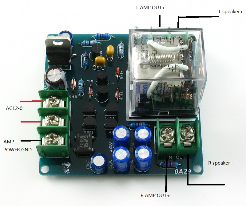

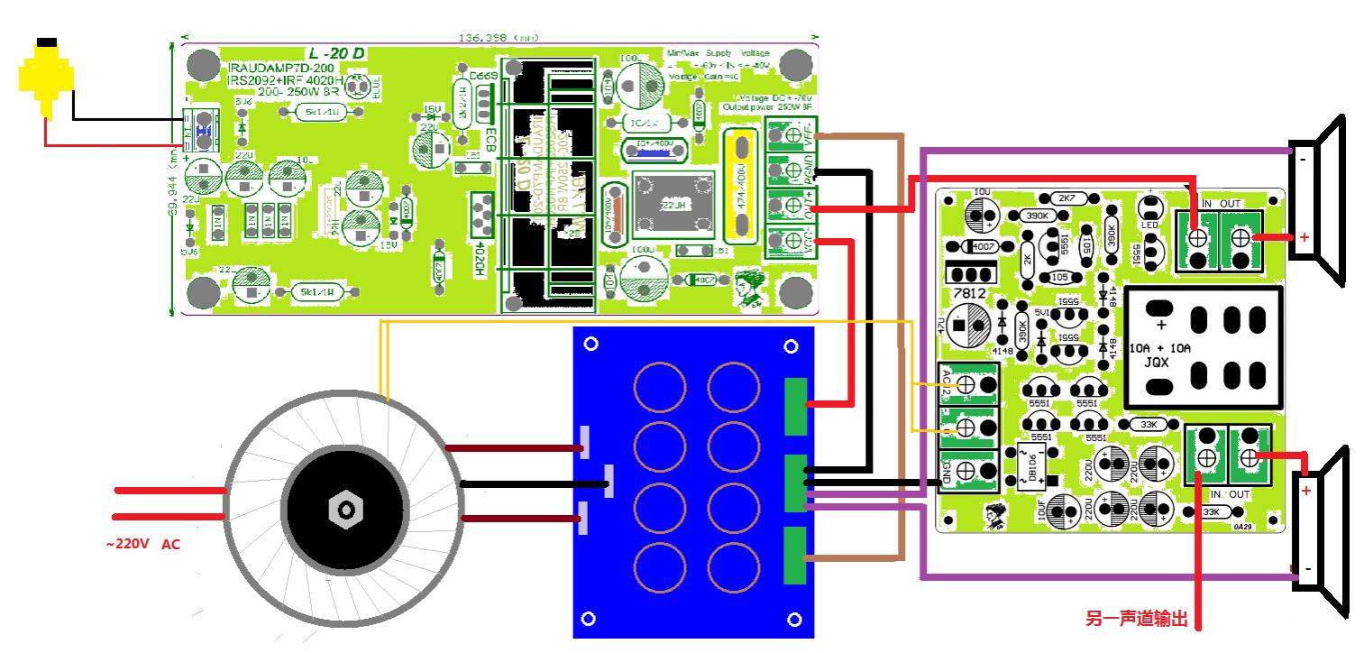

speaker protection
Curious about your comment on the lack of speaker protection. The reference specs seems to indicate that there is Speaker DC protection (page 25). Am I missing something?
Bernie7, IMO the T2 is really good enough for a quality audio system. It is clean enough so that it will be hard to find any speakers capable of distinguishing between the T2 and the L20D. However, the L20D measures cleaner, especially at high frequencies and high powers. I will use the T2 as a knock-about portable system run from my (Apple) 24V 2.65A power brick, and the L20D in the aluminum casing holding my main stereo amplifier. I want to get the SURE working for a suitcase-portable system I have designed, so I will get a real TDA7492 chip from Digikey or Mouser tomorrow, and replace whatever chip SURE supplied in the board 🙂
You know, the L20D performance is so good that it is really going to be hard to beat. Ljm_ljm has produced a board which is really stable, a very nice package indeed. And inexpensive as well 🙂 It doesn't have all the protections of the T2 (speaker relays, etc) and that is just about the only way I think it could be improved. Other than increasing its power to kilowatts, of course 🙂
As for power supplies, you don't need as high a supply voltage to pump power into 4 ohm as you do into 8 ohms, but you need twice the current. The 4020 output chip on the L20D is optimized for high voltage, not high current.
As for pushing the specs a little, one tends to be cautious in view of the lack of speaker protection relay on the L20D. I am adding a board to do that for me 🙂 But if you take 150 watts as the maximum real-world 4 ohm output (which is the number I would start with), you only need about 25 Vrms into the 4 ohm speakers to achieve that. You should be able to get that from a 40-0-40 power rail. Because it is a switching amplifier you can probably fudge it from a 68-0-68, but there will be higher peak VI values floating around, and the amplifier will not be operating at maximum efficiency. Look on pages 9,10,11 of the iraudamp7s data sheet and you will find curves using 50-0-50 into 4 ohms, for example (but they use a different FET in the lower voltage configurations than the 4020).
Hope that helps.
The reference circuit allows for transistors to be added to improve speaker protection, but I cannot find them on my L20 board.
B: yes. Reference circuit with 2 to only 2 N5551, a resistance 100 K and a 330 to determine whether the UF capacitance output have dc. (L15DX2, L20DX2)
It USES IC OUT. The way to close
In fact this way the speaker protection is not reliable, because if MOSFET damage or power of the diode damage above. Protection measures is cannot assure, no dc output.
So in my design, L15D L20D is not the this way.
And the traditional relay plan is the most safe.
