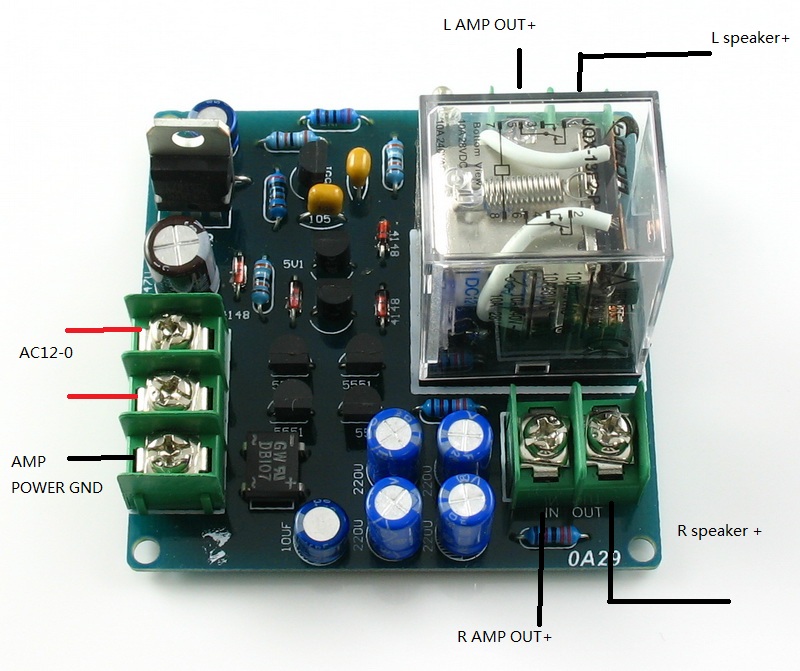

Hi ljm_ljm,
Which speaker protection board do I use for the l25d?
http://www.diyaudio.com/forums/atta...1317359674-irs2092-iraudamp7s-irfi4019-bf.jpg
