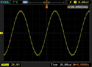

I do not recommend the use of more than +-80V DC power supply.
Because L20D above filter capacitor voltage is only 80V.
Also the voltage is too high above the power 1W 5K1 resistor reached 1.2W, this is not safe.
I recommend using +-60V to + - 70V between.
At + - 65V voltage, the output sine wave + -60 or so signal power of about 8 ohms 220W 20KHZ
