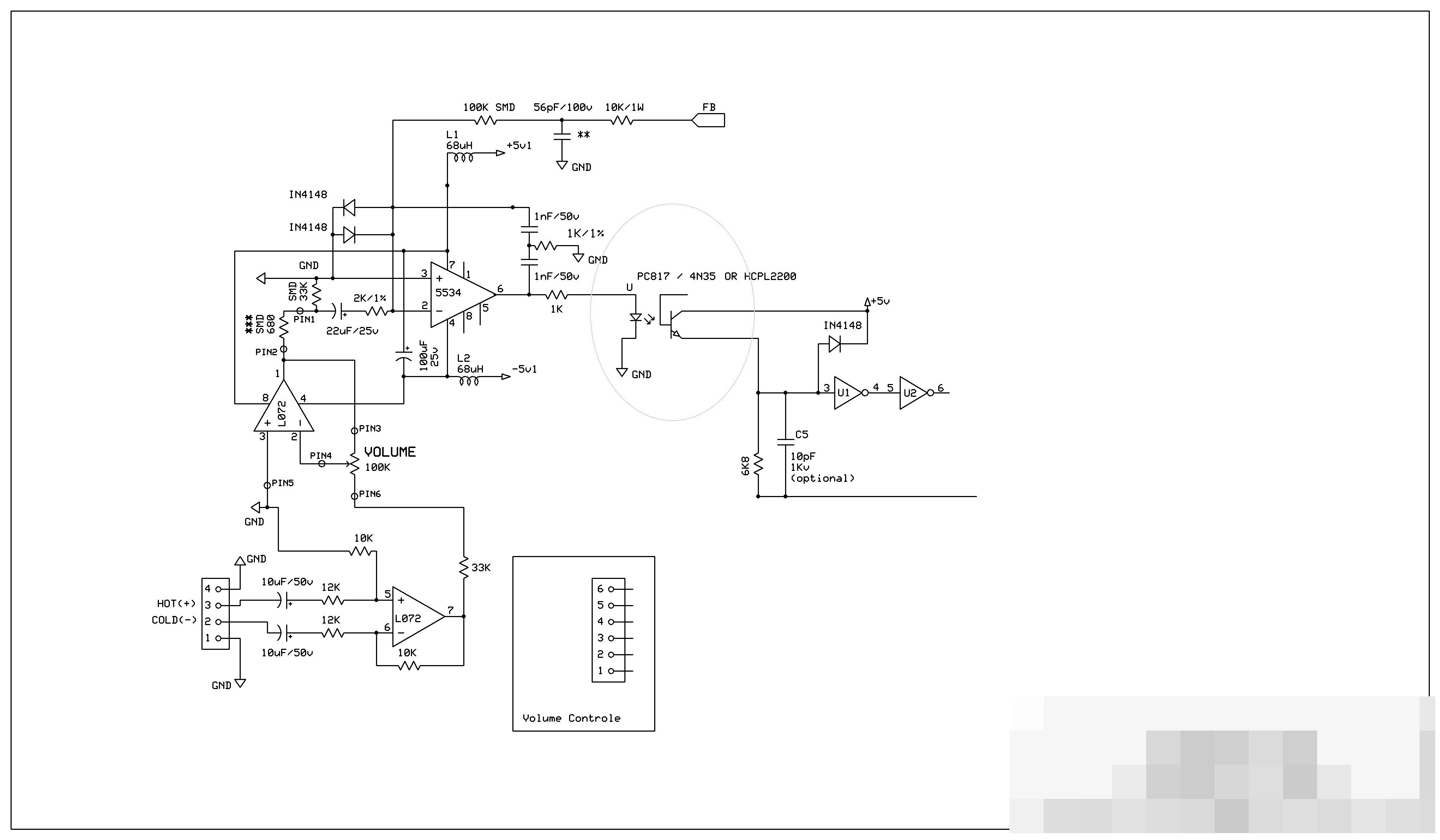

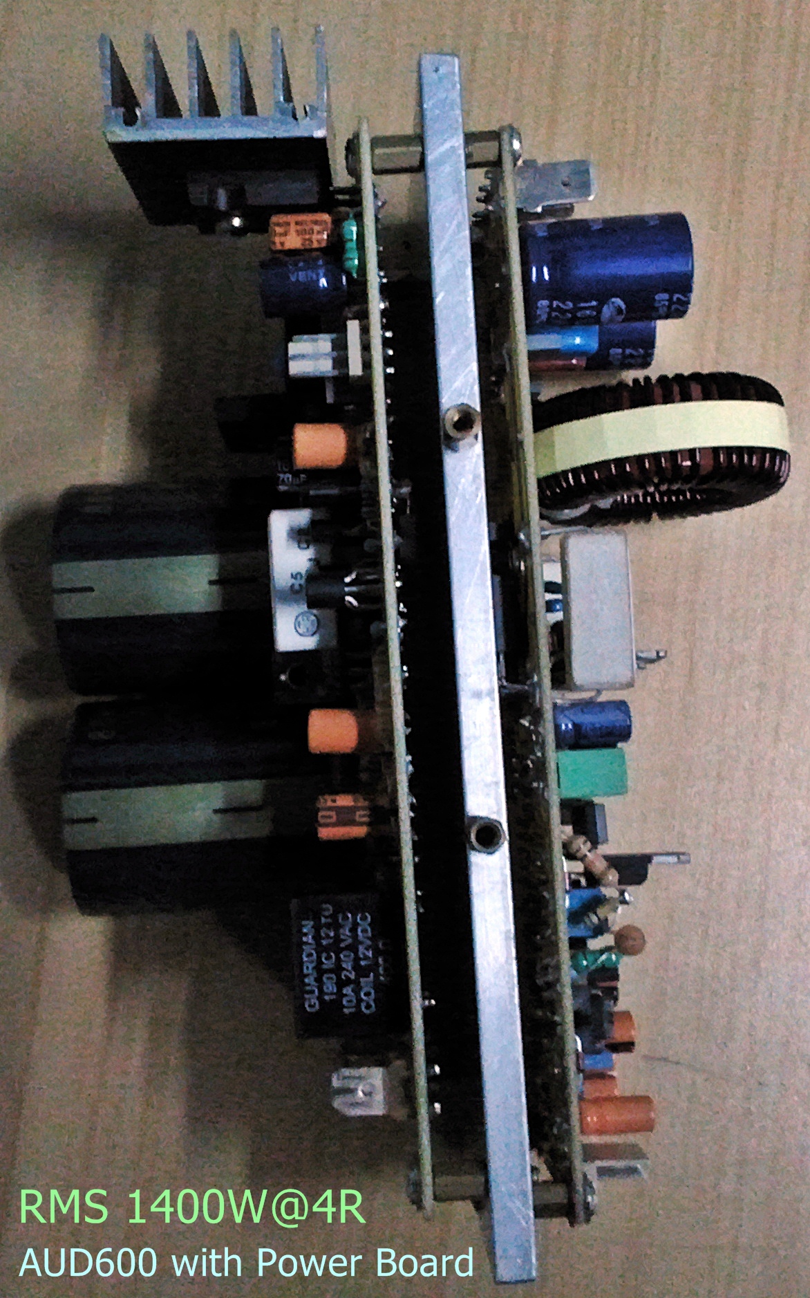

This is very cleaver design. However, mounting in box may be difficult. What is the rail voltage? and what FET you are using?
Raj
Hi Raj,
Vertically mounting. 5mm thick aluminium and 3 inch Hight,6.5 inch length
+/-75V 10A DC rail and FET used IRFP250N fsw@250KHz. OC protect @18A
