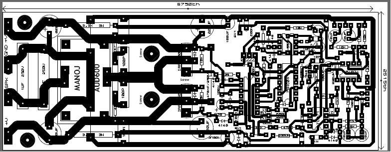

Revised PCB for AUD600 Ver1.0
Hi Manoj:
I have revised a PCB design of AUD600 ver1.0. In this pcb heatsink will be placed on top of board and few more caps to eliminate EMI/noise.
Please let me know improvement areas.
Raj

Hi AKRAJ,
Good design. use 18A(6mm) carrying HV track OR 4mm with lead coat.
and if you use AUD600 in bridge mode its give amazing power supply rail -/+73V
Regards
MANOJ

Hi Manoj:
Thanks for your suggestion. I will do that.
I also have ground pane at top layer, but not posted here. Do you think ground pane on top will improve quality?
Raj
Hi Raj,
IR2110 pin 5 not linked to junction point(feedback)
no improvements for sound quality
Regards
MANOJ

Thanks a lot Manij, I will correct that. Except this everything is okay?
