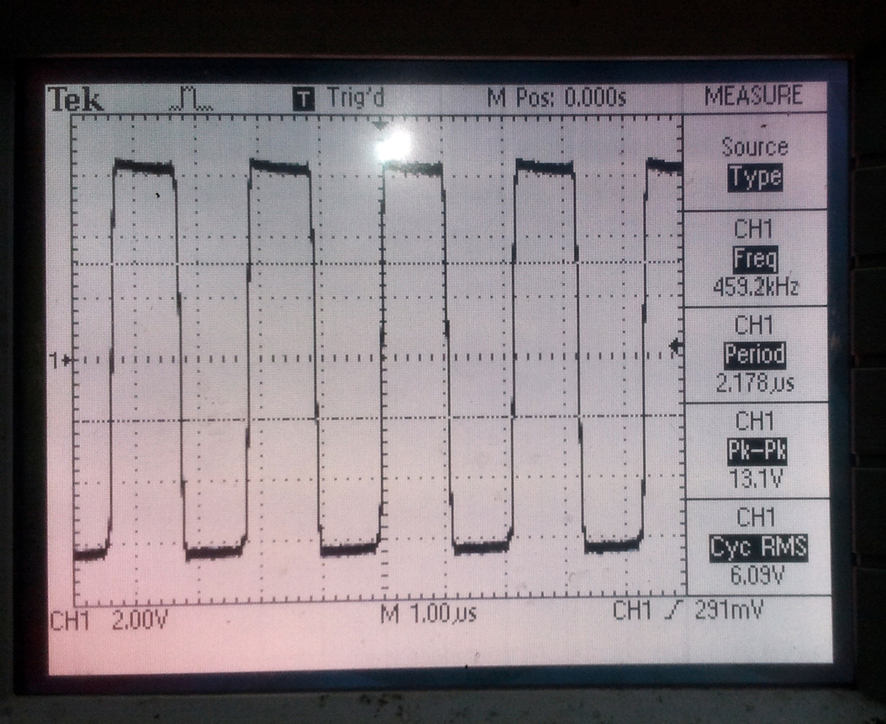

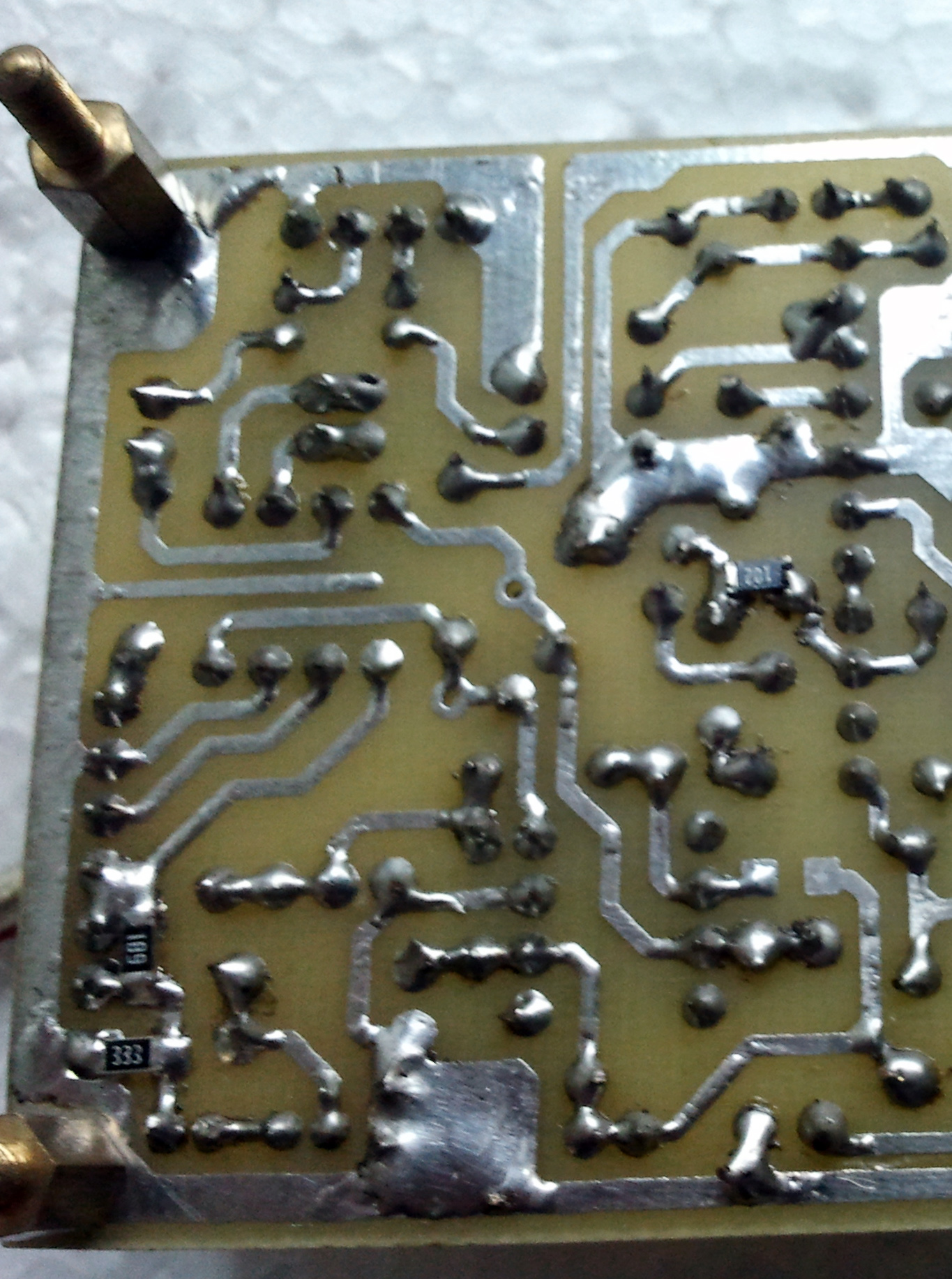

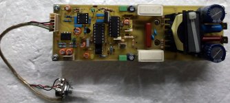

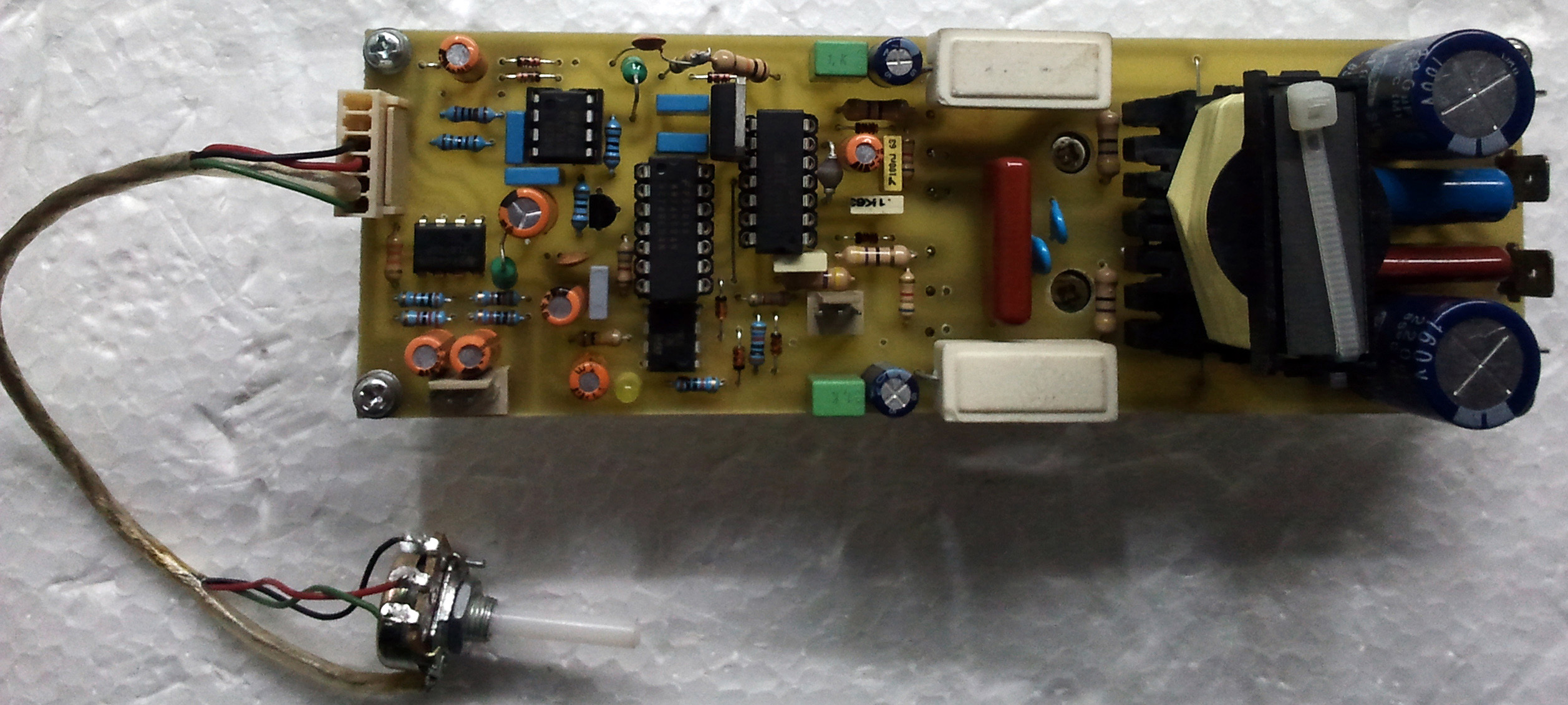

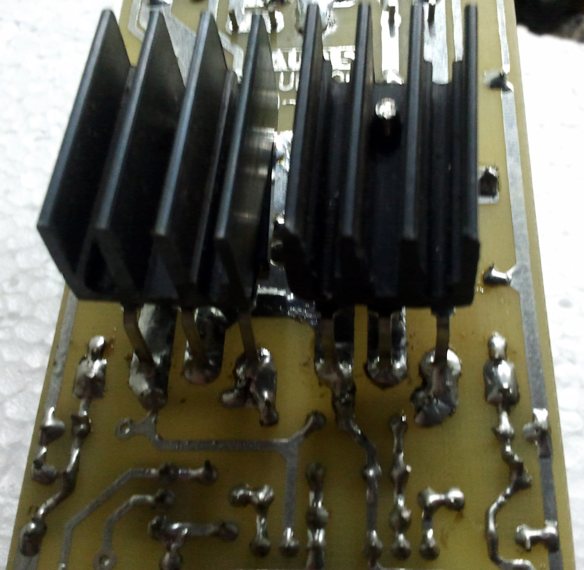

Hi ALL,
My AUD600 Rev 1.1 change to Rev 3.0
First test fsw @460KHz with IRFP250 MOSFET run cool with Mid Volume temp 50 deg. with full drive @ 4 Ohms load.🙂🙂
Regards
MANOJ

Hi Manoj,
use accurate LCR meter to measure the value of your inductor. maybe your ee type filters don't have enough inductance to reach a good cut-off freq. also as i calculated before , in lower loads , we lost some higher frequency and we should increase cut-off freq.
Hi IR,
Thanks. I changed cut-off freq. settings ; add a 474/400v capacitor now HF is good.
Regards
