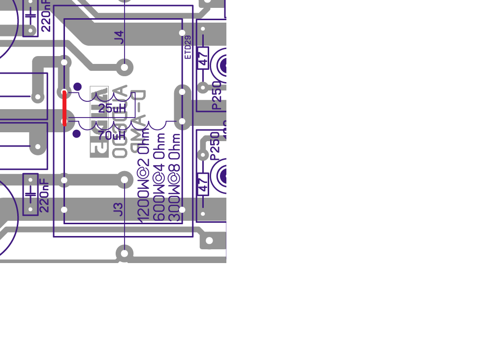

Hi sir manoj
how are you today ?
i try to creat filter for aud600 with etd29
i was try that with 2 wire 0.8 in same side for 70uh and 25uh.
when i did conect 25uh then filter get hot and amp not woked
why ?
thanks
how are you today ?
why ?
thanks
