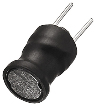

Anyone with knowledge on class D amps...question here, can this inductor be used as alternative for 220uH choke coil on AUD600?
Thank You!

Hi abetir,
Yes you can use drum coil for low supply rails(max.+/-35V),220uH don't need for 250KHz fsw
Regards
MANOJ
Regards
MANOJ

Hi Manoj,
..is it 220uH specific? Will a 100uH be able to work also..?
Thanks!
Hi abetir,
for 250KHz fsw use up to 70uH coil
Regards
MANOJ
Hi abetir,
Regards
MANOJ
Thank you Manoj, I'll get back to you as soon as I have completed one board for a test..🙂
I will be using these pair for the inductor...
