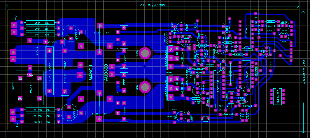

Hi Raj,
Vertically mounting. 5mm thick aluminium and 3 inch Hight,6.5 inch length
+/-75V 10A DC rail and FET used IRFP250N fsw@250KHz. OC protect @18A
Regards
MANOJ

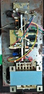

Hi ALL
AUD600 wired for SUB WOOFER RMS1400W@4R🙂🙂
EQ for aud600 wired 100Hz sub filter🙂🙂
Regards
MANOJ

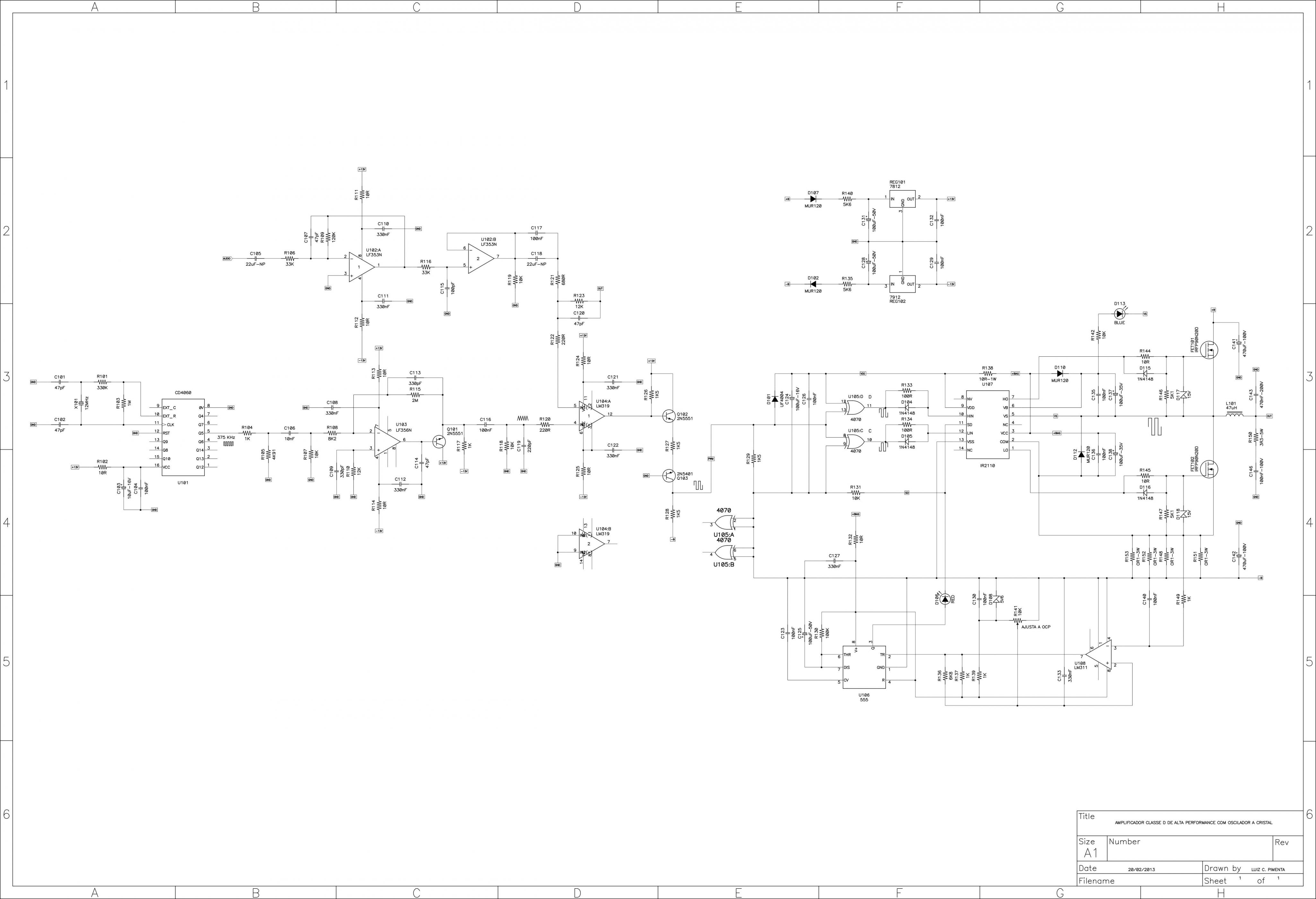

Class D amplifier with high performance and crystal oscillator
🙂 Good morning everyone.
My contribution to the forum.
Have ridden with separate PCBs (clock / PWM audio input, power and protection).
I am now making a single PCB to finalize the project.
OK testing and operation.
Regards to all.

thanks for the schematic luiz.
Looks interesting luizcpimenta, would be great to see some photos of your pcb when it's ready.
OK.
Hi luizcpimenta,
this is similar AUD1000C, thanks for new design. i will give you little correction for your design
1. Remove R129(1K5)
2. separate +15v supply for CD4060 for 12MHz switching it will take more current.
3. Re adjust R127 & R128 for PWM signal 3.3V level otherwise your Q103 will damage on long run(+B=75V or more)
Regards
MANOJ

Hi Manojtm.
I really relied on AUD1000 you sent me.
Thanks for the tips for my amplifier.
You have the files from AUD600 to send me?
Thank you again.
