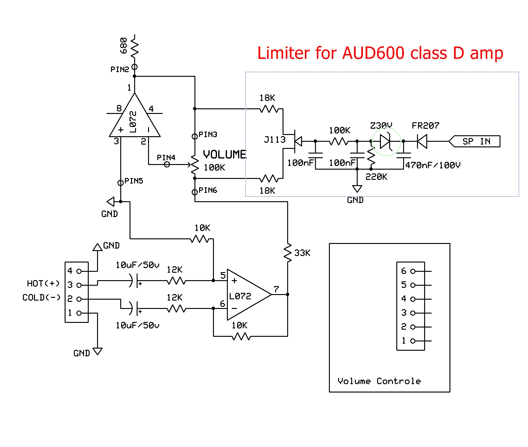

greetings nice limiter can you post picture of picture of fet j113

Hi Andrew,
you can use 2N7000 or BS170 if you don't have J113(J111)🙂🙂

Hi:
What is the purpose of this limiter?
Raj
Hi,Raj
To protect the speaker and AMP for very high volume. any D class amp will produce very high current at speaker point when you apply high volume it will not stand for long time for this level.
