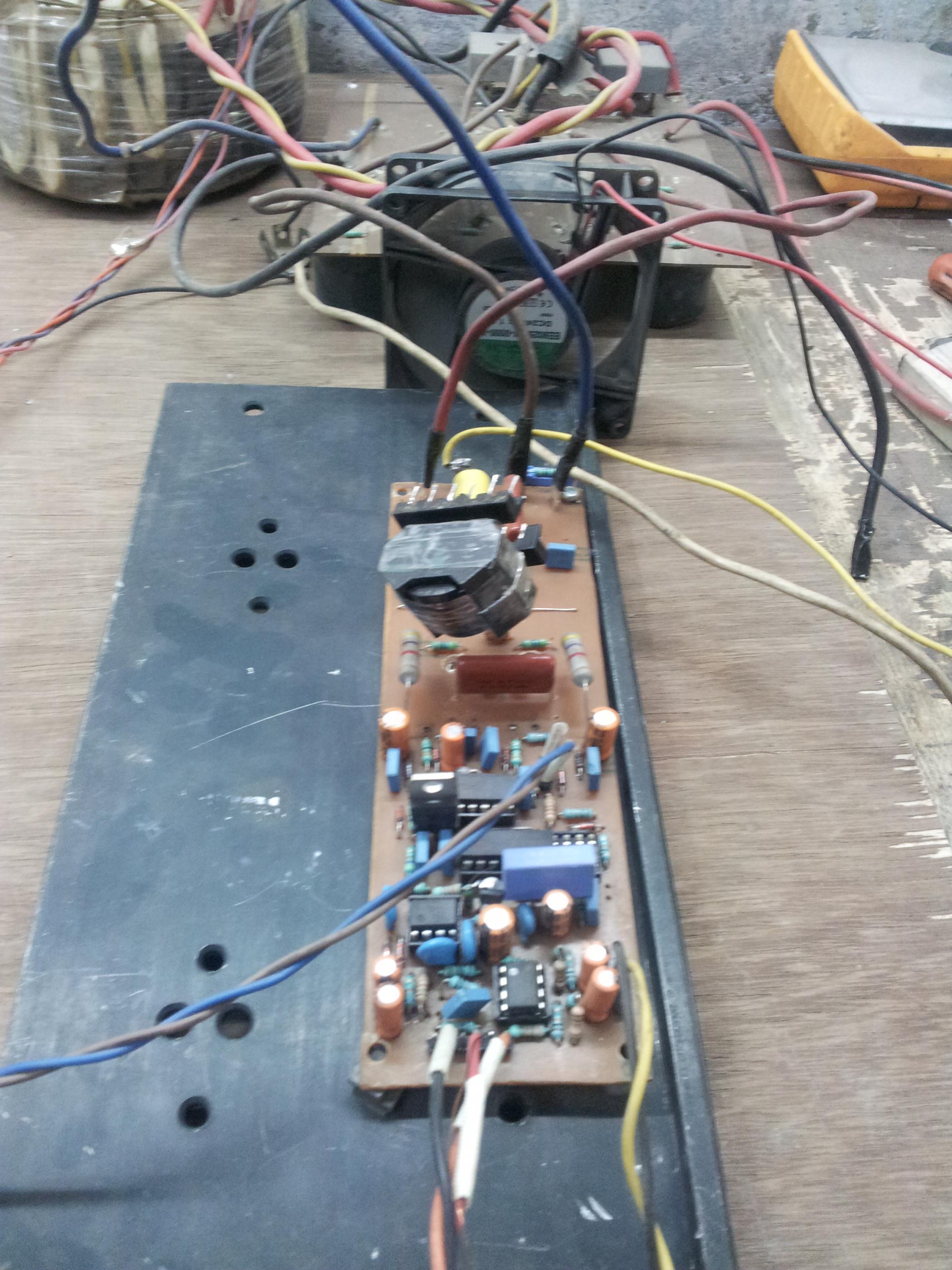

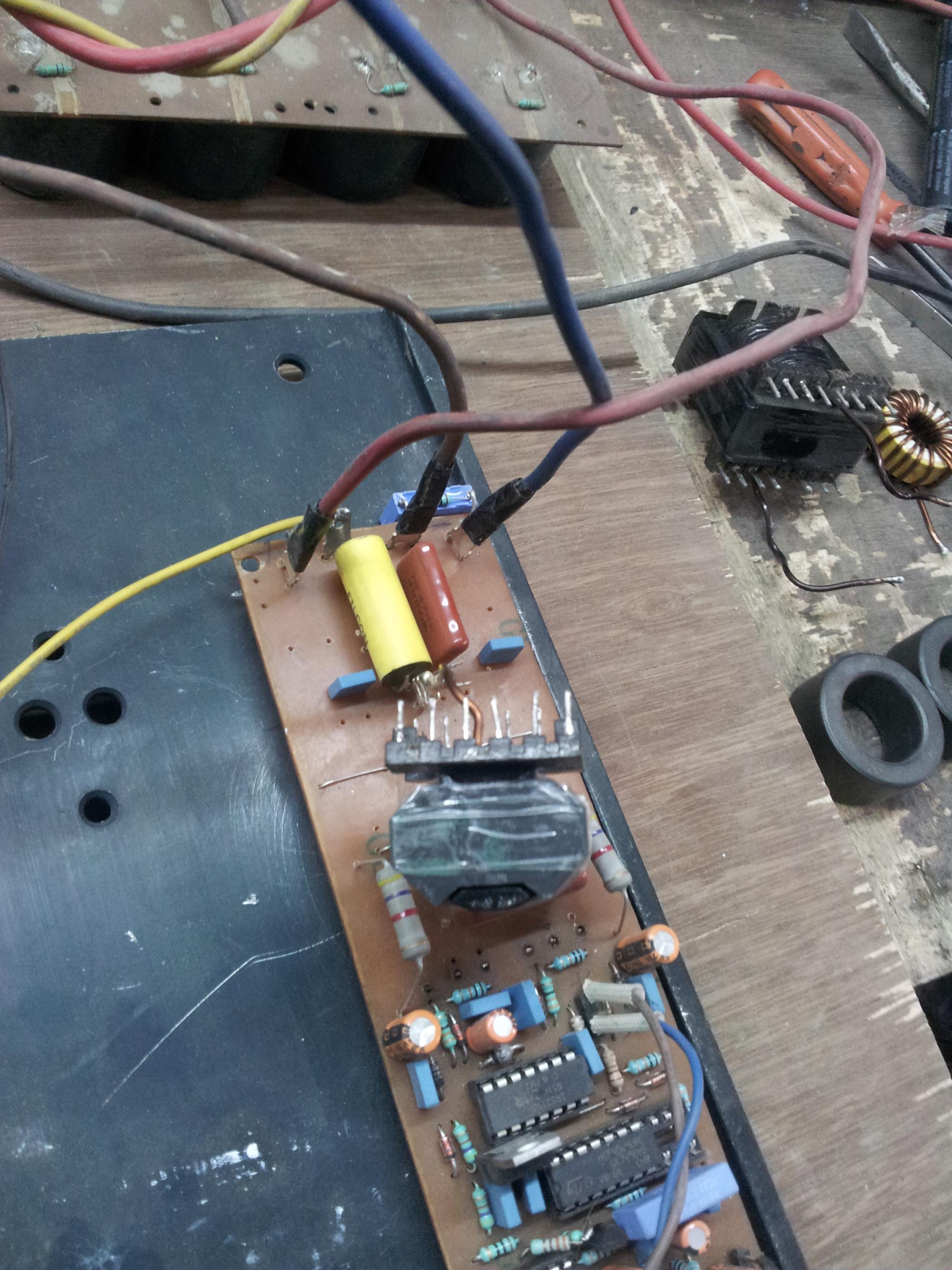

hello sir i m using RM10 on ur amp.. amp is working good.but on 110vc dc( testing ) fets geting hot .. using 23uh . i m not using 7806 i m using 7805 . is that any problem ??
Heat might be okay, but how much?
which fets are you using as outputs?
Hi AMAN,
IRFP250N can handle up to +/-122V supply and do not connect 2R & 4R load. only for 8R load.
Regards
MANOJ
Regards
MANOJ
