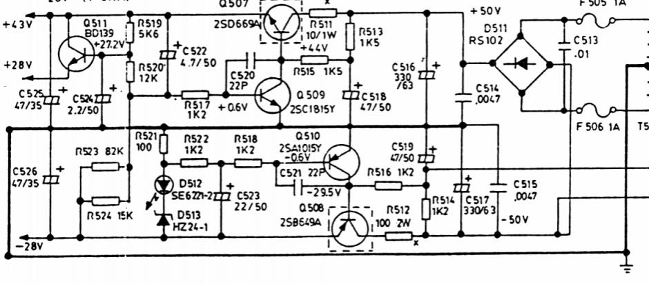

Ill send You a board, You dont have to pay for it. I started to build and test this power supply thanks to EC Designs and member Danico from Hungary who shows me the circuit. Send me your adress on my PM
Bardos, I have the circuit on my PM, it could be worth to try it for the audio stage. Try to post it here so people could see it, or if you want i could try to attached it.

Thanks, I edited my post. Same here, I cant attach the photo of circuit from power supply for pre-amp (NAD). I beleive it could be used (modified) as a power supply for the analog stage for CD40 or any other CD player. It will be good if You try to attach the circuit tomorrow.
Here is the schematic of the NAD 3020 preamp PSU.

Soon ill build this PSU and ill present you my impressions about. I think ill use it for audio stage of CD40.
