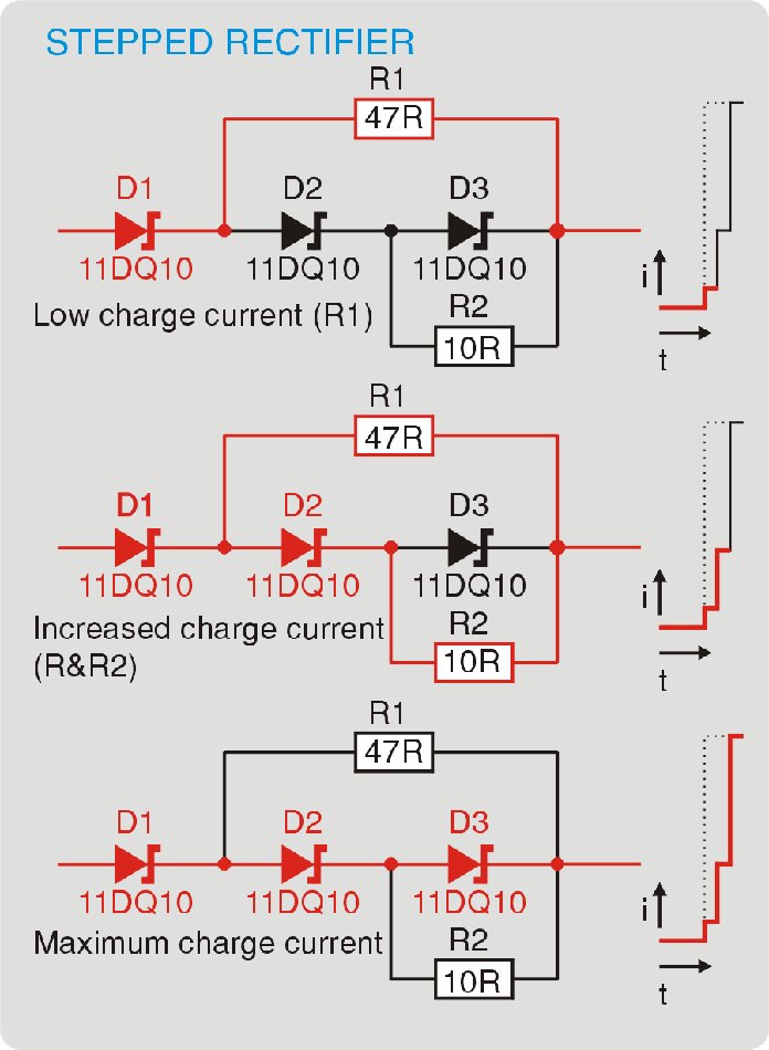

U can try the 3-stepped rectificaton, that does not take much time to try.

Yes, Thanks John, for this "Stepped Rectifier Network" design - such a simple thing that works like a charm!
I already (had to) use them in the DAC power supply. After hearing the impact on power amplifier supply, I probably never use a conventional rectifier in these kind of circuits again.

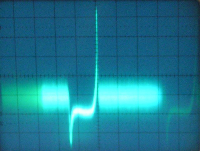

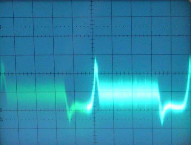

I added an oscillogram to illustrate the effect of a 3-stage stepped rectifier (low, high, full charge current). The voltage is measured across two inches of thin copper wire that is placed between transformer and rectifier.
First picture shows conventional rectifier, setting 10mV/div.
It shows large peak charge current (positive pulse) and a negative pulse caused by transformer back emf.
The second picture shows a 3-stage stepped rectifier added to the same circuit. Both peak charge current and transformer back emf are now reduced, setting 10mV/div.
The stepped rectifier tackles rectifier switching noise right at the source, by doing so it also reduces EMI. Other nice side effect is that the smoothing caps now run cooler so their service life is increased.
