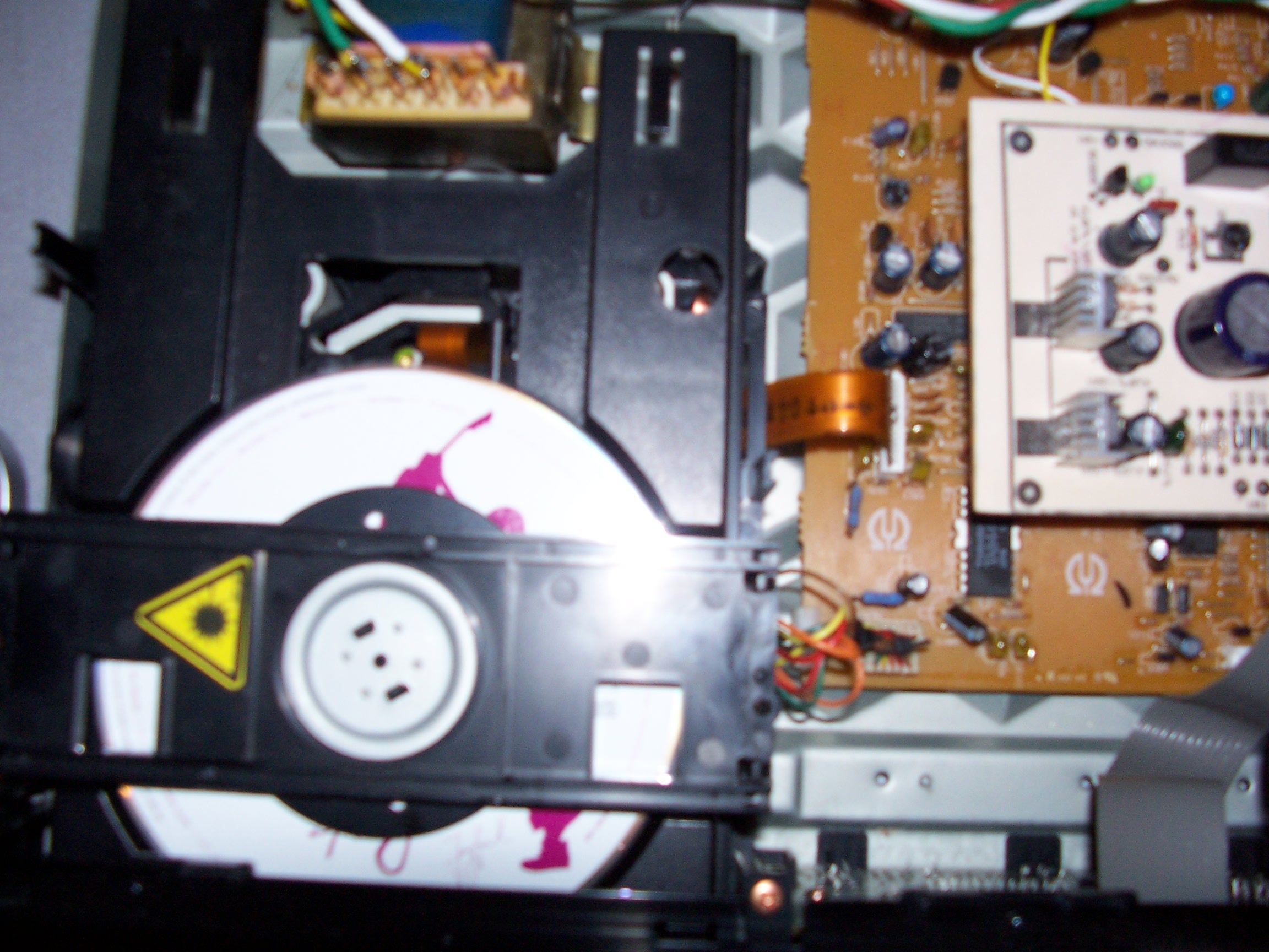

Goran Hi
It's started to change track very slowly and struggles with the last one.
Also the movement up and down at the edges of the disc is quite noticeable
but I can not work out why. The magnetic puck is doing the same job and was not supported by the plastic transport frame during ' PLAY '
I'll change the caps back to 100 uf today and let you know if this improves track search.
Since inserting much larger caps on the dac board and also on the main board
the sound is changing quite a bit as time goes on. I think for the very first time I am hearing burn in - I can't believe it😱
I always laughed at burn in comments but now I'm starting to think it's possible😀.
Thanks for the offer too - yes please !

No problem, ill make a board for you, just i need some free time.
Burn in works. For example its very noticable on the SE amps where the output caps are necessary. I was generating the white noise signal from the PC to the input of my SE amp for 48 hours. After that sound was improved. As i suggested you earlier you can record the white noise signal on CD and let it play for several days. You will notice the difference.
I really dont know what could be the problem with your transport. In my case there was no such a problem.
If you cant fix it, just put it back on the plastic case, like it was before.

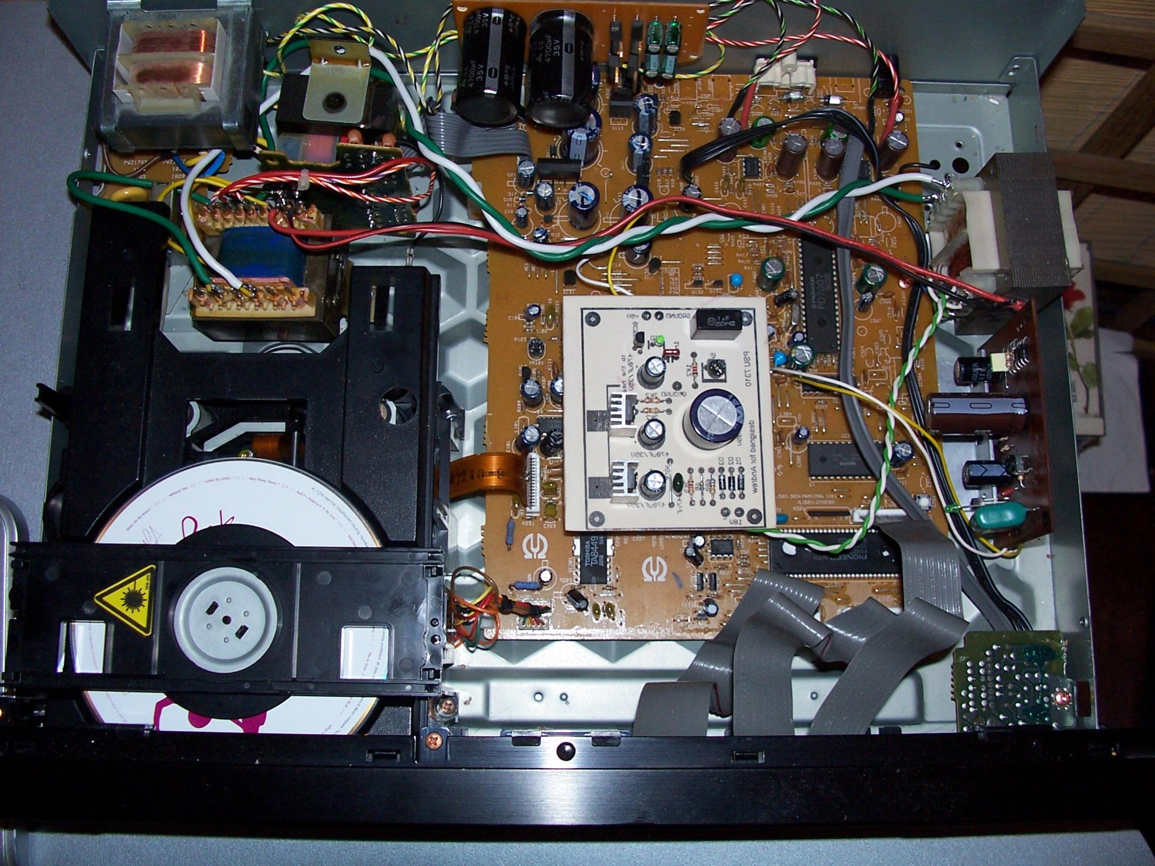

Now the player runs with TDA1541 and 7220 boards installed.
It is quiet good. Still needs some burn in time.
So, the RIFA's doesnt look so funny now 🙂
Board for TDA1541 works? I can make one for my self now 😉
Do you have a separate regulator for 7310?
For 7310 no I dont have one,yet.
The board is perfect. It just fits in the case tight. No need to screw it.
The only think I changed was a +5V cap at the 1541, so sound now a little different. I had Cerafine and changed it to Oscon.
I might prefer the Cerafine there.
Or it needs some time to burn in.
So now you can make boards for 1541😉

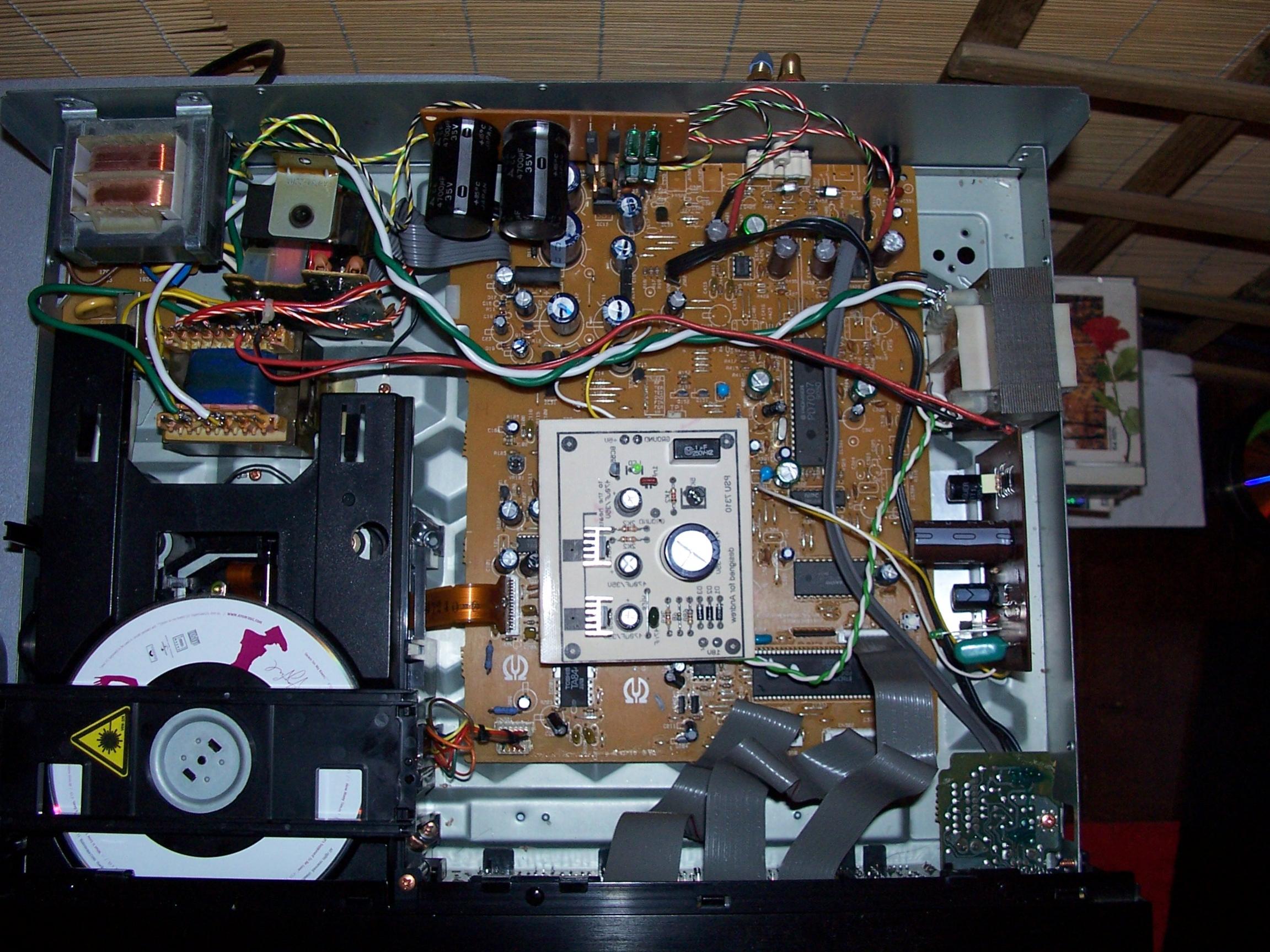

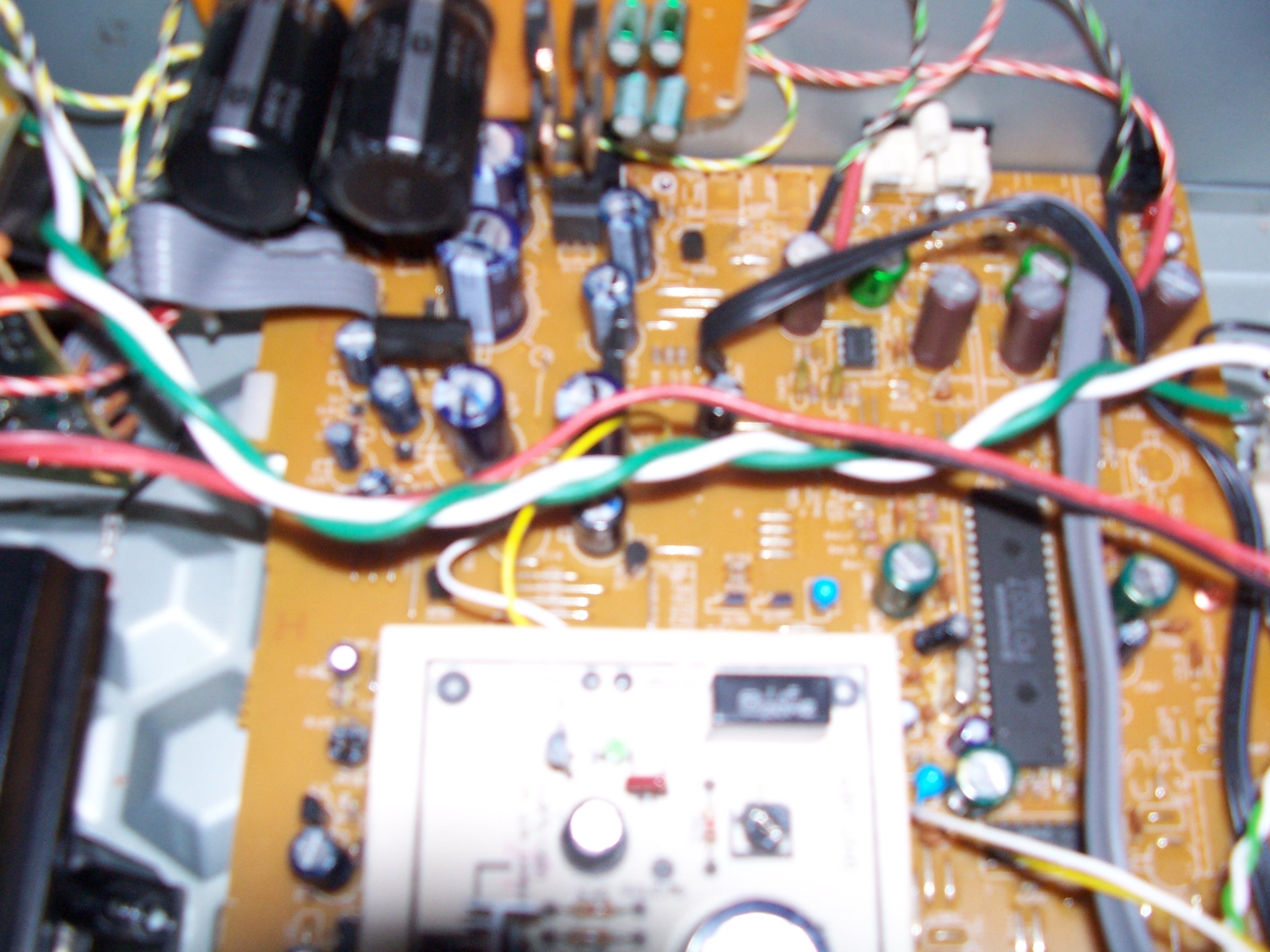

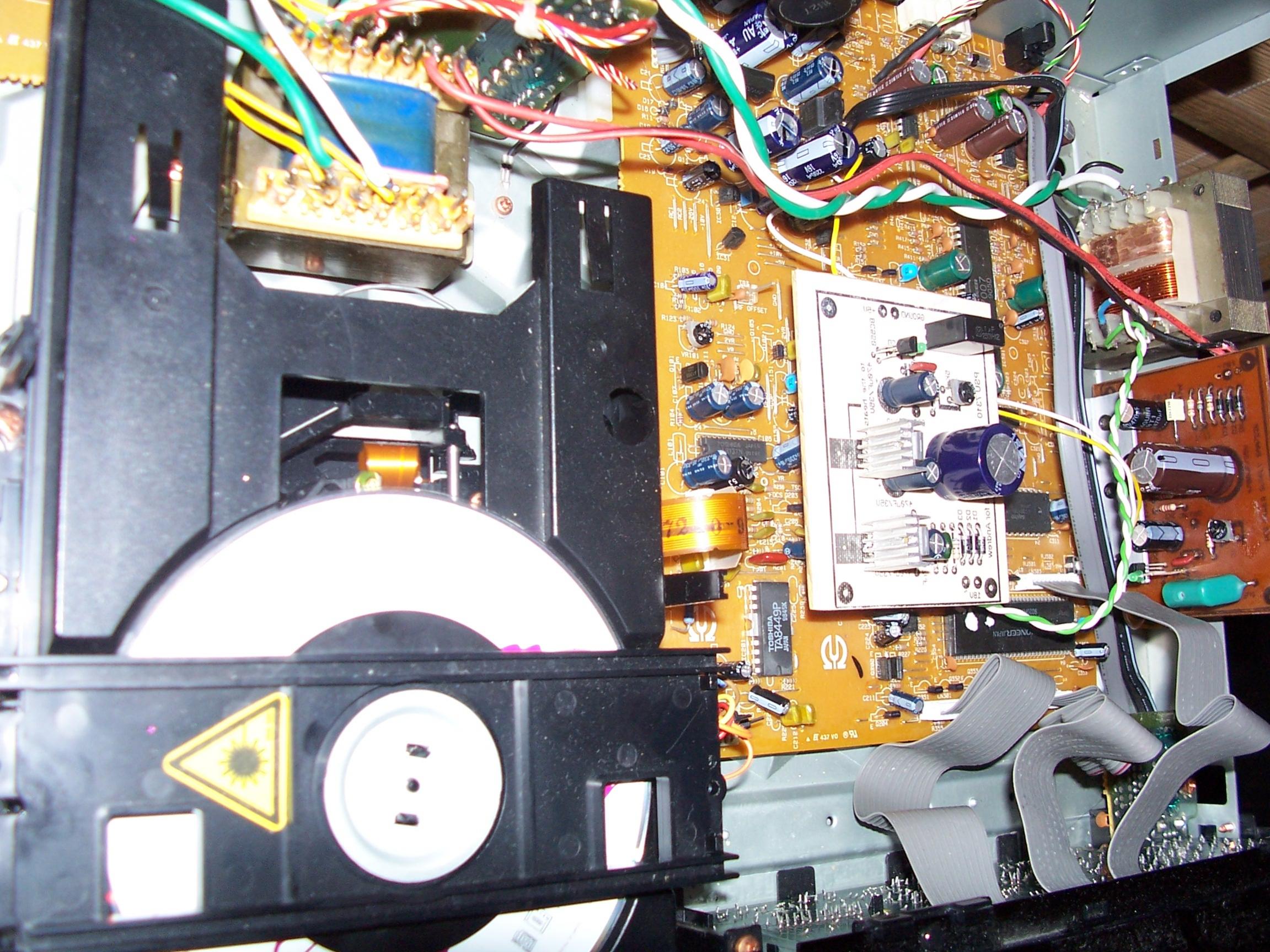

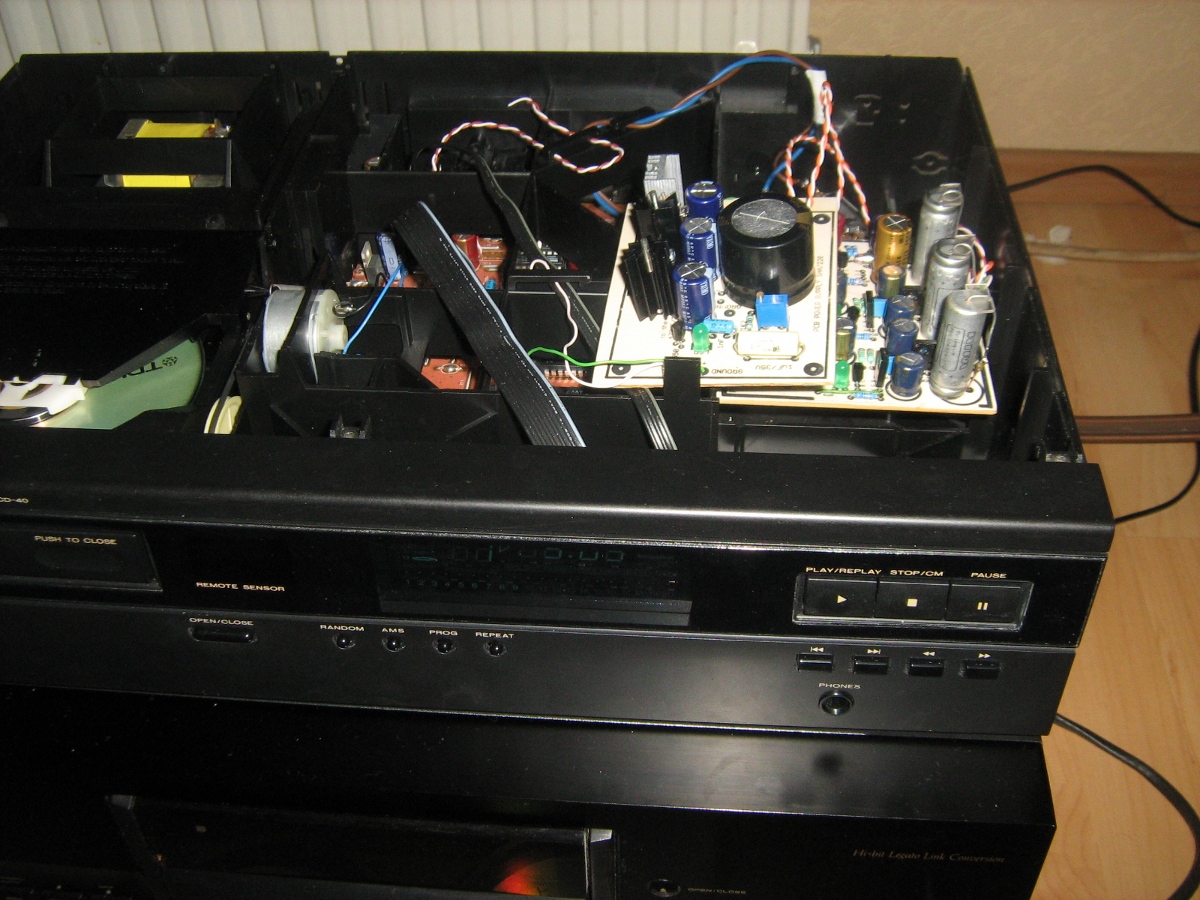

Hi Andrew,
The Pionner i have is a comercial model PD6500, still no top-loading, i didnt had time to play with the transport yet. The DAC is 1BIT PD7007. I added PSU&trafo for the DAC, it use +5V just. PSU&trafo for the audio stage (MUSE on the output and silimics for decopuling), and PSU&trafo for the SM5840. The sound is much more deatiled compared with the CD40 or telefunken. Sound stage is better balanced, simply it sound different. I really cant say which player sounds the best, I always liked the sound of the TDA1541.
The point is, every player can be modded to sound good.

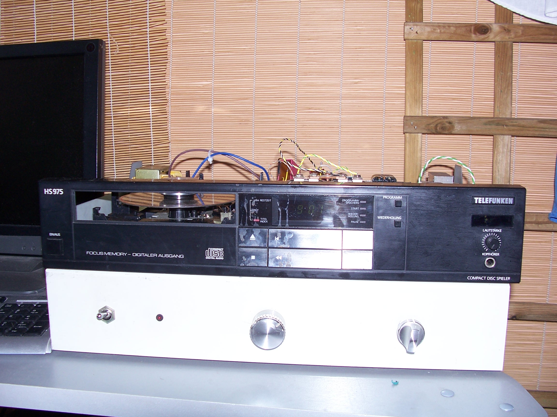

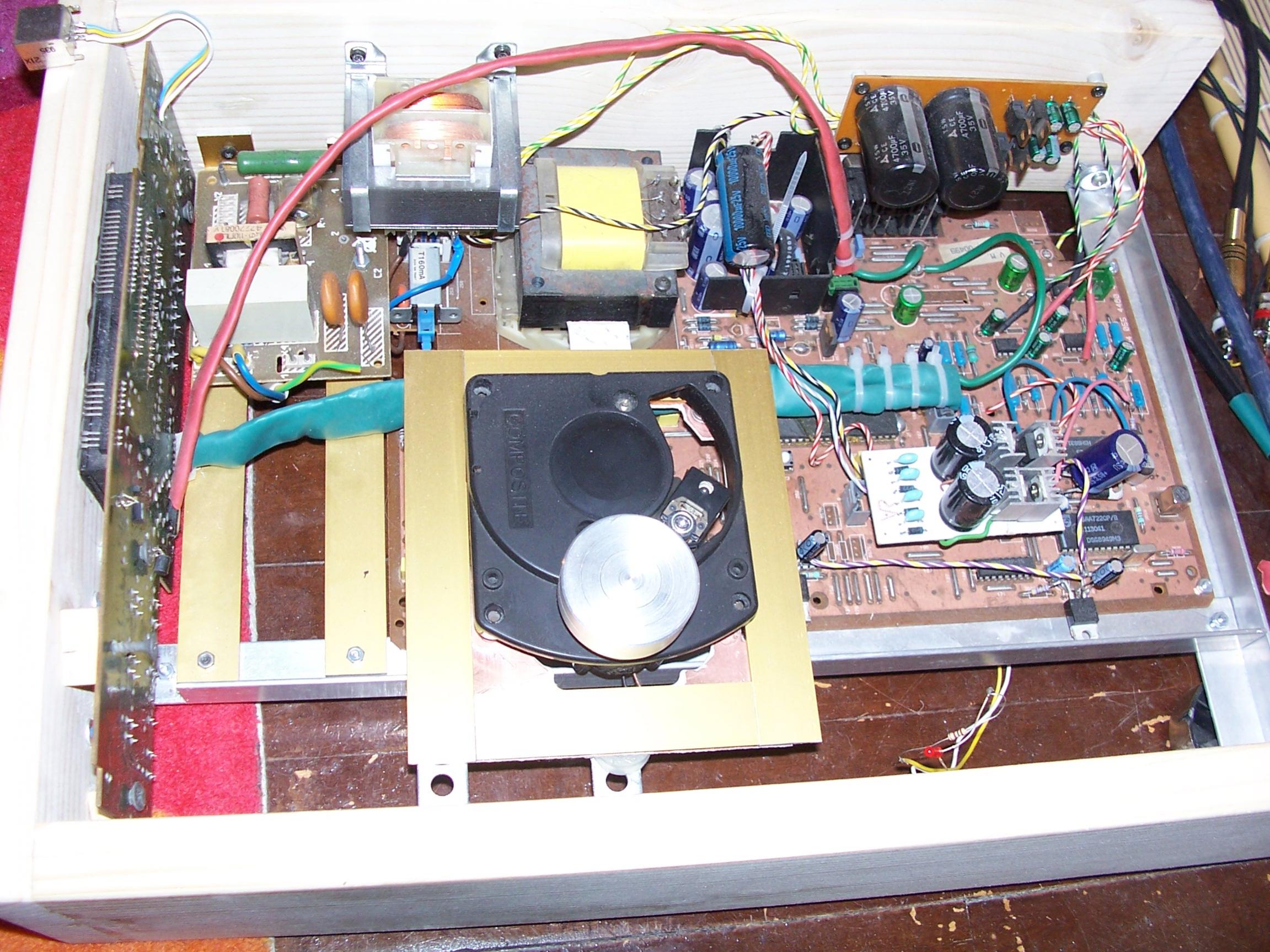

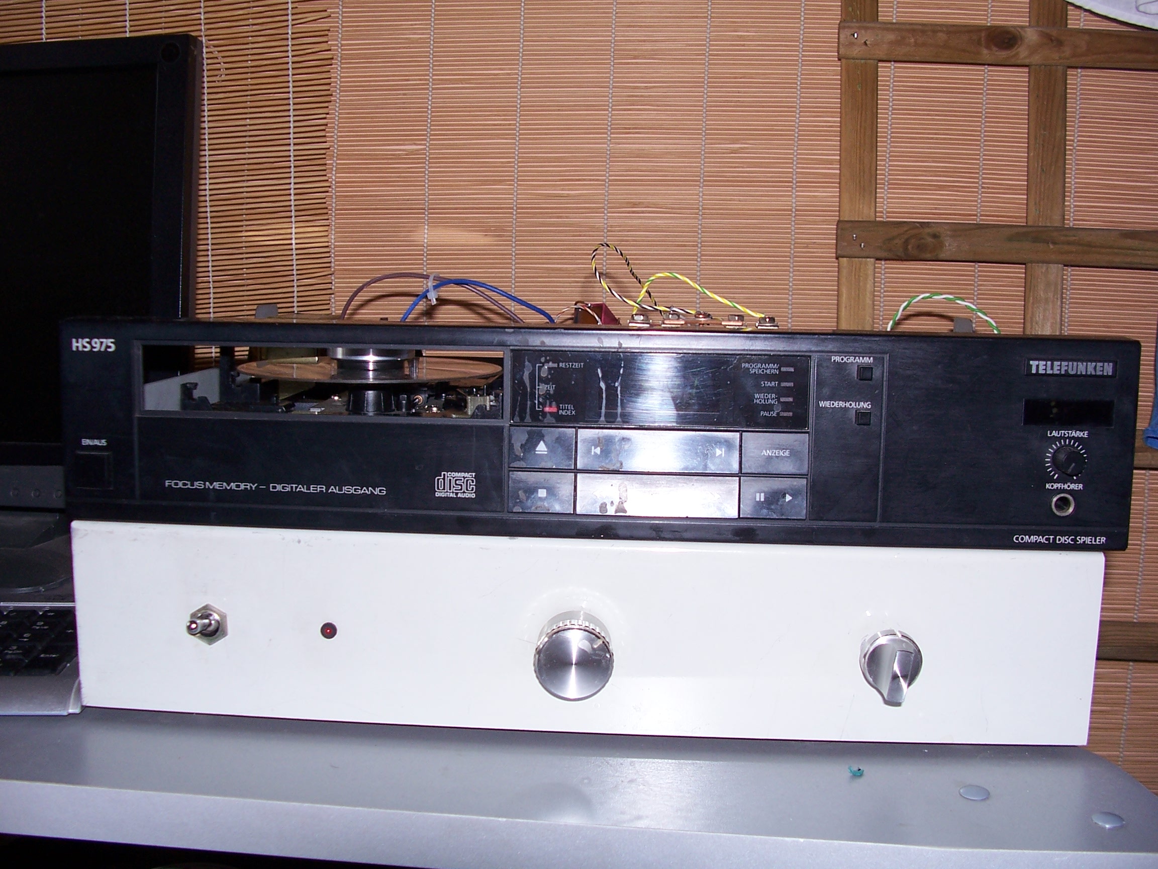

For example, the telefunken HS975 use no name DAC 16 bit TD6720N, the power dissipation is 1500mW, i really had troubles to add the PSU for this DAC, but when it was done it started to sing well. I skipped the filter and tooked the signal from the Vout of the DAC directly to a tube gain stage followed with the tube buffer stage. Sounds better then CD40 definitly. Ill try to do the same thing with Pionner.
You are asking where all this will end, you know the answer, it wont be an end. We will always look for something better. Its not just the CD player which should be modded, the preamp, amp..... speakers.
With the modded Pionner i can hear the sounds and details i didnt knew they exist on my CD's.
Some photos of the telefunken connected to a tube preamp, and few of pionner.
