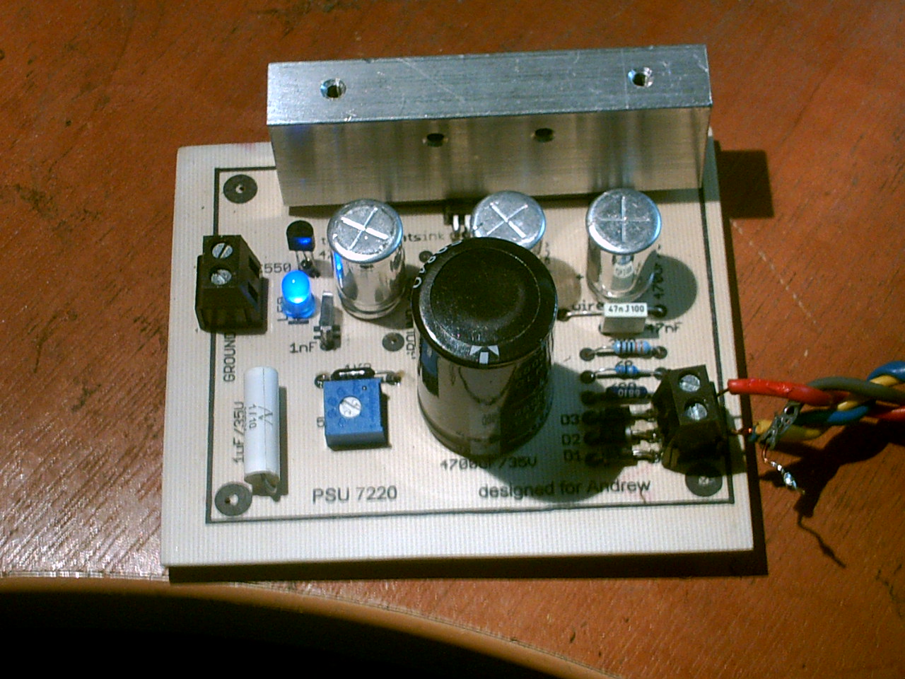

Nice boaard you have there
What is the value of your trim-pot? Is it 5K? I didnt had such a problem and i was using the same board. Maybe try with green led. Or decrease the input voltage. Anyway when you will connect it to SAA7220 the voltage will drop.

Hi Goran
It is a nice board - very happy
The input voltage is at 17.4 volts ac but the 5K trimmer only rotates once.
You suggested multi turn 5K trimmer - the mistake has been made here.
I'll have a new multi turn here tomorrow and will change this straight away.
I hope it works but if not I'll give it 15 volts and see what happens - is this OK ?
Will a green LED make much difference ?

Decrease the voltage and check if trimmer is ok, you should connect the 2 poles, (middle and the last one together to the ground) but im sure you already did that. The multiturn trim wont solve the problem, but it will be good to have it so you can adjust the voltage very precise.
Again, decrease the AC voltage on the input, remember you are testing it without load. Fix it on 5V then connect it to SAA7220, the voltage will drop, so you have to adjust it again very carefully to not go over 5V, thatway multiturn trimm is a good a option.

I tried 13 volts ac and I get 5.5v dc out minimum ( no load )
Maybe multi turn will do it.
I checked all my joints and connections and they are all fine.
I can wind it up to 10 volts dc so the trimmer is working and can only be installed one way on the board.
I just loaded it and get adjustment under 5v = result
Before I fire it up properly do I need insulating pads between BD139 and heatsink ?

Andrew, LED's have different voltage drop and noise.
Infra-Red LED, approx. 1.3V
Red / Orange LED, approx. 1.9V
Yellow LED, approx. 2V
Green LED, approx. 2.1V
Blue somewhere around 4.0 V
Don't use blue or white LED's, they are very noisy.
go for green leds.
Thanks Bardos.
I'll go green then
