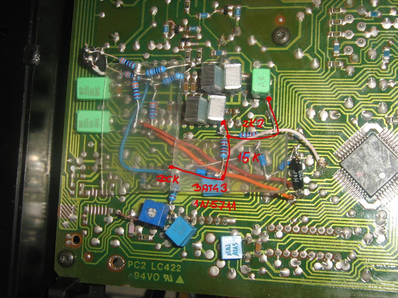

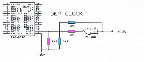

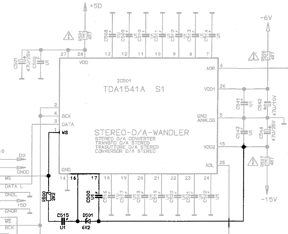

The attachment - this is DEM re clock ?
Can I try this with all my other chips clocked at the same time ? ( 7310, 7220 and TDA all clocked already ? )
What I mean is : MY CD Player has the standard crystal removed. MY new clock sends 11.2 mhz signal to 7310, 7220 and pin 4 of TDA. My clock then sends another 5.6 mhz clock signal to pin 4 of TDA ( I think that's right ! )
So, leaving all this in place I can then follow the drawing and connect pin 1 to 16/17 using a resistor, zener and cap ?
That's it for DEM ?
Confused 😕
Andrew
That's it for DEM ?
Confused 😕
Andrew

Hey Andrew,
I never tried this kind of DEM clocking. There are many ways doing DEM clock,but the easiest to get from BCK line with 1N5711(or BAT43) 12K resistor to pin16 (pin17 not connected).
And 2k2 from pin16 to -15V.
It should work with 5,6Mhz, I use 2,8Mhz in NOS mod.
The resistor value can be 12 to 15k. for me 15k worked.
If you have inverted clock signal then you can use pin17 with it.
There is a treat on this:http://www.diyaudio.com/forums/digital-line-level/11949-tda1541-dem-reclocking-21.html
Danico
To clock pin 2 and 4 I had to lift the BCK resistor ( nearest leg the chip ) to feed in my new clock signals.
New attachment - your pic - looks like you connected 2K2 and 15 K
to pin 17 ?
Am I wrong ?
Andrew
It really looks like connected to pin17,but I did the pic when I changed the 13K to 15K and it was unsoldered.
pin16 is the way to go.

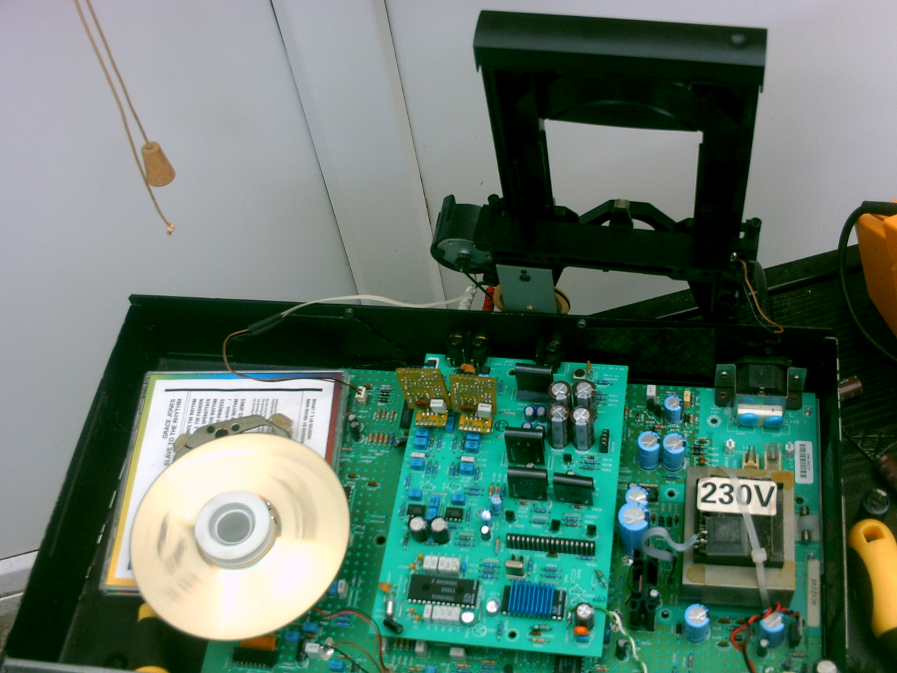

OK, project has started and looks quite funny right now.
Had to short the tray switch wires to make it see the disc and play.
Now, how do I get rid of the loading tray completely Goran ? ( standing up at the back with the motor still in it )
It won't play when I unplug it - do I short that too ?

Yes get read of that motor for the mechanism.
There is a micro switch, (at least in my cd 40) when the cd is inside, the mechanism is pushing the switch. You have to look where the switch is located in your player. Press it with your finger just for a second or two, the cd should start spinning to read the data. Of course you can mount a switch to the main panel to make things easier.
Done - works = result !!😀

Won't be long for me now - pics soon of my frankenstein monster😀
Just as you reported .. taking all the plastic loading tray bits off completely and just using the laser unit makes an immediately noticeable improvement - and It's still not mounted properly yet 😱
I was not expecting this at all !!
I have so far heard big gains from adding decent power supplies and doing the clocking to various chips simultaneously.
For me this transport / laser unit mod is in the same order of magnitude.
Thanks for this idea.
Andrew
