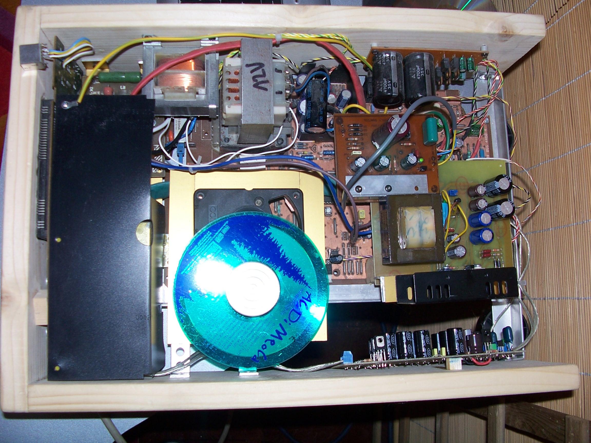

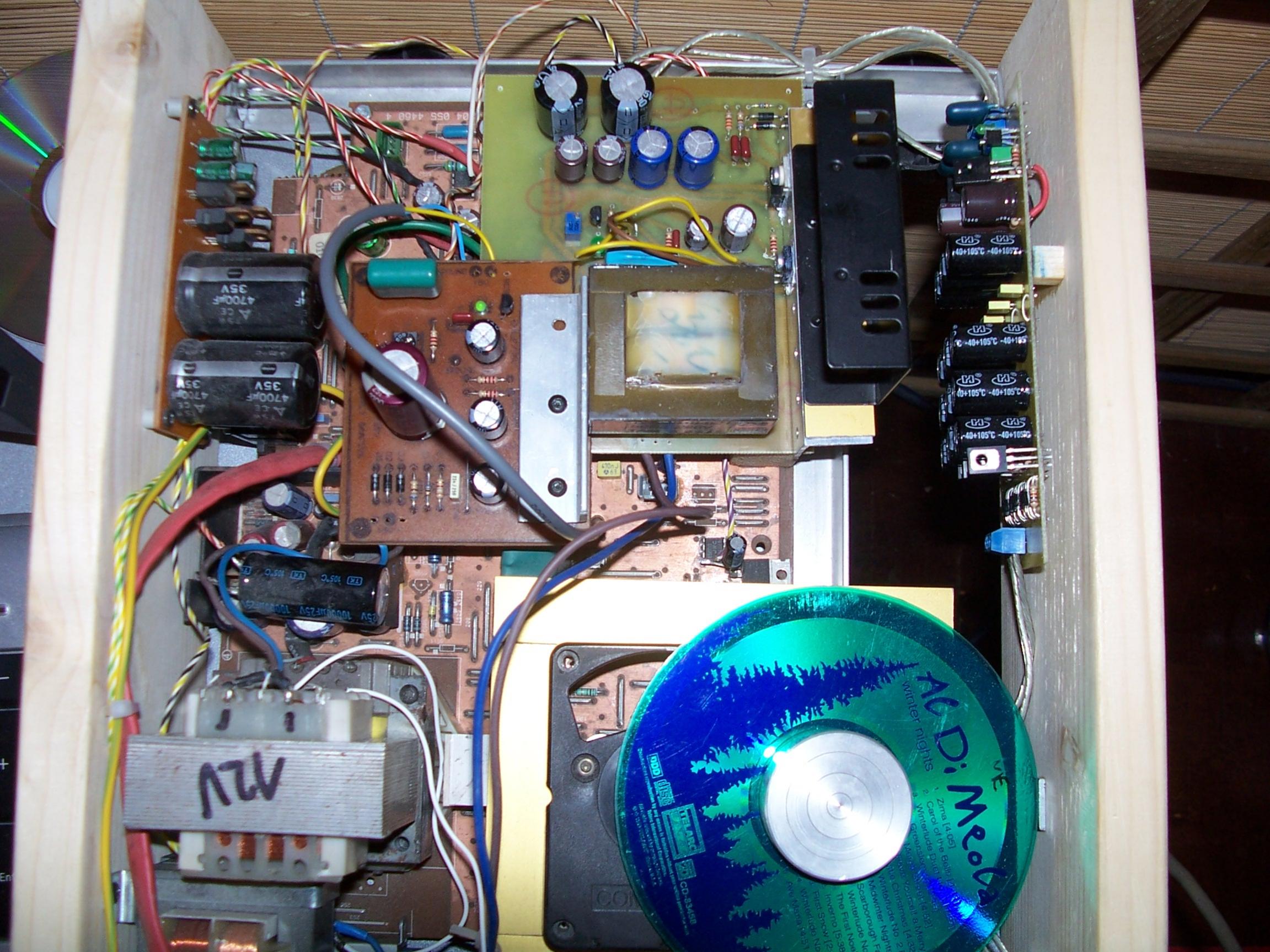

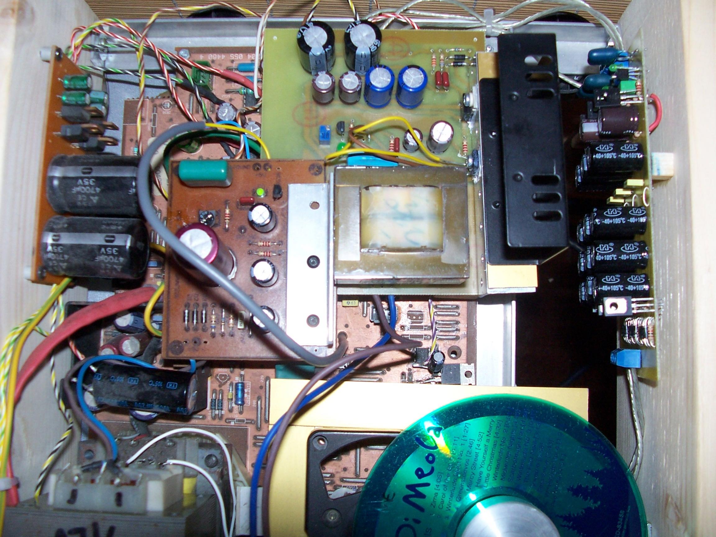

I have instaled another power supply with separated trafo for SAA7310GP. Sounds awesome!!!!
With ~12V in the input, it was easy to get +5V on the output, because SAA7310GP doesnt need so much current, something arround 50mA.
I really like how it sound. It improved the sound a lot, more natural highs and deeper and cleaner bass, abt middle range....have no words, its perfect!

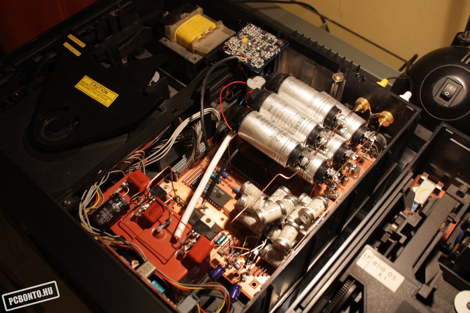

Some photos

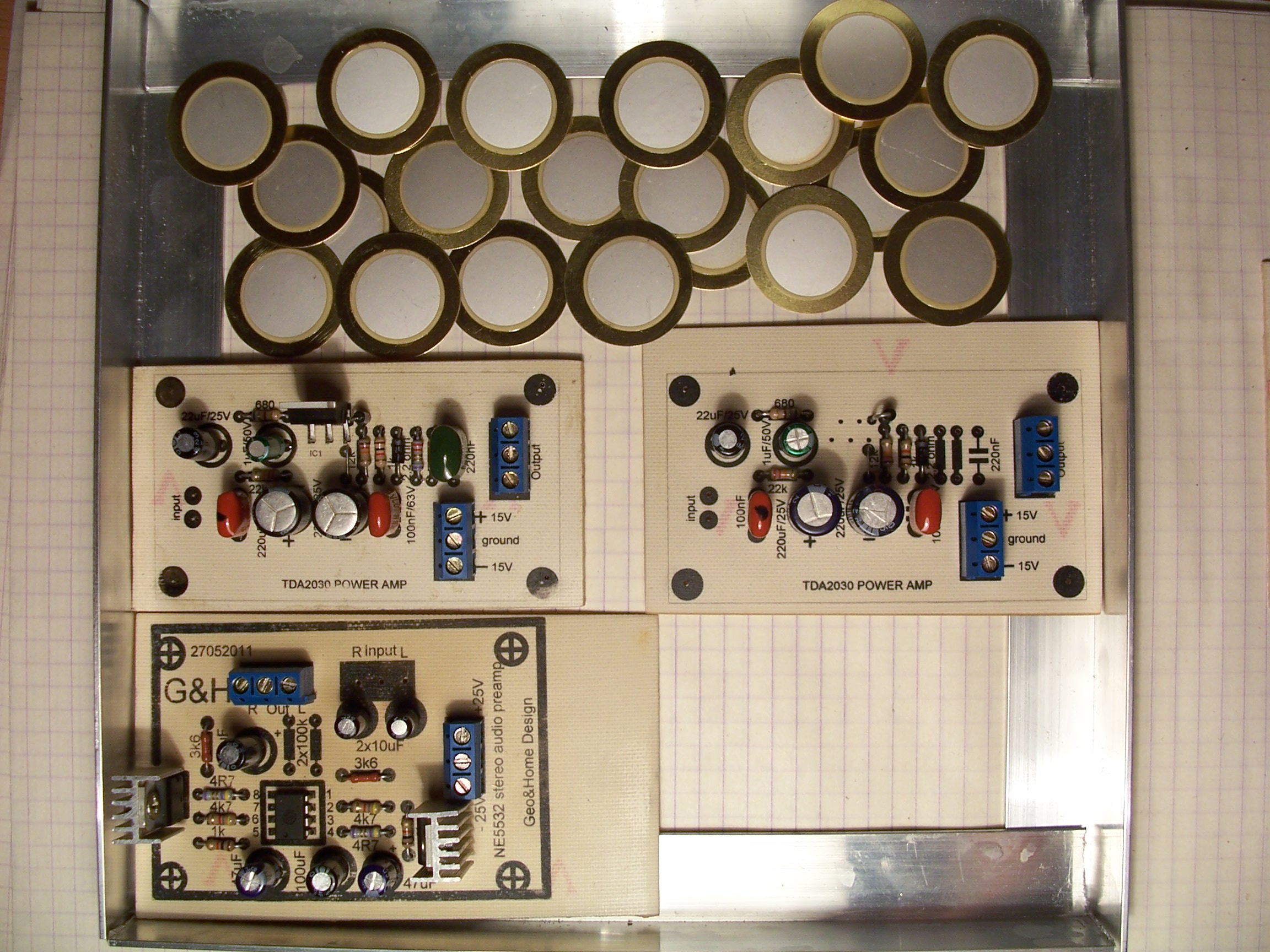

A small digression abt PCB's.
What can be achieved in home conditions, using special paper for laser printers, some chemistry and hot iron 🙂
Anyone can make the PCB of this quality and even better.
Im astonished with the sound of this CD player, I have never heard something like this and i just cant stop to listen the music. I highly recomend the separated discrete power supply for SAA7310.

We know it doesnt look nice 🙂, but when ill do all mods i will put it in a nice box and new PCB's
For the RAM i have ordinary cheap regulator at the moment, but ill design one bigger PSU PCB for all chips.
Servo is also on ordinary regulator(can you suggest some PSU?)
Im very currious if discrete PSU will improve the sound of the analog stage.
And, yes i need more space, at the moment i have 5 trafo's: one for the analog output, one for the TDA1541, one for the SAA7220, one for the SAA7310, the fifth one is for the rest 😉
No NOS mode still and still with LM833 on the output, I will leave that for the end.

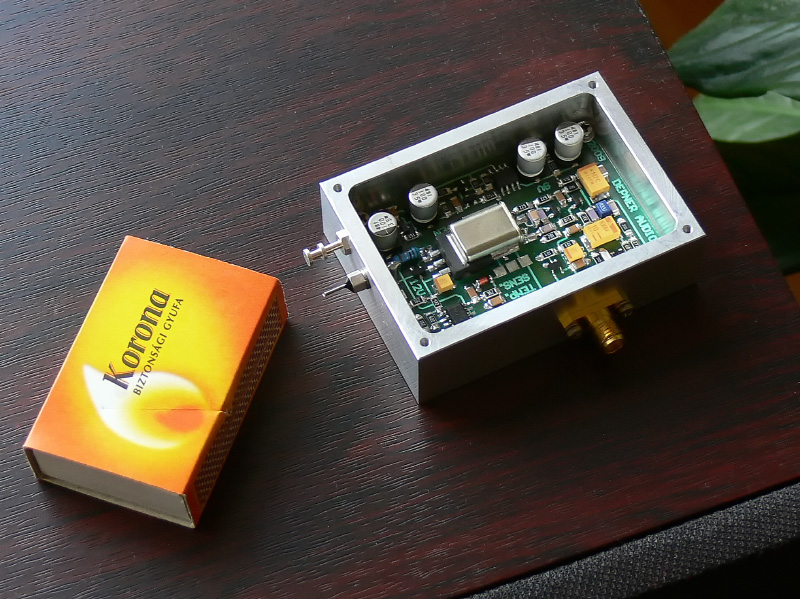

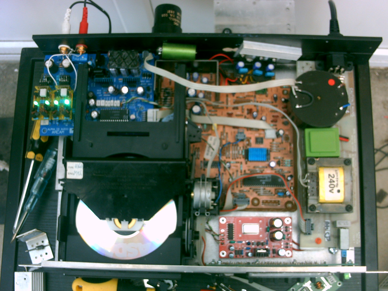

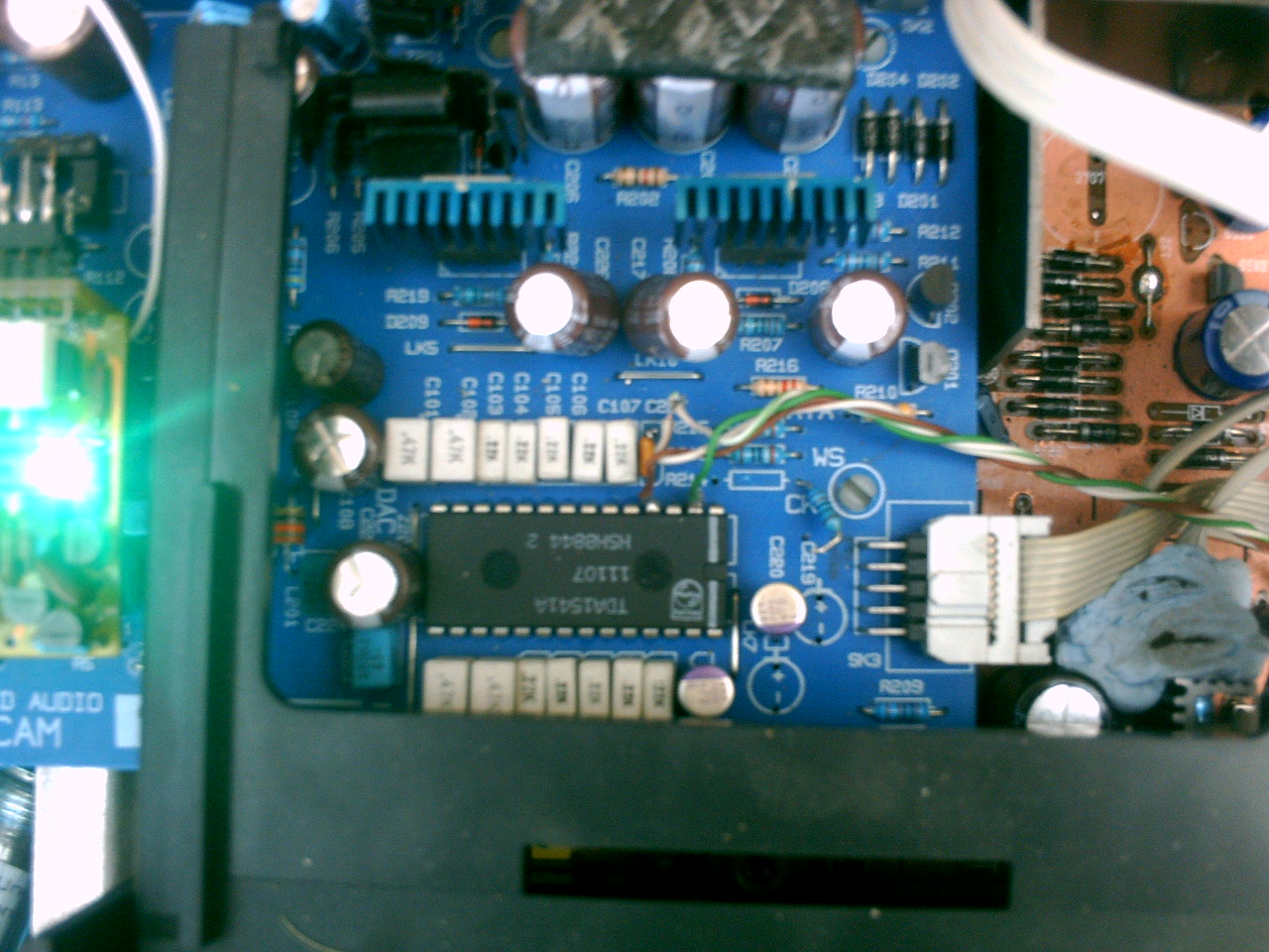

The pics show the red Vintage Audio lab ( E Bay ) clock which will give you separate 11.289 mhz, 5.6mhz and 2.8 mhz clock feed. The pic of the TDA 1541 shows where the wires were connected to feed 11.289 and 5.6 direct to the chip. The 7220 has it's own 11.289 and the 7310 has it's own 11.289 also - I had to cut some traces on the mainboard to make this work.
The player is amazing compared to how it started it's life.
I's not the greatest clock in the world however but it provided an amazing upgrade over the standard crystal - anything will !!!
I am at the moment running the 7220 from it's own transformer, bridge rectifier and large capacitor into a 7805 ( not shown in the pic ) but a considerable improvement was gained. Your board will provide a further improvement I am sure.
Hope this helps in some way - can't wait to try your boards !!

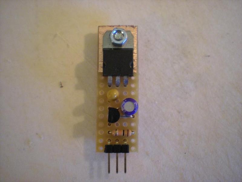

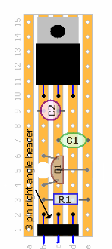

Here's a better pic.
There's a BC 547, Oscon cap, Tantalum cap and a resistor plus the +5v reg.
Easy drop in replacement.
No good for 7220 of course - but good for 50 ma MAX - probably with a heatsink
squeezed in.
With some changes to cap and resistor values it's performance can be improved and also I think BD139 based designs exist too.
