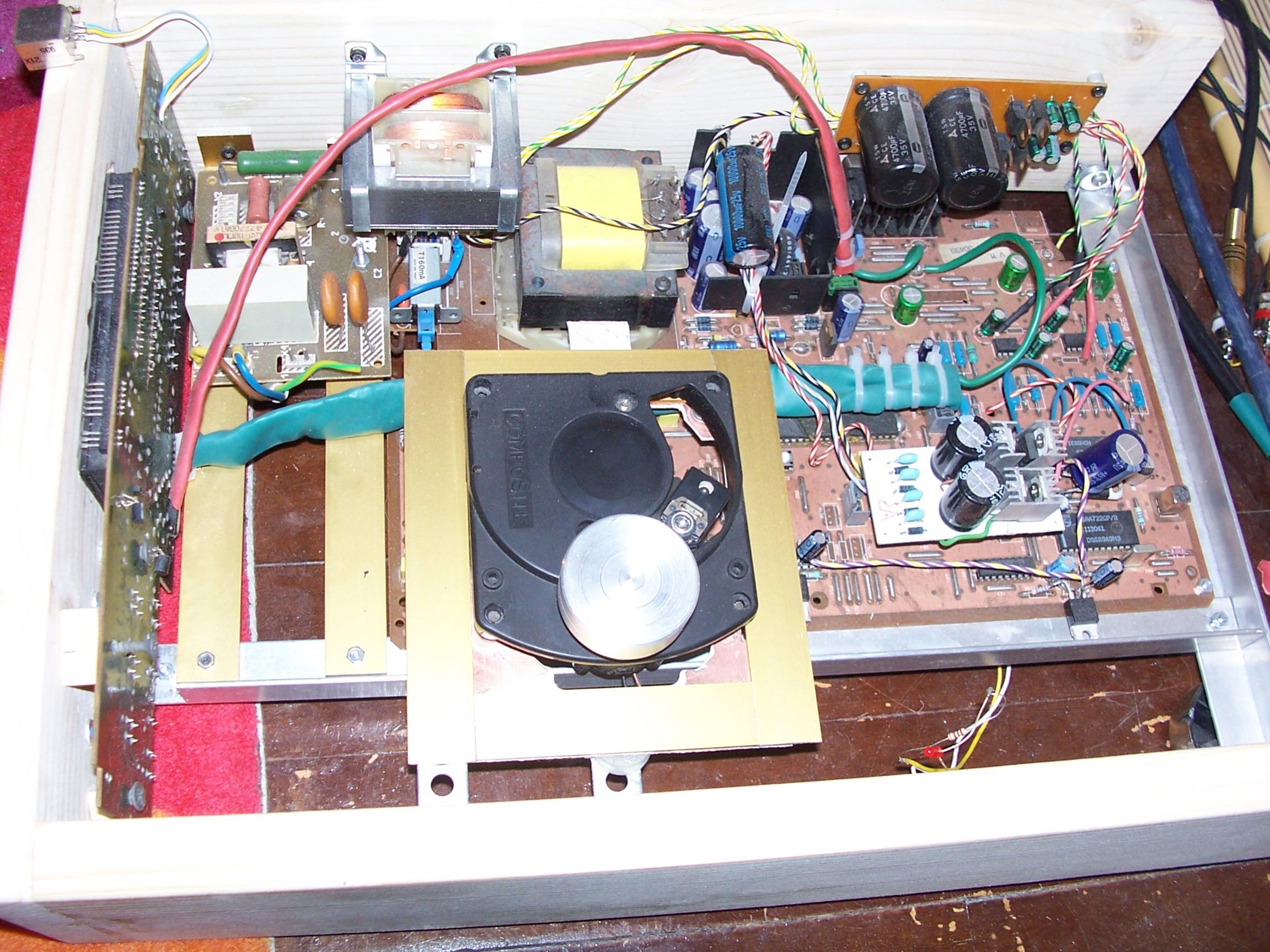

There are a lot of designs u can use, no matter what you will choose, i would suggest you to use the separate trafo's and PSU for SAA7220, SAA7310 (the best results in my case) and of course separate trafo and PSU for TDA1541.
Photos of my marantz and telefunken. You can notice how transport looks.

Goran Hi
It's started to change track very slowly and struggles with the last one.
Also the movement up and down at the edges of the disc is quite noticeable
but I can not work out why. The magnetic puck is doing the same job and was not supported by the plastic transport frame during ' PLAY '
I'll change the caps back to 100 uf today and let you know if this improves track search.

I really dont know what could be the problem with your transport. In my case there was no such a problem.
If you cant fix it, just put it back on the plastic case, like it was before.
