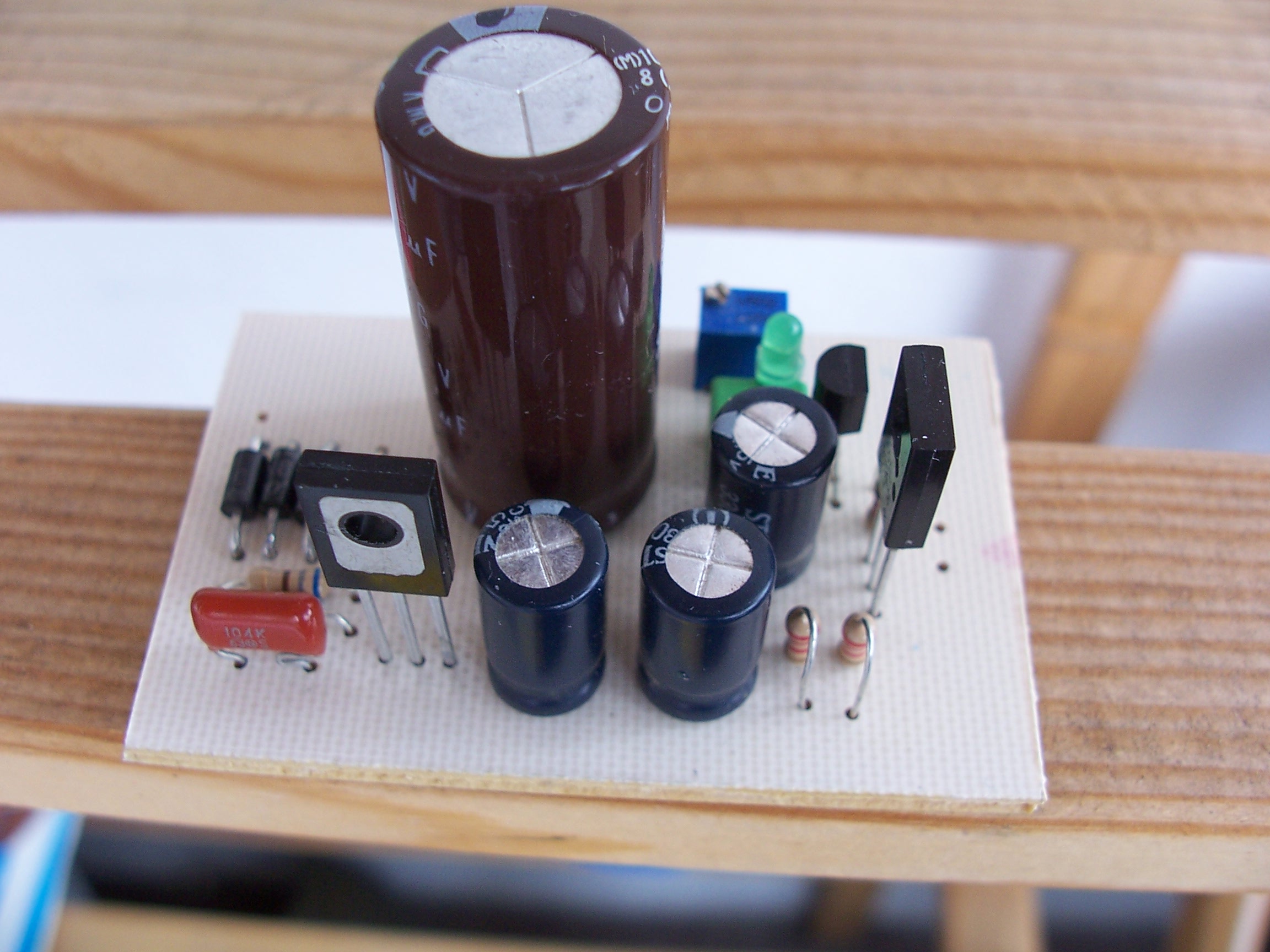

Well, I've fired her up and it's another big step - very noticeable.
But after some tracks my plopping and clicking noise is taking over - it's a real pain in the *** 🙁
At least now I know I can move it into my good CD player and not worry about an explosion 🙂
Did you insulate your BD139's form the heatsink ?
Andrew
If you use one heatsink for both BD's its necessary to insulate them

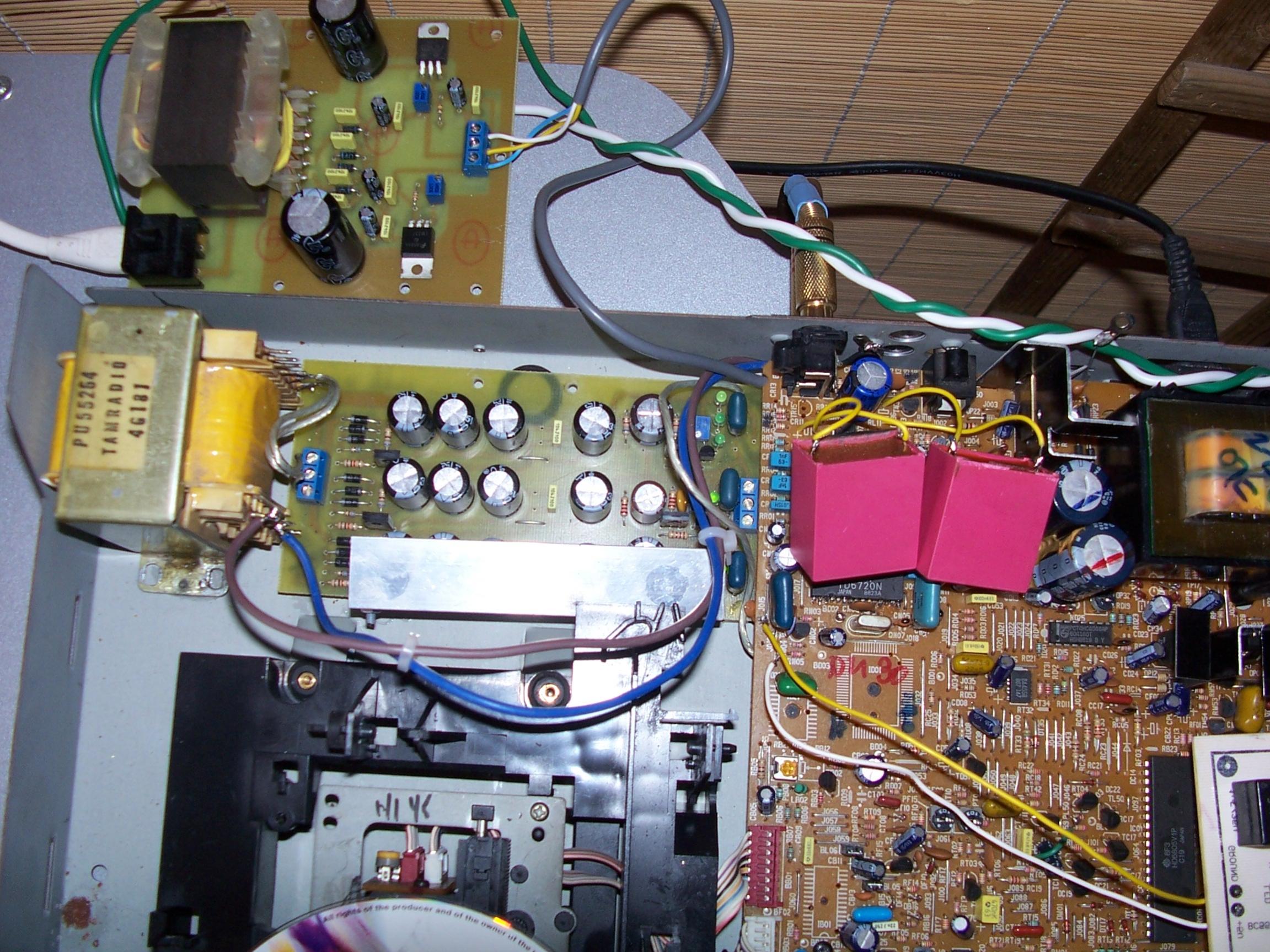

Neat work as usual !
Your 7220 boad - the heatsinks are really small on the BD139's
How hot do they get and what ac voltage do you feed it in the telefunken ?
Andrew

In this case i use 12V AC, but the chip is not SAA7220, dont worry if your BD's get hot on the saa7220, it was same in my case. Just use bigger heatsink and all will be fine.
Yes, that is definitely smaller then mine. 🙂 Nice job on that Goran.

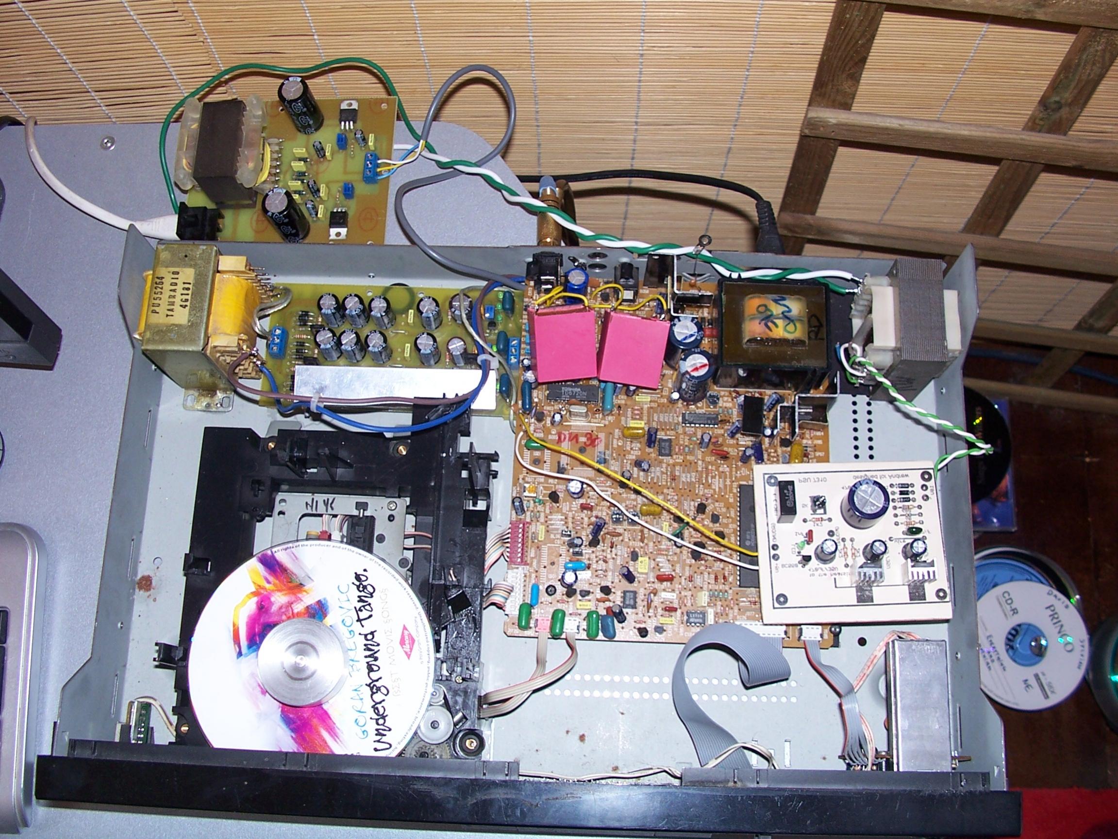

I just tried the ps on the 7220.
It makes much more different. (after Motorola 7805 reg.)
More punchy bass which goes very deep and more focust.
Also helped on the very highs.
After the NOS highs got a little shy but not anymore.
Tonight I build the 1541ps.🙂

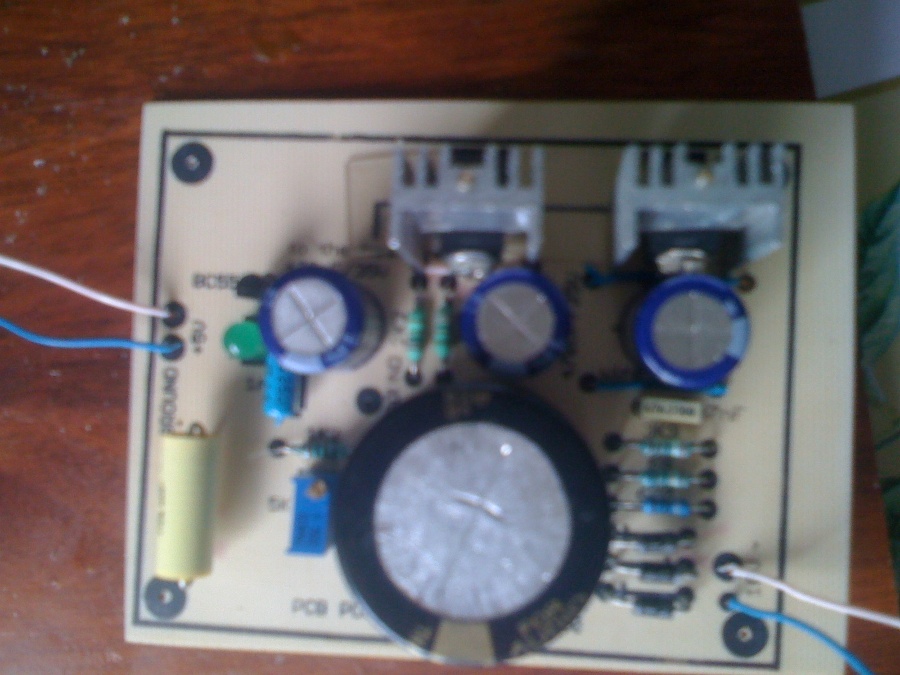

Danico, is there a schematic for this PSU pcb ?
Yes. It was taken from Ecdesigns treat. I can tell you with this PSU the TDA1541 takes a new level.
The 2 schematic were designed together by Goran.

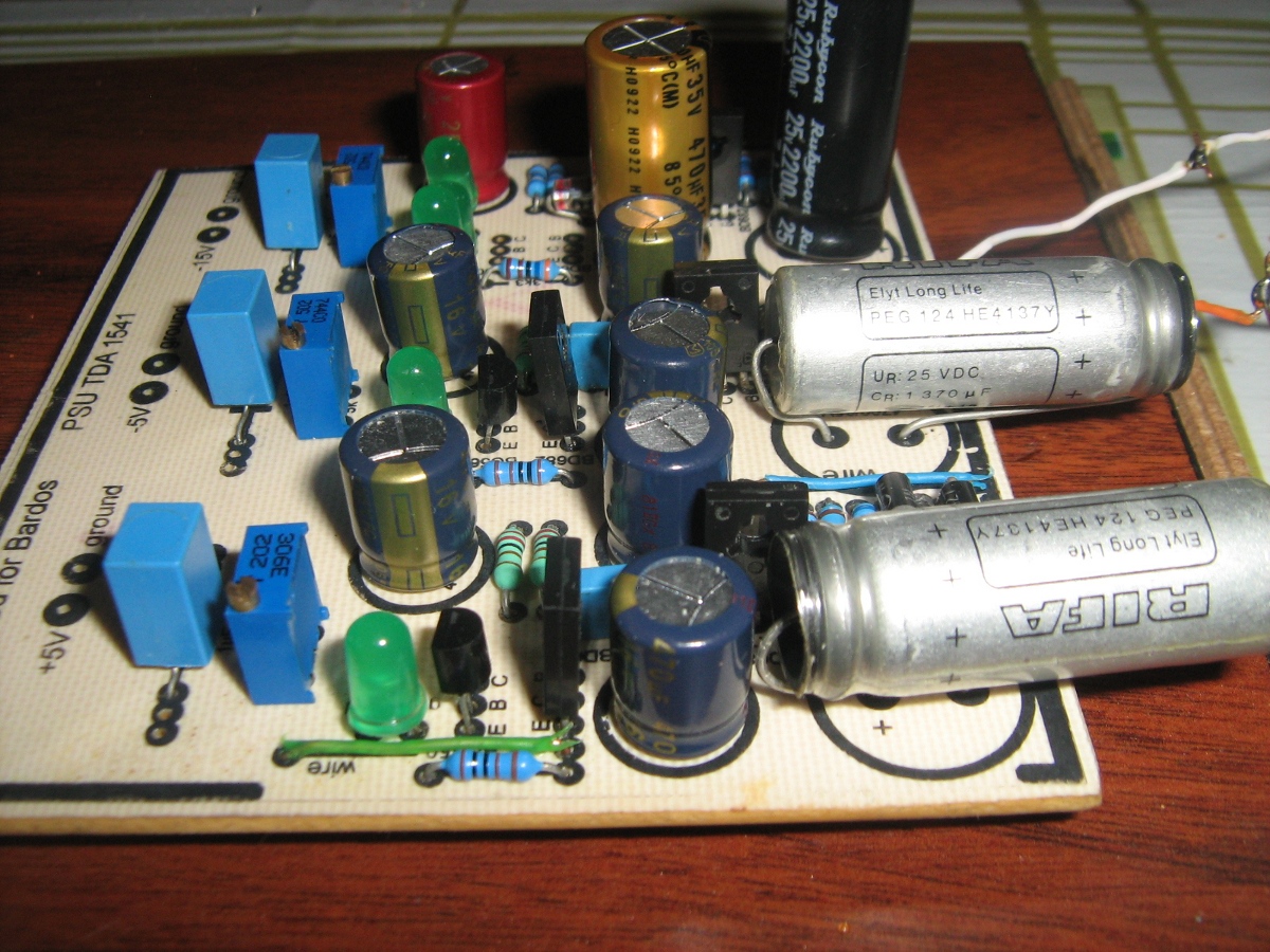

Hey Danico, good you fix it, I couldnt find any mistake in traces.
Because there was no mistake on the board. The BC560 was dead in the -5V stage.
The RIFA cap looks funny on the board but those were the only caps I had.
Maybe they look funny, but, that board was not designed for RIFA's.Because there was no mistake on the board. The BC560 was dead in the -5V stage.
The RIFA cap looks funny, they just deserve better PCBn the board but those were the only caps I had.
BTW i use the rifa's u send me as a cap cluster to the output of my amp. Before I had Sprague, im not so sure but i think that rifa's sounds better.
Thanks Danico, so are they a capacitor multiplier followed by a shunt regulator ?
You are right its a cap multiplier followed with a shunt regulator. In the case of +5V and -5V its only one green led, for the -15V you will need a three green led's.
