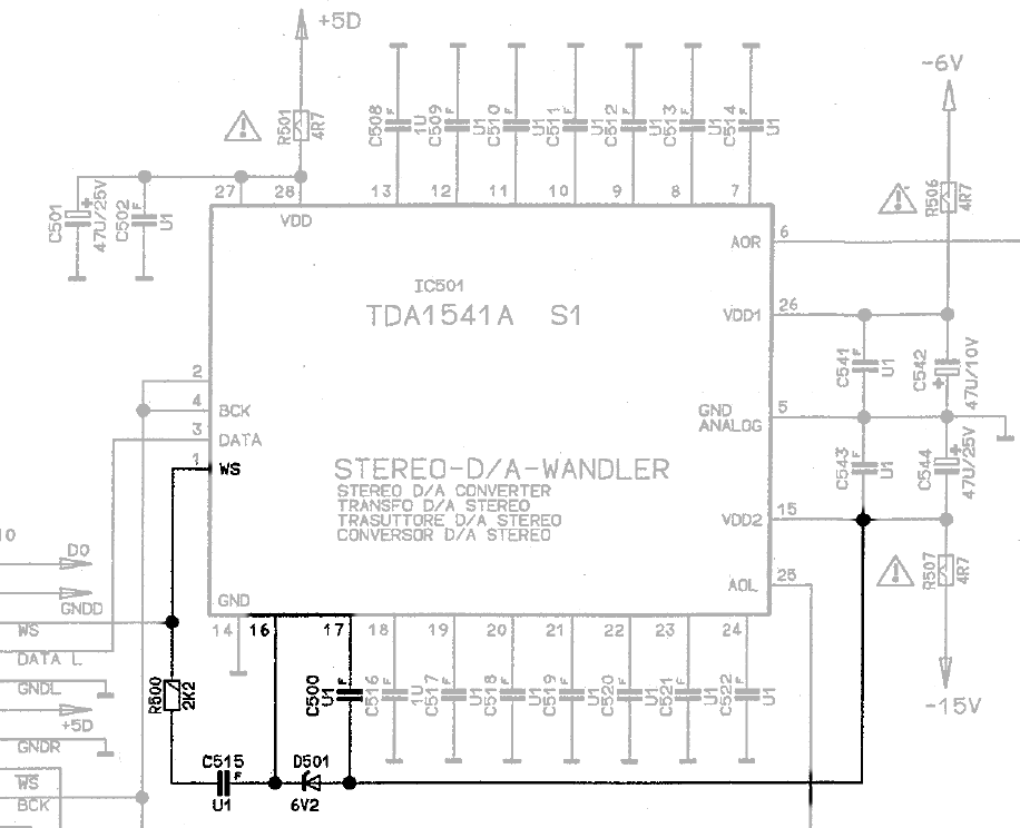

What is your exact circuit now?
You could have an impedance mismatch between the CD and amp. If this is the case, you should re instate the resitor to gnd as per your original circuit to see of this helps. Also, if you are using DC blocking caps, low value here can sometimes hold back the bass if the impedance is poorly matched.
I forgot to add the ressistor to ground after output cap. Im still not using those +15V in series with 4K7 and 5K multiturn pot. to setup the 0V, for now im trying just with cap on the output.
are you sure the filter values are the same? I have several TDA1541a's running in this configuration!
The filter values are same, ill try again with 10K to ground on the output.

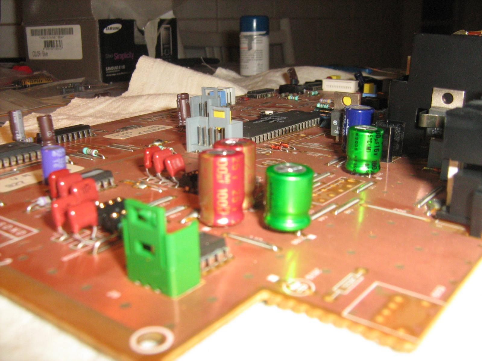

I ordered 20 peaces of ELNA silmic II 100uF/35V just to try if that will change something. If not, ill try with Black Gates.
In general, this modified Marantz CD40 can fight against much more expensive players.
Silmic II is very good. I just finished a NAD3020i and a Philips 610 using silmic II and oscon. they sound very good. I like Silmic II and Cerafine a lot. Someone said Silmic II is very much like Black Gate. But I dont know I never had BG to try.
And Oscons seems to work very good at digital power line at the chips.
If you wanna improve the sound a little bit change the wima decoupling to something better. Like naked polyester(MKT-MKH) like in the Naim cd3.
or polyester mylar. Only watch for the width, since the place is very limited. Hard to find a 2,5mm Width and 5-7,5mm pitch.
I know wima is not bad but not very good either.

Isn't the last stage opamp the filter and amp??
I think the first stage only does the IV conversion but does not amplify.
I believe the 2 stage needed to use it properly.

Nice boards 🙂
I readed somewhere that silmic II is much better then cerafine and a liitle bit better then Black Gate. For sure its subjective. The best way is to try different types and to choose what You like. I have never used Oscons, thanks for suggestions.
I know that WIMA are not so good i will try to find something better, but You are right the space is limited. Its very hard to solder a nice big polipropilens.
I just did the modifications as was suggested, without second stage and without the filters on the first stage. It sound very good, much more natural.
The gain seems to be the same without second stage, at least I cant notice a difference.
To remove the de-emphasis circuit it is only necessary to remove the fet.
The other components are still part of the overall filter. Removing them all will alter the filter characteristics especially at the very top end.
Andy
With the fet in the off state, that leave the 5m5 in circuit which I thought would effectively take that part of the filter out of circuit. Are you saying that even with this high resistor in series with the other components it will effect the sound?
With respect to the single opamp for I/V direct to the output, working on the basis that less is often more this circuit has a filter and enough output to drive into my amp. I've used this circuit on several players and dacs that I've built.
OK. Thanks UV101 to confirm the IV stage.
I just never seen this solution before and I tought the gain just wont be enough.
I will try next time when I take apart my CD again.

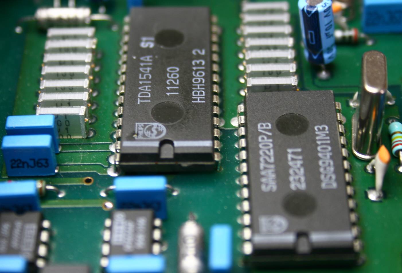

Yes polipropilens is a good choose. For the size anything above 4,7 will be good for output and the bigger voltage sounds better. Maybe because the better insolution?. I cant tell for difference in size between the same kind of caps. But I know I mostly prefer PIO to Film cap. Again it for personal taste.
As for decoupling on the chip I like to use simple L network.
Inductor and cap. Easy to put on the board. Also I know building on a separate board, like you did is much better.
For now I settled with 100uf, but I wanna try the 47uf size, too. Like in the AN dac. In my case the cd40 had 330uf on the 1541 I put 100uf oscon.

I listened my cd and find the bass a little bit less dinamic and its just didnt go deep enough. But it could be I got my hearing still on my friend Philips 610's sound that I just finished. He got my opa2604 and I switched back to the lm833. Probably I remeber listening the cd40 with the opa2604.
Tomorrow I gonna build a separate power supply for the 7220 and 7310.
that would clear things up.
I will try to find those Oscon's here and I will send it to You.
Im running my CD40 for 24 hours in hope that the new caps and the modified output will make an friendship 🙂
The best thing You can do is separated trafo for digital (separated rectifiers and LM regulators for every single IC), trafo for servo and trafo for audio. The top end will be adding a trafo for display and display controller. After this, You can go with NOS mode and tube output.

Yes I plan to do a separate section for the 7220 and 7310. Later I do the dac. I dont think I will have enough time to do the servo, but I know is important too.
