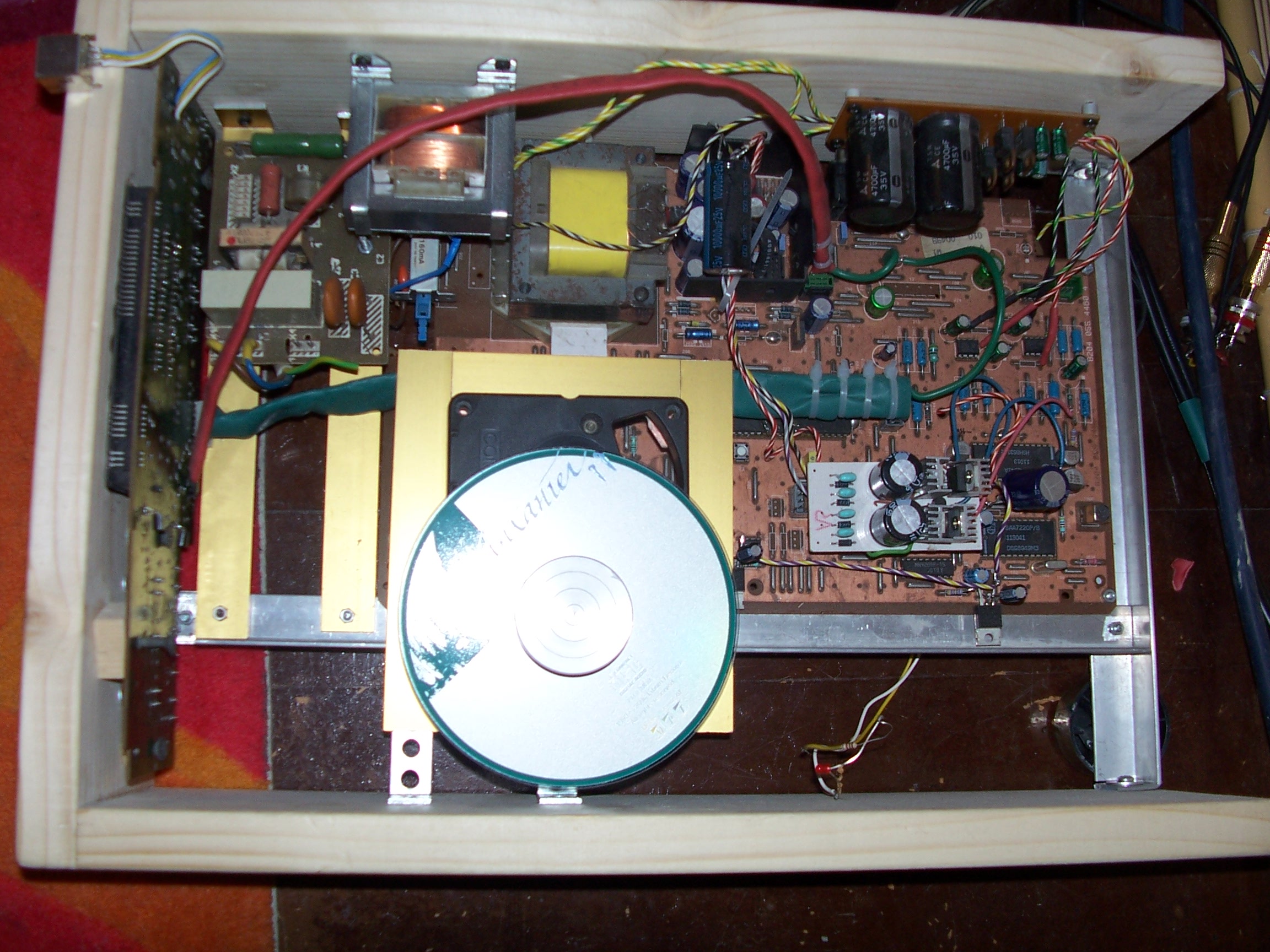

Thanks for the very well detailed info.
I did just bought this cd secondhand a little less then a $100. Here the prices a little higher because not too many of them. Although the used market on the local hifi forum seems to be very slow, so I could pickup some good player cheaper. But I didn't plant to buy this one either.
Anyway I planing to leave aboard so I cant get into a big project like yours.
I just wanna do the the very basic and important tweaks.
Just for fun and to learn new things.
10 years ago when I bought my first "real" High-End after a couple of months I went to San Fransisco, so I didnt even listen them too much.
Now I am back and since I got no job here I had to find something to do.
I finished all my gears upgrades, only this cd40 and the DAC-END left.
I might just do dumping the old case. I have been thinking about a wood sidepanel with coper underneath and something rigid at the bottom.

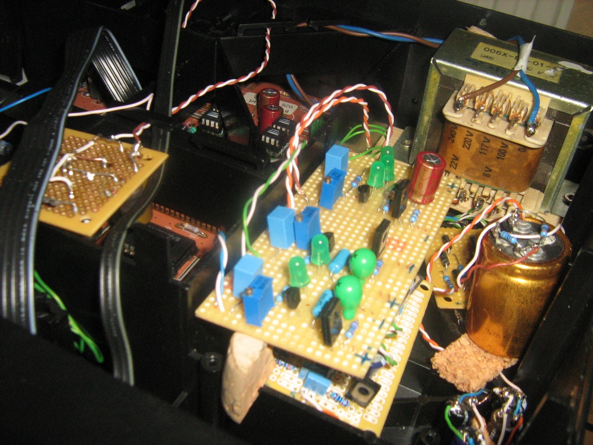

Now I just did sep. reg for the 7310 and 7220. I couldn't listen much, since I have finished it at 8pm. But it sounded quiet good. More air, much more clearer and very detailed. vocals sounded very silky and smooth.
I will listen tomorrow all day,let the new parts burn in.
this reg just temporary, because I waiting to get some better tantalums and LM317T. Later I will do the dac and the opamps.
If I find some cheap trafo I will do the whole thing separated.
I know its a must do.

Im glad you achieved an improvements. I would install LM317 close to chips to avoid wires. I did it in my CD40. Trafo You can buy for 20EURO, any kind will work. It will be better if its bigger. From the same trafo You can feed TDA1541 also.I think You need +5v, -5v and -16V. Ill check and ill tel You tomorrow. What tantalum You are using?
I modified Telefunken HS975, separate PS for audio stage, MUSE on the output (Ill try with polipropilens also). I changed almost all caps. Still sound digital, not even close to cd40. In general sound is very clear,but there is no space arround instruments. I tried to put another DAC in parallel (Telefunken use TD6720N Toshiba) it doesnt work, it must be im missing something. Also, its very hard to find some nice datasheet for TD6720N. Next will be PS for DAC. I hope that will gave me more natural sound.
Also i would like to try to use separate DAC's for each channel, just i need to do some research how to do that.
Mutting transistor are still on their place, I forgot to remove them 🙂
For audio stage in CD40 im using low ESR Vishay capacitors 220uf/63V. Im still waiting for silmic's.

I'm not familiar with the toshiba dac, but the sep PS must be good.
About the regs I just drop them in and it was the easiest way to do.
My friends coming over tomorrow so I needed to do something for a fast and easy improvement.
I dont wanted to take out the board again. And only had time after dinner.
The green tantalum?? I dont know the brand,could be Vishay.
I ordered some from that french store from ebay I linked. (yellow Kemet and AVX)

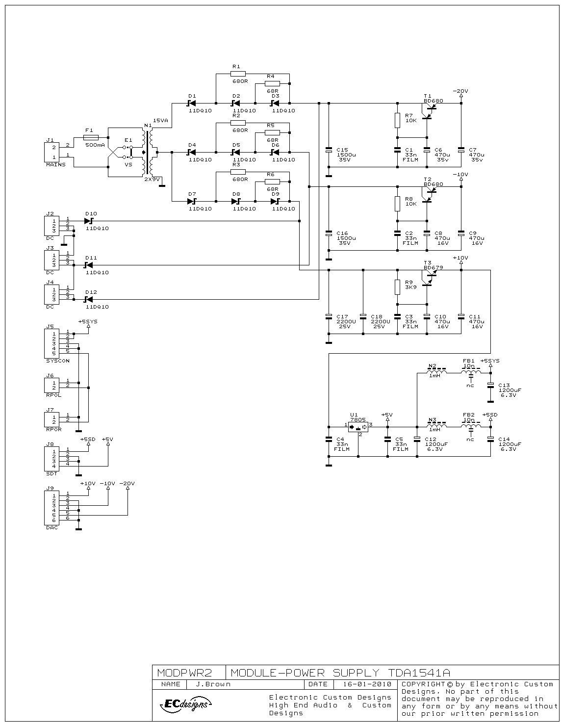

Hello Goran,
Its been a while. I have build some series reg. for the 1541 with a 3 stepped regulator taken from ECdesign.
Unfortunately I didn't got it to work properly. There was no sound only very quiet cracking noise.
After I started disconnecting -15V and -5V. Finally I got sound.
I assume it can be some ground problem. If I do connect the -15V ground to the jumper wire on the panel right at the dac, then the -15V became -12V.
Anyway I have to take the whole thing out, because the -5V miraculously not working. I tested everything 3 times before I put them in.
But the sound changed a lot with the 5V series reg connected.
Huge 3d soundstage, clearly separated instruments with very detailed sound. I have never heard cd-s playing these good.
Sound very much like a live music. I lived in San Francisco and 3-4 times a week I listened live music so I can compare what sounds good.
Last night I listened music until midnight and I can wait to listen some music today.
Goran do you have any idea what can be the problem? Should I just separate every ground even from the panel ground? Maybe I trigger somehow the muting transistor???
here is the power section and the series reg. from ECdesign.
Hello Danico 🙂
Nice to hear from You again.
Sorry you have problems with DAC PS.
Looking at your circuits i have feeling that you should use different transistors, BC560 could not handle the current whats required from TDA 1541. Maybe thatway voltage drops from 15V to 12V.
Anyway, i'll tell You how i did it.
I use cheap 7915, 7905, 7805. Unsoldered the ressistors near DAC from original PS rails and there i connect the new PS. No problems in my case. In the near future ill make new PS with LM337 and LM317.
I dont know if you have separate trafo for PS for TDA1541, if not, solder wires to the secondar of the present trafo you have 17-0-17, use shotky's for rectifiing and some nice cap's for filtering (i use cheap ones 2x2200uF/35V). Then just implement the 7805, 7915, 7905, solder the outputs of regulators to resistors near dac (first you have to unsolder that end of resistors connected to the original PS) Use radiators for 7805, 7905, and 7915, in my case the are getting really hot.
If this will work (it should work) you can upgrade the PS with more expencive parts.

I do have separate transformator. I did try the regs and they worked well. Except I needed to change the resistor after the bc550 from 1k to 680 to get the right voltage. So maybe that can cause less current to the dac.
In my case with separate transformator do I need to isolate the dac from the original ground?? I mean there is jumper that connects all ground on the top of the board.
I chose these kind of reg. cause its supposed to be very quiet.
I think I'll be fine with these setup I just need to recheck everything. I didt got 10 volts from the power supply BD680 so that the starting point.

I dont think you have to isolate DAC ground, at least i didnt. Try to implement separated trafo for logic and display, also isolate the wires wich leads to control board, i did that with alu-folly and thick wires to ground. And the most important, tweak the transport mechanism. I get huge improvement doing that.

Regarding to the regs. The 3 stepped rectifier can be used with 78xx,79xx, since there is no ripple or spike in the DC voltage.
So its easy to give it a try even for the simply reg.
From ECdesigns:
"For power supply I now always use 3-stage stepped rectifiers, these greatly reduce (limit) switching noise bandwidth as these offer "soft switching". This has nothing to do with diode type (Schottky) or diode switching noise. Its the effect of switching on / off large capacitive loads like a smoothing cap.
Next I use a capacitance multiplier to reduce ripple voltage to below approx. 1mVpp using a Darlington stage.
After that, I use LC filtering (Hybrid chokes) to filter out residual noise). This un-stabilized, clean, ripple-free DC voltage is then fed to a plain 78xx / 79xx regulator. because the input voltage is a clean DC voltage, the plain regulators (with limited bandwidth) now function without problems and offer tight load regulation.
RF / HF regulation cannot be provided by the regulator and relies on local decoupling using suitable decoupling caps and / or power supply filters.
I use large capacitor values on the regulator output (470 ... 1500uF) to filter out regulator noise.
This approach no longer requires discrete (large bandwidth) regulators.
For highly critical circuits like reference voltages, masterclock and reclocker, I use additional LC filters. These take care of the noise that managed to pass the power supply."

As I know. Goran building his project out of the cd player case. So he will have just enough room for the PSU and series reg. If he wanna hear what the 1541 is capable better try it.
Also I sad the 3-stepped rectifier eliminate the noise before the regs. So it will improve a lot with the old 78xx.
Its only 3 diodes and 2 resistor.
Despite of him I wanna keep it in the case.
I could manage to build the whole PSU with a separate transformator and steel have some spare room.
I just put up the picture awhile ago.

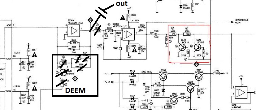

I'd better get some help to my original problem, but I rather go and take it apart and hopefully I will find it.
Its true Danico, im still building my project out of case, even many times i wanted to just give up and put all in original case. Any suggestion about discrete PS is very velcomed. Im using regulators because with that aproach i cant ruin TDA 1541. For +5V i have 7812 and 7805 in series. also vor -5V 7912 and 7905. For -15V i have just 7915.
- Digital Source
- mutting transistors on the output of Marantz cd40 help!!!
