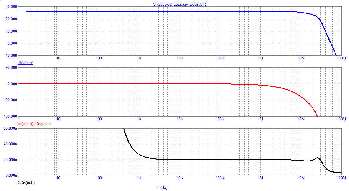

Baxandall made a great contribution on this topic. Among Russian radio amateurs, I. Akulinichev continued his work. He also used a vector meter to measure distortion. Here is one of his developments with a slight modification to increase the output power.

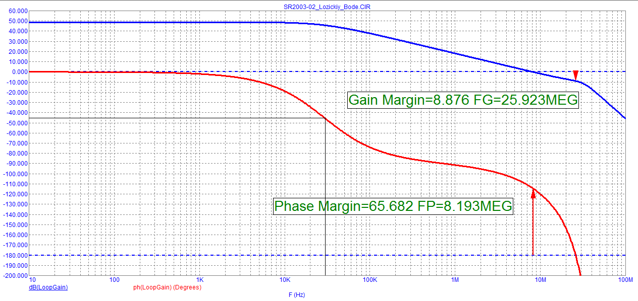

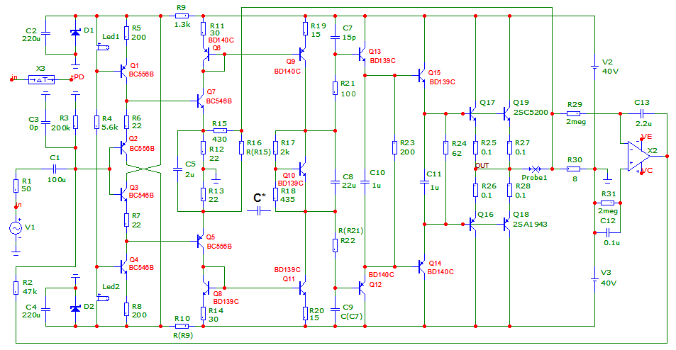

The quiescent current of the output transistors (bias) is 125 mA, the signal propagation delay time is not more than 50 ns and is stable up to a frequency of 4 MHz. Due to this, at a frequency of 200 kHz, there is no gain roll-off, the output signal practically merges with the input signal multiplied by Ku. The distortion spectrum is short, falling, the 2nd harmonic prevails in the spectrum. Class AB amplifier, but no switching distortion. The servo control signal level at 20 Hz is less than 90 dB (norm is less than 40 dB) than the input signal level.
The rest of the parameters are reflected in the test results and are presented in the figures.
The delay can not only be associated with the frequency ,
but also with the signal level, although this is not always easy to see.

I have already given the circuit of the serial production of the Kumir U-001 amplifier, which still sounds decent today.
Engineers who understand what parameters are required from the amplifier develop them like this, see the attached file.
The slew rate of the output voltage depends on the С*-correction and can be from 150 to 1800 V / μs. The time to reach the steady state does not exceed 30 ns, unlike other amplifiers in which the time of transient processes (distortions) is delayed to 3 or more microseconds.

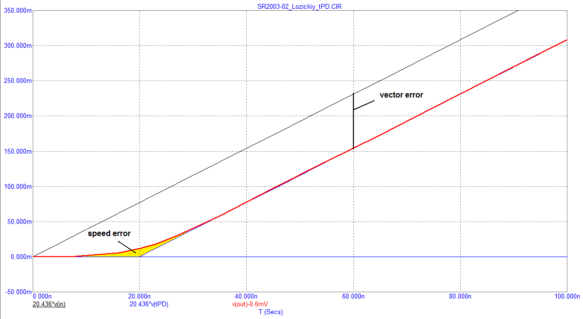

Jan, sit down, "two"! you still do not understand the difference between vector error and phase shift.
The phase shift at a given frequency depends on the delay time (the time axis is horizontal). And the vector error is voltage! (vertical axis). Learn the theory.

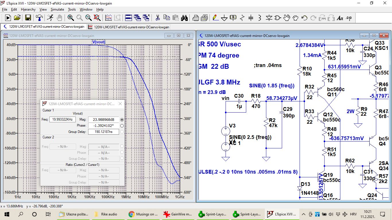

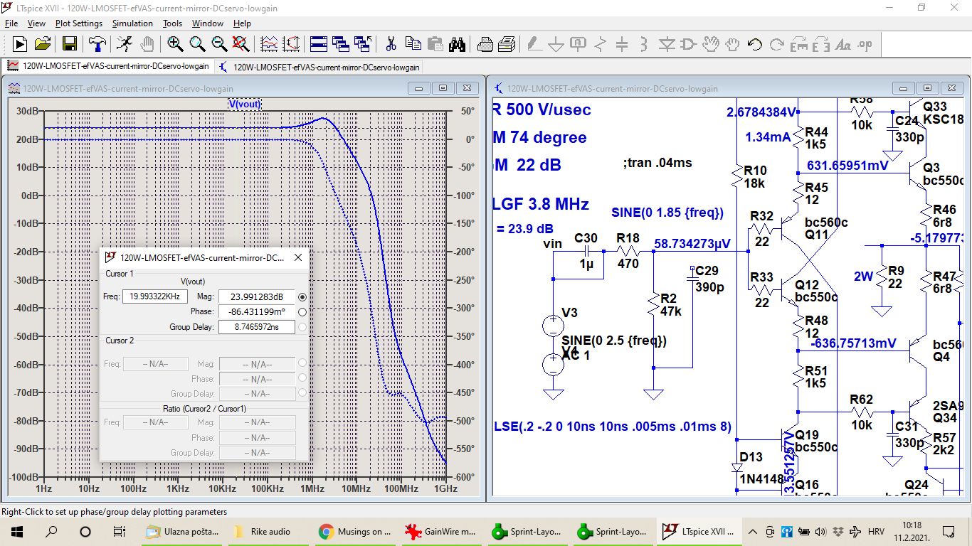

I am confused with the terms used by some of Russian participants and by explanations, specially those used by petr-.
Use of delay is very confusing, like Group delay, Propagation delay and some others “delay”
OOS used instead NFB, correction instead compensation, I really can’t follow all that discussions, even if I would like to learn something from it.

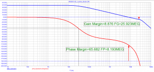

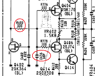

Attached a gain plot of one of my amps, without and with input LF filter, and from those plots it’s easy to see that input filter has biggest influence on Group Delay.
The bump in the gain plot is characteristic of the TPC compensation (not correction as petr- uses instead).

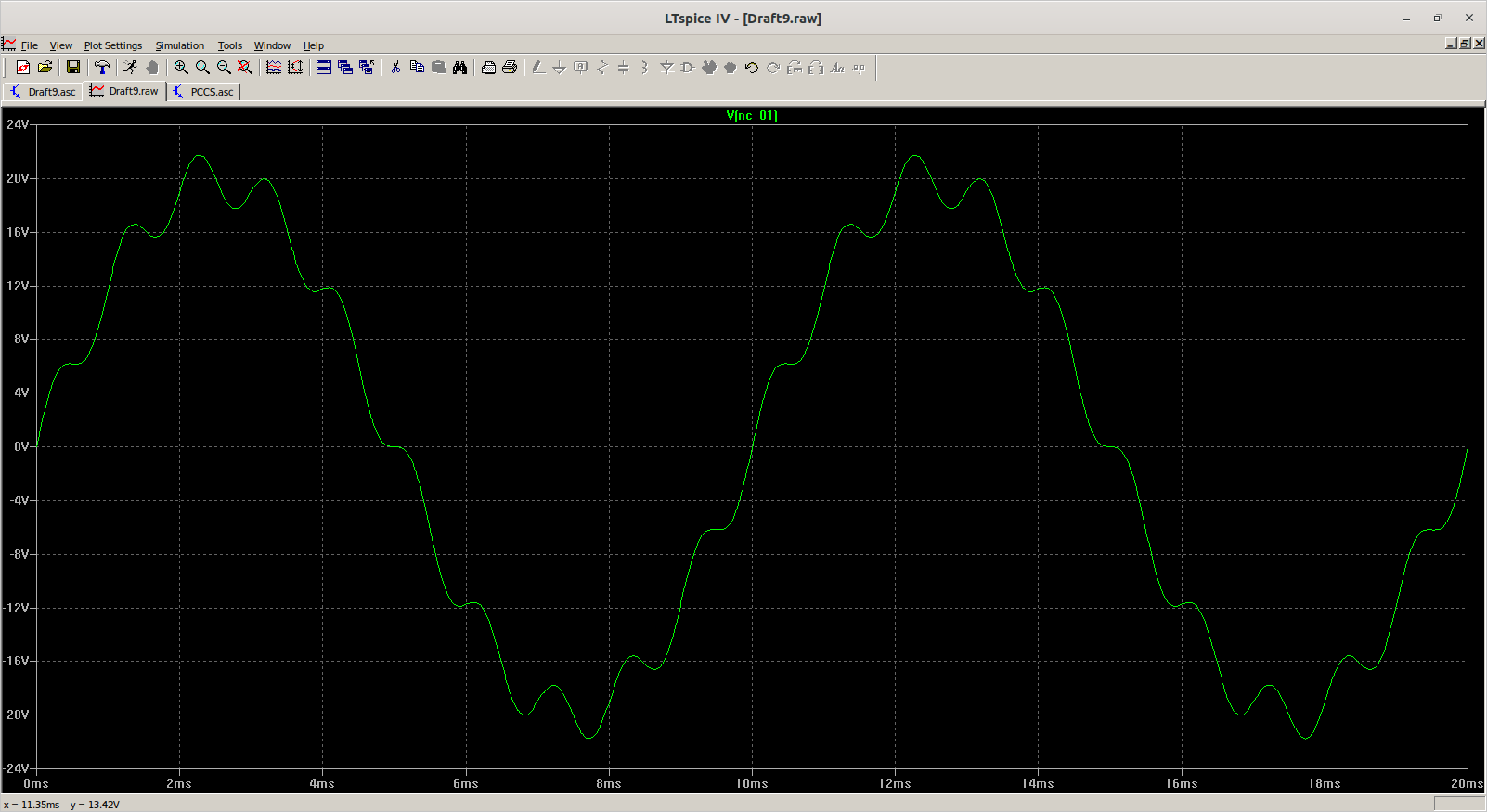

In the following image we can see a 1KHz signal modulated by a 100Hz signal,
if an amplifier has different delays depending on the signal level,
the 1KHz signal will have phase errors.
Our ear will perceive that with jitter.
I think it is the biggest problem affecting audio amplification.

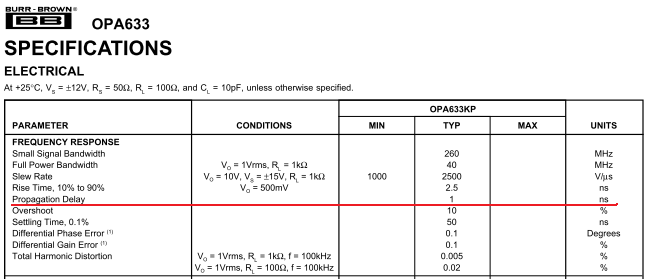

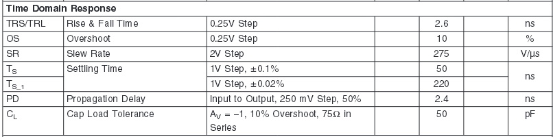

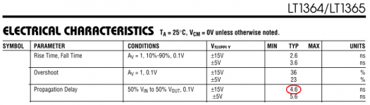

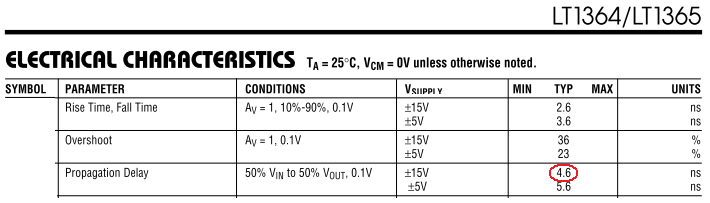

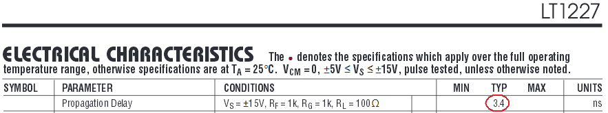

Can you show an example of this instead of FCD?if the delay is related to frequency, this is the worst case. In this case, the amplitude envelopes of the signals will be violated, and the associated sound timbre
Damir, the time Propagation Delay is sometimes indicated in the datasheets on the op-amp

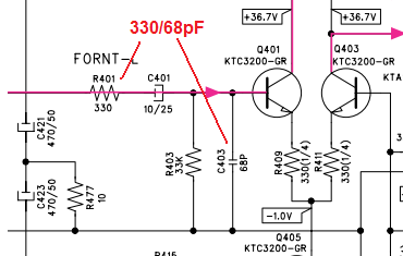

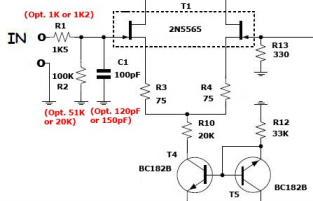

Nobody has installed a low-pass filter at the input with a cutoff frequency of 160 kHz for a long time.
Here are some examples.
Or they don't put any filter at all, in extreme cases put a filter with a cutoff frequency of 1 MHz or higher.
Otherwise, it would not make sense to design amplifiers with a full power bandwidth of 5 MHz or higher.
Moreover, many companies refuse servo control and a capacitor in the NFB circuit to ground. Input capacitors are used with a capacity of at least 220 μF (instead of 0.47 μF) - two capacitors connected in anti-parallel.
In my example the cutoff was at 850 kHz not 160 kHz.
Propagation delay is used in digital circuits.
Have you ever read Stereophile, and if so have you ever seen an amp with a BW of 5Mhz. I haven't.
Has it ever crossed your mind that no source is producing this kind of frequencies, not digital or analog.
So what's the benefit of not using an input filter, none. What's in favor: yes, suppression of HF.
Just another nonsense argument.
