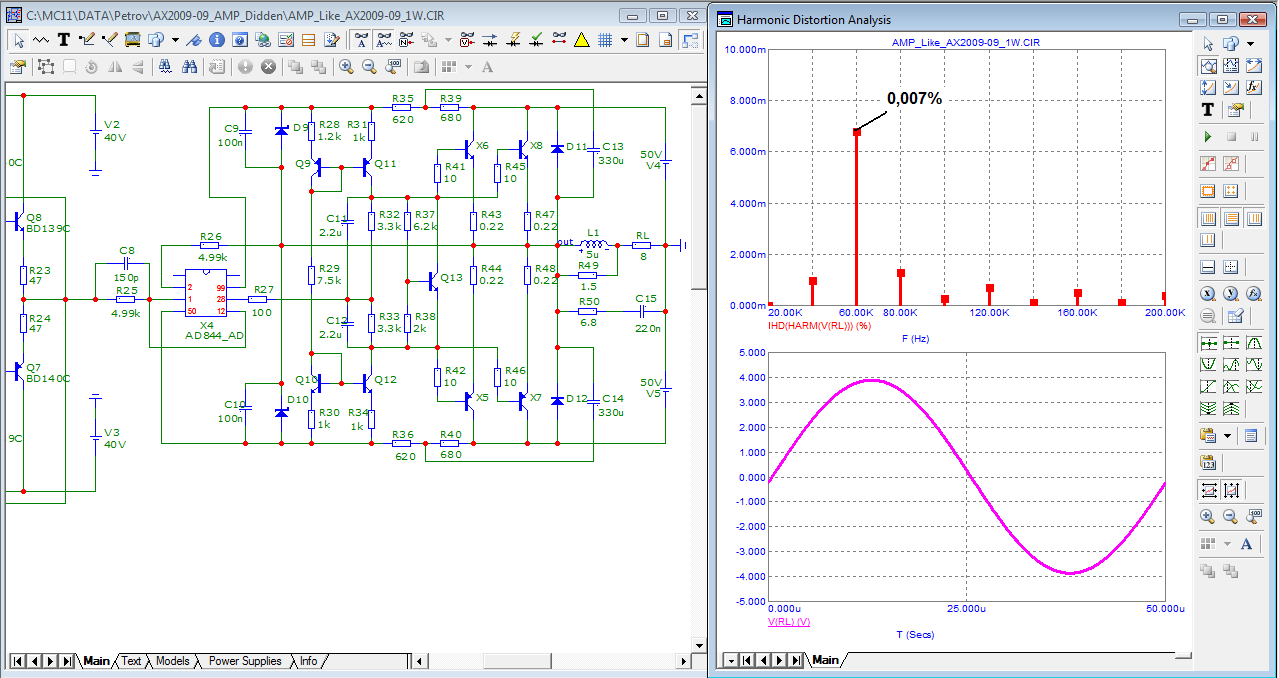

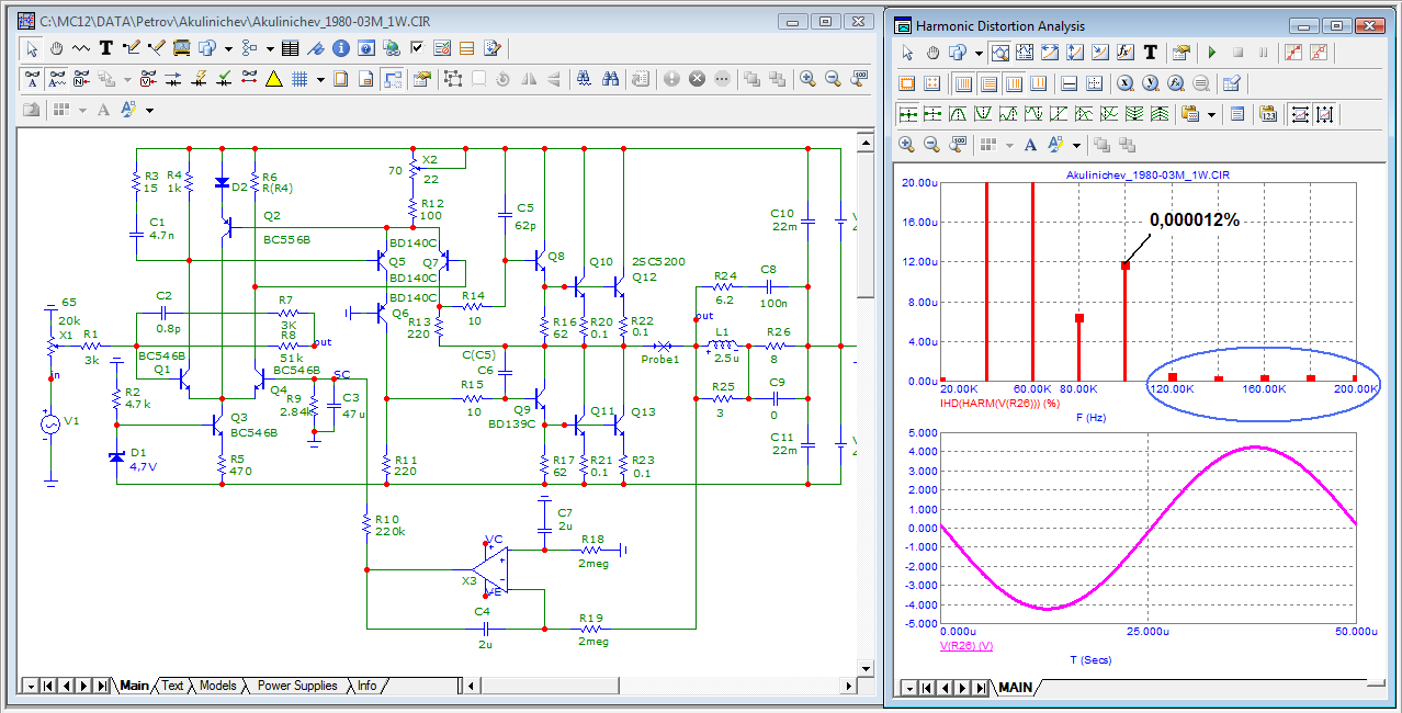

Explain which filter will help reduce the noise and distortion of this amplifier by 30 ... 40 dB in this test.
There are two frequencies at the input, clean, without additional harmonics
Why, in steady-state mode, the distortions of two amplifiers on a sinusoidal signal are the same, and the IMD test shows a difference of 30 ... 40 dB

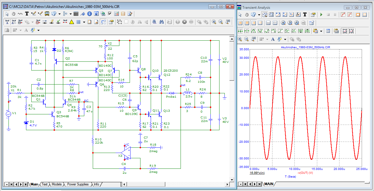

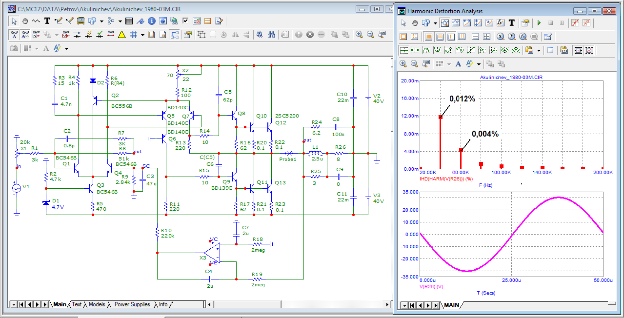

Now let's turn to a simple development of Russian radio amateurs. The voltage amplifier was proposed by Maxim Vasiliev, and the output stage was developed by Dmitry Kireev.
The features of the output stage include the fact that it is capable of working from peak to peak (Rail-to-Rail), the bias circuit for maintaining the quiescent current (bias) has an isolated power supply with a voltage of 5 V.
The signal propagation delay time is 60 ns, the duration of the linear section is more than 1 MHz, at the end there is a smooth fall. With a smooth decline, the time to reach the steady state does not exceed 2 * tPD. In this case, this time is no more than 100 ... 150 ns, which guarantees negligible speed distortions.
Ah, this scheme. For my favorite, I abandoned the parallel amplifier and preferred the usual complementary output stage on inexpensive, affordable bipolar transistors.
Sincerely, M. Vasiliev

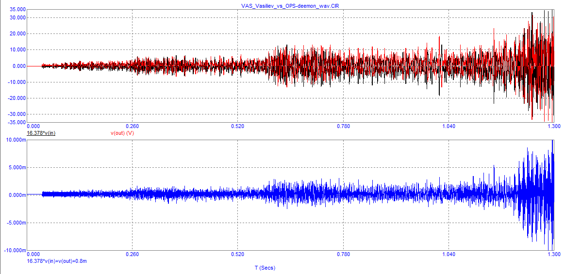

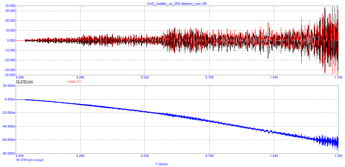

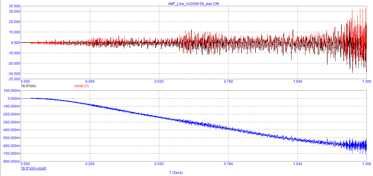

let's give a sound signal to the amplifier input
As we can see, by the end of the first second, a constant voltage of more than 0.5 V appeared at the output. Moreover, the voltage amplifier is to blame for this, the output stage is not to blame. By the end of the test signal, the peak-to-peak vector error amplitude reached almost 200 mV.

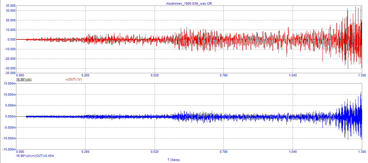

We have to repeatedly hear complaints about the work of amplifiers with servo control. I checked the voltage at the output of the operational amplifier responsible for the servo control, it is only 140 mV. Disconnected the servo control, balanced the amplifier and ran the test again
He is predictable, again and again and........................
Well, when the boulder rolls down the hill you have to push it back up again.
We also repeatedly hear complaints about copper wire and cables on the floor. Do you also believe those?
And the device included in the signal circuit a servo drive (integrator)?) does not on affect the loop gain of the power amplifier? In the low-frequency domain ? And doesn't introduce a pretty decent level of distortion ?Мы также неоднократно слышим жалобы на медную проволоку и кабели на полу. Вы тоже в это верите?

That's right, because the integrator is connected to the summation point and there is an influence.If the correction signal is mixed with the error signal of the OOS at the junction point of the resistors of the oos circuit, the influence of the integrator will decrease.Turning off the servo control system in the second amplifier and balancing it also removes the DC component at the amplifier output

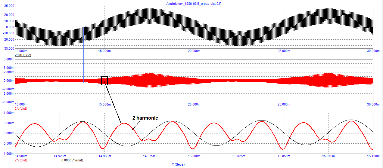

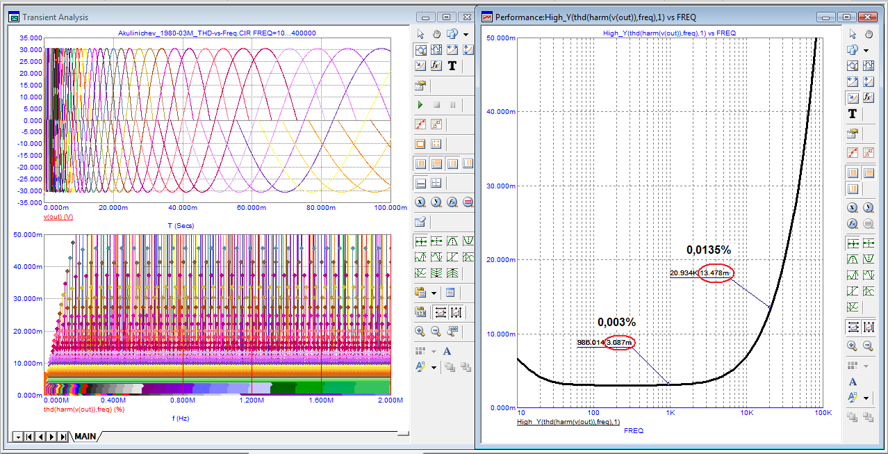

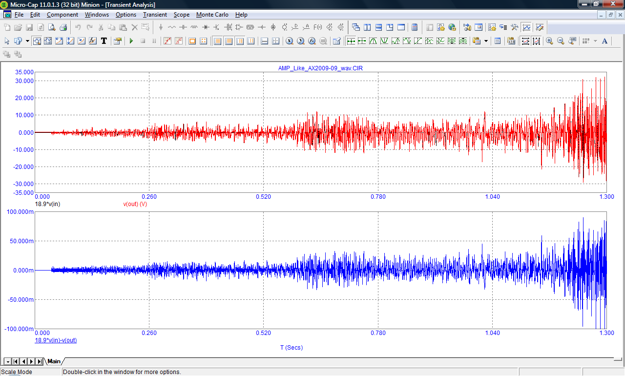

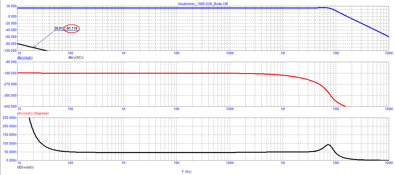

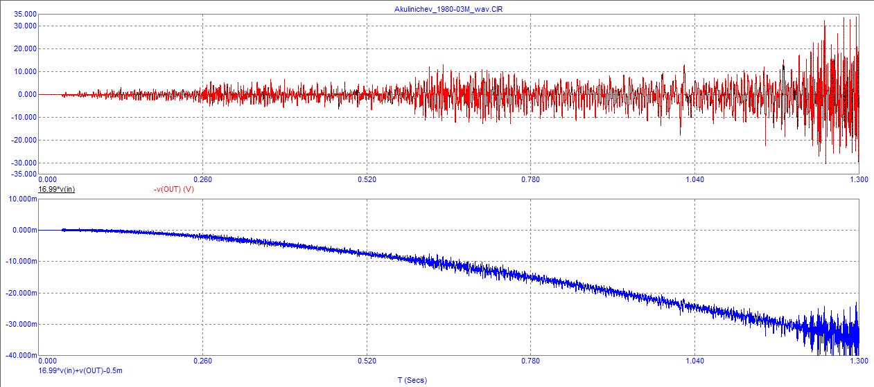

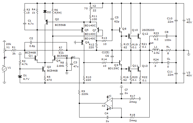

“Gold-ear” listeners claim that the appearance of a constant component during the operation of the servo control system of more than 30 ... 40 mV is already noticeable in the sound.
However, let's not deviate from the topic: "the influence of the time Propagation Delay on the accuracy of amplification of audio signals"

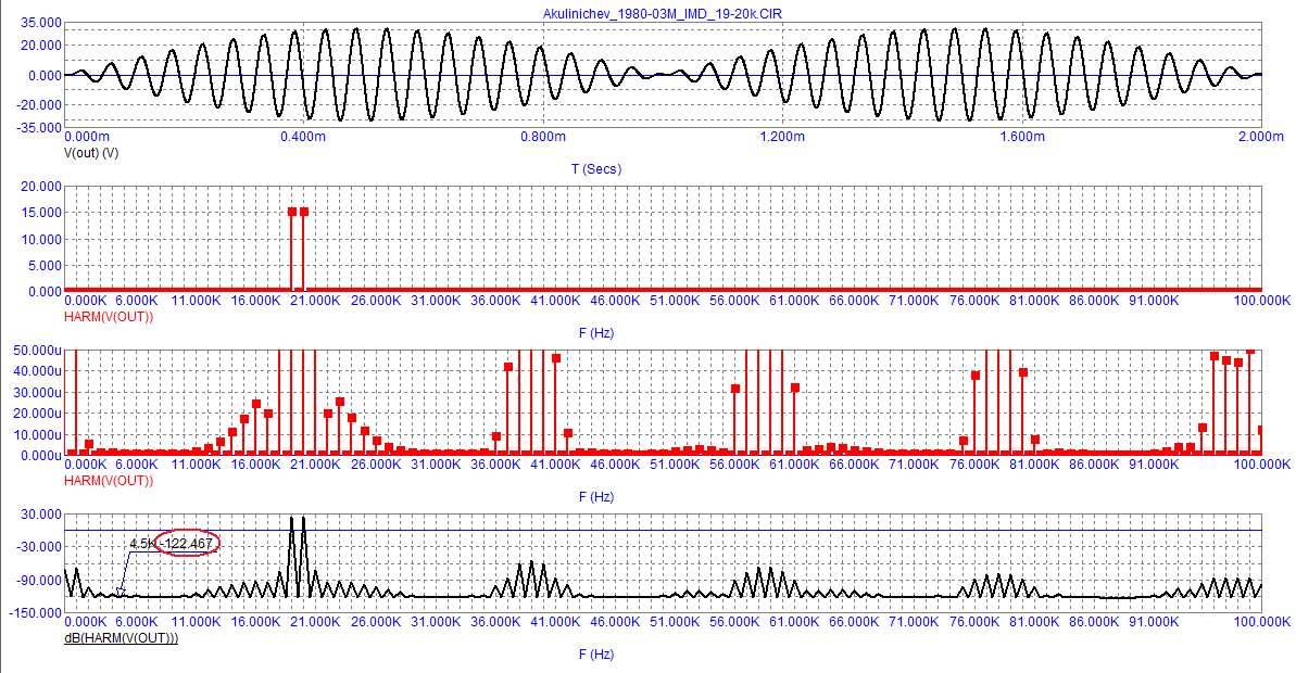

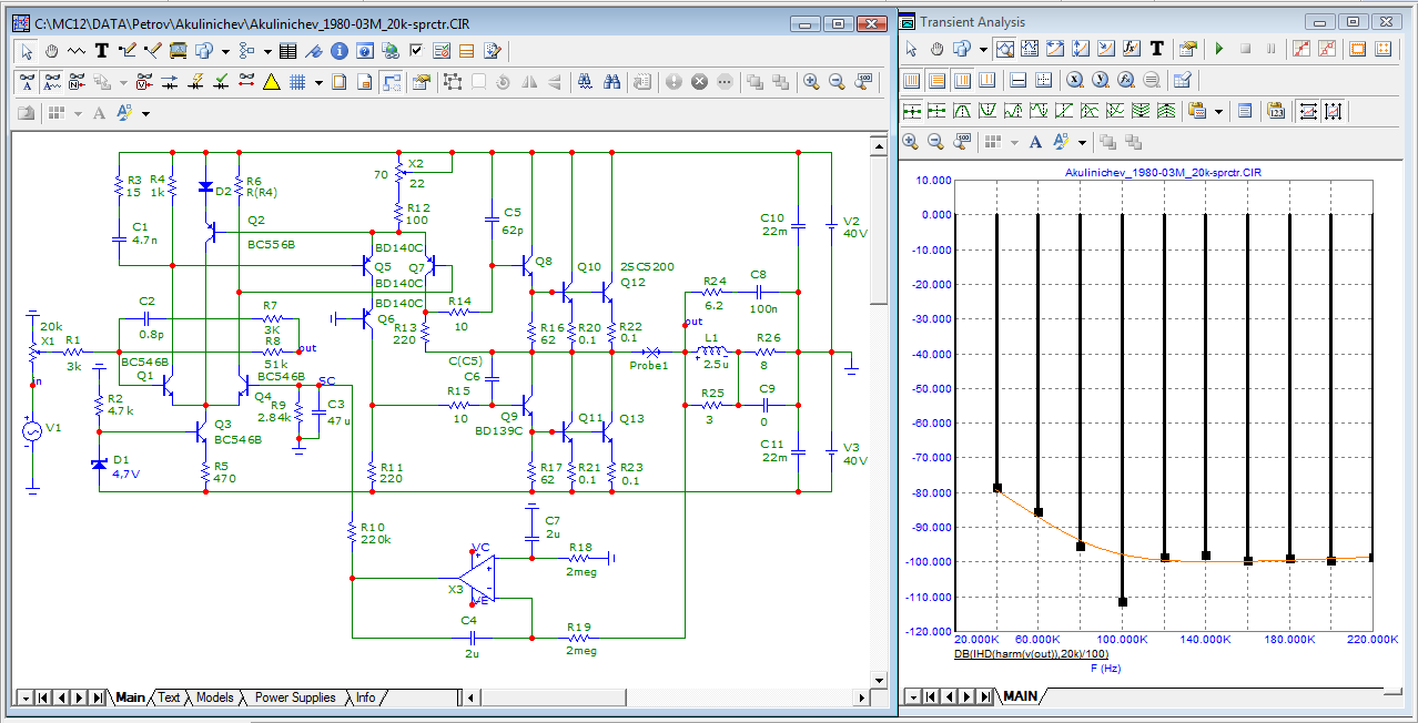

Baxandall made a great contribution on this topic. Among Russian radio amateurs, I. Akulinichev continued his work. He also used a vector meter to measure distortion. Here is one of his developments with a slight modification to increase the output power.
The quiescent current of the output transistors (bias) is 125 mA, the signal propagation delay time is not more than 50 ns and is stable up to a frequency of 4 MHz. Due to this, at a frequency of 200 kHz, there is no gain roll-off, the output signal practically merges with the input signal multiplied by Ku. The distortion spectrum is short, falling, the 2nd harmonic prevails in the spectrum. Class AB amplifier, but no switching distortion. The servo control signal level at 20 Hz is less than 90 dB (norm is less than 40 dB) than the input signal level.
The rest of the parameters are reflected in the test results and are presented in the figures.

Many have acoustics with high sensitivity and the quality of the first Watt is important for them. At low power, the distortions of the amplifier I. Akulinichev are negligible, the spectrum is short, which cannot be said about a more complex amplifier

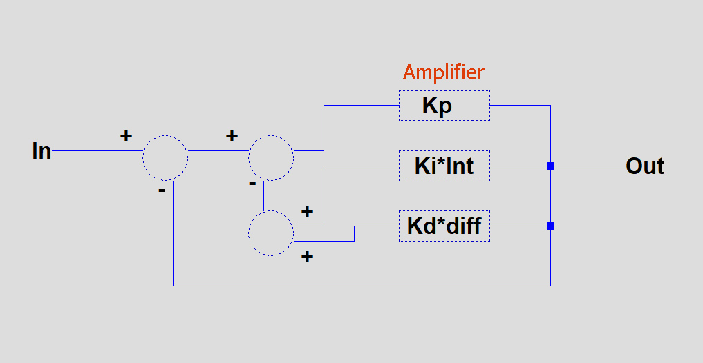

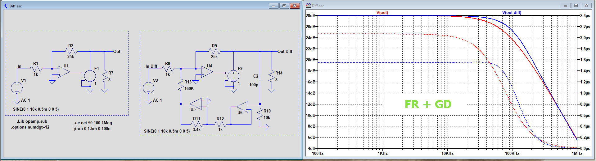

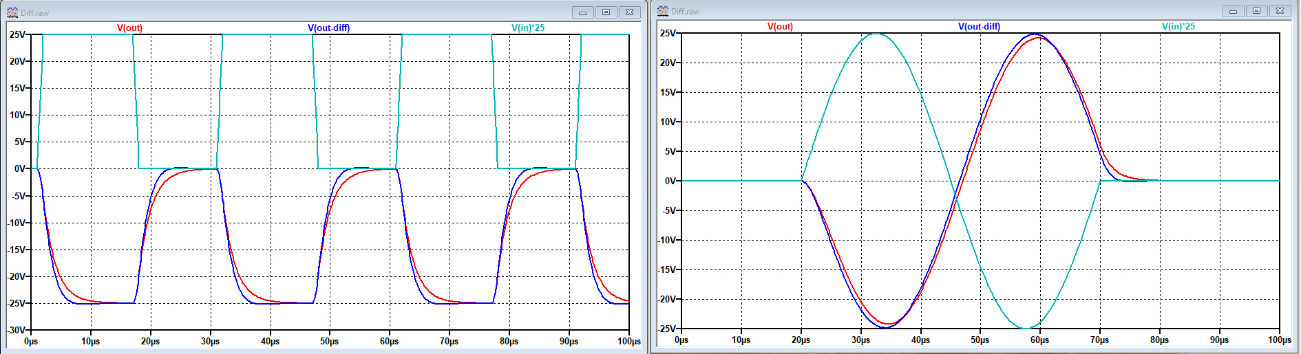

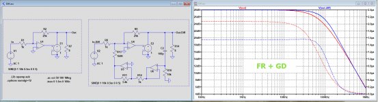

Petr,
You might have thought that I was kidding when mentioning the option for a PID control system.
Well, I was not.

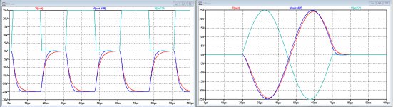

In the two images below you see a simple amp with a 70Khz BW and the same amp with the feedback added from a differentiator.
With differentiator FR is extended to 100Khz, but the GD between both versions is quite different.
With differentiator is goes down from 2.1usec to 1.5usec and has a much larger frequency span.
When processing a square wave or a 20kHz frequency burst, the difference are quite noticeable.
Hans
