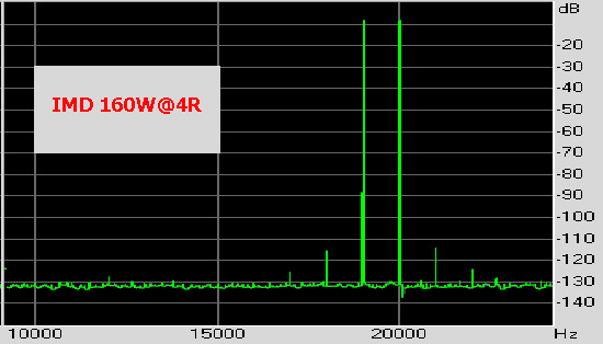

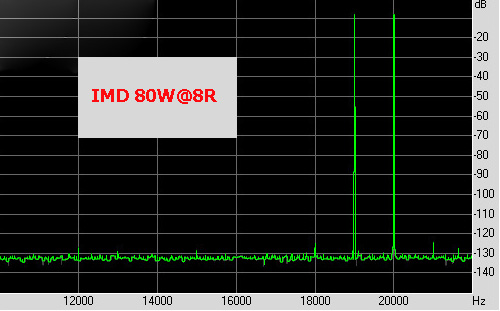

Petr,
Yes you did show images of this important IMD subject.
However, two remarks:
1) The images were simulated and not measured as far as I could see, which can make a big difference.
It could very well be a by-product of the sim program.
See the two images below of real IMD measurements of 80Watt@8R and 160Watt@4R taken from my amp.
According to your theory it should produce different noise levels but it doesn't.
2) Looking at your IMD images, all I can see is a rise in white noise, true ?
If your theory holds, white noise is harmless as long as it stays below the auditory threshold, which is the case as shown in posting #126.
Hans
