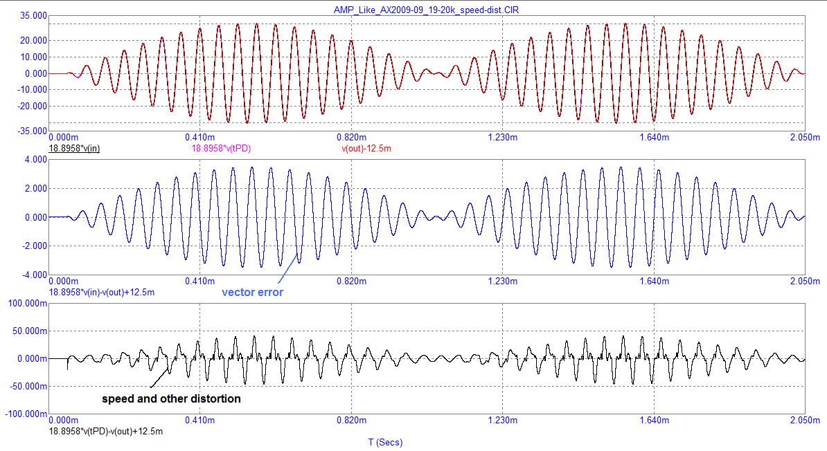

I don't know if you will understand this or not but to make a valid proof, real measurement is required, simulation result alone is not enough. Use real signals present in an audio recording. Avoid use of hypothetical signals.... IMD tests and showed that an amplifier with a low and flat group delay has a lower level of distortion products in the audio band. In support of this, I cited tests of three amplifiers carried out by Bukvarev.
To show the known fact of what? Are there speed distortions in the first period? In real music signals?

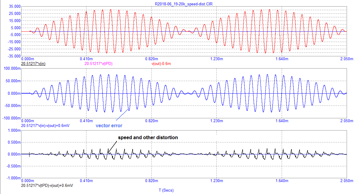

Hans, I borrowed figures 4-6 from Bukvarev's test (see link).
Is it really incomprehensible that the increase in noise at the end of the audio range is due to high-order intermodulation products.
Hiraga showed a similar effect in the article "The Many faces of distortion" Glass Audio 2005-05 see fig. 3 and comments
I'm not going to convince anyone, you can pour from empty to empty endlessly. Whoever understands will be guided in practice and will soon be convinced of the correctness of the idea of reducing Gdelay to 100 ns and below, that's all. Of course, subject to the conditions that I stipulated.
