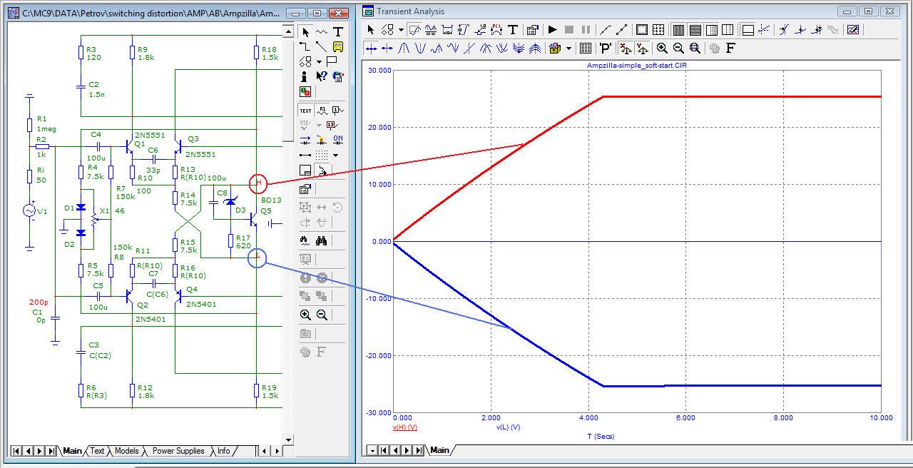

Another feature of the Ampzilla amplifier is a soft turn-on, without "claps"
the music signal is a pulse signal rather than just a sinusoidal one. Apply a rectangular pulse signal to the equalizer, adjust and see what is output. He does the same with audio tracks. Therefore, it is necessary to use it very carefully, and it is better, if possible, to do without it.

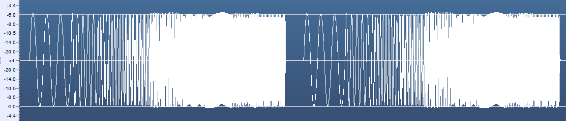

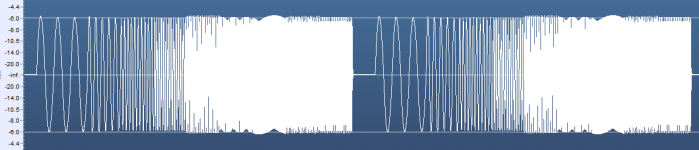

petr, may I ask, how do you see the test input signal?
/örjan
orjan, I see the test input signal like this. I used this signal to set up the recording-playback channel of tape recorders. Exactly in this form, it entered the input of the recording channel, and in the same form I observed it at the output of the playback channel, if the tape recorder was in good working order. Can I use it to test the amplifier? What do you think?

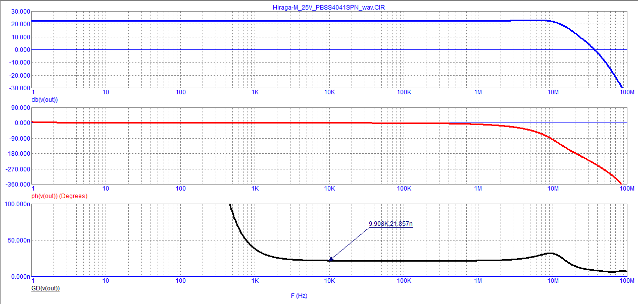

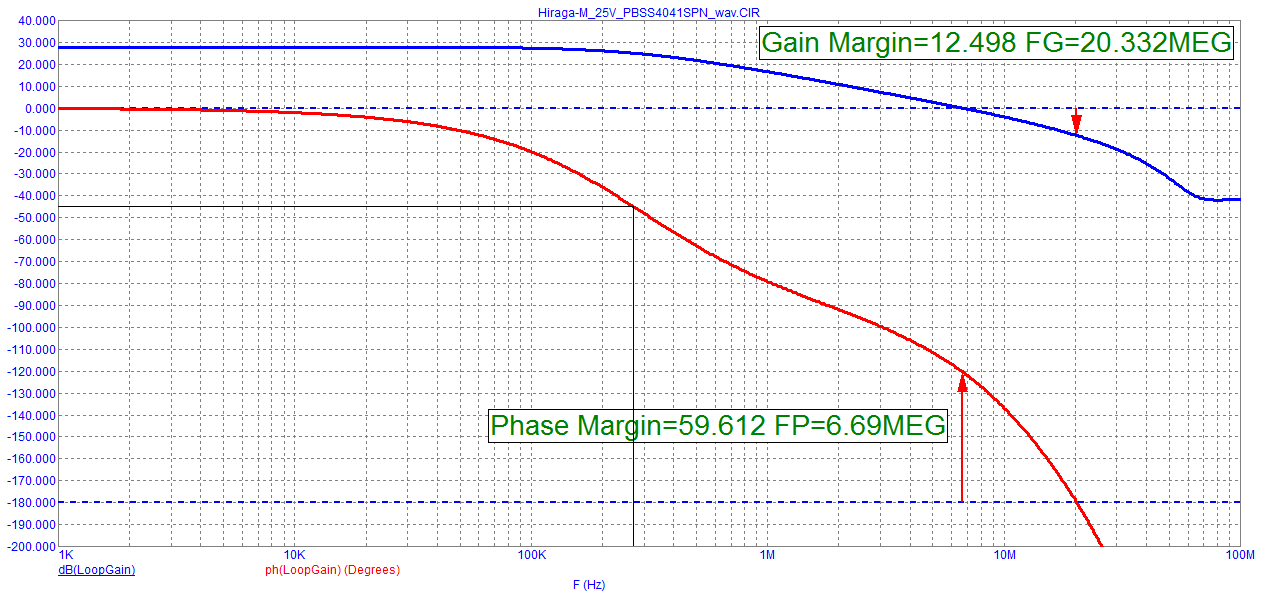

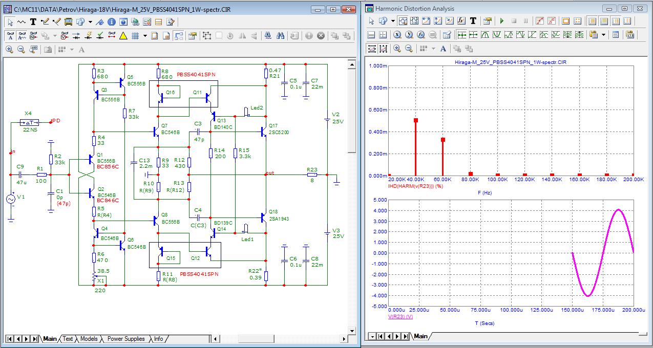

I never found an argument against Graham's statements.
Hard to discuss about "as wide as possible bandwidth", "as fast as possible speed".
Anyway you will be limited by power stage bandwidth/stability, VAS output current and hi-impedance point load capacitance.
Any good idea or sophisticated knowledge must point you how exactly reach those benefits.

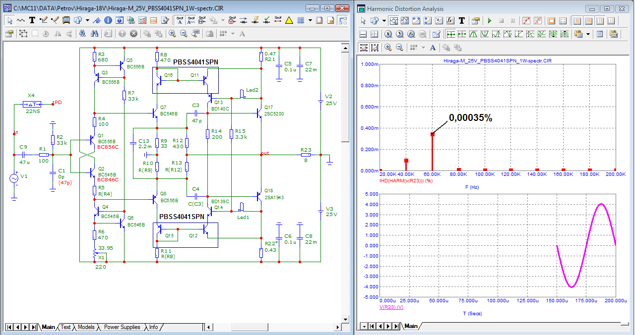

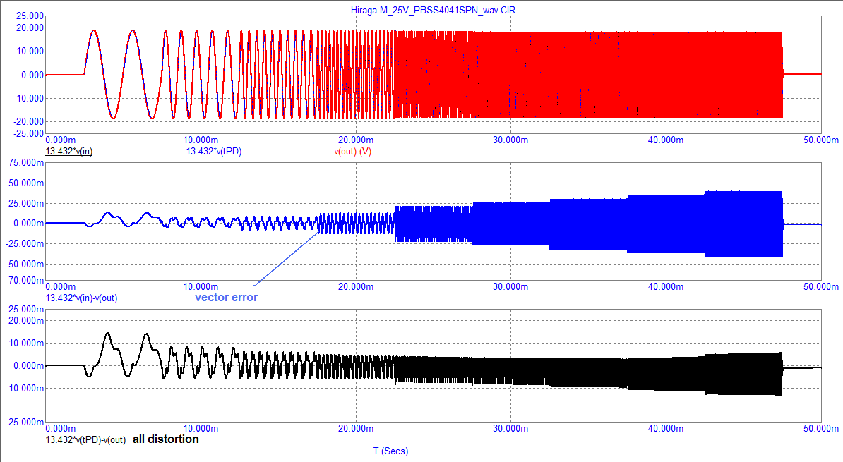

Now i see one way to achieve Graham's goals - make relatively simple amp with low feedback depth and very fast OPS, literally say - dominating pole somewhere at 100 kHz, first order and ~30-40 dB feedback depth at gain of +26dB.

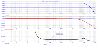

The slightly modified amplifier by Hiraga satisfies these requirements. First pole 250 kHz, tPD = 22nS

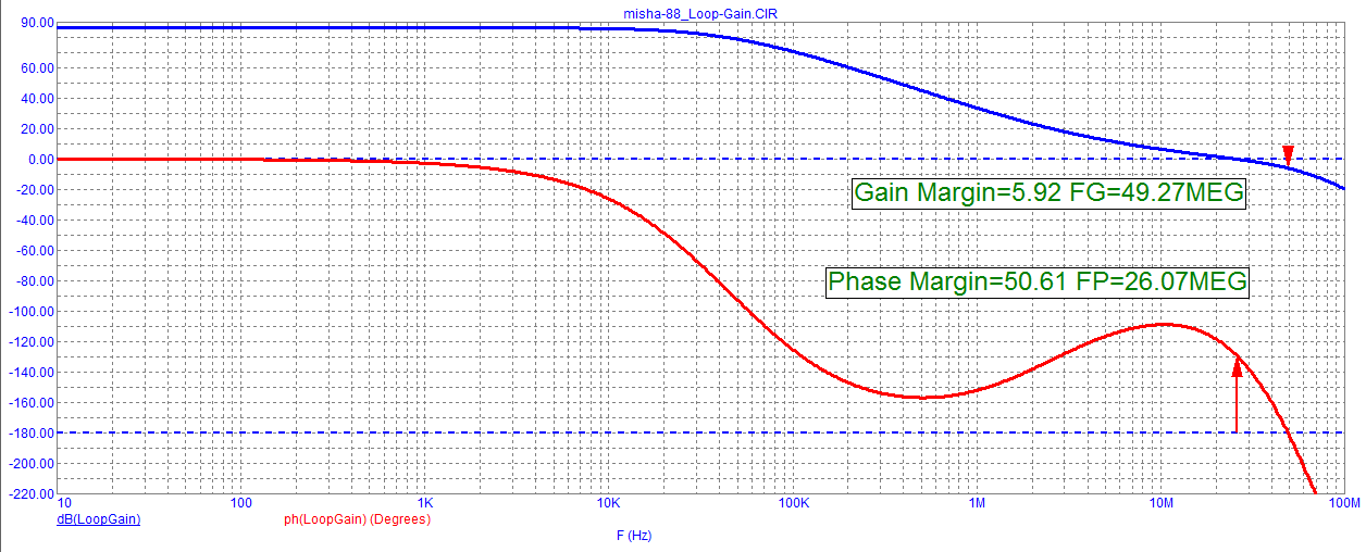

It is not so easy to obtain a great depth of NFB and meet the requirements for parameters that correspond to high sound quality.
The author of this development succeeded.

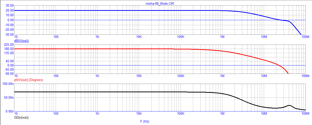

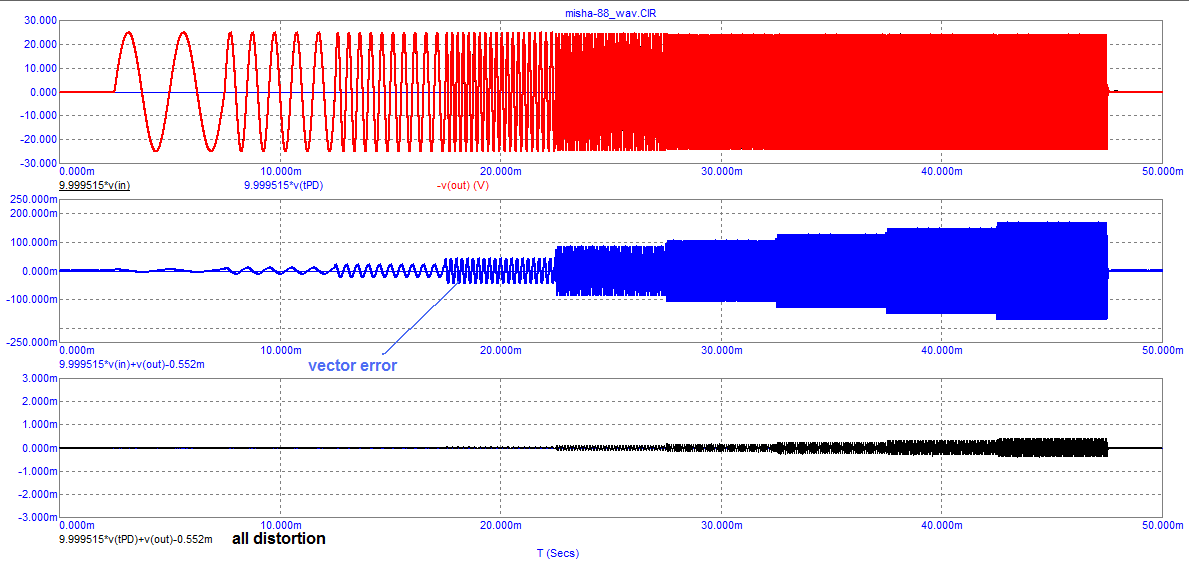

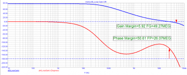

???? ?? ????????? ????? ???????? "??????????" ????????? - ???????? 33
Judging by the parameters, the author is not only well versed in sound, but also strong in circuitry. The signal propagation delay time tPD = 70 ns from fractions of Hertz, up to 600 kHz, followed by a smooth falloff. The frequency of the first pole is quite high - about 20 kHz.
The NFB depth in the audio range is more than 85 dB, which provides negligible distortion.
