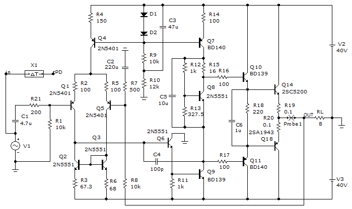

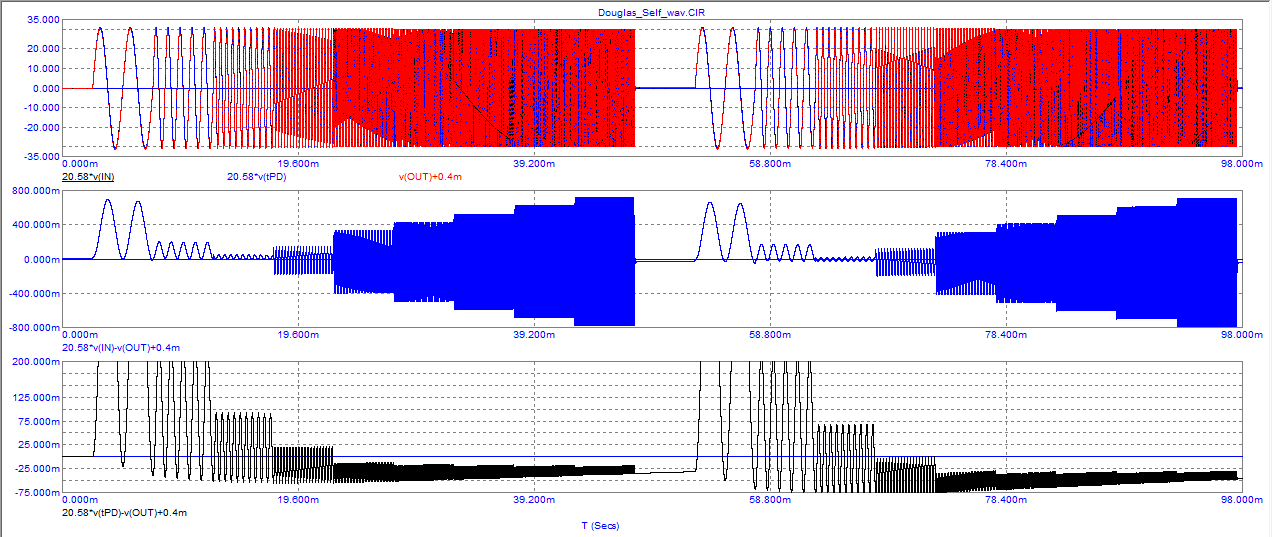

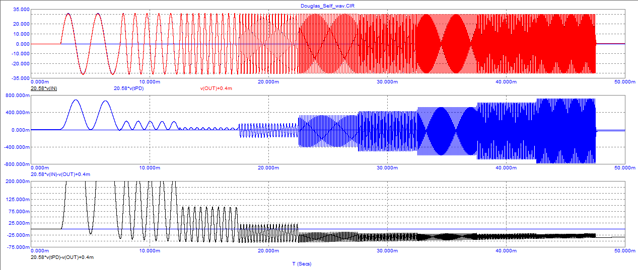

The effect of capacitors (bandwidth at the bottom) can be traced in the following tests
a constant component of more than 50 mV appears at the output
As mostly the case, the images are hard to understand without explanatory text, but even without images it is easy to understand why DC appears at the output. It’s because input current of the 2N5401 is not symmetrical.
You are right that this output DC should better be prevented.
But is has no relation to aiming for a very low and flat GD that you favour.

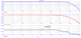

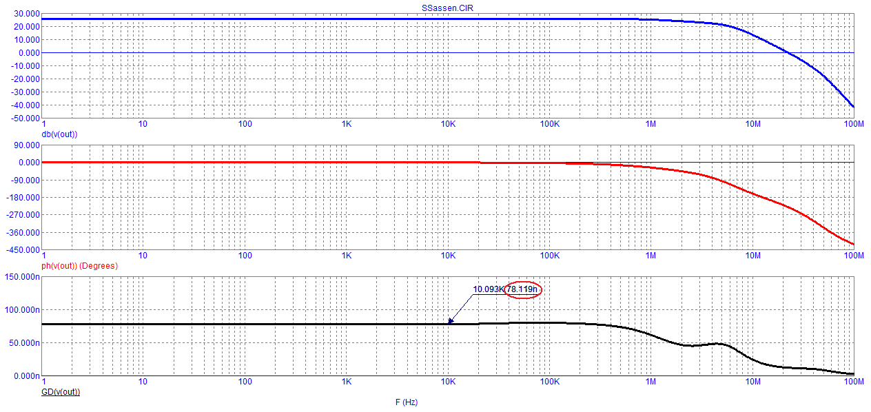

Yes, Hans, you rightly noticed that I am a supporter of the most flat characteristics of the GDelay. This also corresponds to the theory according to which, for the transmission of any signal with minimal distortion, the frequency response and phase response should be as linear as possible, and therefore must be linear and the group delay

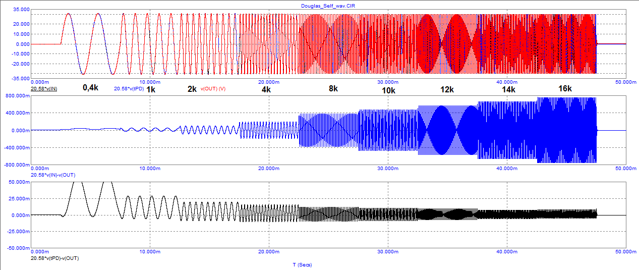

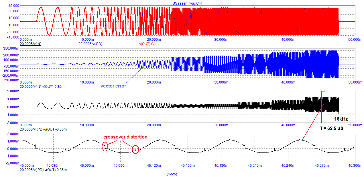

Here is an example of a test of an amplifier model from a neighboring branch (from which my posts were uploaded here)
Ku tuned in at a frequency of 10 kHz. The test shows that at a frequency of 16 kHz, Ku has changed slightly and the signal suppression is incomplete.
In the low-frequency region, the second harmonic prevails, and it is mainly distinguished as a product of distortion.
Changes in frequency response or phase response is linear distortion and does NOT generate harmonics.
Non-linear circuit elements cause non-linear distortion which DOES create harmonics.
Jan
Jan

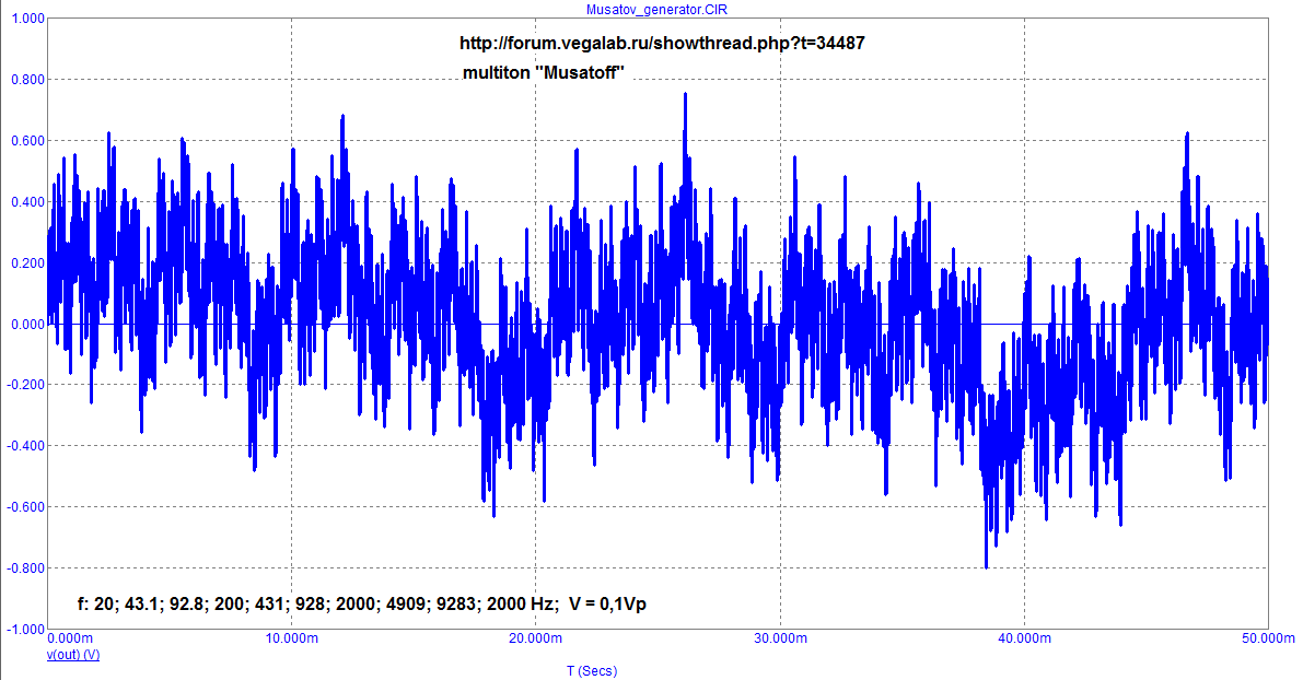

When I can find the time in the next week, I will do a multitone test instead of a sim, with increasing levels for two completely different amps with 8R load.
I will of course also measure their GD.
Will 20 tones do from 100Kz to 10Khz ?
Let's see what happens, two possibilities:
1) the noise floor will increase as you have suggested.
2) the noise floor will not increase, but several IMD products will become visible.
Hans

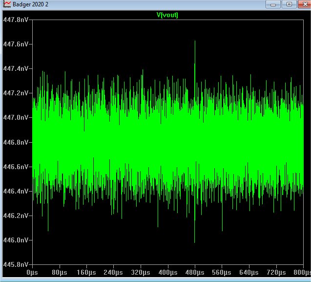

IT is strange (or not so) that the models of devices show noise while at rest .
(below)
Real units show +/- .4 mv. I'm servo'ed , so F all. I can't hear it on my silk dome tweeters , I am happy.

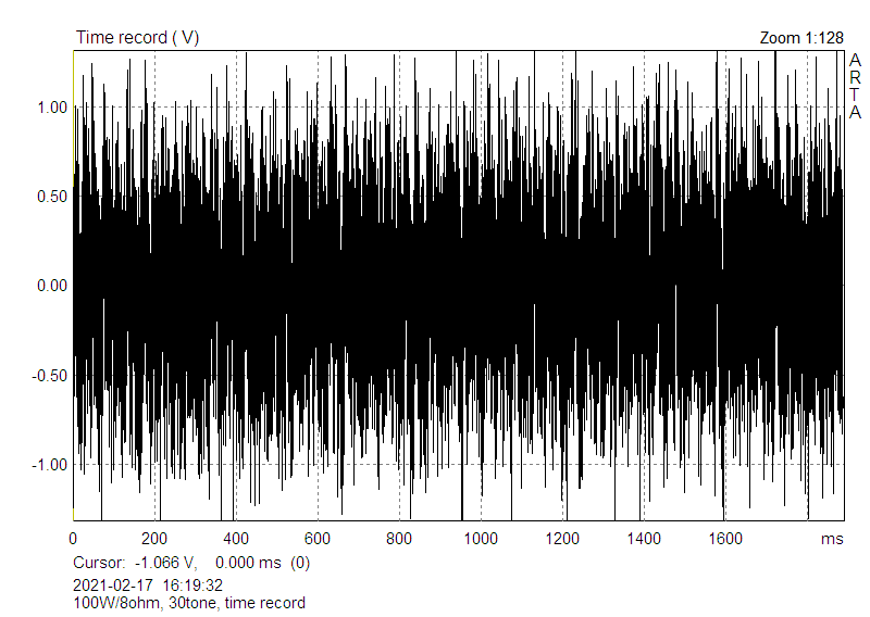

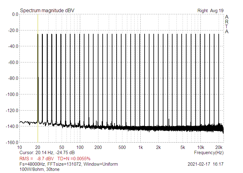

Real measurements ,my amp, multitone signal..Output attenuated cca 30dB. Amp with total GD (inclusive input LP) about 450ns. Amp alone about 210ns. This is reality, no "strange" theory.
So ARTA can generate multitones? Didn't know that, that's interesting.
I wonder if the crest factor and individual phases can be specified.
Need to check it out.
Jan
Jan
