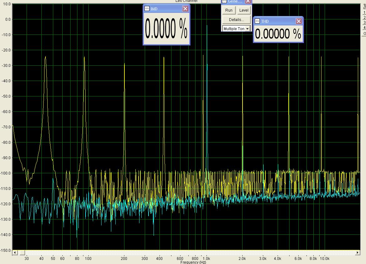

Real measurements ,my amp, multitone signal..Output attenuated cca 30dB. Amp with total GD (inclusive input LP) about 450ns. Amp alone about 210ns. This is reality, no "strange" theory.
Great posting. It shows already in some way that noise spectrum is quite normal an in no way elevated at HF as the images suggested that Petr showed.
Did you by the way also measured the noise spectrum in the same screen setting but without or with much lower level multitones.
If so, we can close this discussion.
I don’t care what happens above 20Khz as long as it has no repercussions on the audible frequencies.
And this multitone test could have given a clue.
But so far no cigar.
Hans
multiton-noise

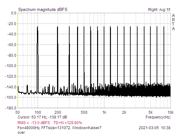

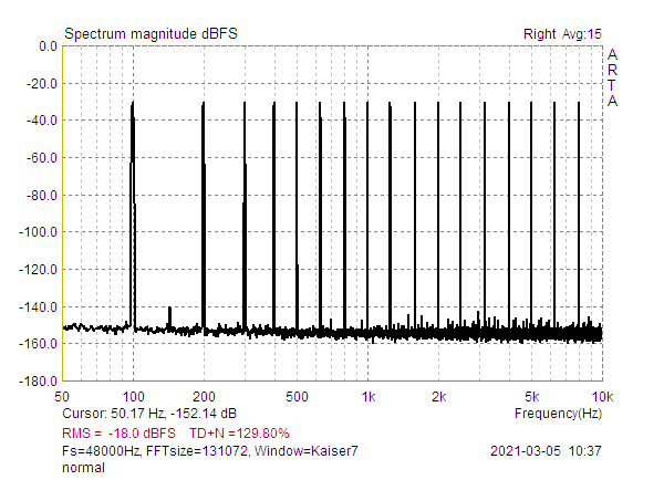

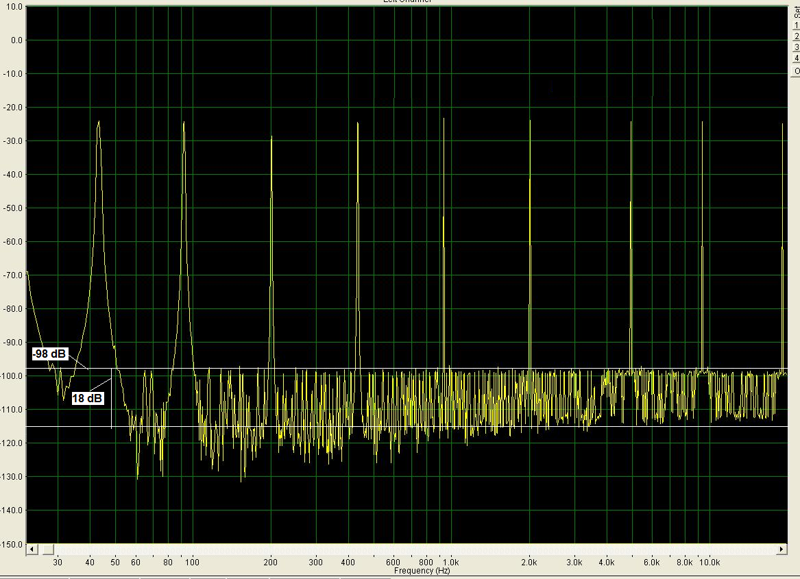

the measurement results show that the noise on a multitone signal has risen by almost 20 dB
Что такое разрешающая способность ? Форум Sound Space
Onset of peak limitation somewhere in the chain, generator, DUT, sound card input .. Multitone has a high crest factor, peak values are high compared to discrete tones. You have to lower signal few dB. The signal in the time domain must also be monitored for control.

Good points. It is not easy to interpret the results from a multitone.
If you read the AP app note, they carefully select the frequencies and phases of the test signal, together with the FFT settings. The aim is to make sure that all harmonics fall in discrete FFT bins, so they can be measured individually.
Also, they make sure there are FFT bins where no fundamental or harmonic falls. These 'empty' bins can then be used to measure the noise in the presence of signal.

BV, this is an absolutely meaningless test, since all intermodes coincide with useful signals and therefore are not reflected or visible.

Gotta love it. BV posts a pretty blameless multitone result and Petr ignores it and posts a rubbish one to prove...nothing!
OTOH, that test shows the intermod and harmonics at the same freqs as the signal, and thus are hard to see. Petr has a point there.
I tried to explain how a proper multitone test needs to be structured so that all the harmonics as well as the noise can be seen separately.

billshurv, your test is as bad as the previous test with frequencies over 1 kHz. This multitone has 30 frequencies. The more frequencies the lower their levels. The lower the levels of the RF components of the signal, the less the likelihood of intermodulation and velocity distortion.
The frequencies are extremely poorly chosen, most of the first order intermodes (having the maximum level) fall on the multitone frequencies. For example, 15 kHz - 12.5 kHz = 2.5 kHz; 15 kHz - 10 kHz = 5 kHz; 12.5 kHz - 10 kHz = 2.5 kHz; 10 kHz - 8 kHz = 2 kHz; 8 kHz - 6.5 kHz = 1.5 kHz; you can count in the reverse order: 10 + 5 = 15; 10 + 2.5 = 12.5; 12.5 + 2.5 = 15; 8 + 2 = 10 and so on ...

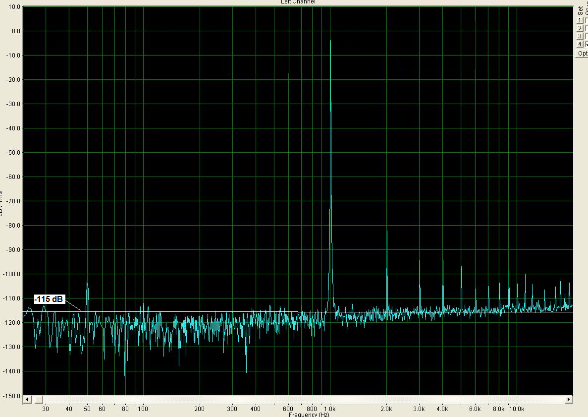

Hans, I don't understand what you don't understand in the tests. Here are two tests: a single sine test and a multitone test. On multitone, the noise level went up by 18 dB. And this is with a bad sound card. Some cards have an intrinsic noise level of minus 140 ... 160 dB, then the difference is seen more clearly.
So use simple CCIF, 19+20kHz. Or use e.g.50+51kHz and look for product at 1kHz.The more frequencies the lower their levels. The lower the levels of the RF components of the signal, the less the likelihood of intermodulation and velocity distortion.
Petr,
yes those last images are almost clear but the second image does not show the noise well enough.
What were the exact frequencies, what was the used frequency bin width and how many spectra were averaged ?
And I still have no answer to #275.
The musatov link that you gave is not available.
You cannot say that a sound cards has a noise levels of -160dB.
Starting somewhere at -120dB for a 24bit A/D, it depends on the width of the used filter bin.
The narrower the less noise according to a square law and always to be followed by averaging spectra in order to flatten the noise to its average level.
In this multitone test we have to be able to discriminate noise from IM products,
because your thesis is that noise will increase because of “speed errors”.
So please give the frequencies for the multitone test and the filter bin width.
It is not just Hans, it is many of us.
There is nothing to understand in your post. You just throw up two graphs, and say: 'See, graph 2 is better than graph 1'.
There is no description of what the test is, what are the signal levels, what kind of equipment is tested, what is the test setup, under which conditions, what are the differences, etc, etc.
You do that all the time and the result is that nobody knows what you are talking about, and you are wasting your own time as well as our time.
