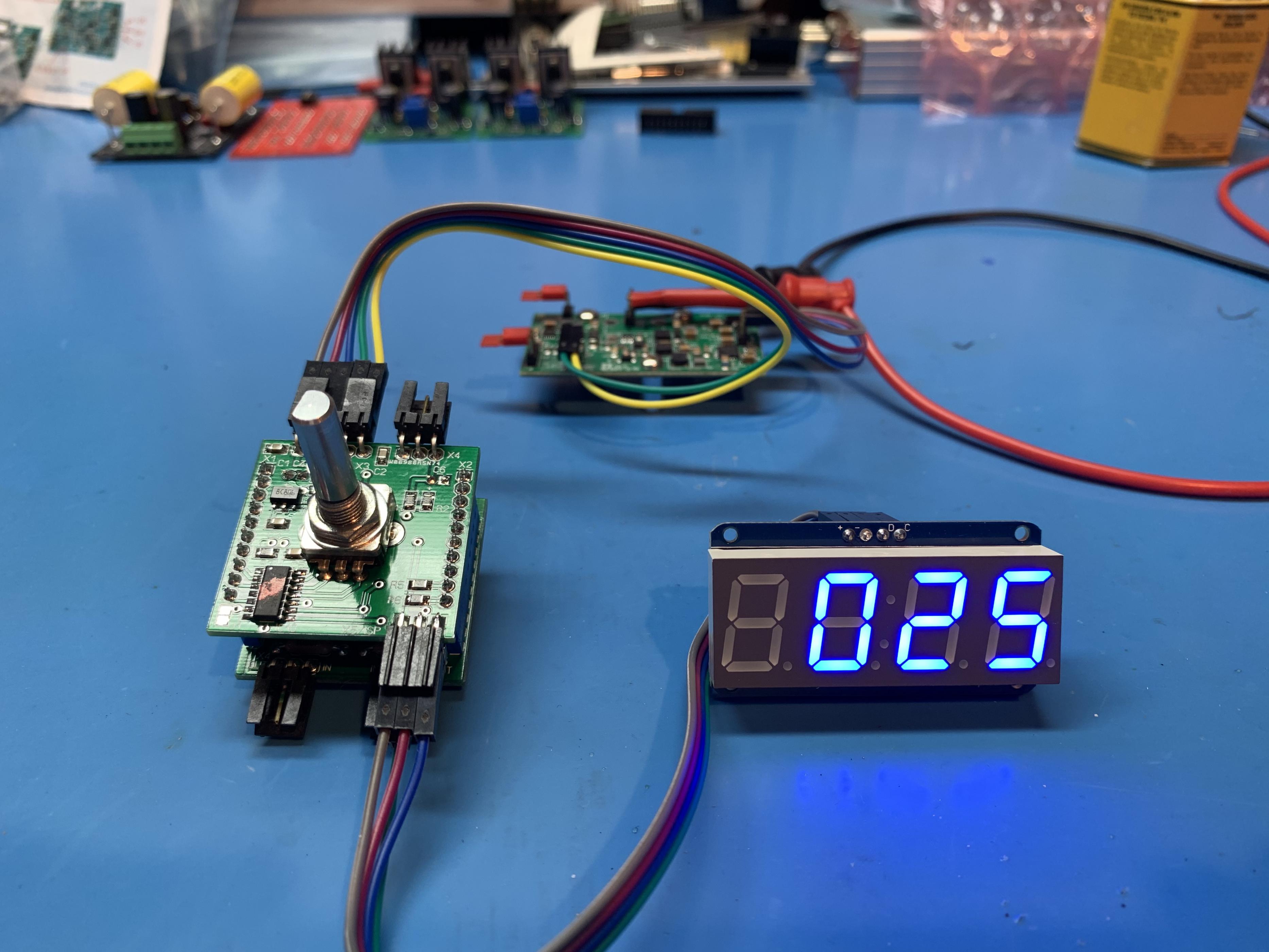

I have two minor suggestions:
1: (Controller board) The LDO or voltage reg. needs an input cap close to input terminal. This cap should have a capacitance value equal to or larger than the
output capacitor for performance applications.
Fortunately it is easy to install to the board, see pics. I do not remember the package size, maybe it is 1206... fits perfectly.
I tested two different LDOs in this application with and without the additional cap, and without the cap both were oscillated.
2: (Muses board) I think there is a mistake, see pic.
It is easy the cut the trace between C3 and R4 and you can use a little wire to connect c3 the other side (gnd) of the r4.
Thanks rookakoma
1: I use standard TS78L05 without any oscillation. In some cases (with low drop voltage regulators) it could necessary to use a second cap nearly the input of the reg.
Please tell us the regulator type in your buildup.
TS78L00CY
https://cdn-reichelt.de/documents/datenblatt/A200/DS_TS78_SERIES.pdf
2: It is not really a mistake. The cap short high frequency direct between dref and vdd.
Daniel

Help with Remote Function
Hi Everyone, looking for some help here please.
I finished a 2-ch stereo version of this fine attenuator earlier this year, but like a few other people, I have been unable to get a remote to work with it. I don't have a display attached, only the IR sensor, and I am using the onboard 5V regulator. The attenuator works well in all other regards.
Input voltage to the attenuator is +/- 15.2 V from a p2p regulator that I built - it is tapped off a 28V psu. R1 is 100 Ohm, so there should be heaps of current.
The on-board regulator (KA78L05) outputs +4.5V and this is what I have as Vs on the IR sensor (TSOP 4838).
I've changed the regulator, D1 and D2, and the sensor but still no joy. I don't know where to debug next (looking at the controller IC but I have no idea what to do with it...)
I'd appreciate any help or suggestions on how to proceed.
Oh, I've tried 4 different remotes (Panasonic, Sony, Apple) and none seem to be able to talk to the attenuator.
Thanks,
-Keith-
